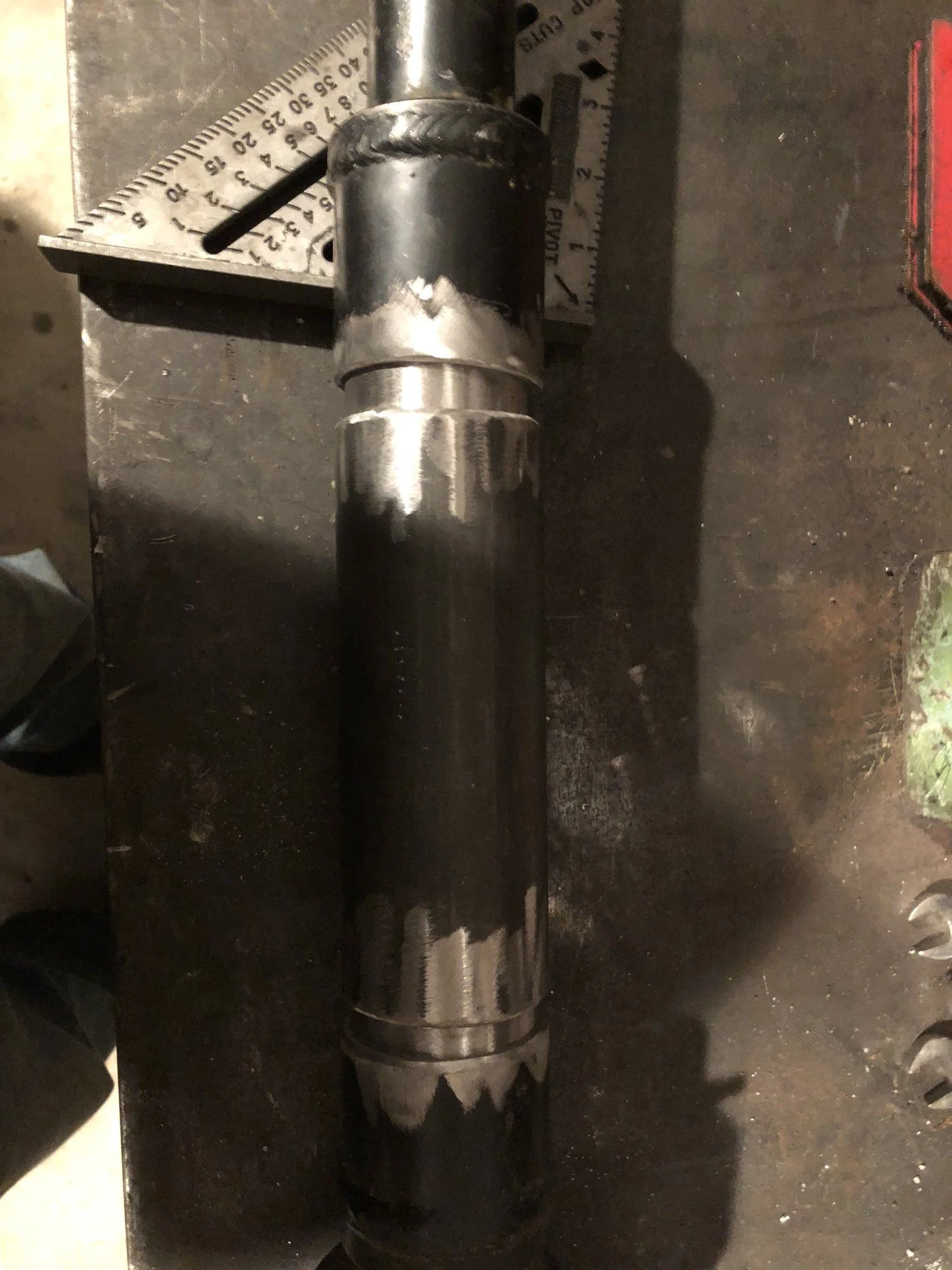

would measure carefully and then caution against reusing the front. Problem is not length but slip, the factory front DS usually doesn't not provide enough slip to handle most modified front suspensions.
I had a custom long-slip driveshaft built when I first lifted it. I'm theorizing that the slip that was built into that shaft will be sufficient, although I just lifted it slightly. My thought is to just lengthen the solid portion of the long-slip shaft.
As is typical for this build, I finished the last piece of the puzzle in the 11th hour before the next wheelin trip. I ended up adding 7” of 2.5” .120 wall DOM to the front DS and sleeved it with 2.25” .120 wall DOM that extended ~ 1” into the old DS ends. Pressed it (with a hammer) so it was close to flush and did my best to square it up. Now off to the testing grounds.

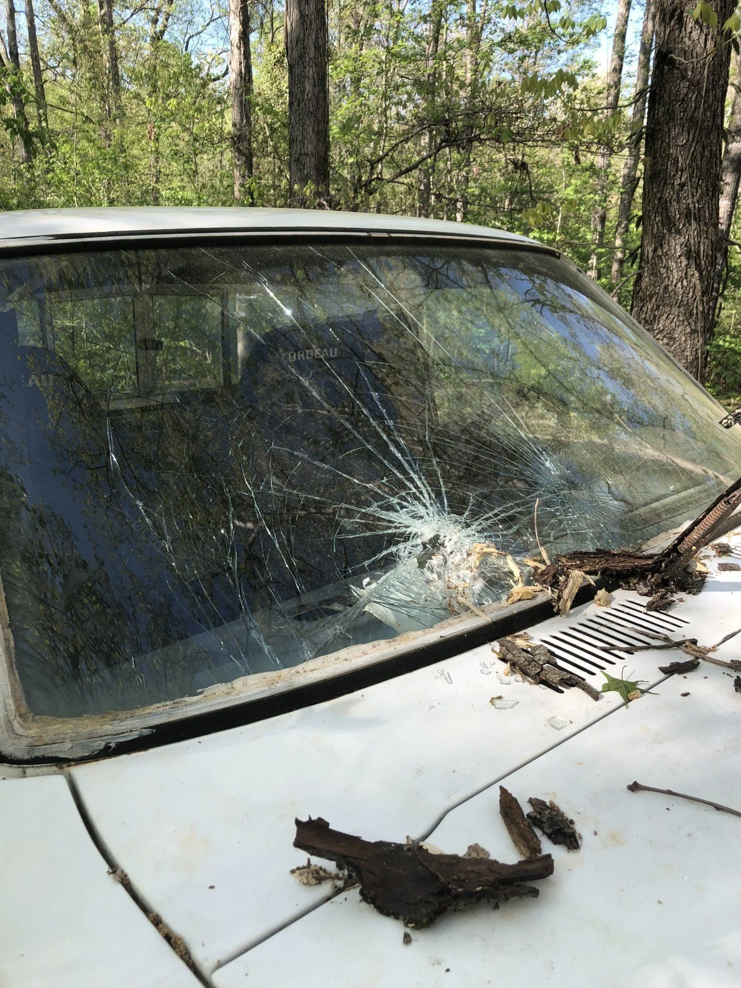

Damn tree branch fell over the weekend :censor: Anybody have any experience with 1st gen windshield repair. I’ve found a couple of threads about doing it at home but wondering if I’d be better off going with someone like Safelite.
It’s easy @tgreco. Replaced the one in the Runner after it decided to flip over without me. Bought the windshield from rockauto and one tube of windshield urethane.

Thanks for the feedback guys. I’ve read that the 2nd gens have a different gasket type that is easier to deal with. This sounded like it required the soapy rope/mig wire/guitar wire trick to get it done. I’ll attempt it first and report back.
That sucks. I thought it was like the Runner glued in.
I just did this on my '81 Trekker, it's straight forward.
Watch some YouTube on it.
The gasket and glass are both available new aftermarket.
If you do call in Safelite ect... at least remove the old glass and gasket so you have a chance to clean up the rust and paint the flange.
Little bit of a pain to get out but not too bad. Ended up cutting the gasket around the windshield and took the glass out and then the rest of the gasket. One small rust hole which was expected given the leaky cab. I’ll give it to Toyota as that sealant stays stuck.
