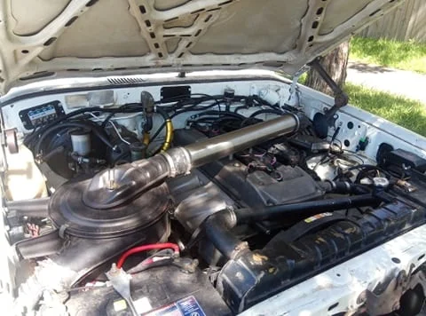

Hows the swap coming along mate? I literally just signed up to this forum to post I have an FG barra swapped 60 series Over on the east coast shes been running sweet for almost 2 years now. I didn't do the swap but i got it off a local bloke to me a couple of months after he finished the swap.
Keen to see how your swap goes!

It's got the H55F with the dellow conversions bellhousing kit.
It's been a great rig absolutely no issues with it mechanically. Did have the fuel pump die on me but being an external bosch 044 was an easy one to replace.
@Noot if you have ay questions or need to see some pictures of how it's all sitting in the 60 let me know I'll try and help out as much as possible

I'm not Noot buuuuutttt. Any photos of 044 location? Throttle pedal bracket?
Thanks :)
Thanks :)
Haha all good you'll have to excuse the mud I got new tyres since going wheeling but haven't given her a bath yet :rofl:
so the fuel pump and the surge tank are tucked up under the drivers side rear guard.
As for the bracket I'm not sure it kinda looks like a custom job
