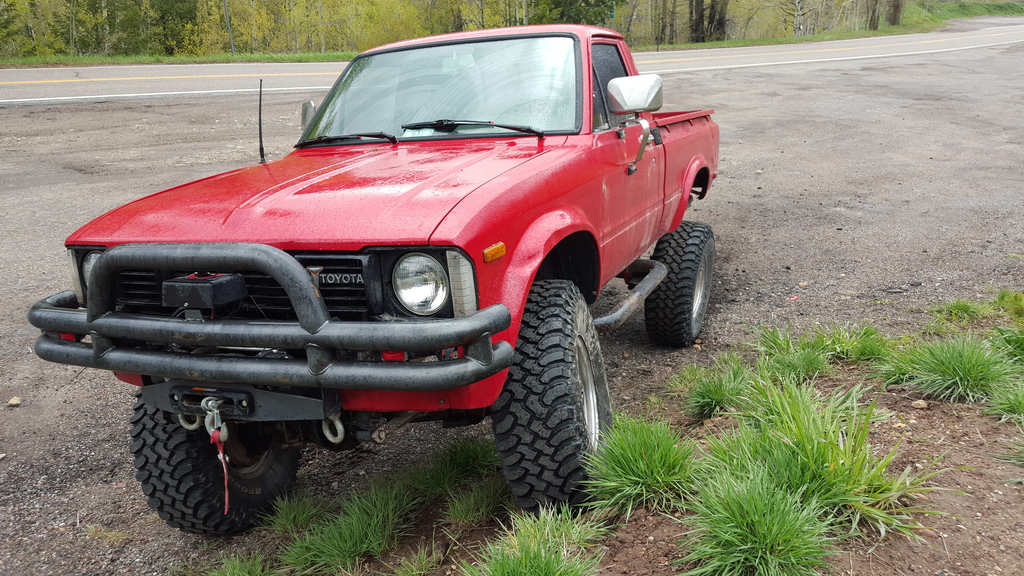

I will order a flat pitman arm next week. I am going to cruise moab in the FJ cruiser and hoping to get some vender deals while I am there. Here are a couple more pics
The 3.4 liter swap was done really clean using the dashboard out of the donor and all the heat is plumed. The motor has ruffly 100,000 miles and runs smooth and quite.

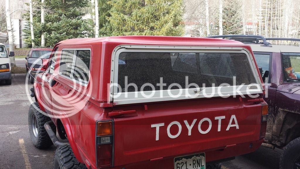

That is the plan for this summer. I don't have a garage so progress is slow. I am also thinking about getting rid of the topper if anyone is interested and in the Colorado.

It is an IFS steering box. It needs a flat pitman arm which I'll order this week. The interior is black out of the same 4 runner that the motor came from. I'll get interior pics tomorrow. The poop pipe is also welded about 2 inches lower than the frame which is why it looks like so much body lift. More pics tomorrow. I'm really on the fence about ditching the topper or not. I love the look but functionally I think an open bed with maybe a roll bar would be better. Decisions decisions.

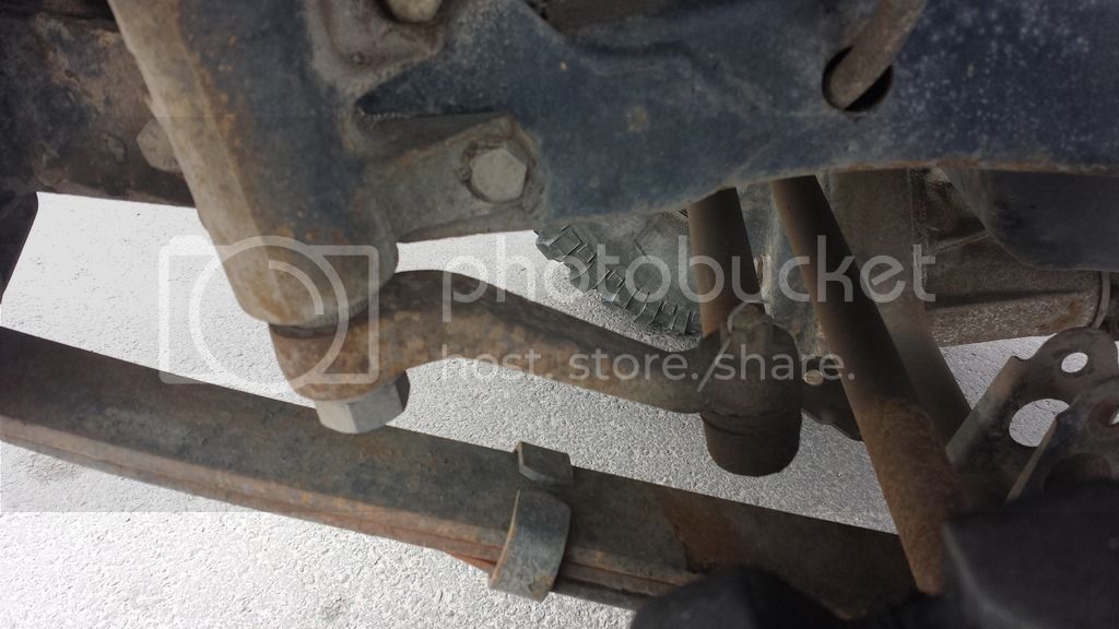

So I haven't had a lot of time to work on this lately(busy work schedual last couple weeks) I did have a chance to really crawl around un it and measure everything. It looks like there is actually a 3 inch body lift, the pitman arm needs to drop to clear the oil pan, The tie rod bottoms out on the oil pan and the rear shocks are fully extended on flat ground. So here is the plan:
Make bump stop extensions and limit the up travel for the front (parts on order)
New shocks and bump stops for the rear (parts on order).
Take the 3 inch body lift out cut it down to 1 inch and reinstall.

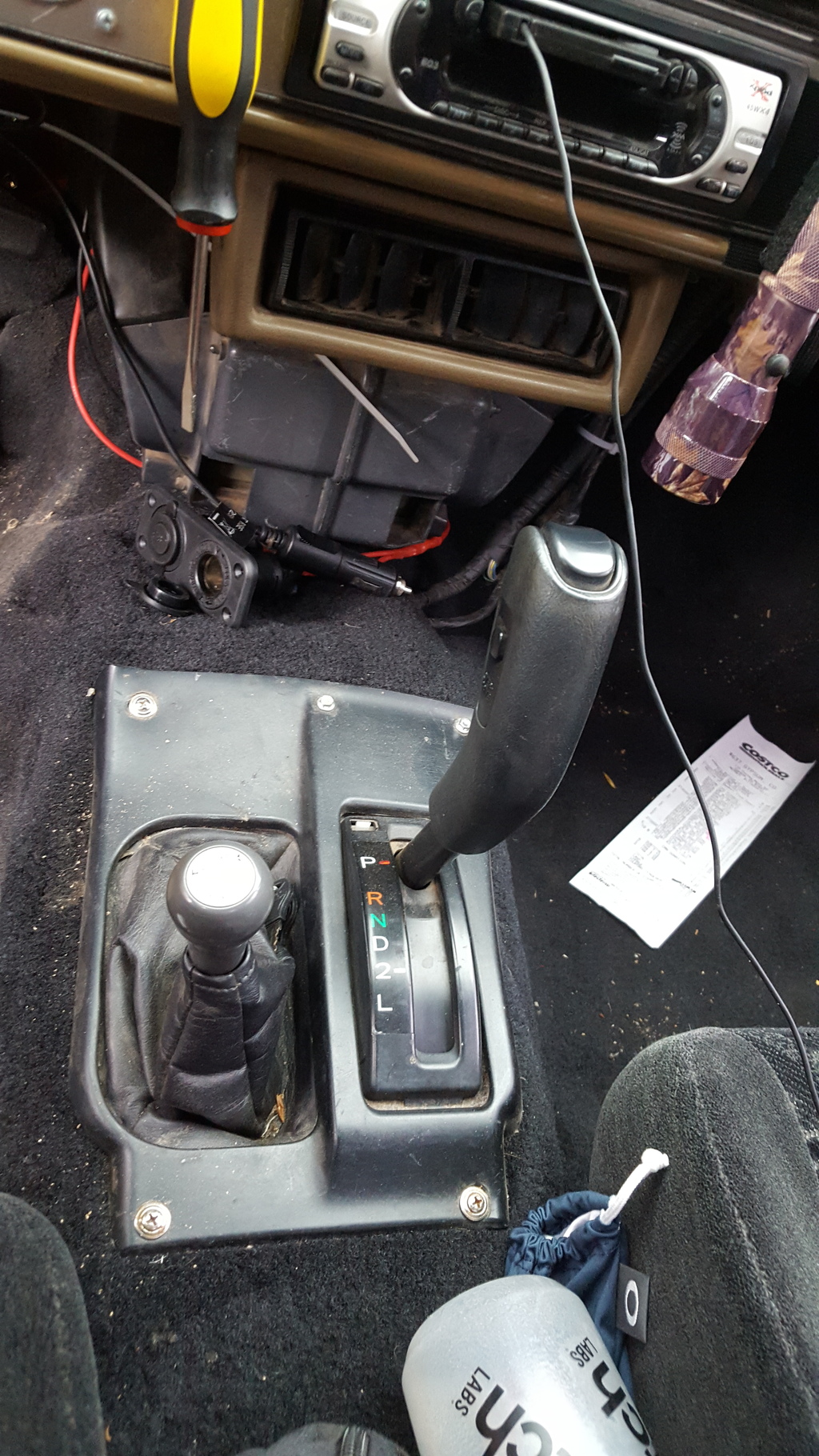

Because every one loves pictures here is one of the shifter set up. The extra wires are from a power outlet I put in it will all be cleaned up next week.

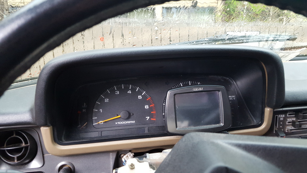

Old school speedo math - 1980 Toyota/4.37 gears = 3100rpm @ 55mph. So based on that, why speedo not work? Electronic input or something?
