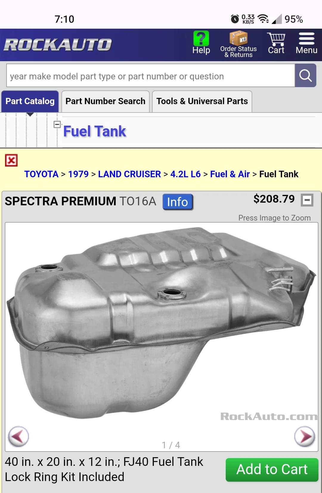

I bought this one from rock auto. I think it is the same as the one from cruiser corps but less than half the price.
One note there is no drain on the bottom of these aftermarket tanks.
I have a really dumb question -
I assume one of the holes on top is attached to the place you put gas into the tank at the gas station - what's the other (big) hole for?
I'm also guessing the big "finger" is the hookup for the gas pump to pull out of the tank - what are the three smaller fingers used for?
As LITP said one of the "big" holes is for sending unit. The other is for fuel pick up and return for fuel pump. The large finger is the overflow on fill nozzle for gas station visits. The three smaller units go to the vapor accumulator(?) that is located behind the cover on passenger side B pillar.
HTH
Doseman
The gas station fill is locted below the large finger. It is hard to see in the picture.
HTH
Doseman
Huge help, thank you! So there's one hole for both pickup and return? Is there some kind of manifold that screws into that port that has an opening for two fuel lines (one going out, one coming back in)? Just trying to visualize this so I know what to ask of the mechanic doing the work.
