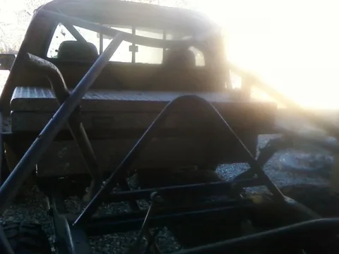

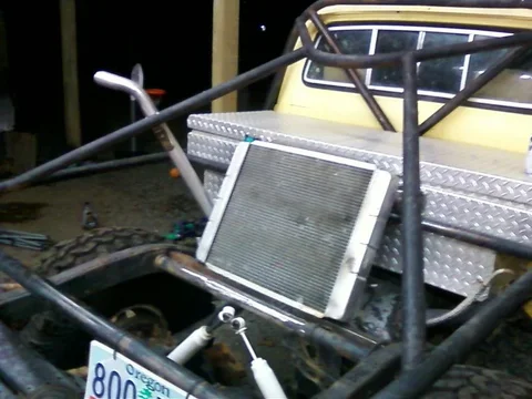

Here is a pic of where the radiator will go.
I mentioned I was going to build a hoop to mount shocks, spare tire, as well as protect the radiator and provide a top radiator mount. Here is the beginning of that.

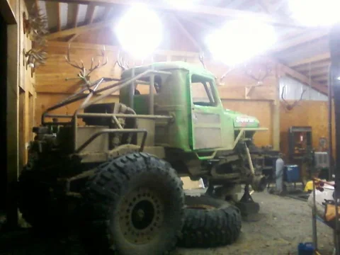

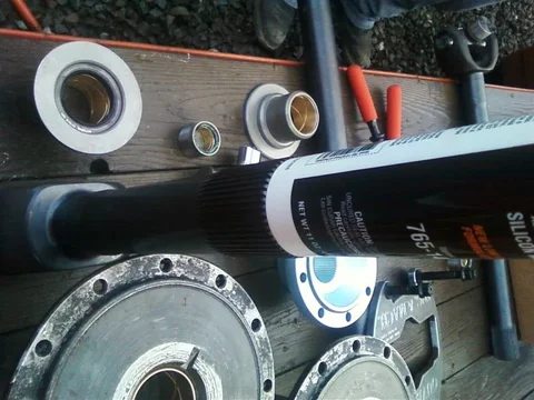

We pulled willy in tonight to tear the front axle back down. Another broken rockwell axle and the other side was pretzeled. We are sending the parts of to get machined now and soon will have a set of 2" gun drilled violator shafts. Should be the end of broken front axles.
yep unfortunately almost on demand.... Rears are the worst and fronts arent much better but with 54s it doesnt take much.... the new shafts are going to be 2" diameter gun drilled. As an fyi they make two front stock axles in a rockwell and one is a ball and joint style kinda similar in a way to our yota birfs and when they break they destroy stuff. We only use the u-joint style.

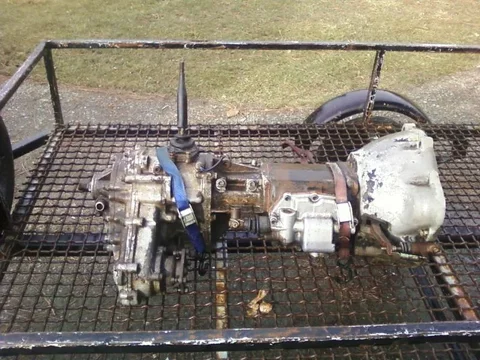

I currently have an r150 with the chain drive behind it. In the corner of the shop I have a top shift reduction box and one other gear drive forward shift case that will have to be modded to a top shift sitting here with the adapter to put them together. Both cases are 21 spline. I have been planning to purchase an adpater for the v6 tranny to gear case as well as the 23 spline adapter which is a solid pretty penny. But now I am having heart burn about putting a 21 spline Seems like I am asking for a weak link or fuse if I may. I am not interested in putting another chunk of my life savings in this thing. I am basically at:
Do I run the chain case that honestly isnt that bad and has a lower reduction as well as shifts on the fly if i was to break they are dime a dozen thanks to the 3.0 and everyone originally thinking they were weak
or
Buy the adapter and install my cases and hope for the best out of the 21 spline second case?
I do rocks about once a year where the dual cases would in deed be nice but for the majority of the vehicles life it lives in mud where dual cases are a waste.
Any thoughts??
If it's a cost issue you should just run what you have (chain case) and if it breaks then worry about the twin stick option. You can always go back and change it if you don't like it.
Honestly, if it's 95% mud you're chasing, I wouldn't bother with duals, 4.7's into your current t-case will cover all your bases for when you need it.
I adapted a r150 behind my v6 so I have the current chain case at the moment. I have 1.5 gear cases laying around here but to install the 4,7s I believe it has to be a gear case. I am still not convinced that my current set up will not suffice for what I do. Normally its simple I would play with it some more and then make a decision but I really need to lengthen my custom tacoma cv driveline unless I am going with the duals then ofcourse I need to shorten it (much simpler!)
So a few things done since last post. We installed the 2" rockwell violator shafts and locker. We tested it on a new years run (i had to ride along as I wasnt able to tackle the dang powersteering line.) Was absolutely insane and surely videos will pop up and if they do I will post a link. There is no way to describe the size of the axle shafts other than saying microscopically larger than a tube of caulk.

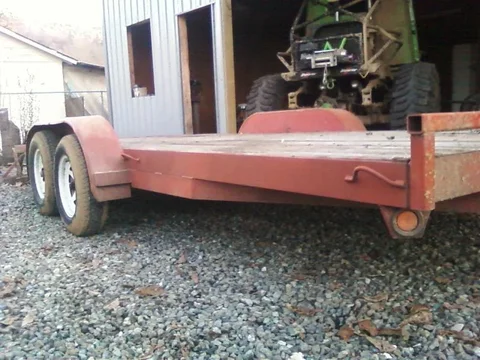

I purchased a trailer a few weeks ago in order to be able to trailer the yota.

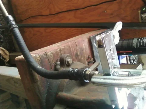

I also posted a new thread and got some good info from ferg (thanks again) and was able to use a chevy powersteering hose and just reflare it and use the toyota thread on one end. The yota thread is the same thread pitch as the chevy side but is longer..... Done deal and money saved but more importantly time and insanity.
So as mentioned earlier I am leaning away from the doubler.... One of the reasons I tell myself is that I have 2 forward shift tcases and only one top shift reduction half.... So I would have to source another top shift or pay the 100 bucks for the conversion (not going to happen would try to do it myself first)..... And then bam tranny and top shift tcase for 20 bucks today... Has to be a sign right??? :)
I fought the power steering trying to get pressure... I tried every trick in the book. I finally gave up and replaced the mystery to me saginaw pump. When I removed the reservoir one of the metal ball bearings was stuck to the magnet. We cleaned everything up, installed the new pump, primed it and bingo done deal power steering.

Now you just need to start shopping for one more tcase that looks identical to that. You need two top shift cases. It is possible to mod a forward shift cases rails but i didnt want to tackle it. Also I will be emailing you before too long I still need that O2 sensor!
I haven't looked into it that much since it's a ways off for me but I was thinking that I could just get a 5 speed trans/transfer and use the transfer off of it mated to the one I have now. Not true? Or, do you have to have the adapters and all that jazz?
