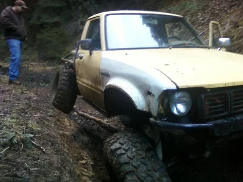

So finally made it to the run without breaking down. I still battled the power steering a little even with the dinky cooler and the atf. Anytime I really put the steering to work (not binds just constant trail use) it would whine. It also pushed some of it out the top but I did have it overfilled. It rode a lot better with the winch stored in the rear. I was pleased with the flex and tires cleared everything. I was most impressed with the fact that we pulled a wicked climb that was steeper than your picturing right now and I was able to use 2nd low. Once I even tried 3rd low and I could let the motor pull down close to dieing, crest the bump, step into it and regain. I cant wait for some rain around here as wheel speed should not be an issue.

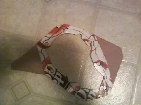

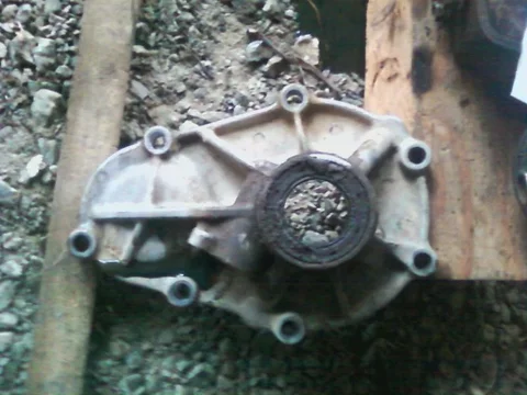

I decided to pull the back off of one of my gear cases and make a template for a t-case crossmember. I only used little wings vs the full crossmember as I want to conserve plate and utilize other methods such as round or square tube.
Diet doctor pepper boxes work great! The first pepsi box didnt work worth a crud :D

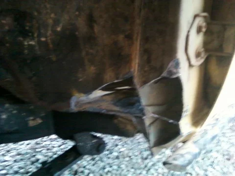

As mentioned the additional 1.25" forward on the front axle in addition t what the rear springs already do was just too much for me. When I flex and stuff a tire the bump stops stop the spring right at flat but there is a hell of an S wrap in the spring. I can only imagine when I get to hogging on it the front is going to hop like heck. I moved the axle back the 1.25 and flexed it again and they stay flat. I had moved the front forward to clear the cab corner which I had already chopped and plated once. Now I am cutting more. I had to cut even more after this picture! It is tight to the cab mount now.

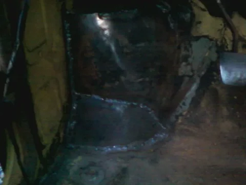

Nope sure dont. My goal this entire time has been not to lift it anymore than I have to. I wanted to keep my center of gravity as low as i could with this yota. I have been able to maintain very good approach angles due to bumper designs as well as axle locations despite the low height. My belly clearance is decent thanks to the non stock crossmember. I tried to install my drivetrain as high as I could to ensure I had steering linkage clearance which seemed to have worked well. I only have about 3.5" of uptravel but all kinds of droop. I would like to get to about 4.5" of up travel before I am done. The 3.5 doesnt sound like much but that is at the frame so the 39.5s will actually tuck up inside the front fenders a little on stuff. It allows me to stop the springs right at flat. I will grab a picture soon of the current cut on the cab corners. It is rediculous and is tight to the body mount. But I have accomplished my goal and it really doesnt bother me inside the cab as there is a ton of room over in the corners

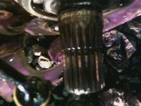

So i finished the second round of patches on my cab corners today. there is nothing left the tire will hit the body mount before it hits anything else. We relocated the electronic fuel pump to back by the tank where it should be as I cheated temporarily and it almost left me stranded twice already. I ordered longfields 30 spline shafts today as well as hub gears. I also picked up my 23 spline coupler for my doubler. We have a large run tomorrow I should have some pics. It looks like my membership just expired so looks like I better dig up some money tomorrow for that as well.

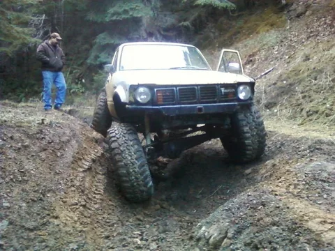

Thanks it really did its job today. I laid it on its side in an iinsane ditch thing and mashed a fender, the door (door will be fine) and broke a mirror all to heck. I was overly pleased with everything today the 4.3 was insane and pulled a crowd quickly. I will try to post some video. 3rd gear low range throws a few chunks
