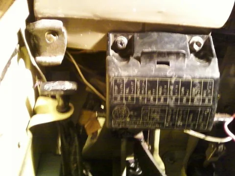

I was sick and tired of fighting the round glass bus fuses. I could not get a good contact no matter how many times I cleaned them infact I broke one tab off and one was already broke when I got it. I picked up a newer stock square fuse block. I do not have my paperwork with me but it had like 9 power feeds/circuits vs. 5 that the round fuse block had. I ended up combining a few circuits exactly as the round block had done. It should work good for me as I have not loaded any circuits harder than the stock 1980 had. I just climbed in the house from finishing it. I was able to figure out that part of my fight was a bad park light relay.
Very nice!
I've played with just about every inch of wiring in my first gen, and I gotta say, the harness in this truck is one of the best layed out ones I've seen, and that block is just idiot proof.

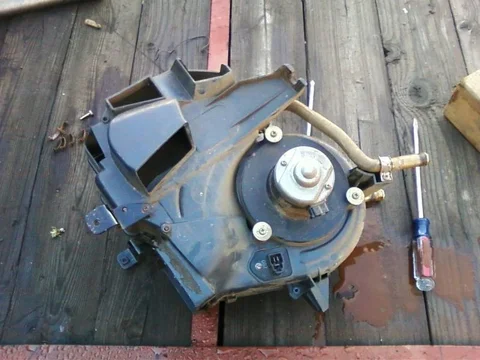

So even though I had the heater box out the other day and found that screw holding the door open I was an idiot and chose not to break it apart. Now that it is back in I just do not feel it is blowing as hard as it should. I manually checked the doors and forced them shut tight. I chose to tear it back out today and pull the heater core to ensure it isnt covered in leaves or mouse crap.

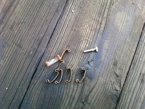

It is very similar to the one I rebuilt for my fj40. When I did that one I replaced all of the felt stuff but not this one. A few clips and one screw is all that holds it together.
Unfortunately the heater core was pretty clean. I cleaned what I could and blew some dust out of between the cores. It blows a little harder but not crazy. The squirrel cage looked fine as well. I guess you get what you get.... :meh: It isnt terrible I just thought it should blow harder as it blows hard on vent setting....

This thinga majigor is toast. The only setting that works for me is HIGH. Correct me if I am wrong though that has nothing to do with it not blowing as hard as I would like because HIGH doesnt use it so High isnt effected right??

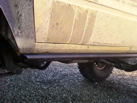

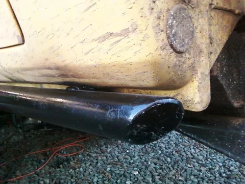

So I have been dieing to get some kind of rock slider on there before I crush in below the door. I wanted something simple and low profile. I hate when the protection is so large it becomes a hinderance. I started with a hole saw to try and half notch the cab but it didnt take me long to break the drill bit so heck with that where is the sledge hammer.... I still want to add one more for strength in the center but it got dark on me.
