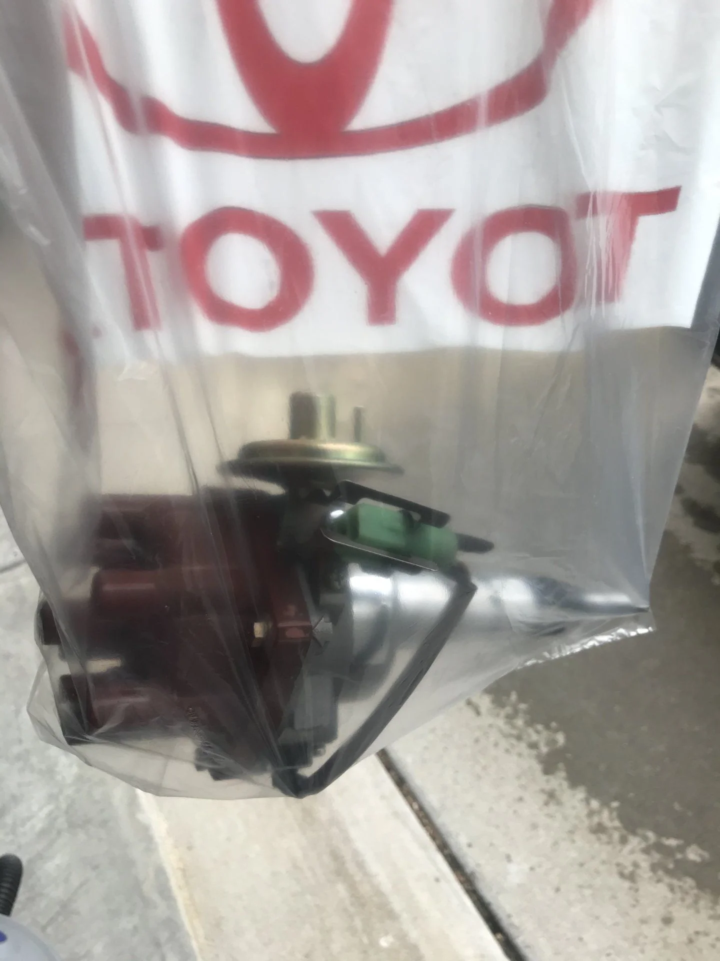

I just bought a rebuilt distributor from him with a new advance diaphram on it. You'll want to cap off your retard vacuum line as the new diaphram will only have the advance on it. It's not needed for performance only emissions.

I just bought a rebuilt distributor from him with a new advance diaphram on it. You'll want to cap off your retard vacuum line as the new diaphram will only have the advance on it. It's not needed for performance only emissions.View attachment 2279855
thanks for the info. I'll reach out. maybe they can shed some light on my present dizzy. would love to have the timing control setup. let me know how yours works.
