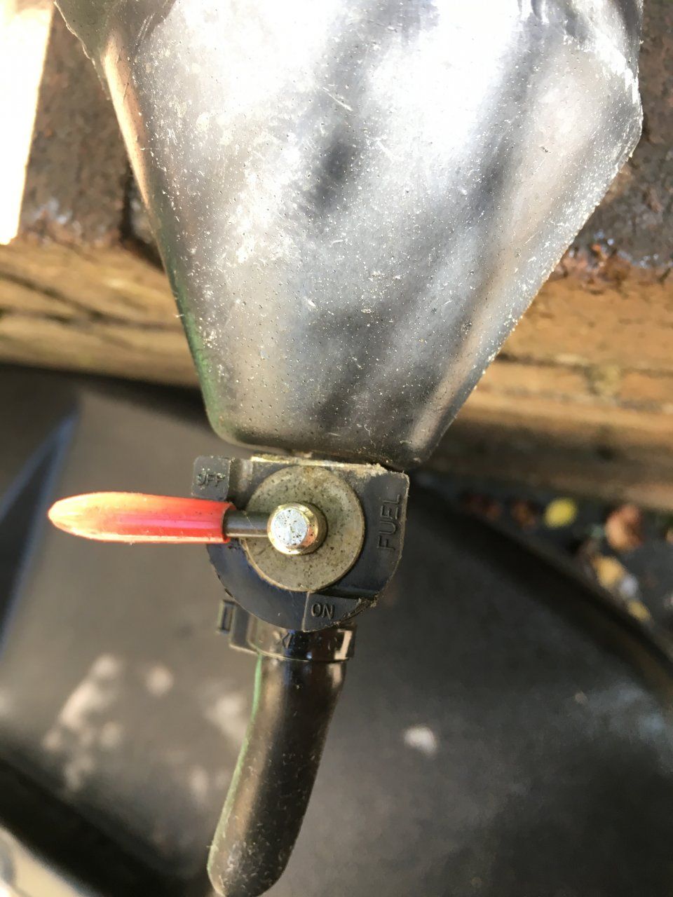

I found this hose hanging behind the dash and tracked it back to what looks like a Radiator overflow. I wonder if this hose is supposed to be for my washer hose which Is missing.

I'm not sure mine is the correct overflow. Mine does have a valve on the bottom of the overflow.
I have no clue what you have. Every over flow I have seen has the line from the radiator going to the bottom of the expansion/overflow tank. That way extra fluid goes from the rad to the tank when hot. When the system cools it sucks it back into the rad.
Perhaps it is mounted upside down and the part going to the dash is in case the expansion tank overfills. That would make better sense.

I've never seen an overflow like the OP's, but it looks like it's mounted to the 'normal' overflow/washer fluid bracket.
Edit: Actually, on closer examination, it appears the OP's is set up to overflow to the black bottle and pump out the bottom of the black bottle thru the clear hose... Which could indicate that some PO was washing the windshield with overflow coolant... If the clear line actually feeds to the washer nozzles...

I have already found a few places that sell the washer kit and thankfully I have the bracket. Is the current overflow an actual FJ40 part?
OP, that is definitely not a stock over flow bottle.
Dbaird has the stock overflow bottle/WW fluid bottle, but it is in the wrong location (opposite side of the engine bay).
The short hose in the glove box should go up into the windshield frame. You could probably feel the hard line it attaches to above the right side of the top of the glove box.
Update. First I removed the old "overflow" still not sure what it is.

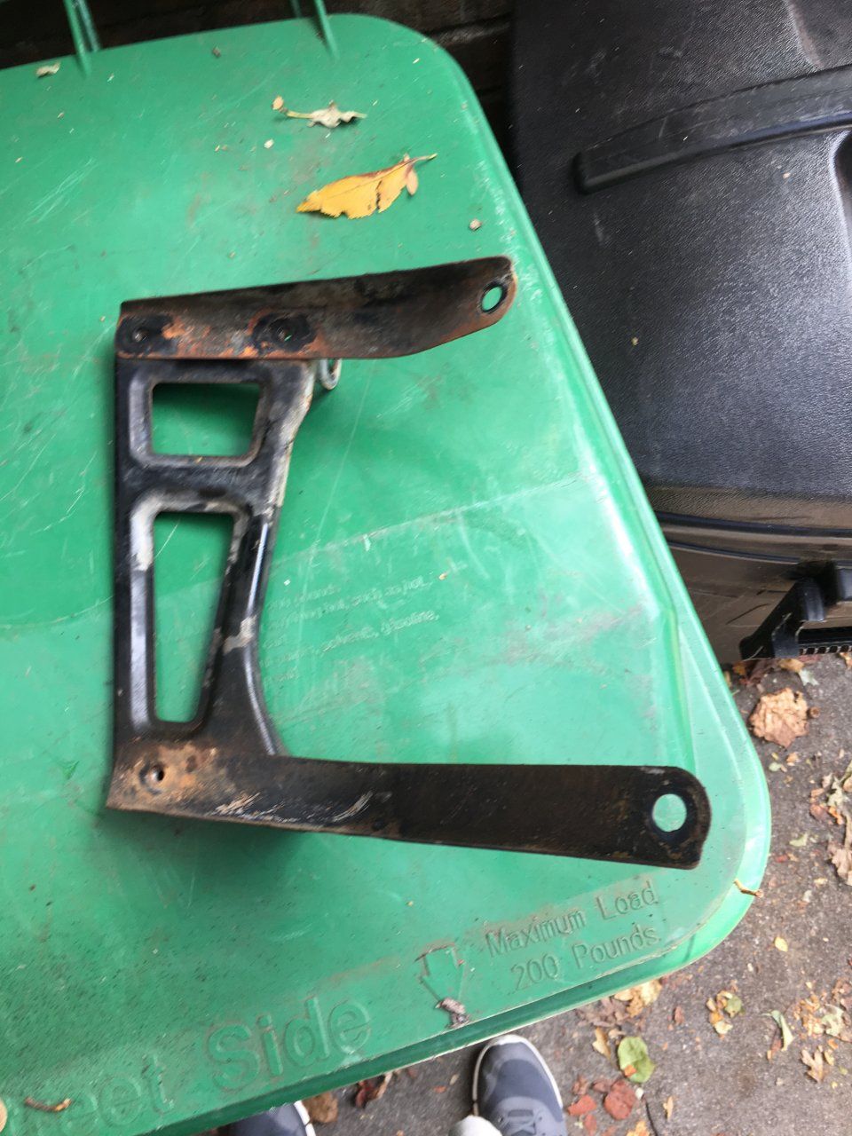

Pulled the bracket to get ready for paint. Now time to spend money at cityracer.
