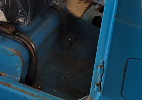

Also, I just noticed that the floor pan on the passenger side of the tub does not have the perch that the center seat bracket (the bar that has the front inside mounts for the driver and passenger side seats) sits on.
This is an image of the perch I am referencing- next to the transmission hump (I grabbed this image from another post). Any information on where to find that perch, or if anyone has made one and has proper dimensions?

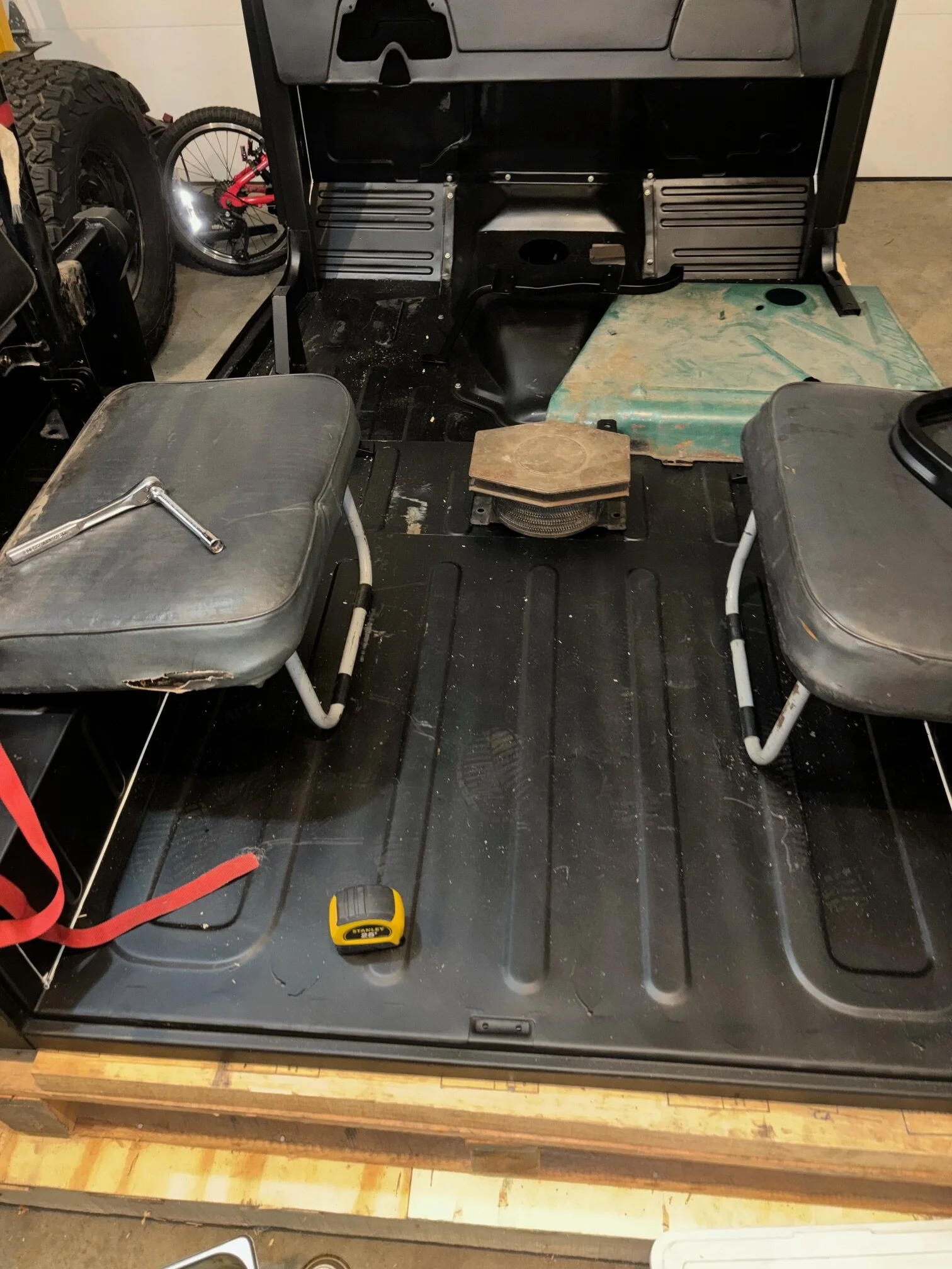

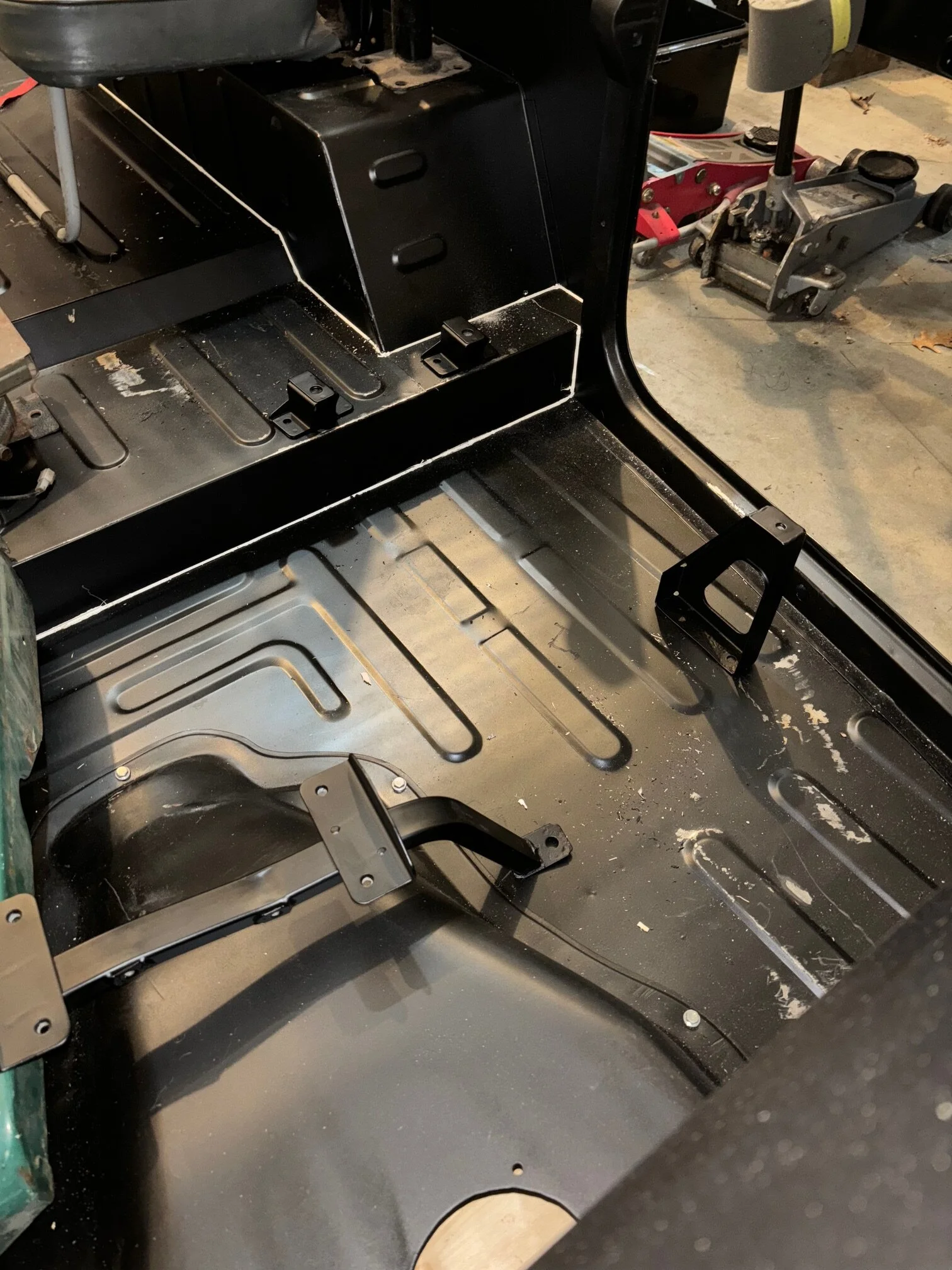

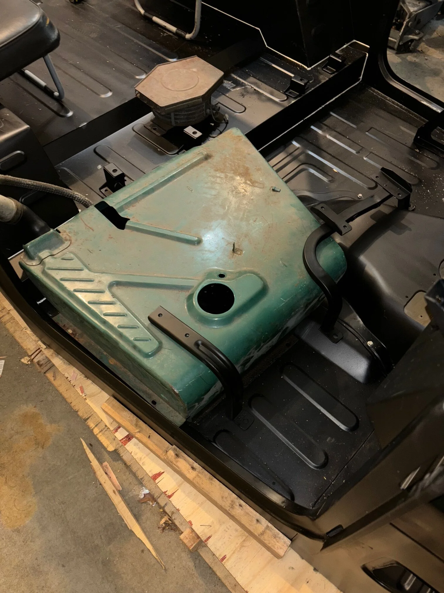

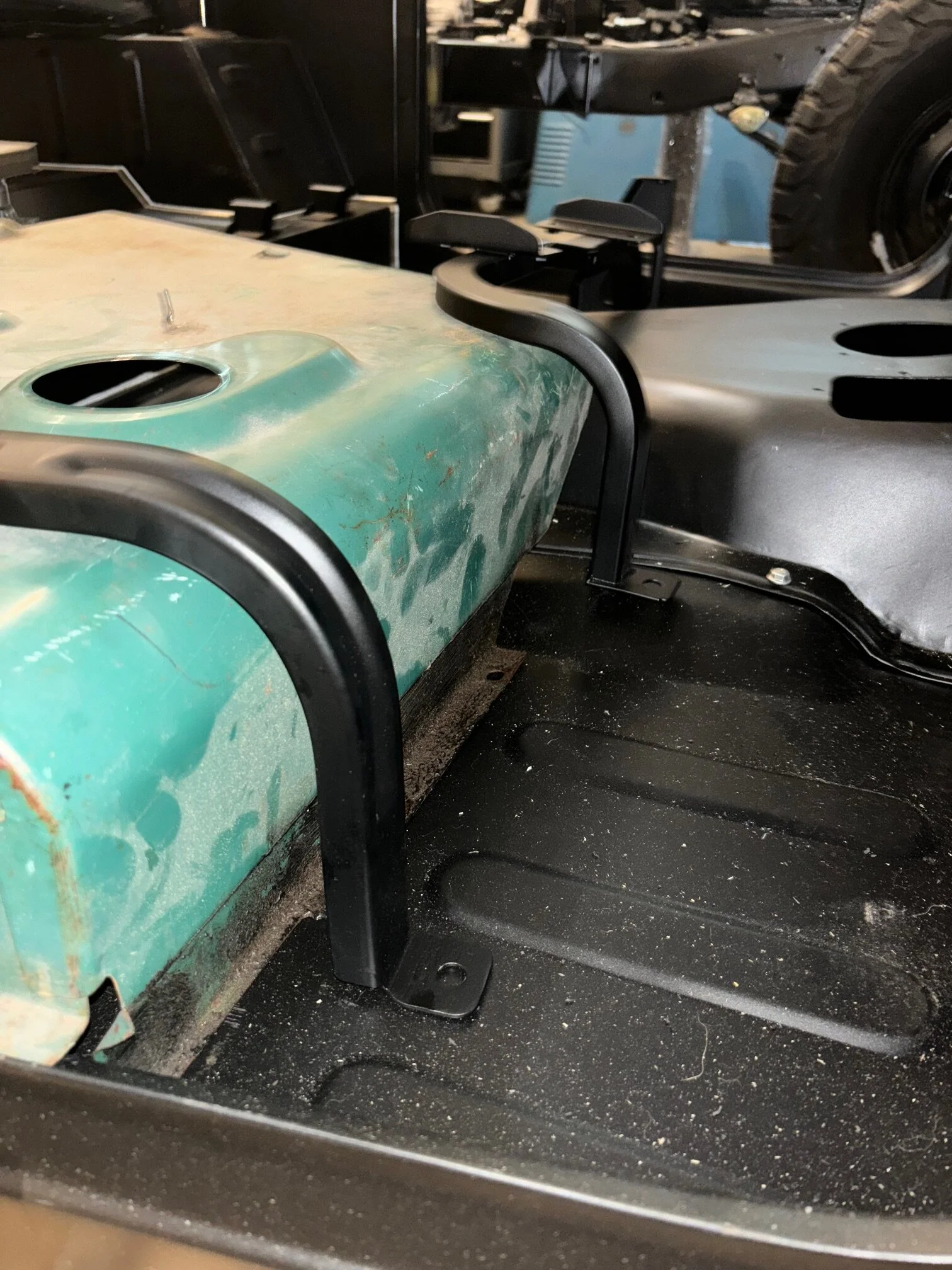

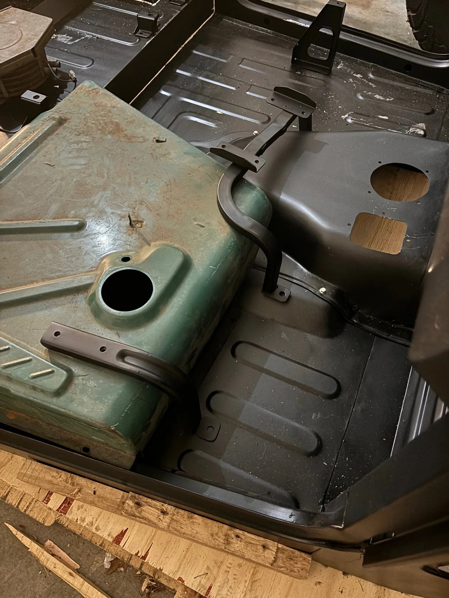

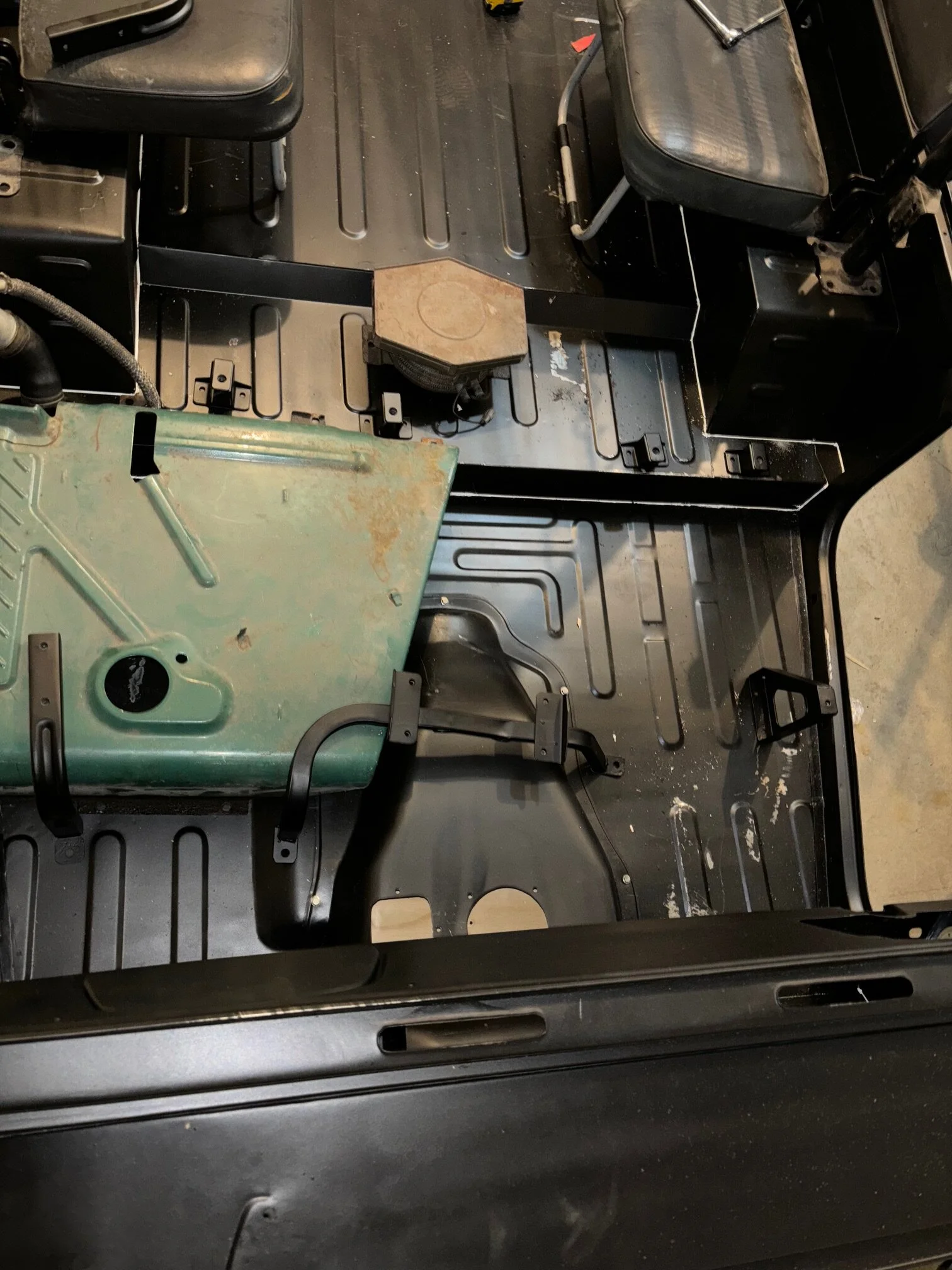

I have a nice clean tub here I can take some measurements off of and post. maybe post some pictures of what you are working with?
Thanks Matt, here are some photos. Just looking to drill all holes and get as much as i can mocked up before the tub gets stripped for body / paint. I have the original seat mounting stuff which you can see just kinda laid out in the photos.
