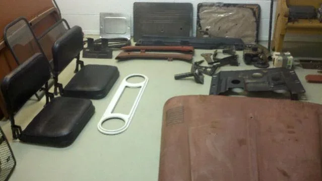

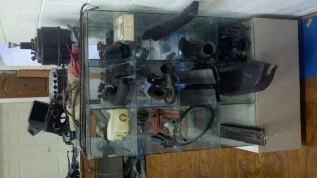

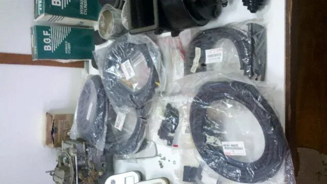

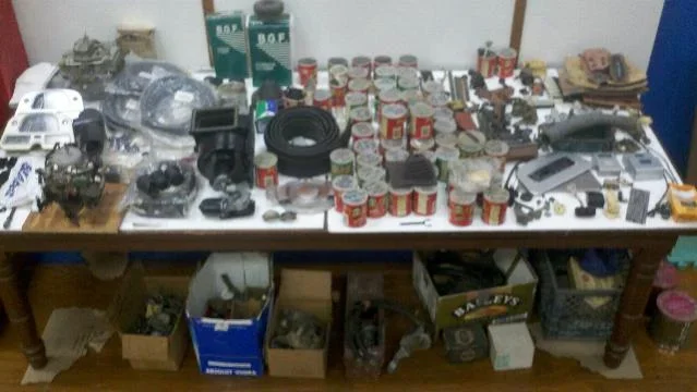

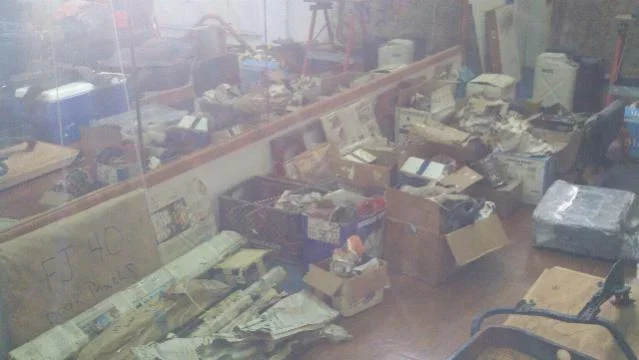

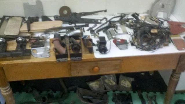

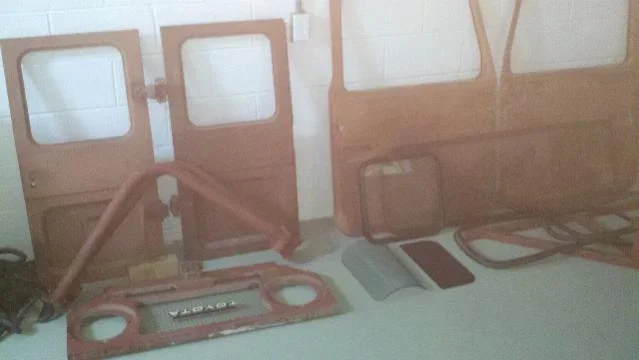

So it's time to start unwrapping. Just getting started.
This is what's left. Just unwrapping and seeing what I have. If you are around south central Ky swing by. It's Christmas in March. Oh and the stove, kayak, cooler, and Dan isn't fj stuff but just about everything else is. Stay tuned........
I would go for a 1978 color..

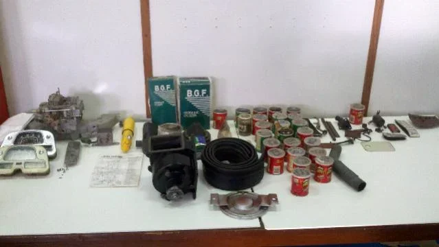

Holy macaroni !!! :eek: That's a lot of parts. You can start an ebay store and sell, you'd make good money.
Lot's of Pringles too
I have never seen so many pringles cans in all my life. I just love that all are full of parts and labeled..... I also have more glass and the hard white top that I didn't get pics of. I have decided I am going GREEN (original color) on this one....... Wheels are going to be traded for some factory ones.
