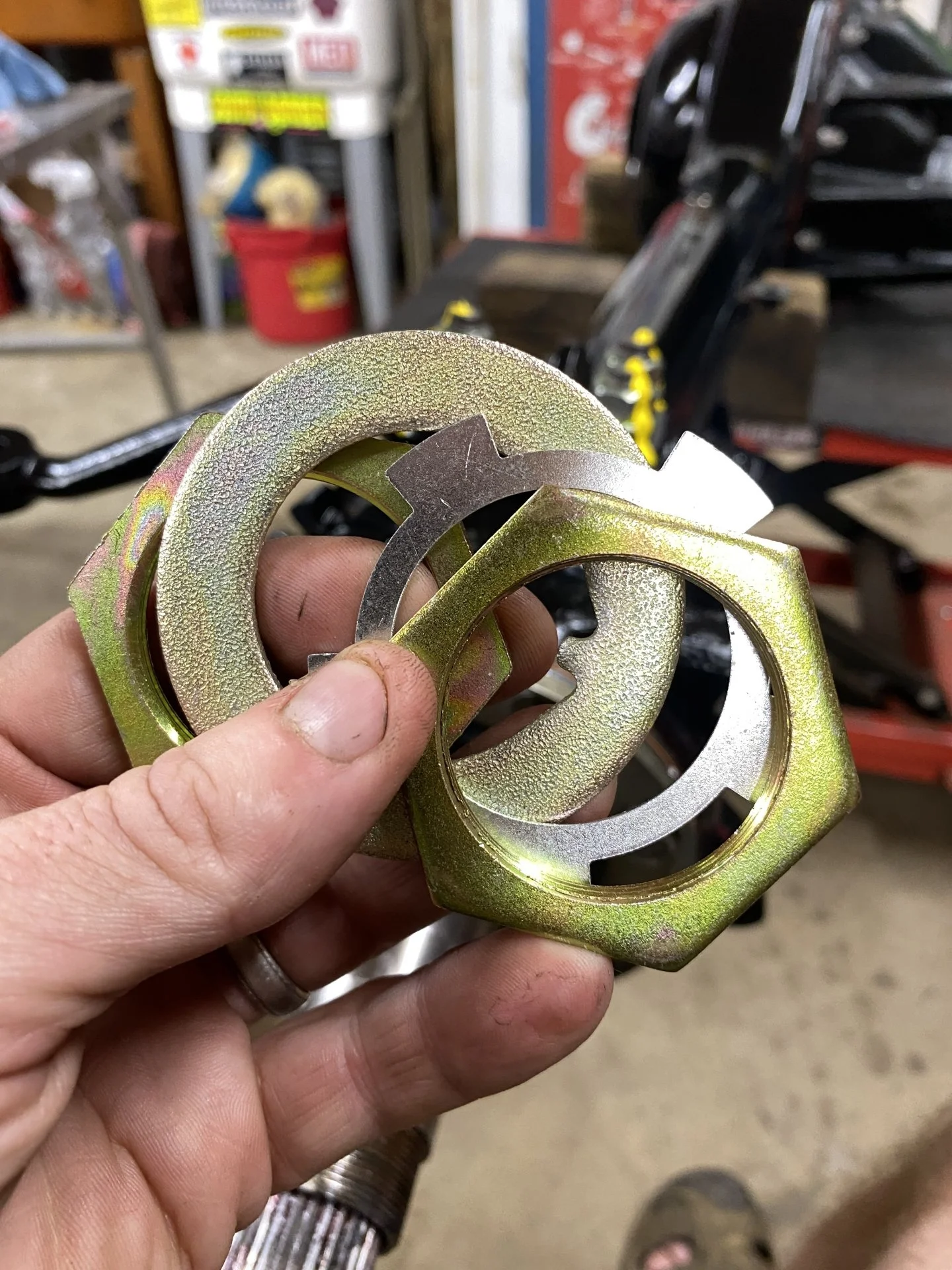

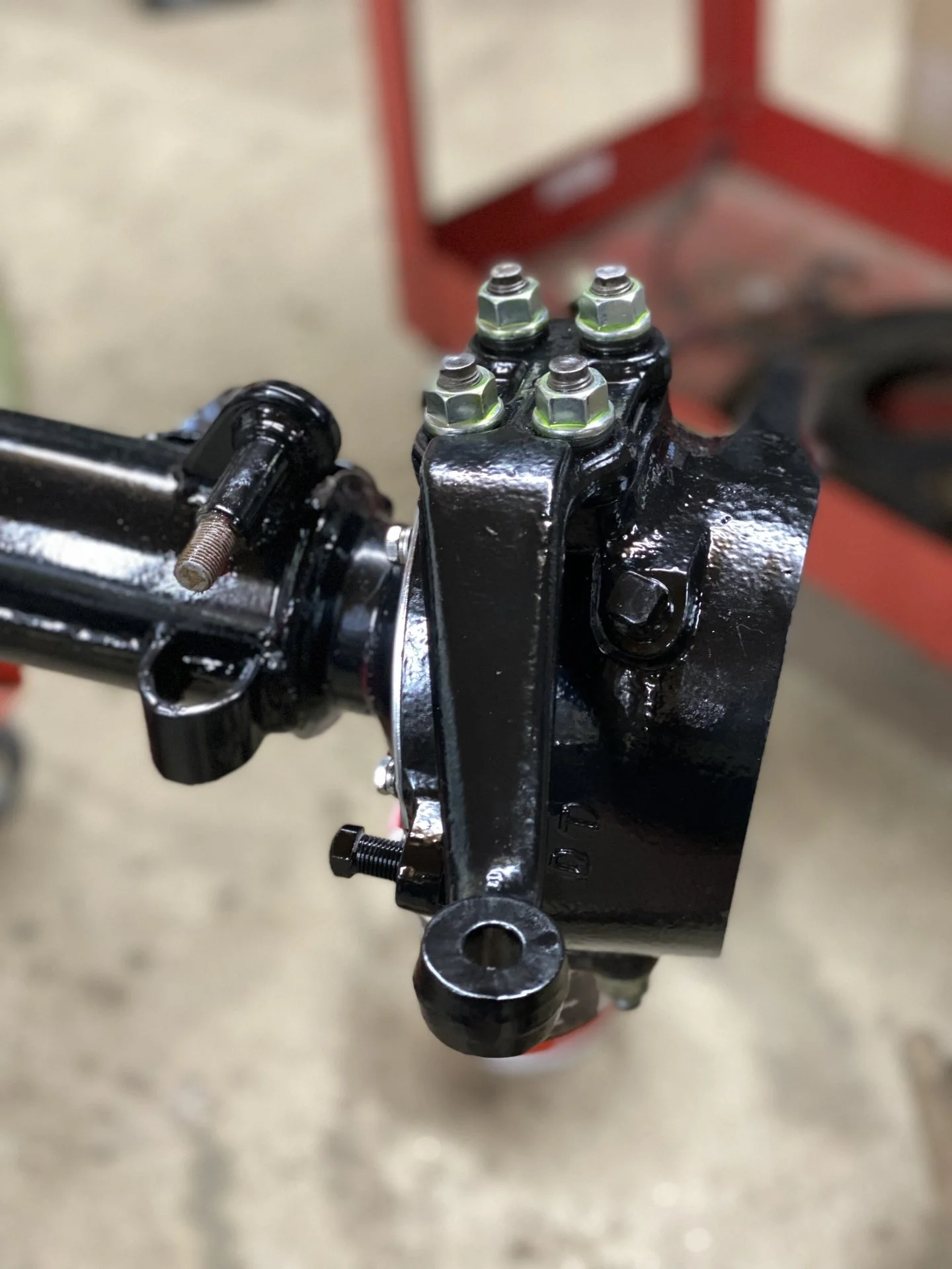

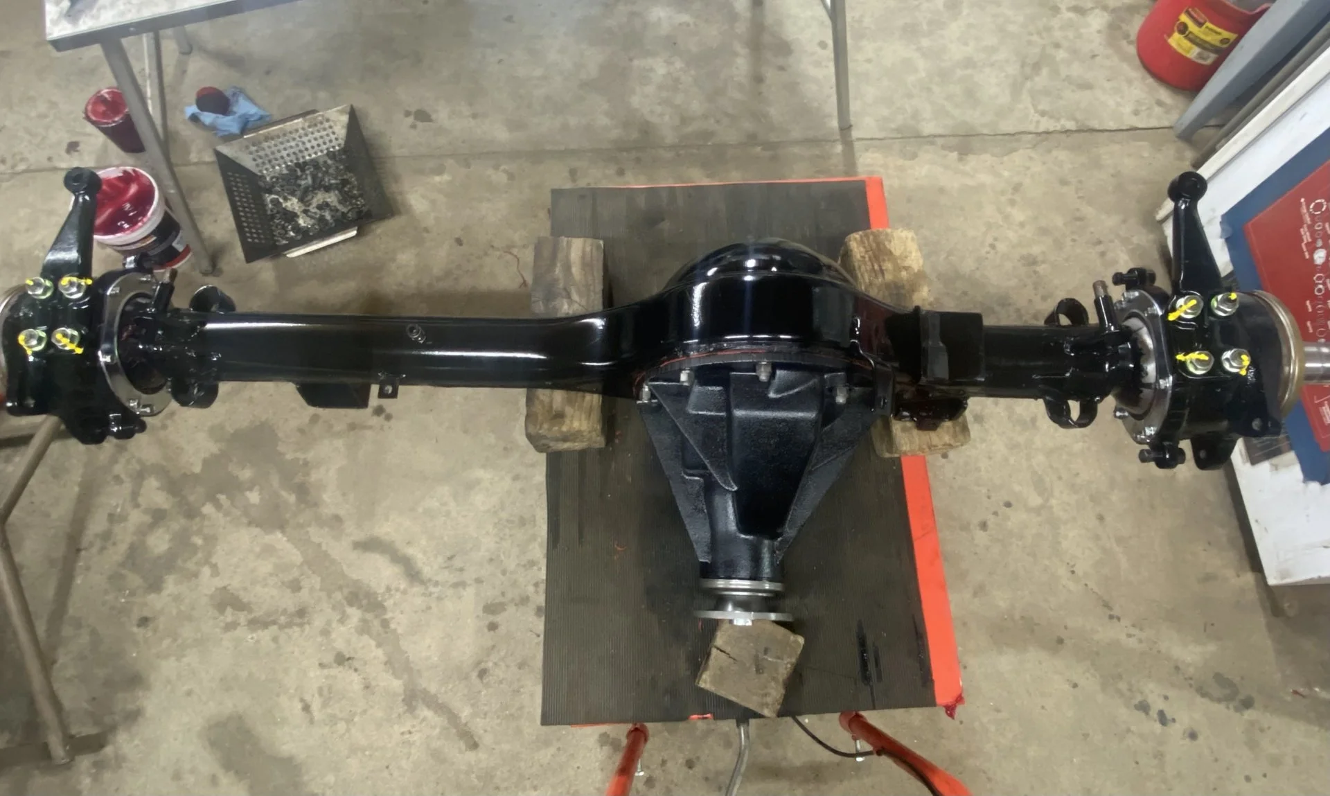

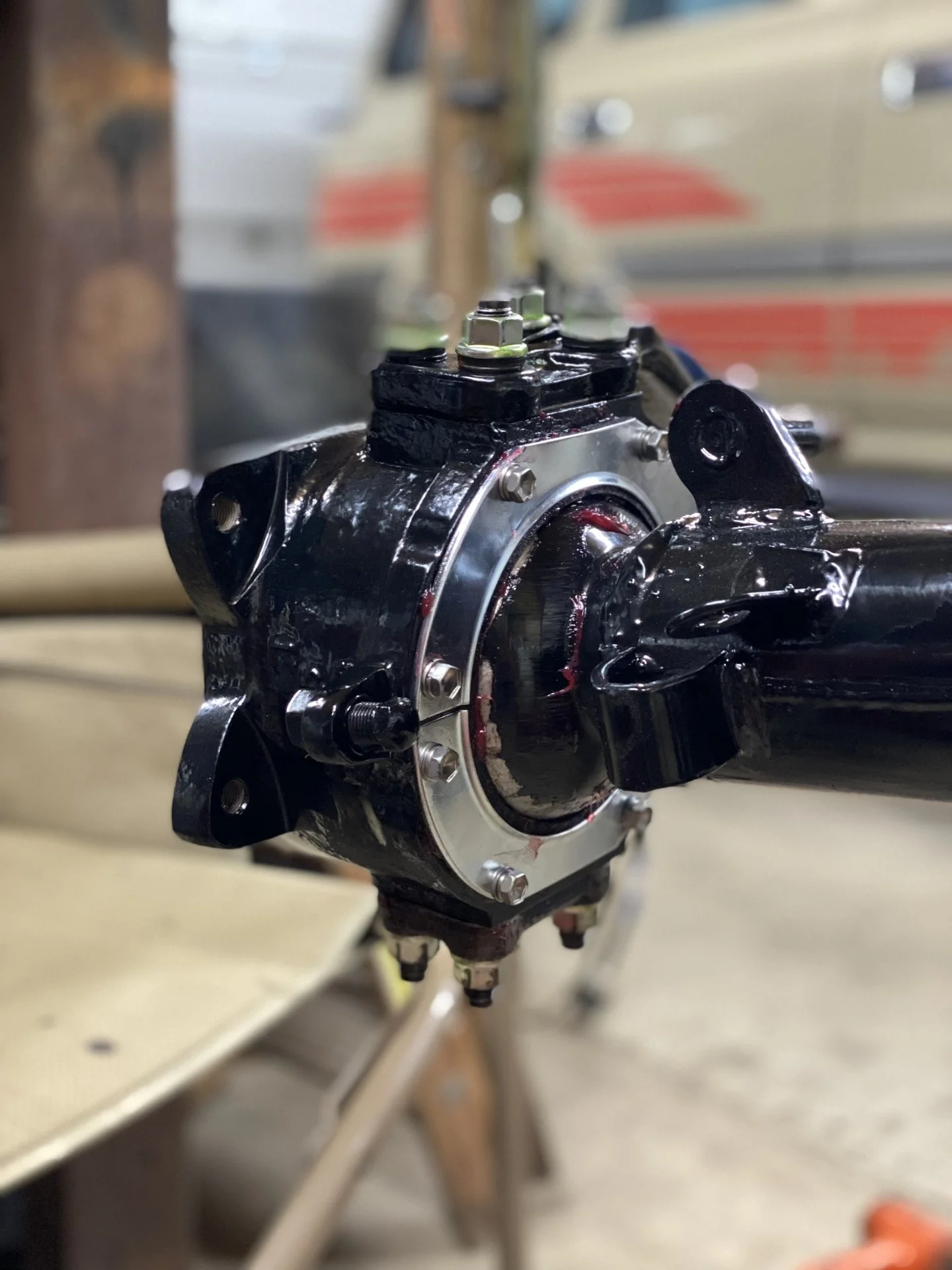

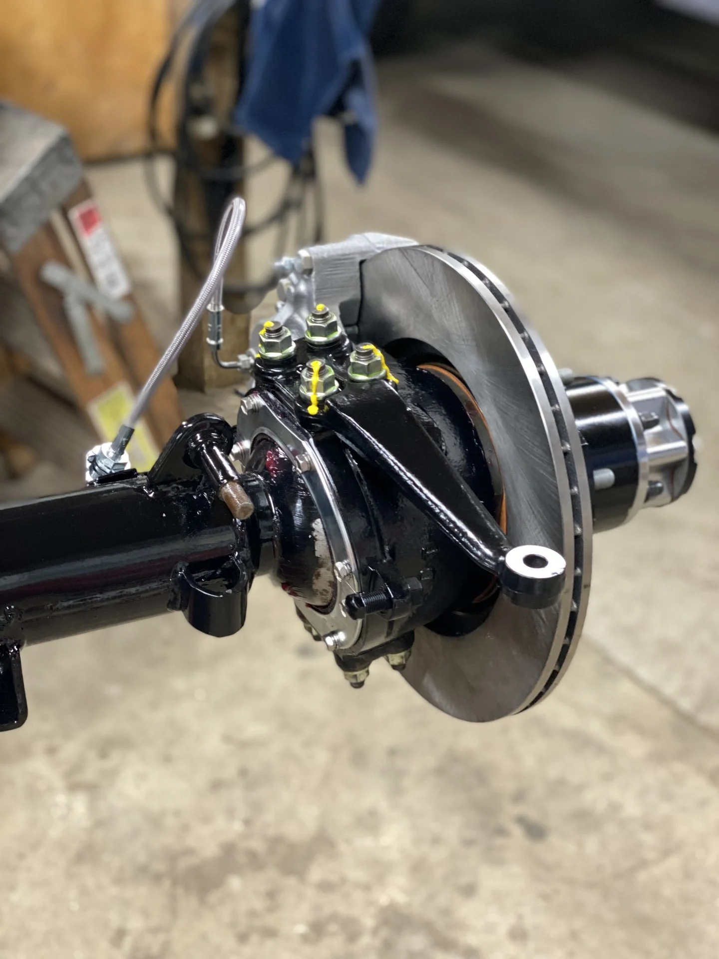

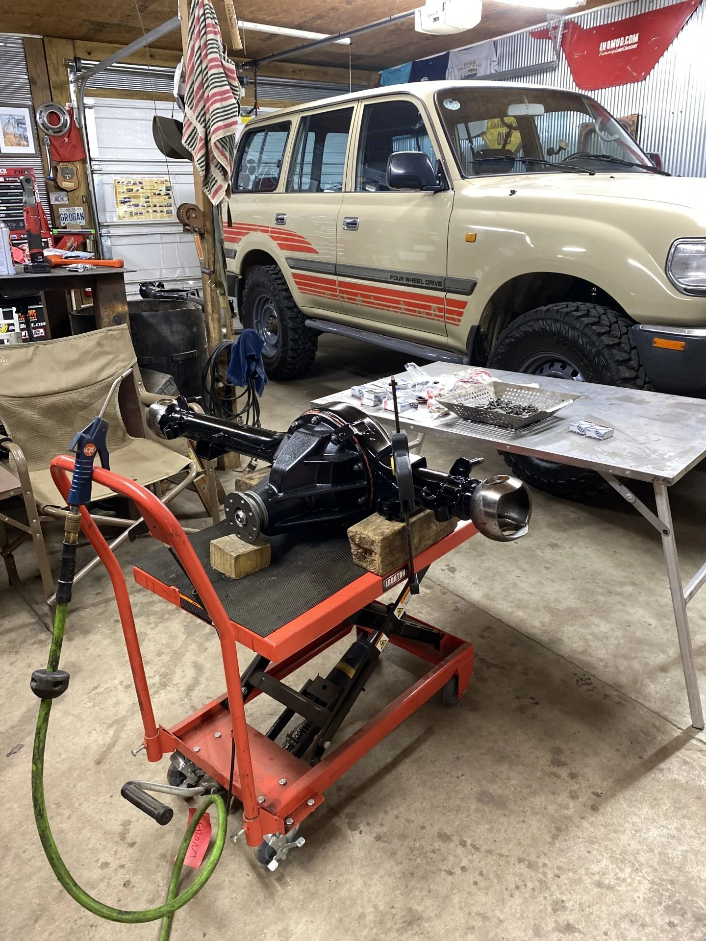

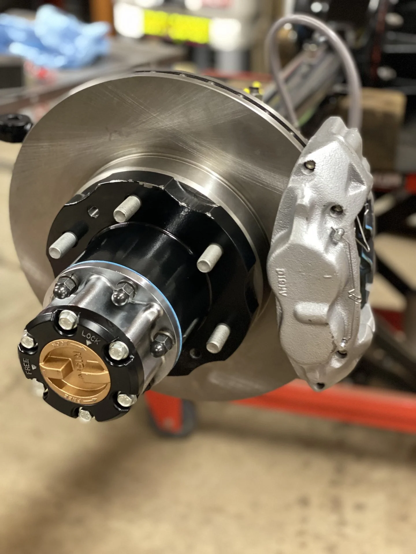

Assembly time for the front using my favorite knuckle kit via @orangefj45 …. Sumo Gear.
Auburn LSDs front and rear

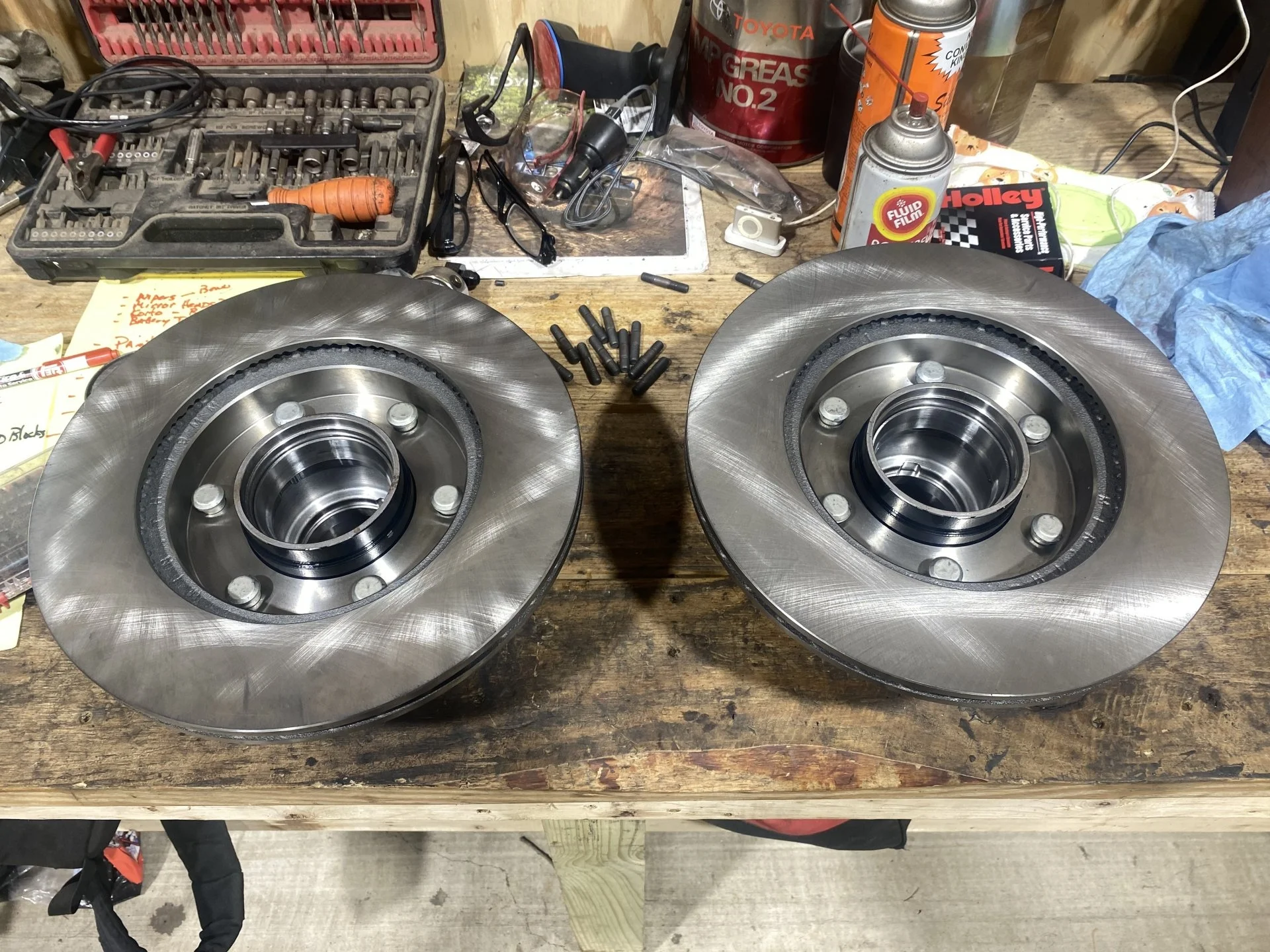

This is the first time I’ve ever used a set of new hubs via @Racer65. The races went in perfectly as did the wheel studs and hub studs. Very nice pieces. Highly recommend.

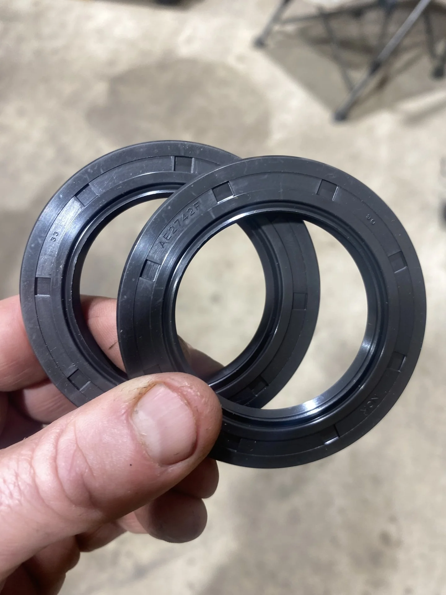

The Sumo knuckle kit comes with rear semi float axle seals which is a nice touch and also new 54mm nuts which I love.
Dang, I’m usually ok with my half-@ss work but then I look at one of these threads and get both depressed (with myself) and impressed (with the builder). Those yellow wax line thingys remind me of the seals used on important letters 😆.

@wngrog had that color matched to the truck.

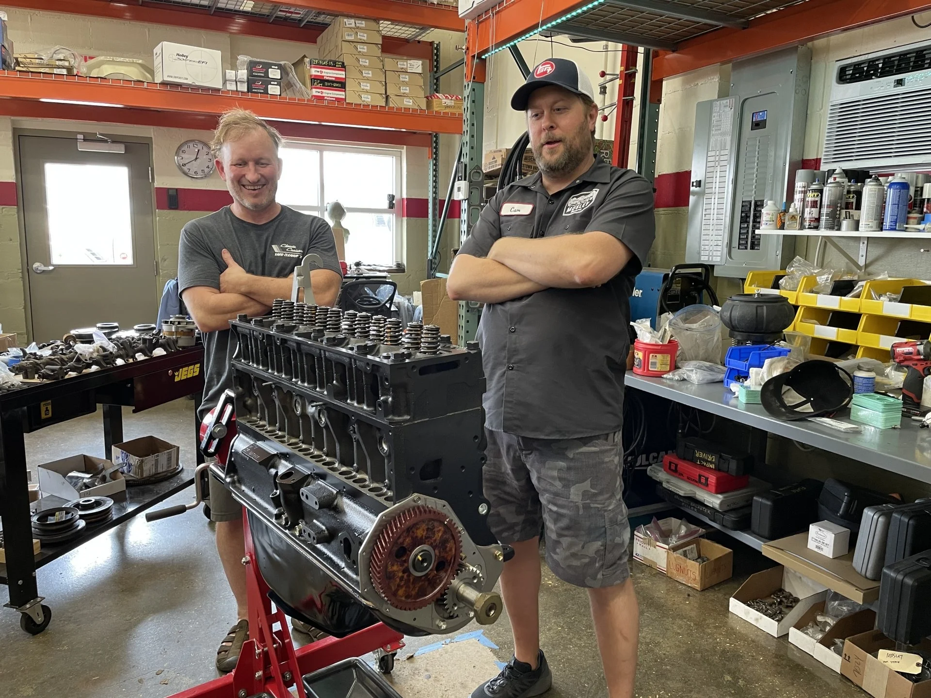

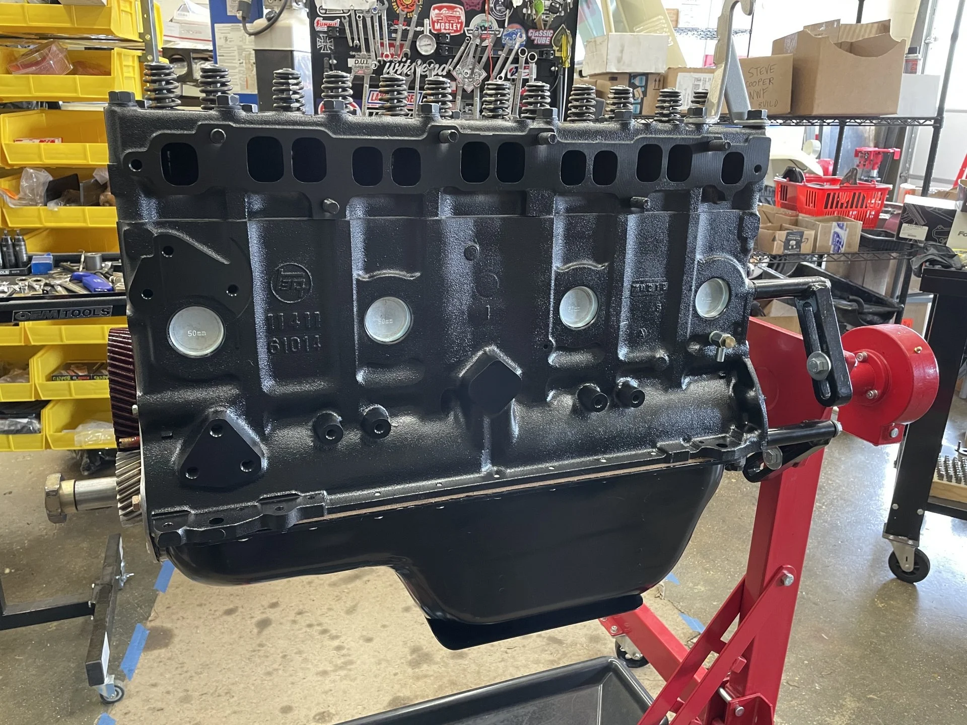

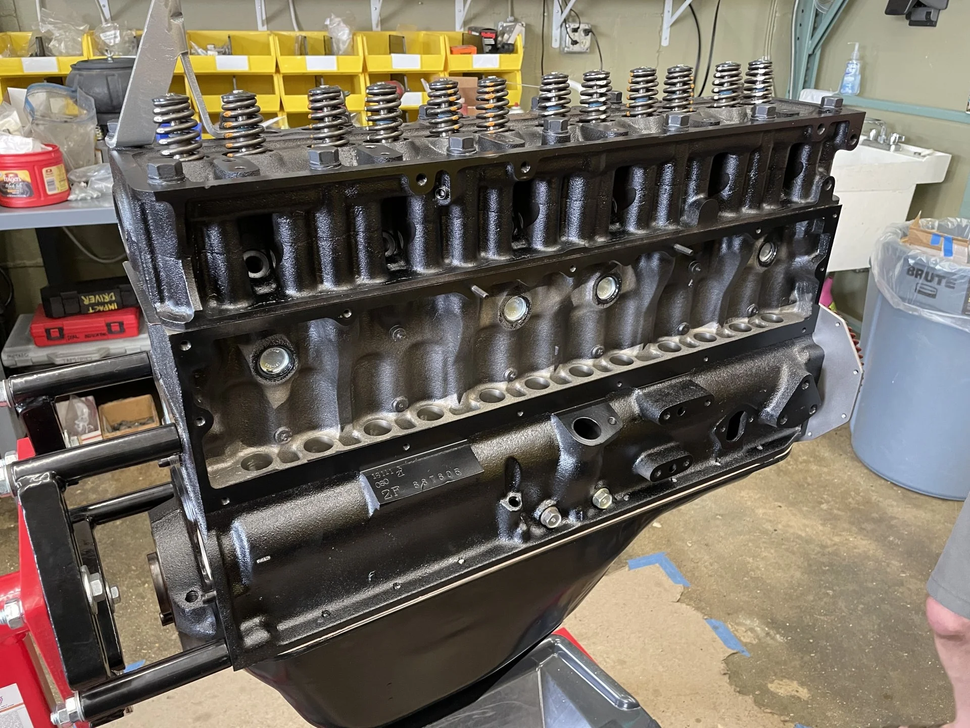

I’ve been slacking on the updates but here’s a few pics.

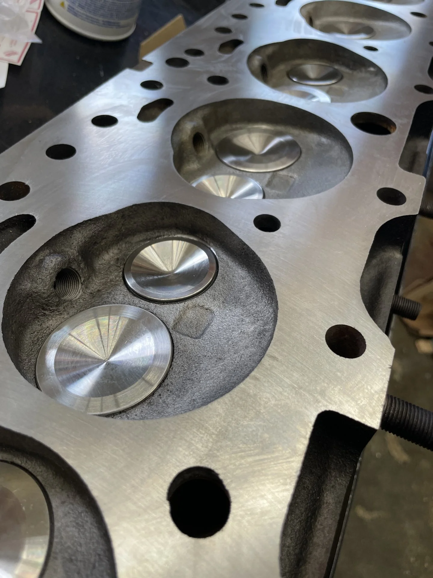

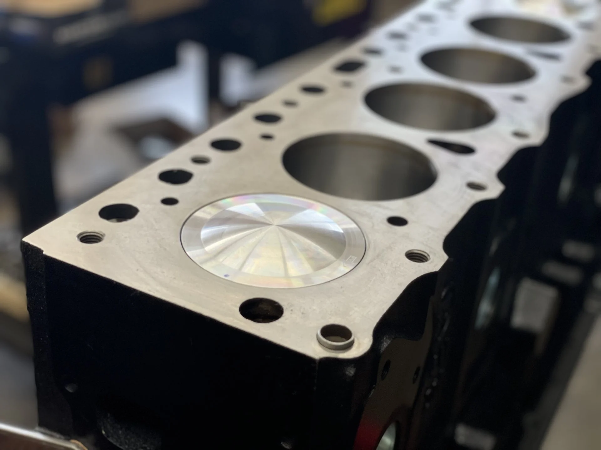

To stay period-correct, we’re using a dome piston head (with larger valves and milled for compression)…
Factory dome pistons are long-discontinued, so we are using Jim C’s custom Wiseco 1.5mm over Big Boys, which we’re putting in a late-FJ60 block…
More to follow as it comes together…

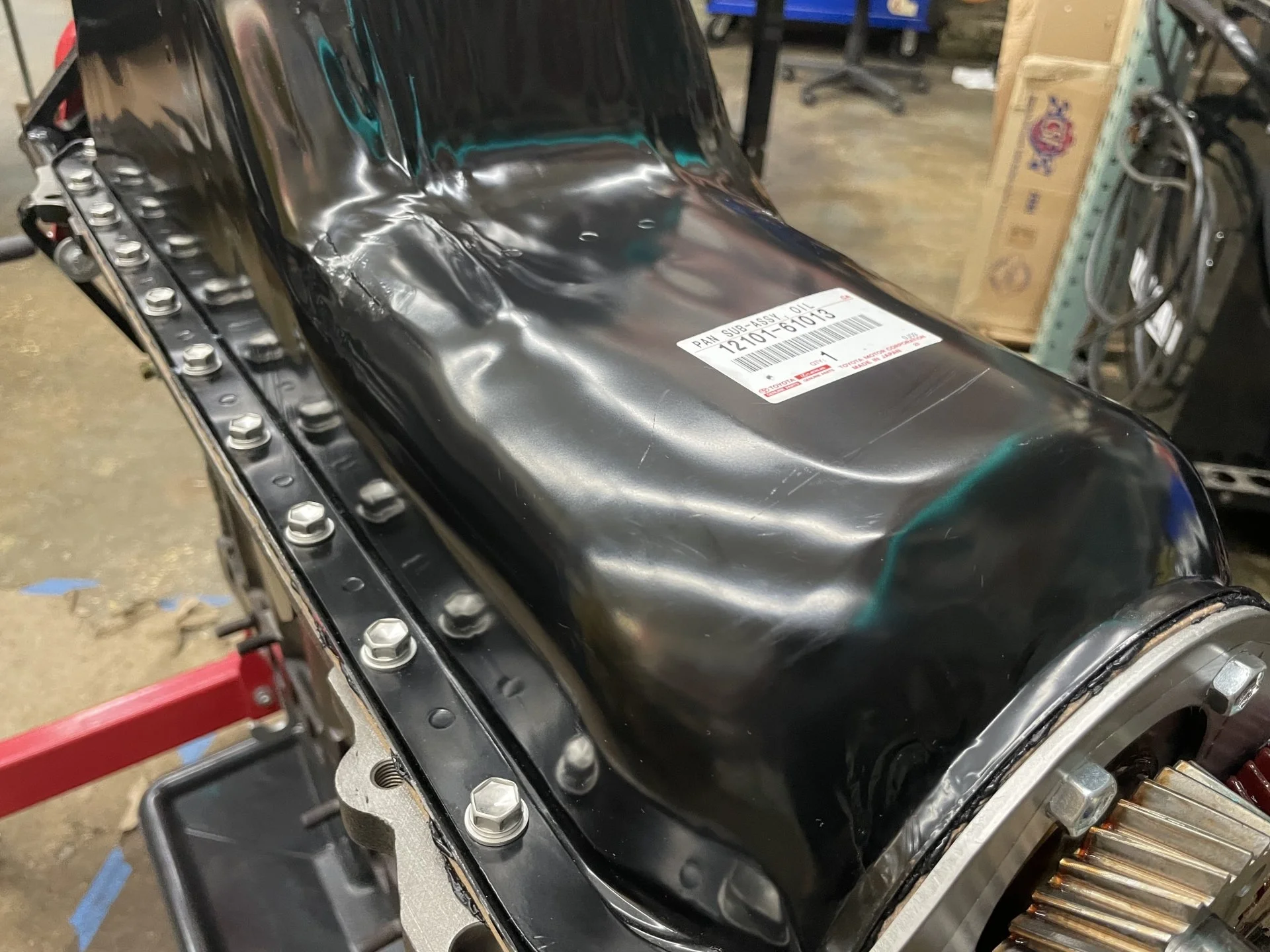

Beautiful!! Are you putting RTV on both sides of the oil pan gasket and all around the whole thing?
He does and I have one and maintain two others he built and there are zero leaks on any of them. Whatever he does I like it.
Yeah the power steering taps I knew, was wondering if maybe it had different/better coolant passages or something like that.
The plot thickens LOL! There seem to be many different opinions on the right way to do this.

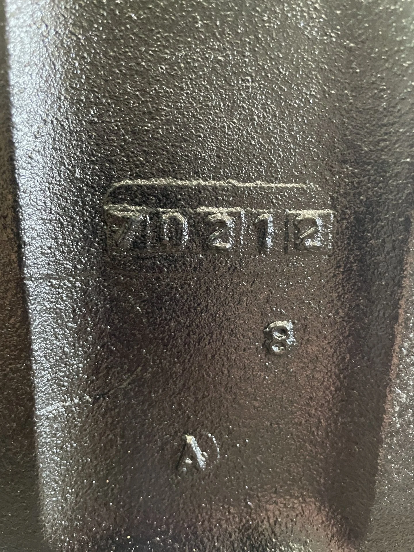

That is a great question. @iptman - I didn't mean to come off snarky. Just what I knew of off hand, along with some head changes. However, I too, would be curious to know if there are improvements to the 2F block over the years other than cosmetics. From what I can find in my FSM's the details are identical in a 76 2F as they are in an 82 2F.
One change I like is the threaded oil galley freeze plug in the front of the block. They started that in 1984 I think. I had one let go on me in that spot and almost lost my new engine.
