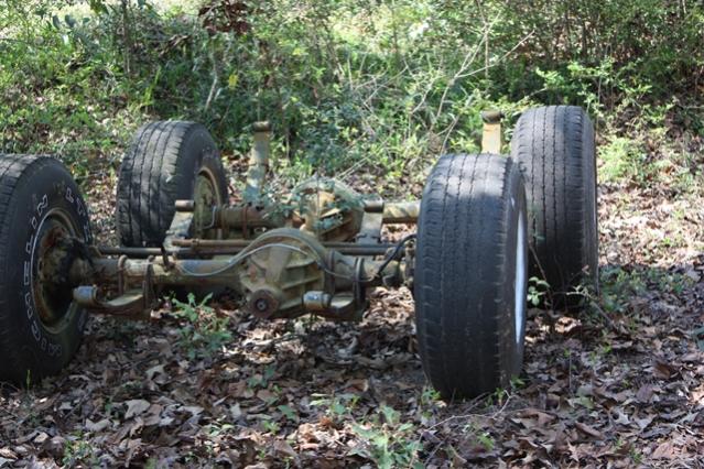

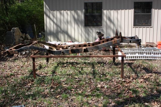

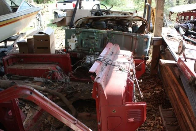

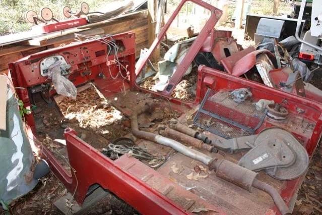

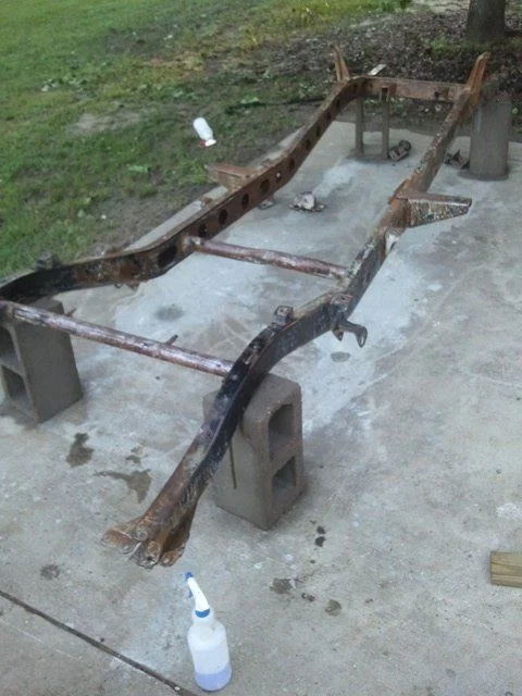

I started with parts as you can see in this first set of pictures.
789491
789492
789493
789494

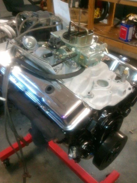

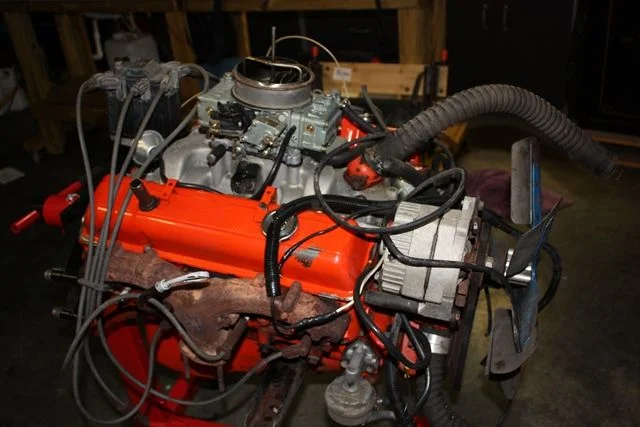

I picked up a 350 V8 with a Holy Avenger Carb. Good 4 bolt main engine. this engine got shelved and replaced by an L98 TPI motor.

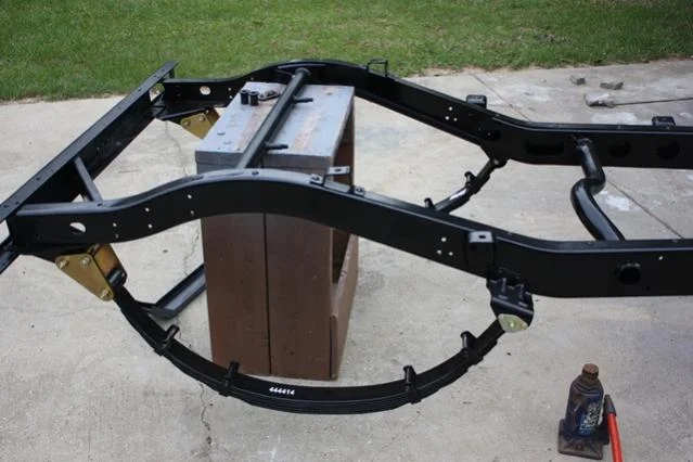

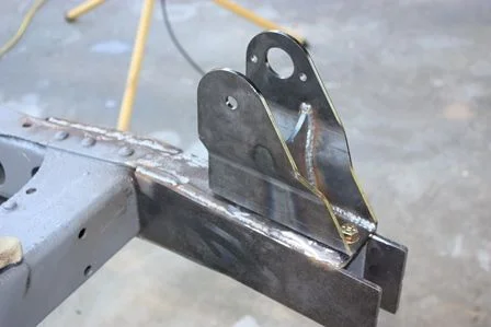

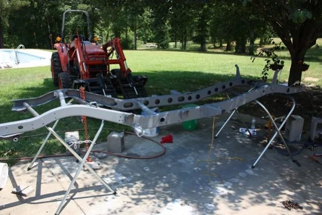

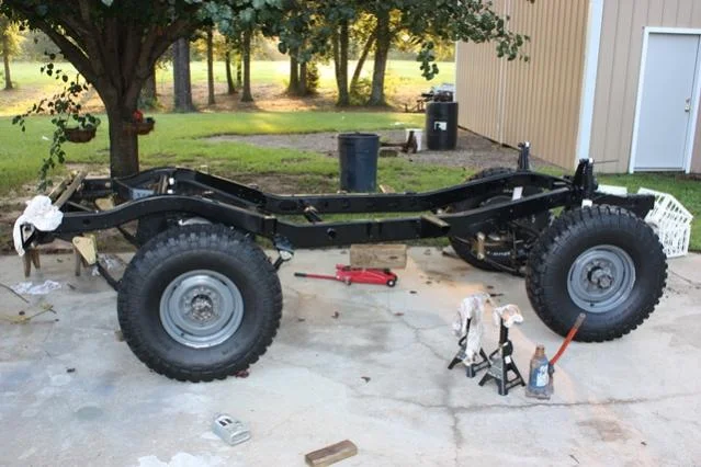

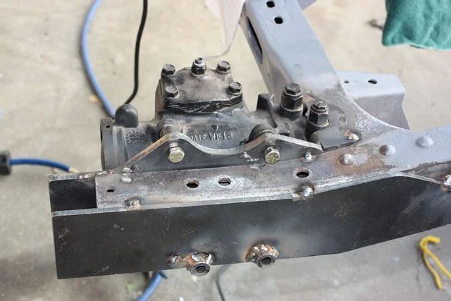

Started working on the frame.
Luke at 4x4 Labs supplied the Power Steering mount,

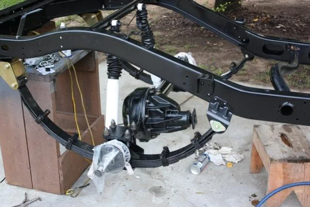

April 2011

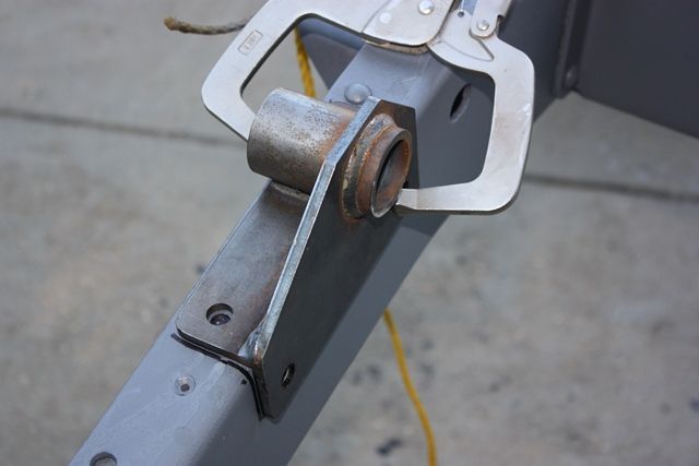

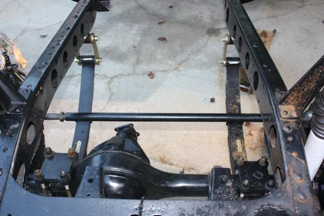

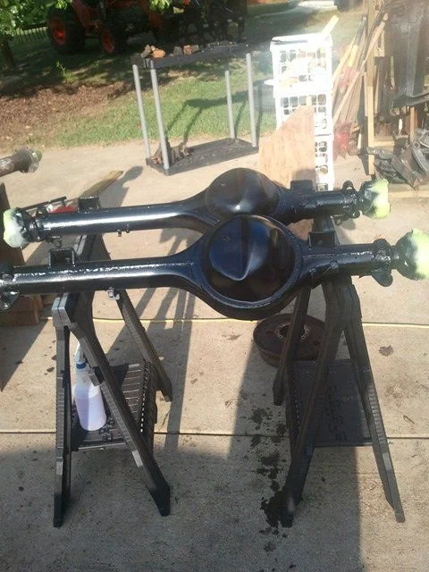

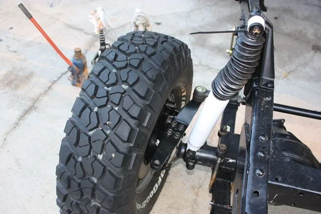

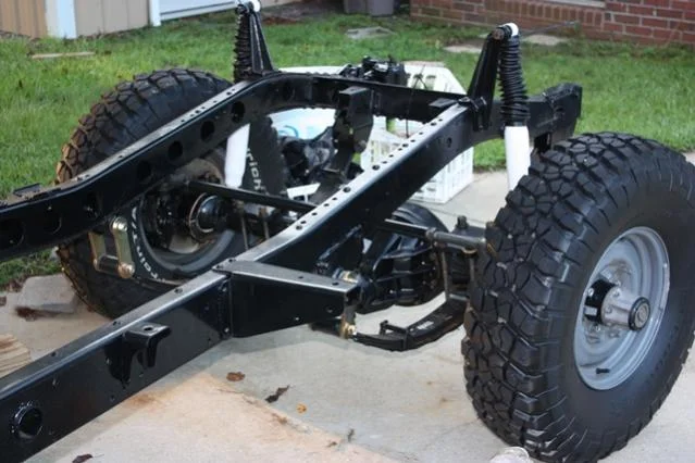

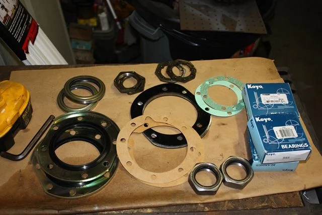

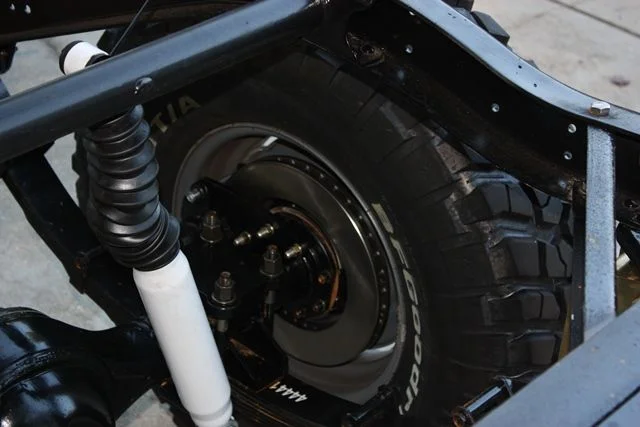

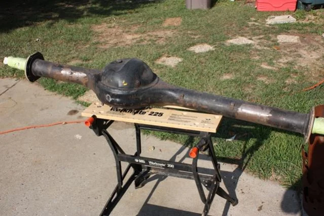

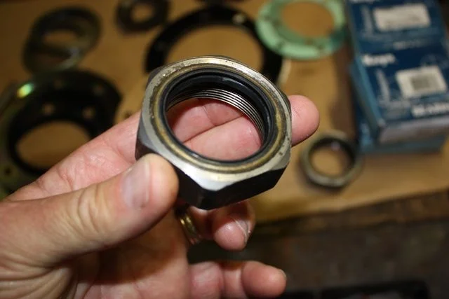

Worked on the frame assembly, disk brakes on all four wheels, and new bearing and seals for the full float rear.
TSM manufacturing was the source for the brackets for the rear full float disc brakes.
Link Home (TSM Manufacturing Home Page)
The rear calipers are 1979-1983 Monte Carlo front calipers. I think you can use rear calipers from a 1979-1985 El Dorado also.

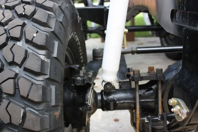

assembled the 4x4 Labs High Steer setup. It turned out that I had the High Steer for a spring over setup and since I was staying spring under Luke was gracious to swap with me the proper setup. so the pics of the setup here eventually changed to a slightly different angle control arms.

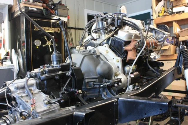

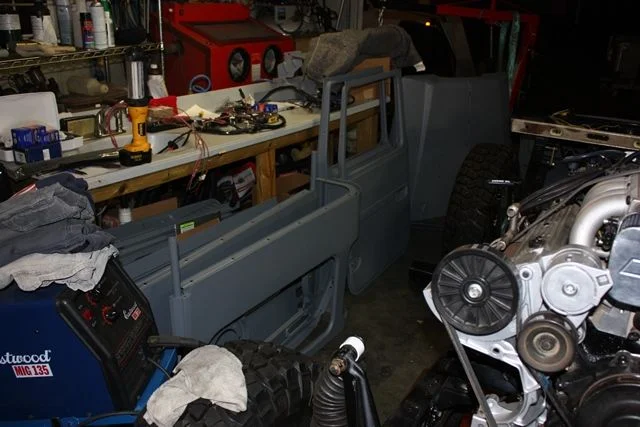

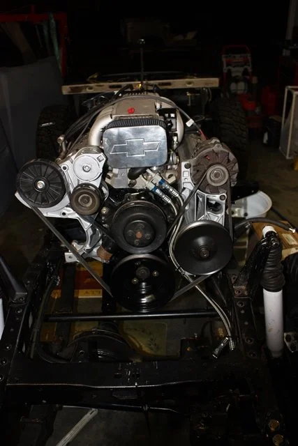

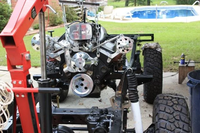

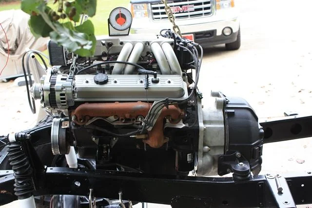

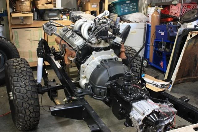

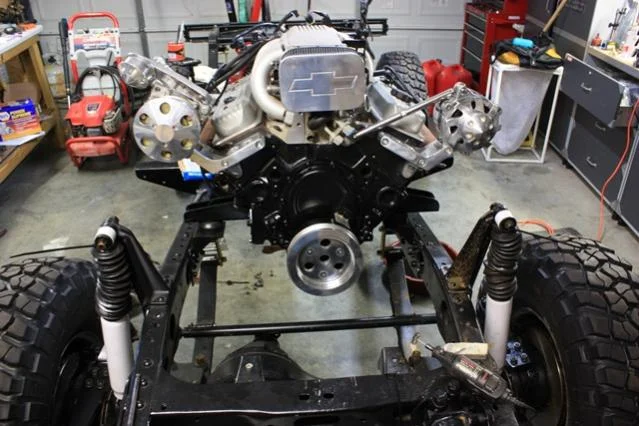

By August 2011 I had the engine, trans, transfer case ready to mount.
I did use a Marks adaptor for matting the Toyota 4 speed to the engine.
Also, I had to nix the fancy serpentine belt system and bling for a OEM serpentine belt system. Although the wide stance and low profile short water pump would have been nice match for the Mark's Adaptor, the width interferred with the shock mounts and I did not want to engineer new shock mounts.
BTW the belt routing on the OEM serpentine belt system was all wrong in the picture. I had to go to ThirdGen.org and search for the proper belt routing with a smog pump delete.

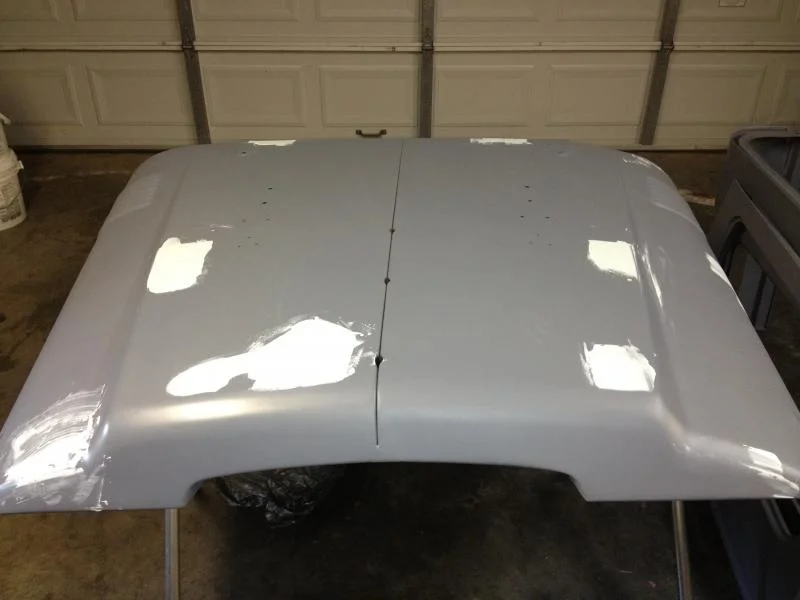

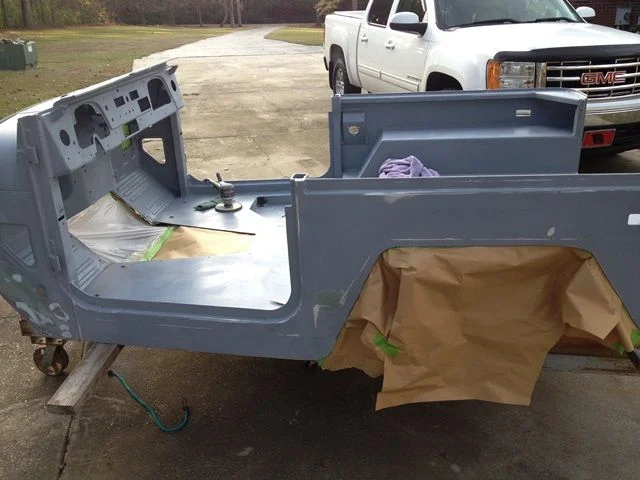

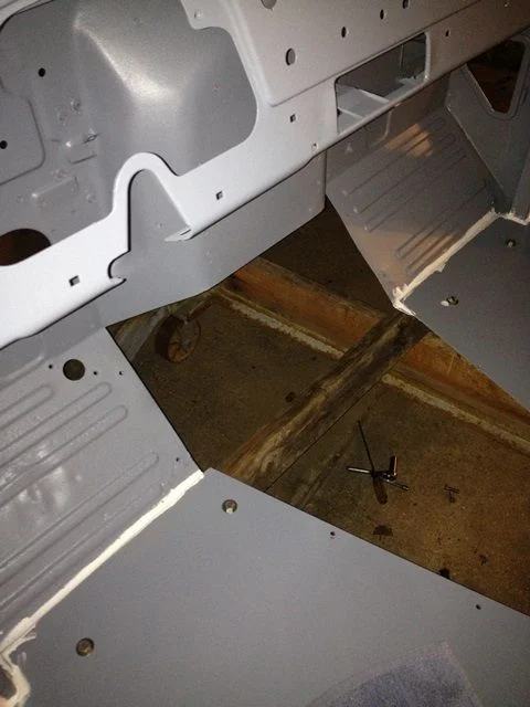

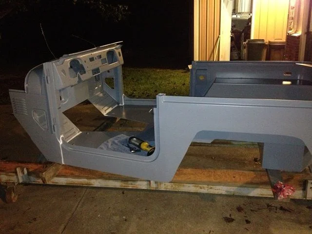

By September I had the body parts back from the bead blaster, epoxy primed.
I also found a 60's hood, I think the spear on the 60's hood is cool.

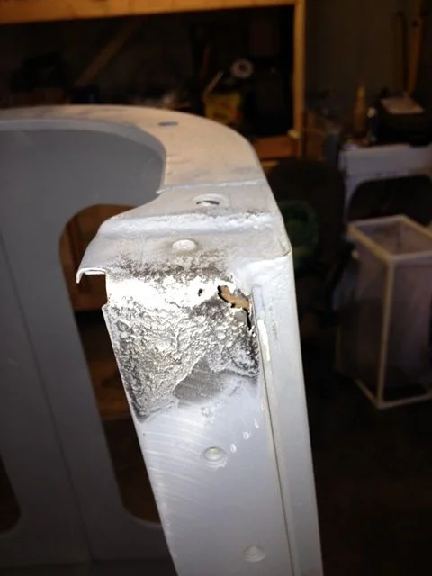

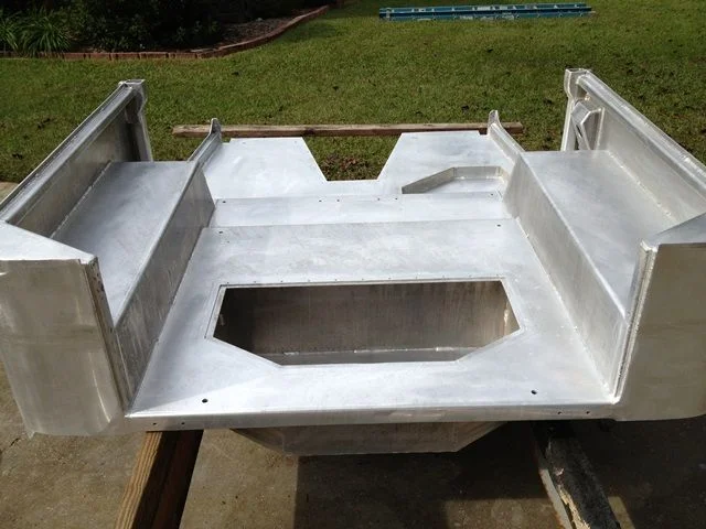

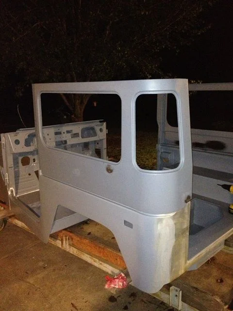

I worked on the body work, got a mig welder to help with the patch work.
I ditched trying to salvage the original body when I found a deal on an Aqualu tub in Atlanta. Drove over one afernoon with my trailer had dinner with the seller, talked FJ40 stuff, his wife helped me move it over to my trialer and back to MS with my nice body.

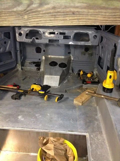

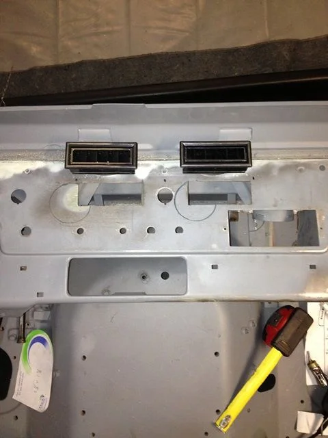

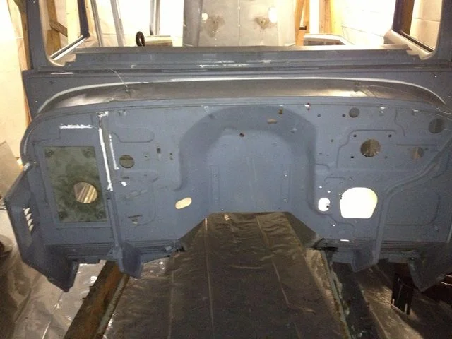

Continued working on the body. My plans were to install an Old Air Products Hurricane AC / Heat unit. I wanted vents in the dash. Thus the round holes on either end of the dash and two rectangle holes in the middle upper.

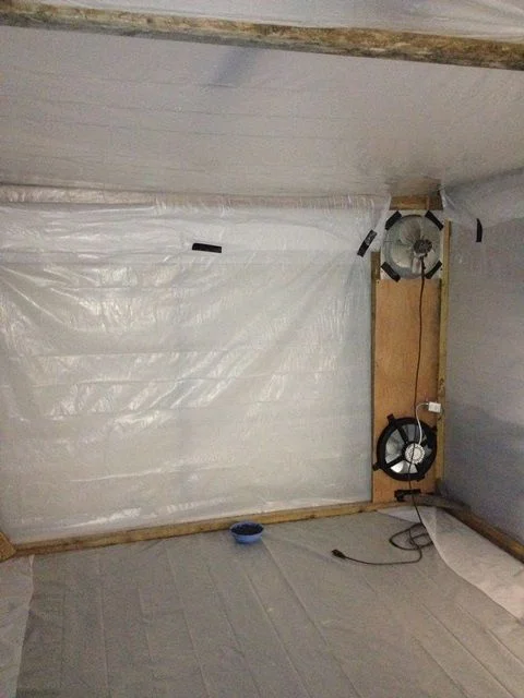

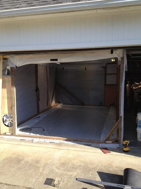

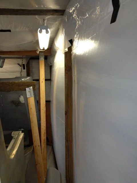

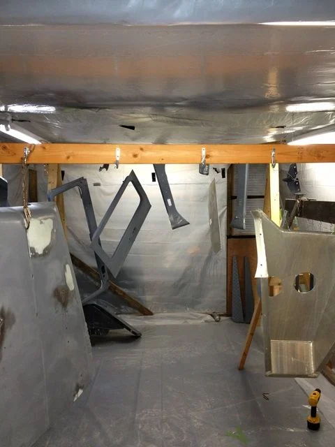

I built a paint both in my shop. More pics of the booth to come.

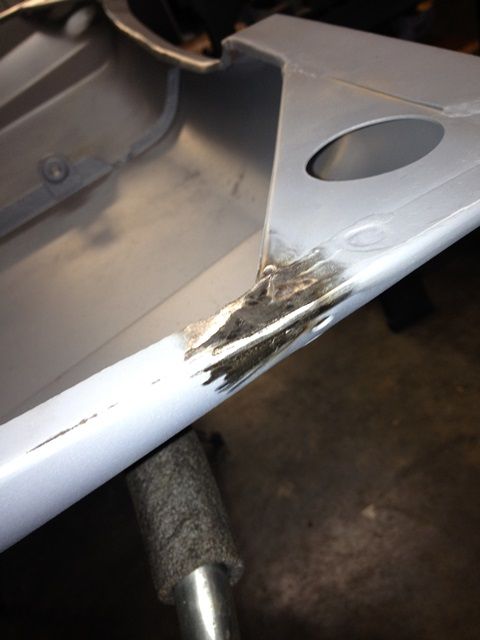

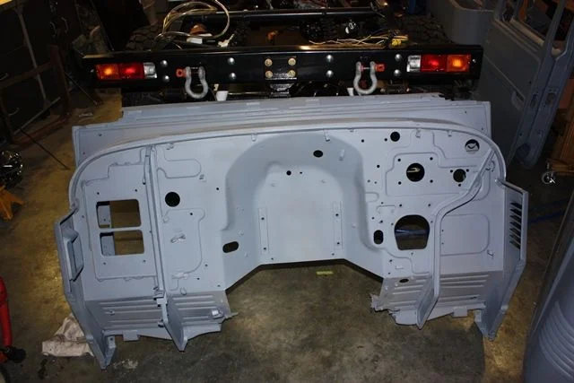

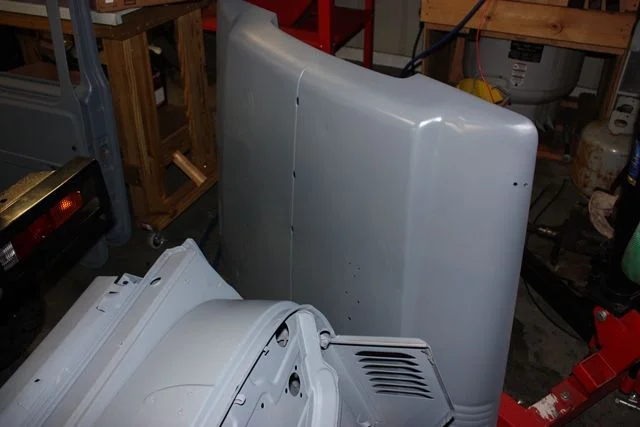

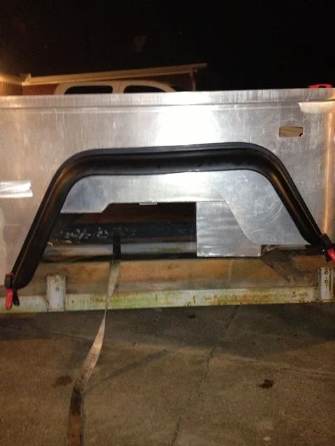

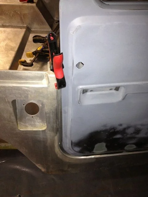

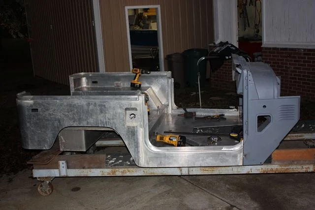

Measured and cut for the extra wide version of the fender flares.
did some test fitting on the doors and body parts.
October 2012

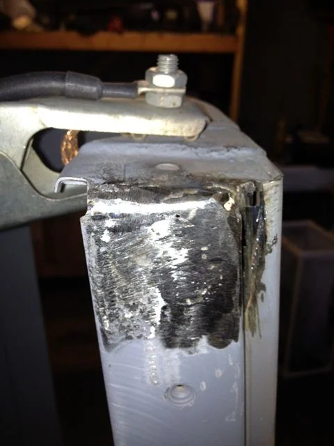

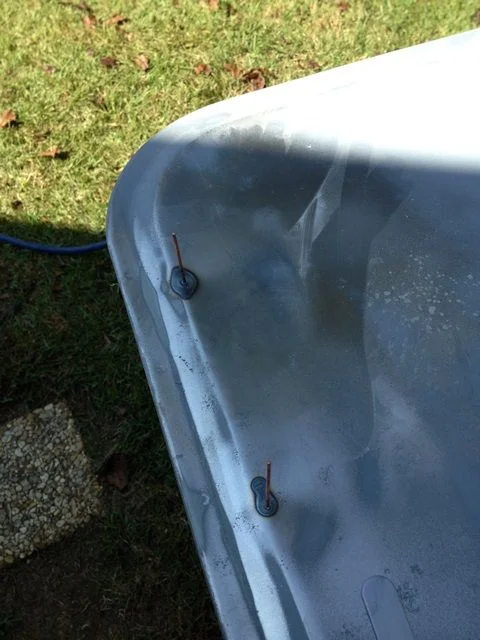

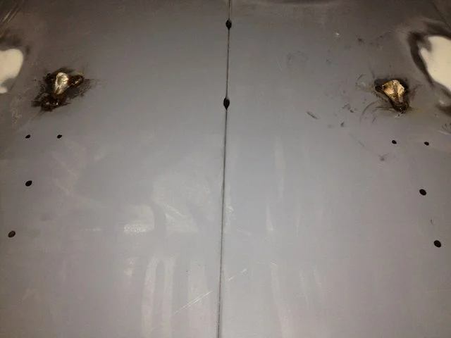

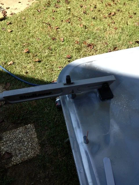

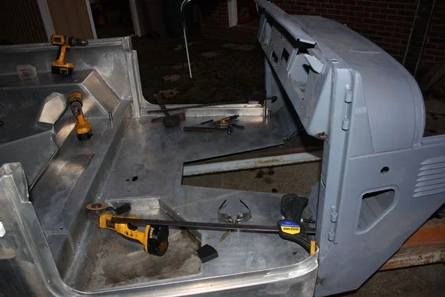

picked up a stud welder from Noah and purchased a puller arm to help get some dents out of the doors.
Mated the cowl to the body and sealed it with 3M body seam sealer.

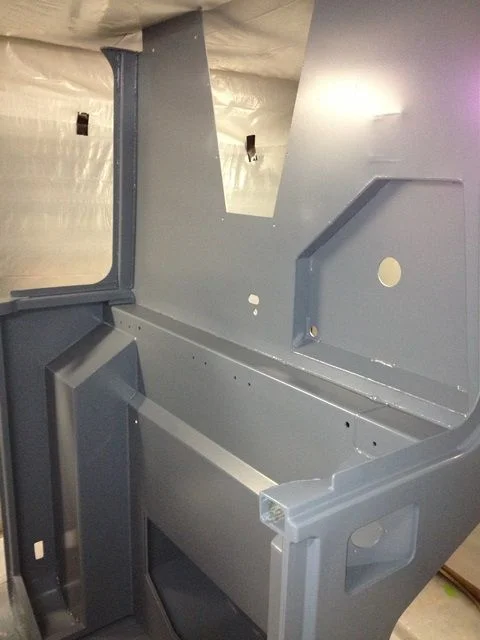

Started painting.

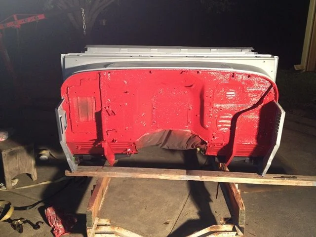

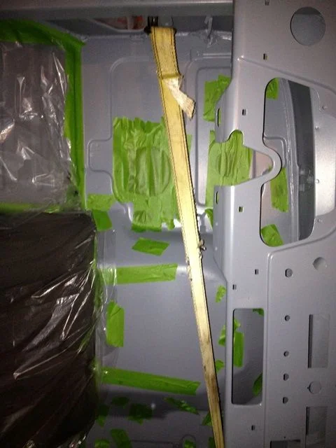

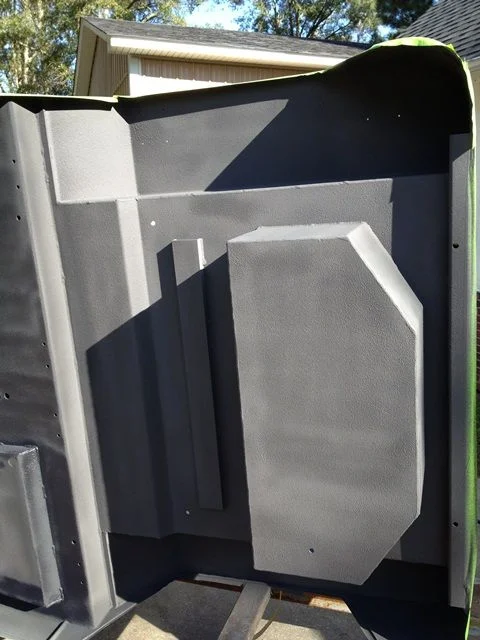

After the primer was done on the body and it was assembled to the cowl, I applied Lizard skin heat shield and Lizard Skin Sound Deadner to the underside of the body in black.
October and November 2012

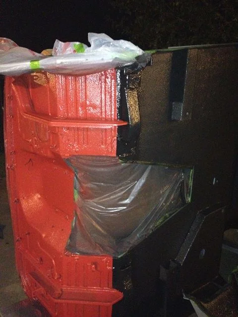

Finished the Lizard Skin with U-Pol Raptor over it for protection.
Did the bottom of the body with black Raptor and the firewall I tinted the Raptor with the Freeborn Red.

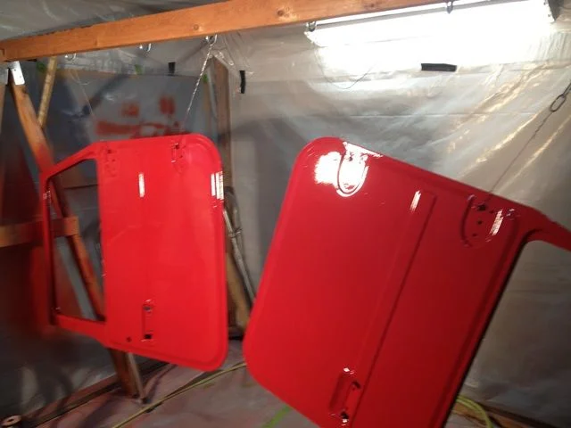

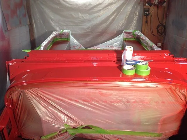

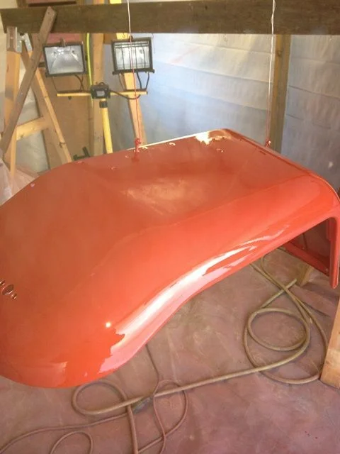

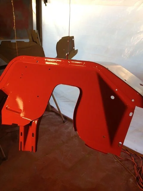

Started painting the large parts, the doors in the previous post, fenders.
I had the motor mounted too high and had to pull the engine from the frame and re-position the motor mounts.

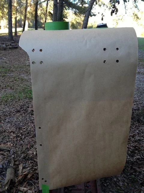

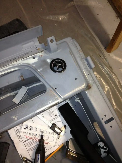

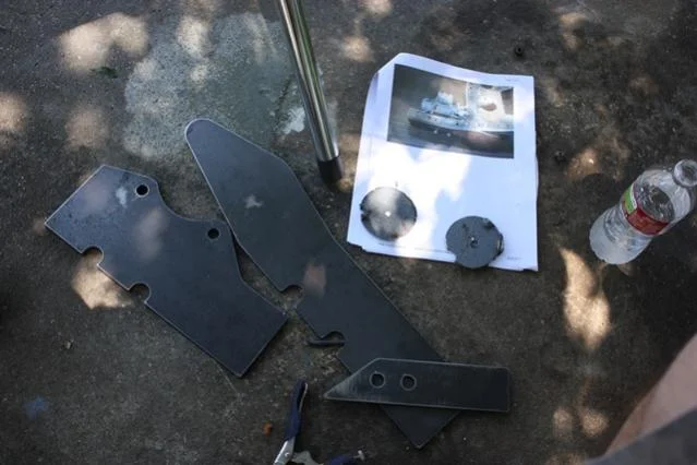

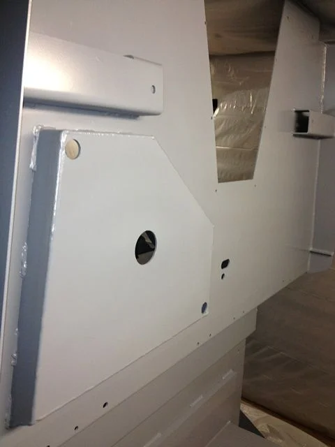

I also wanted to get the holes drilled for the tire carrier before I painted th body. so I took some craft paper and made a template of the mounting holes and transferred the position to the aluminum body.

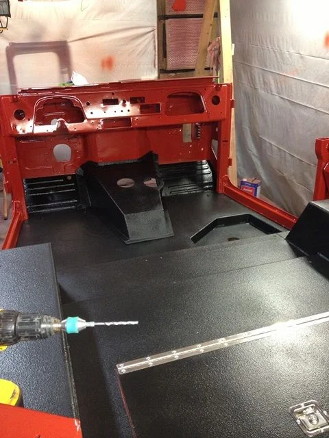

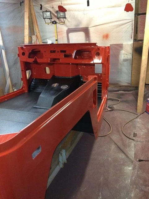

December 2012

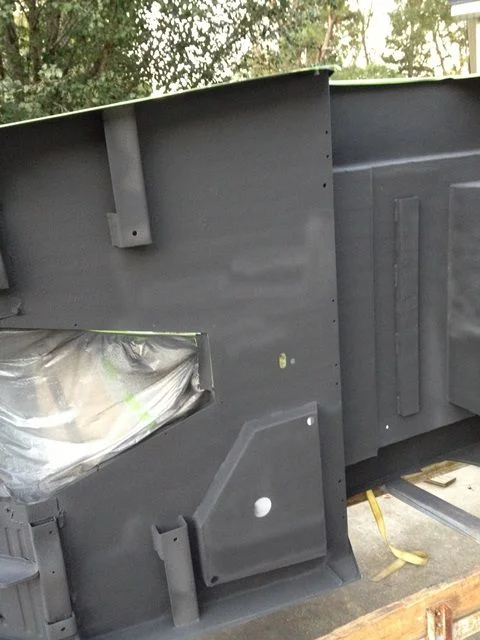

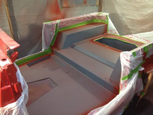

The body gets some color, finally.

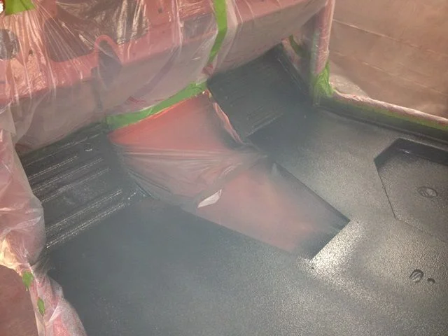

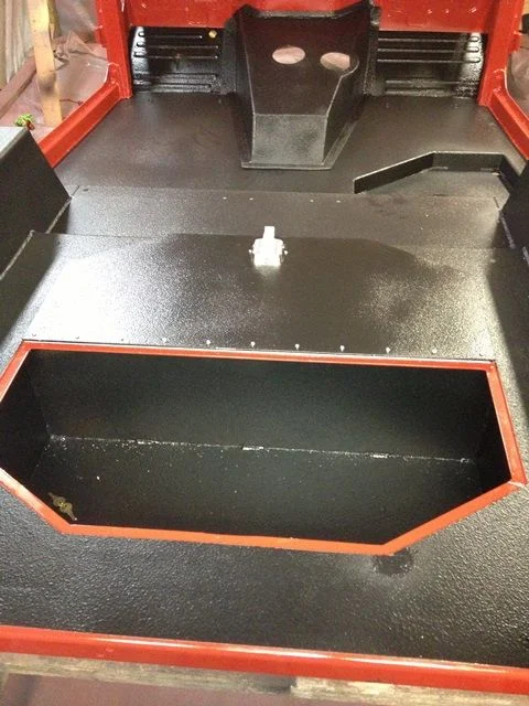

Then the floor gets black U-Pol Raptor. The mist had not cleared in the last picture. more pics to come

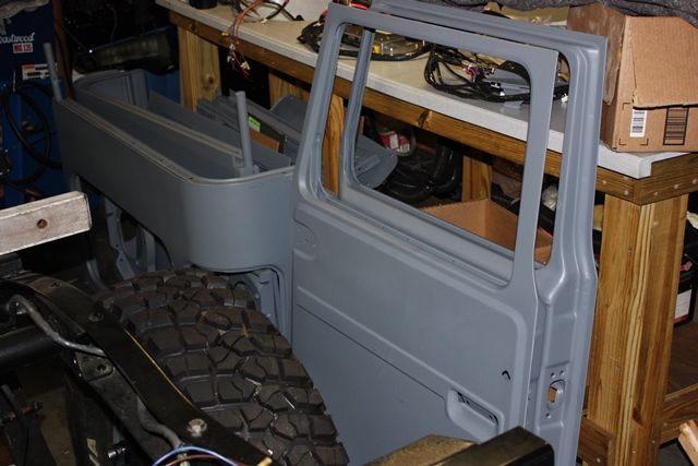

December 2012

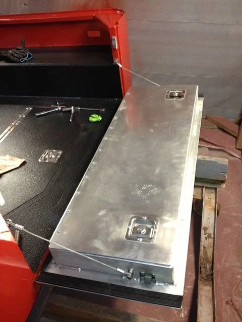

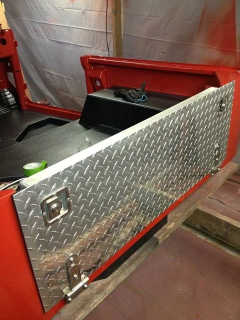

more of the Raptor on the floor and the storage box. fitting the storage tailgate to the body and finally the body just sittin on the frame.
