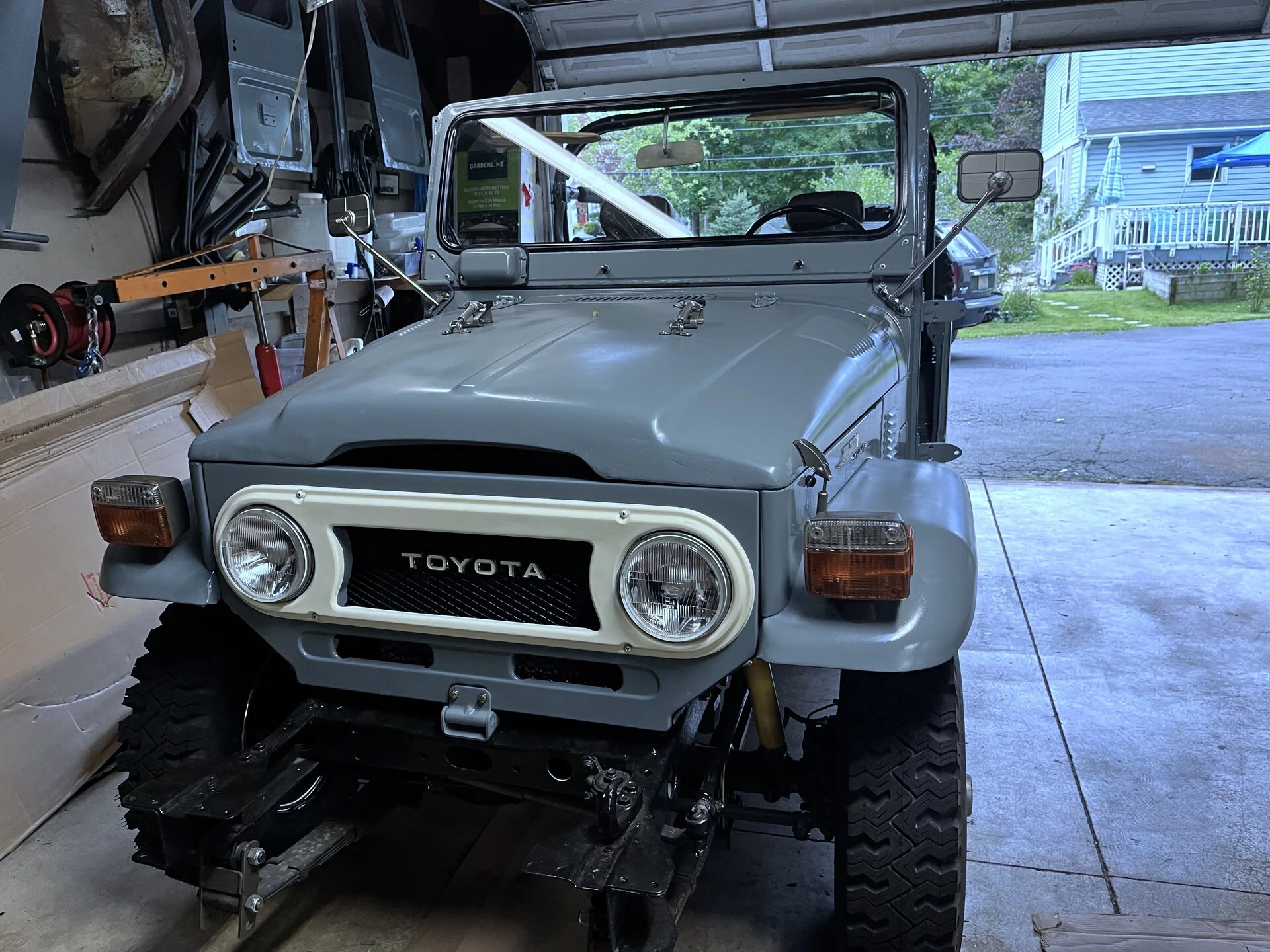

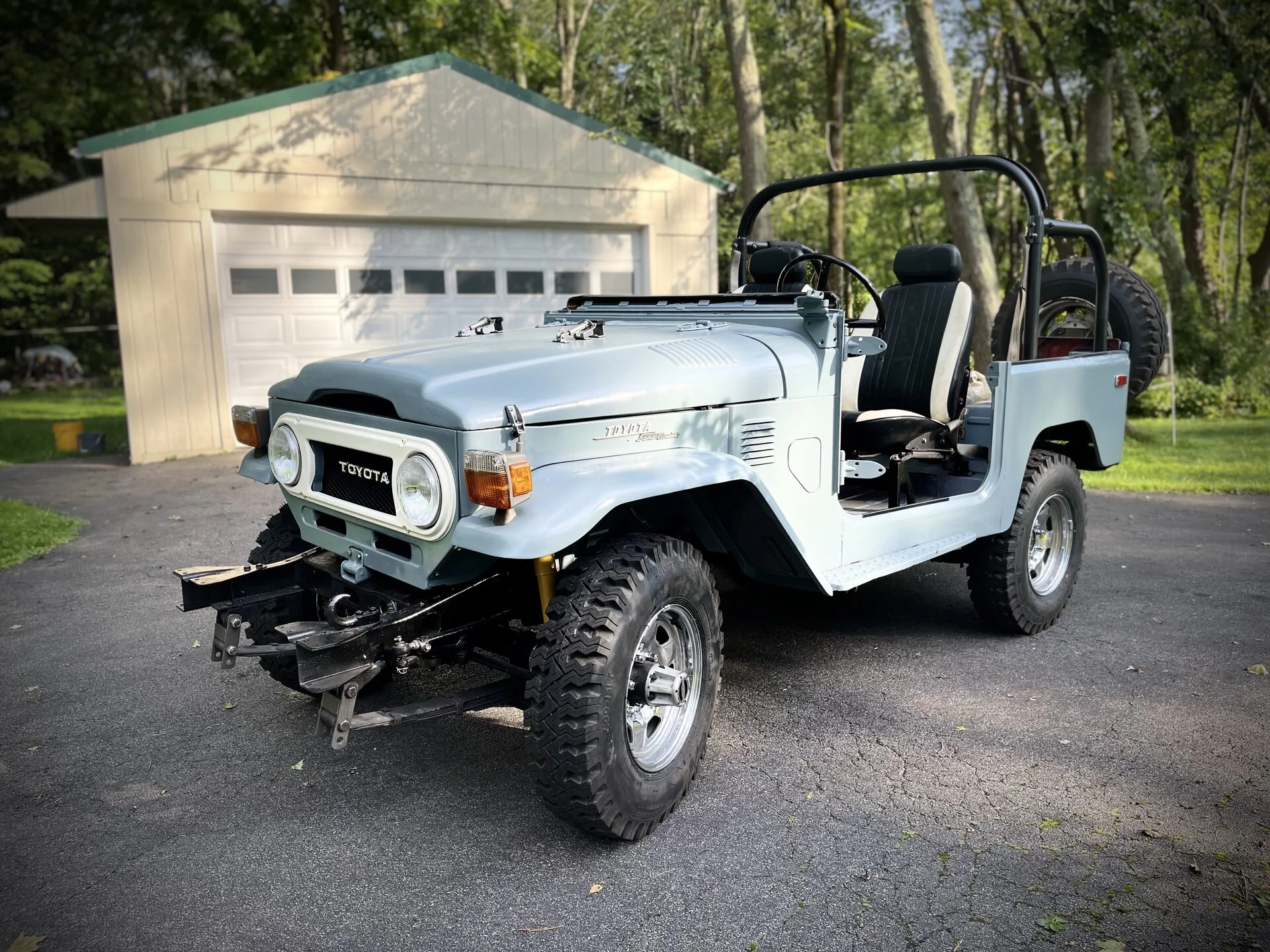

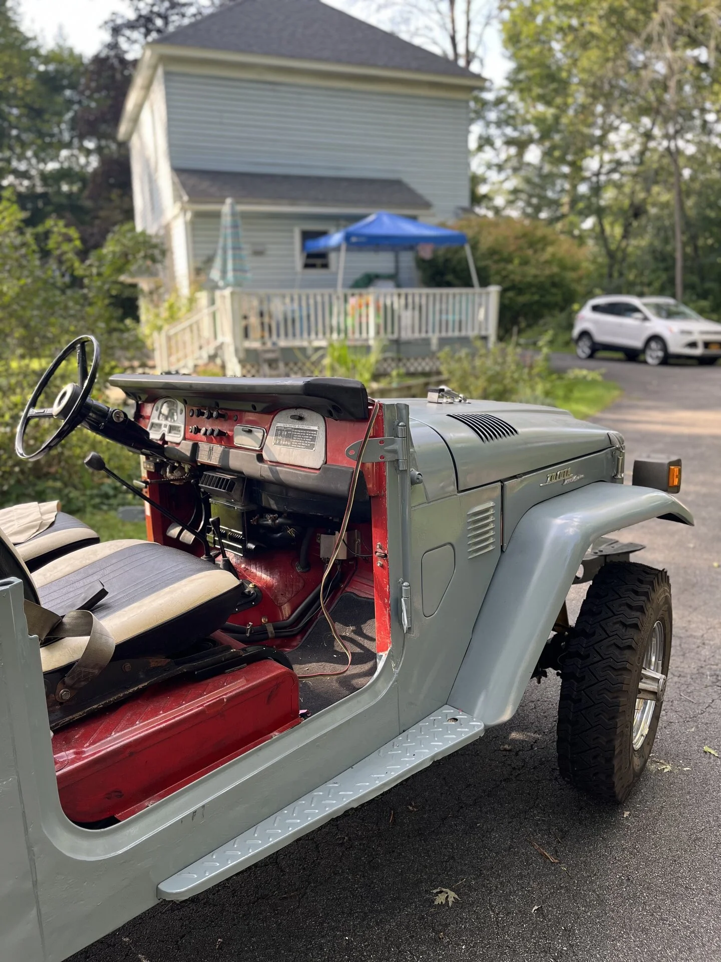

Finally is running ... don't have a chance to go on the road. Just only on the driveway.
It takes a few minutes to warm up (from a cold start). If press acceleration in the first minute after starting the engine dies.
The vacuum is good, the compression is good. Amp shows almost +30 in the first minute of running and lowers almost to the middle after a few minutes.
Warm start with no problem at all. Probably will work on doors and herd top this fall/winter and register in the spring.

yeah they are cold blooded, I’m told the engines need warm air run properly. Something like 85 to 90, that’s why the old style air cleaners had a thermostatically controlled inlet, on start up the flapper would close and you draw air from the exhaust manifold riser tube. I have headers so I took some flexible metal exhaust and made a heat riser to the air cleaner for the fall/winter
