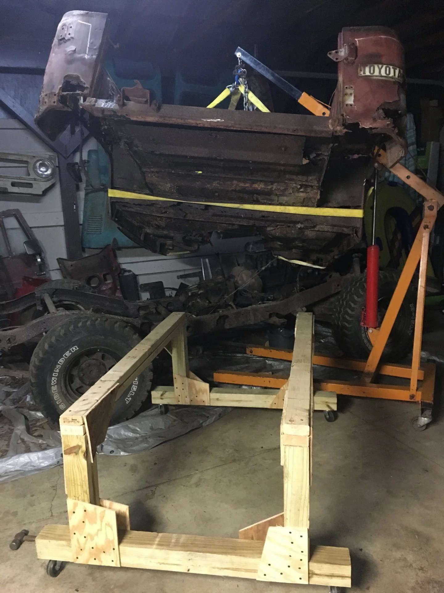

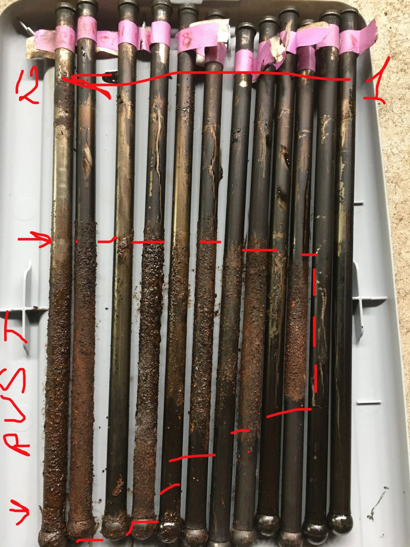

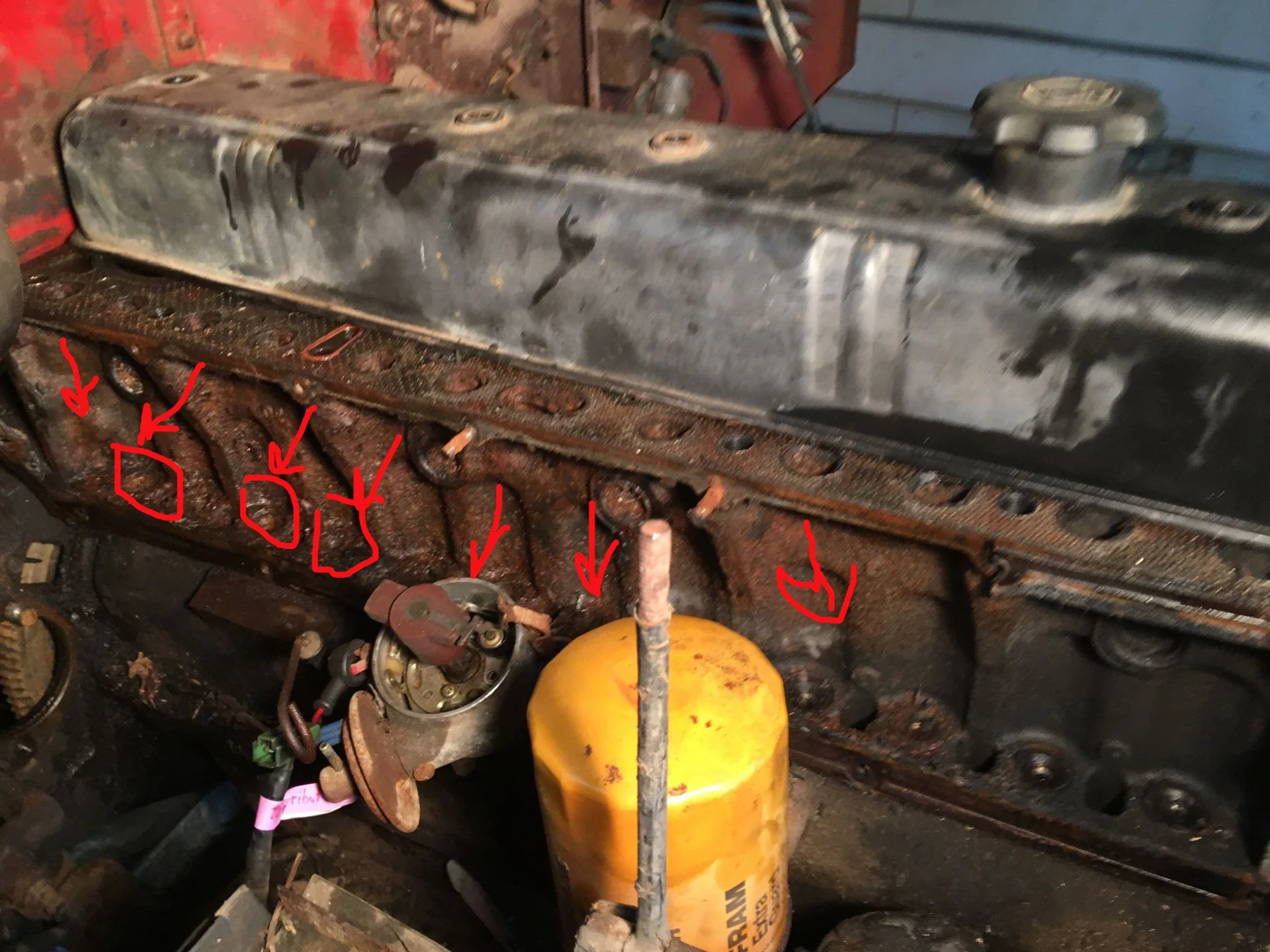

I have almost (I think - 90%) whole picture now..

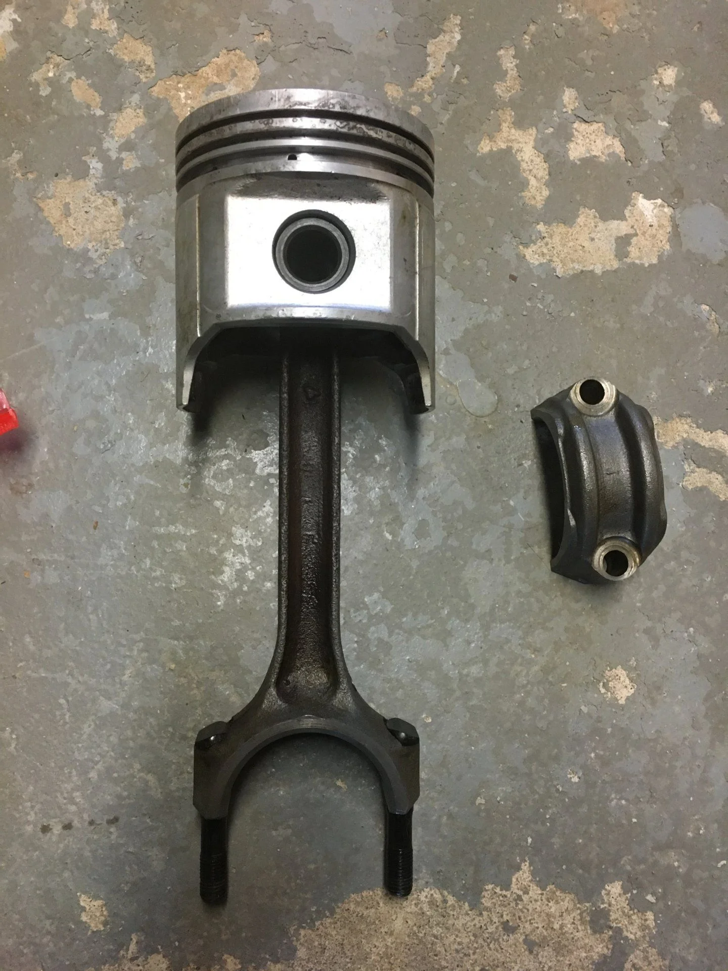

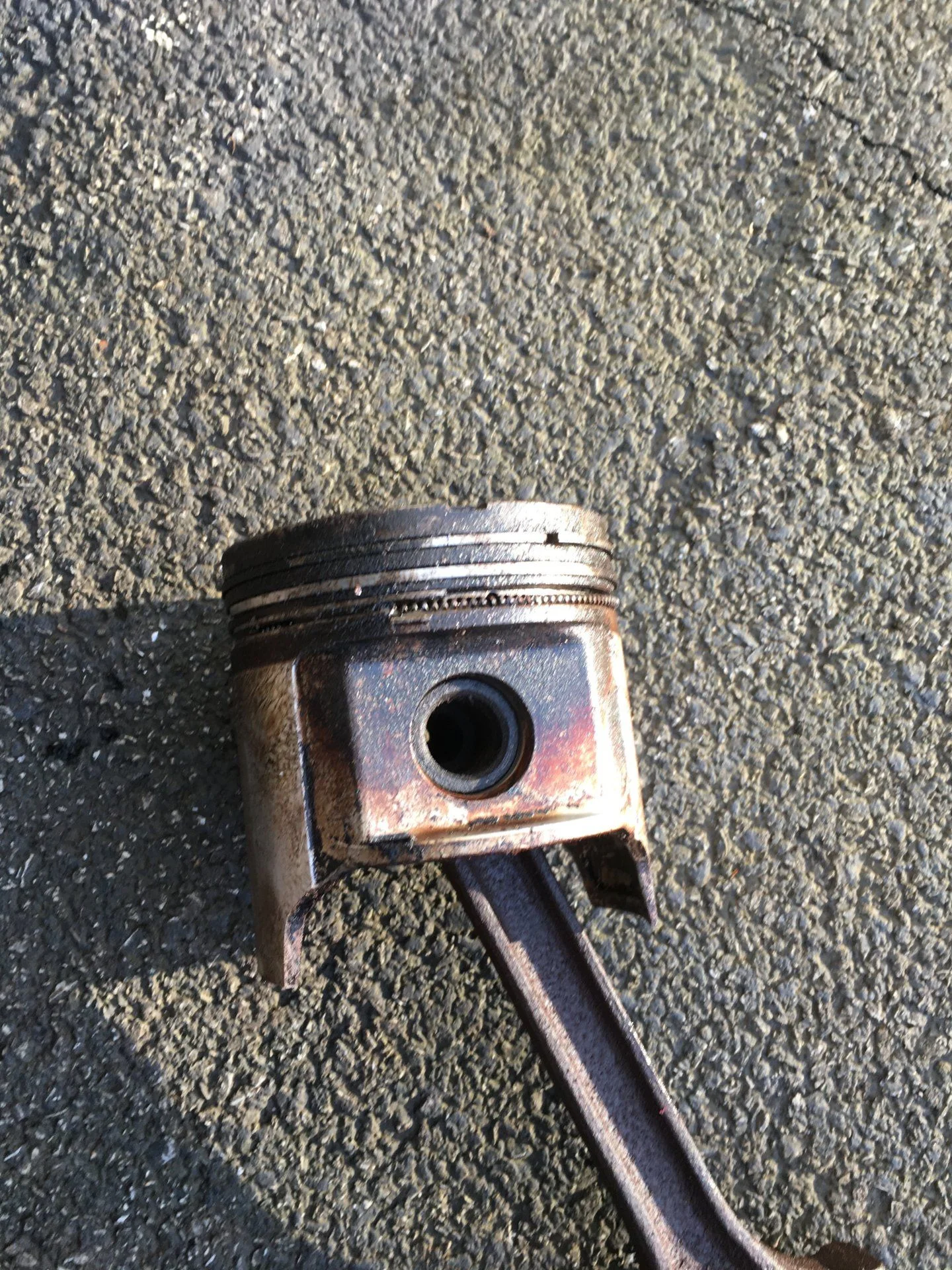

Water was collected over time in two cylinders and in push rods aria. Valve lifter was rusted and block timing gear as well as rust in two pistons also block crankshaft. Because engine is tilted back, you can see how push rods is rusted from 2-3 to 12.

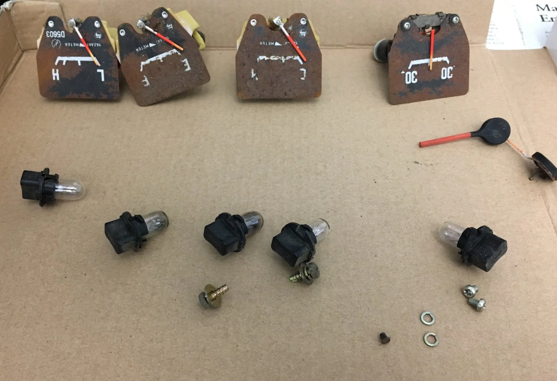

Working on gauges cluster ... it's has no glass and very rusted ..
I have older model speedometer parts (what I have found in the glove box ) what I have to modified to my model..

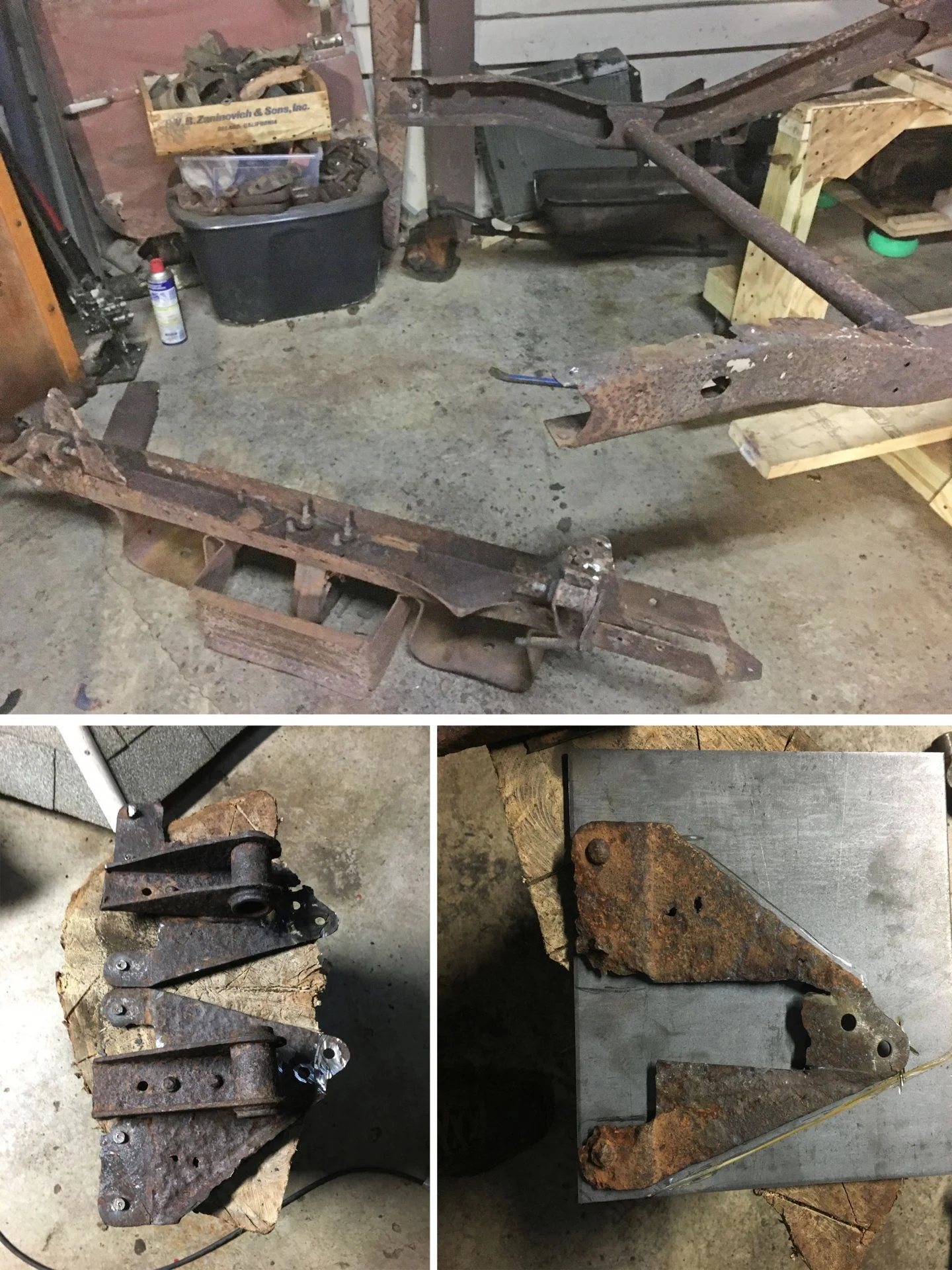

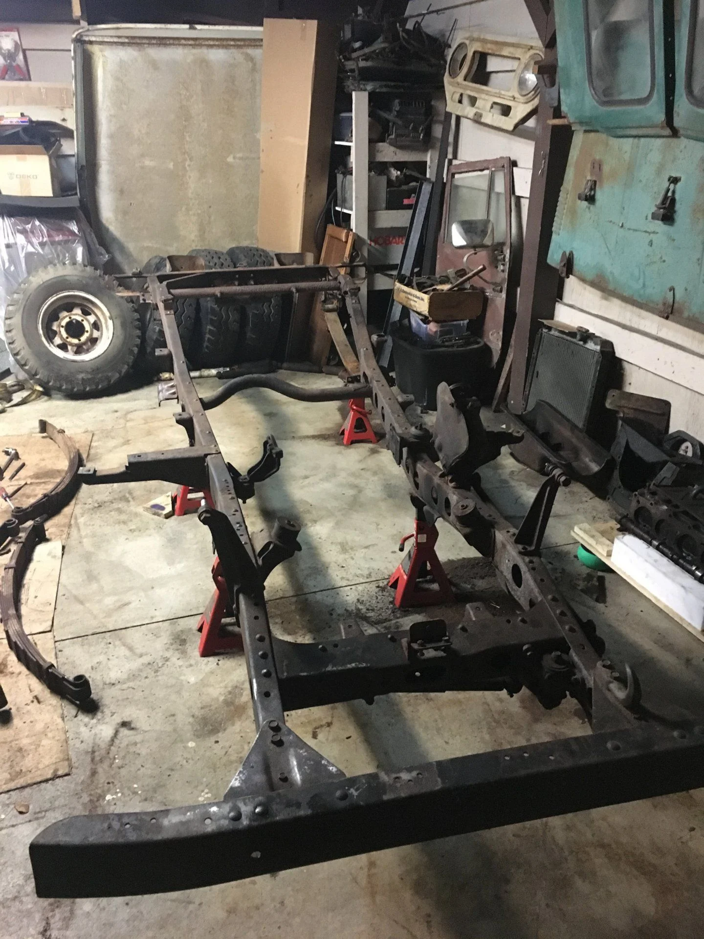

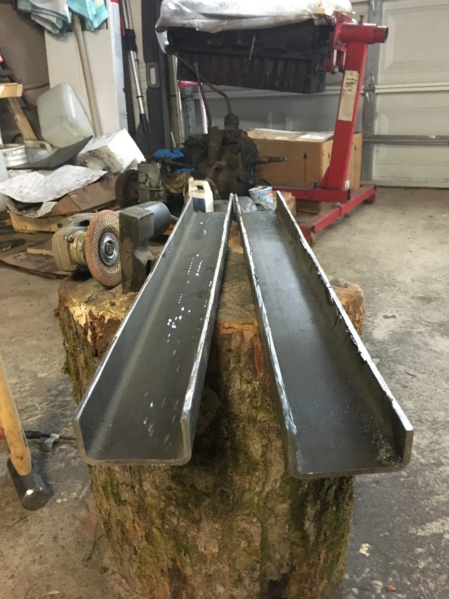

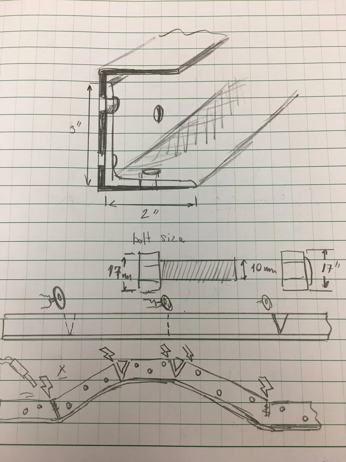

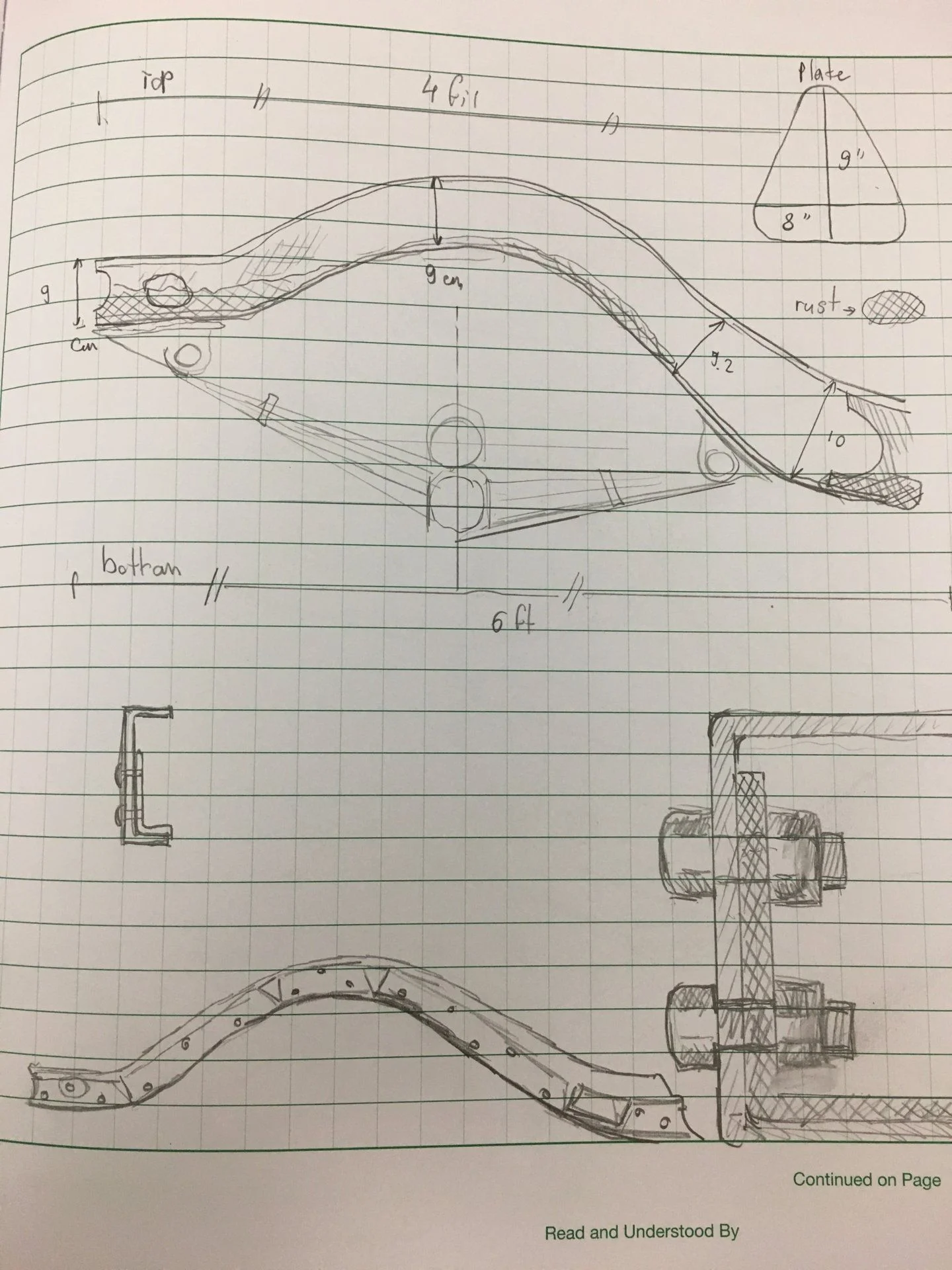

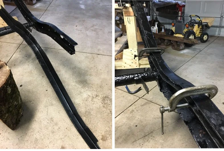

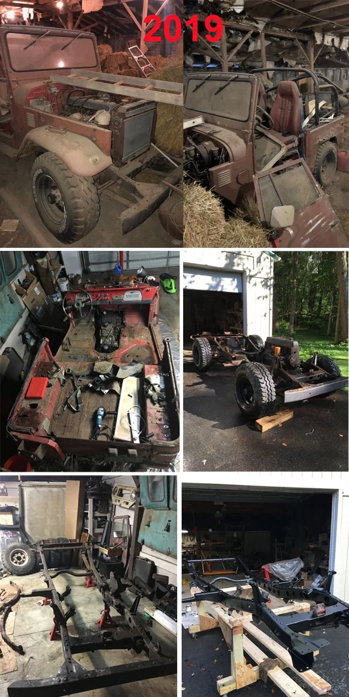

The frame actually better than I thought it would be. Right C-rail is very solid and has rust only on the surface, except a very end.
Left rail has solid wall and top but bottom part rust and thin (shown in red).. inside plate has crack (see in blue)

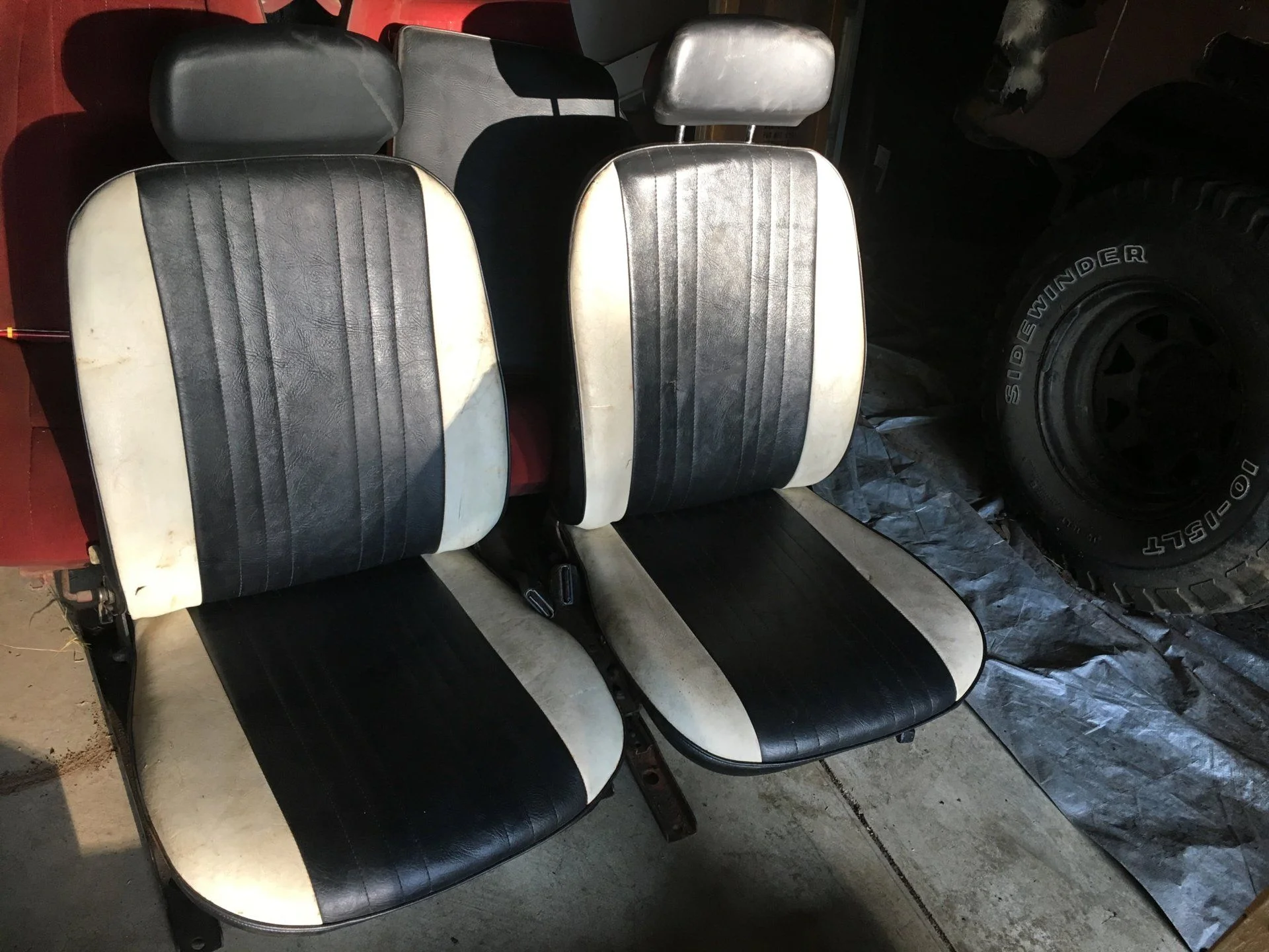

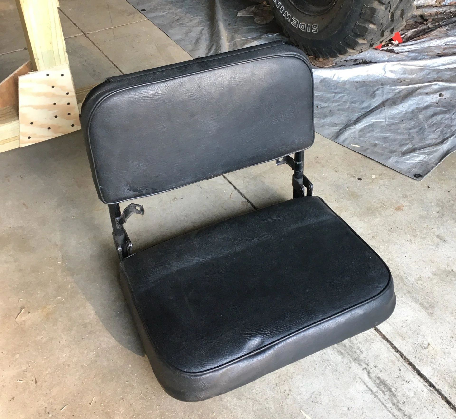

Also found this one (screaming deal)... not sure if seat cover is original.. but it is old ..seller said it is storage by his father ..
also both fenders never been installed ..
