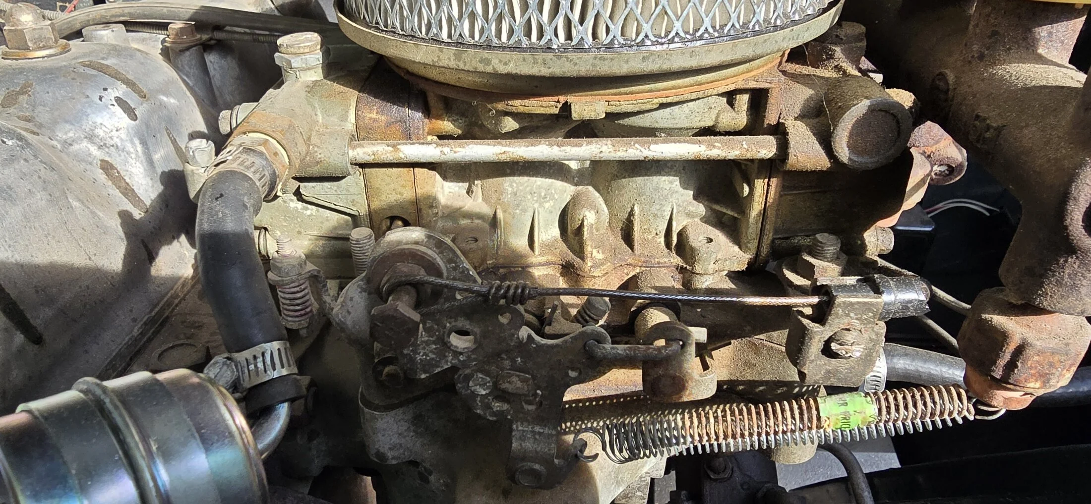

Hey all, I'm slowly chipping away at repairing this 1976 and now I'm having issues with the accelerator cable sticking on the Holley carb where it turns 90-degrees toward the firewall. I'm wondering if I should keep the current Holley/Offenhauser setup given my issues with it seem to continue mounting. I can't find a new cable anywhere, the truck runs rich no matter what adjustments we've made on it and after being rejetted. Any general words of wisdom or direction?

I would removing the cable assy. Check for kinks in the cable. Hopefully you not find any. If looks good curl it and and soak it in WD-40 to clean the rust off. After soaking it, he cable should slide easily.

The turn on your accelerator cable looks like it is too short for the application. Easy to address to allow some more relief for bend. If the brake booster and MC combo is in the way there are other Toyota options there... something you may need to do if you change carbs.

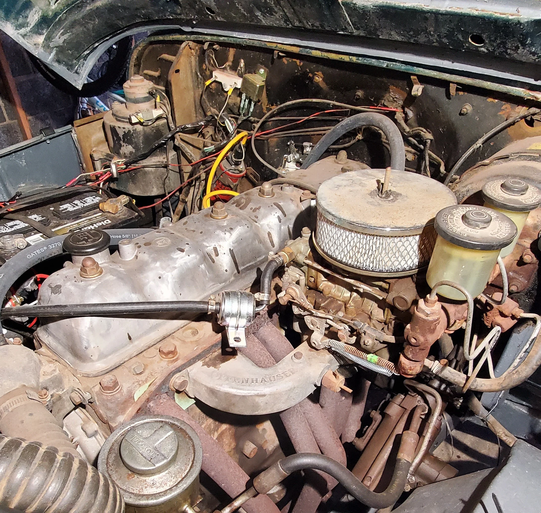

Also is that valve on the forward runners attached to anything? Could it be causing a vac leak? If not using it I would just plug that manifold port.

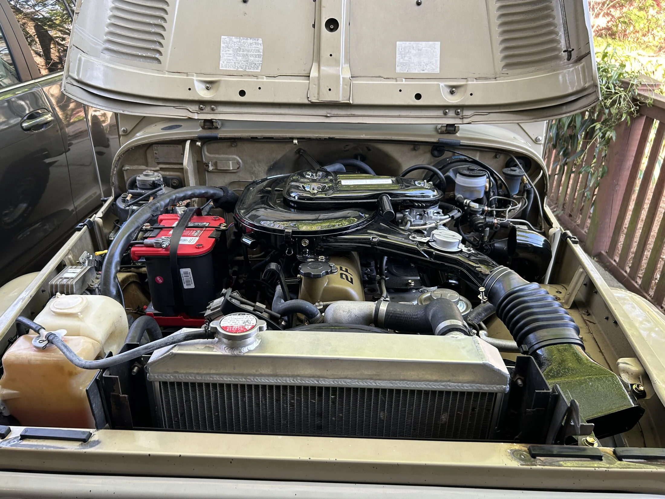

Going in for a “return to stock” intake, carb, air cleaner. Will report back on the performance differences.
Yes, back to desmogged stock, but retained the headers. Seems to run much better, less rich, no feeling of power loss. Only thing I miss is the manual choke-free starts
