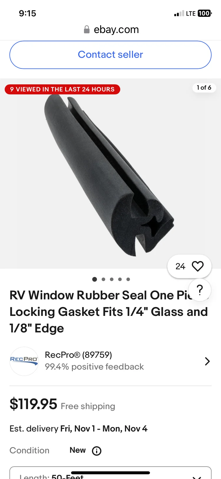

Would this work?

I installed my 3 rear windows with this stuff. Was relatively easy for a first time try. I bought 50’ which was was too much. I had planned on doing the side ones too but went a different route for those. I think I had estimated about 40’ would do them all and cover mistakes.
