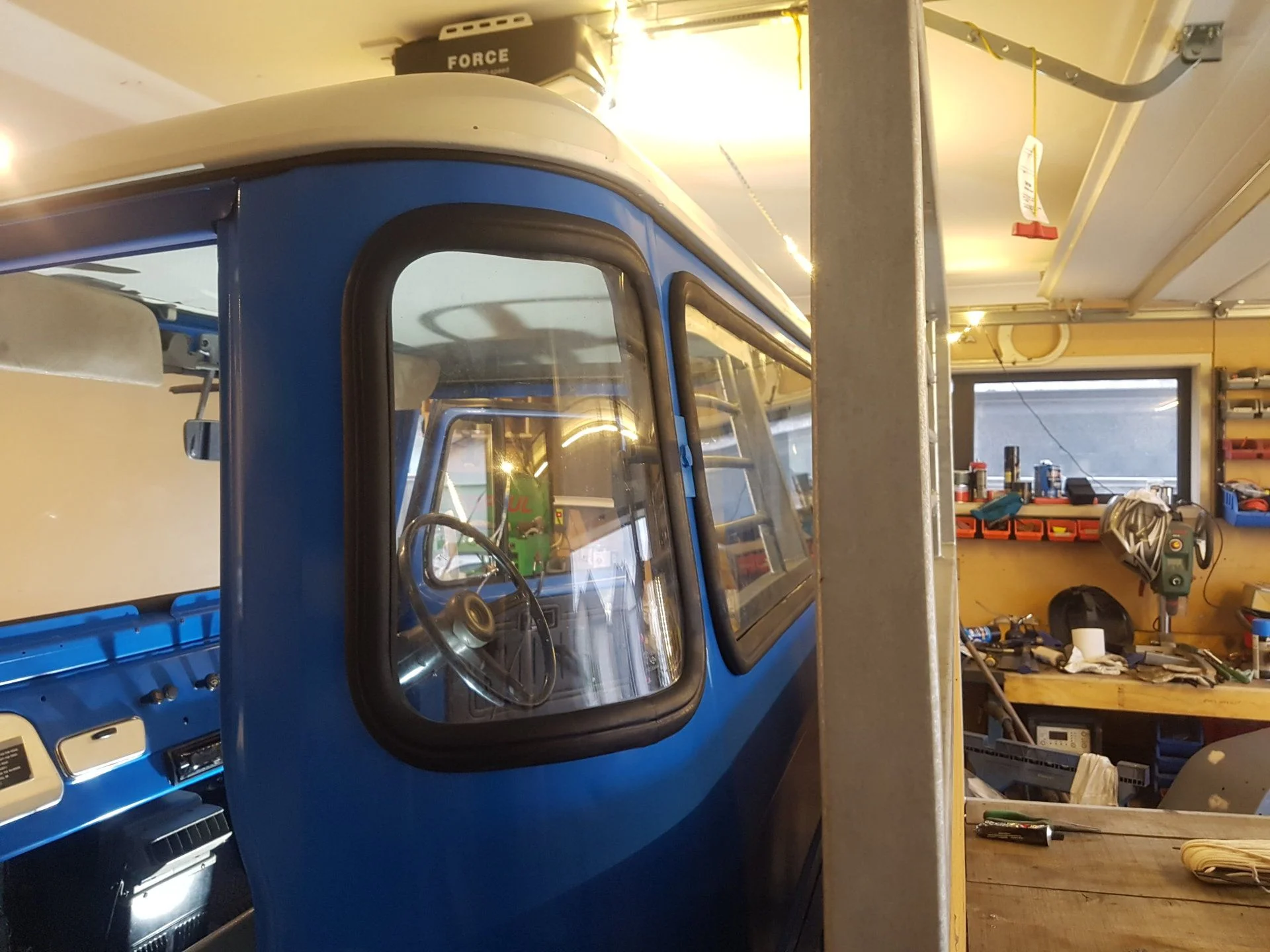

Looking great Tom, might want to double check that bezel before the bezel police show up mate. :hmm:
I would have a look again, thick side is at the top in all but the first photos in the thread then I bought it.

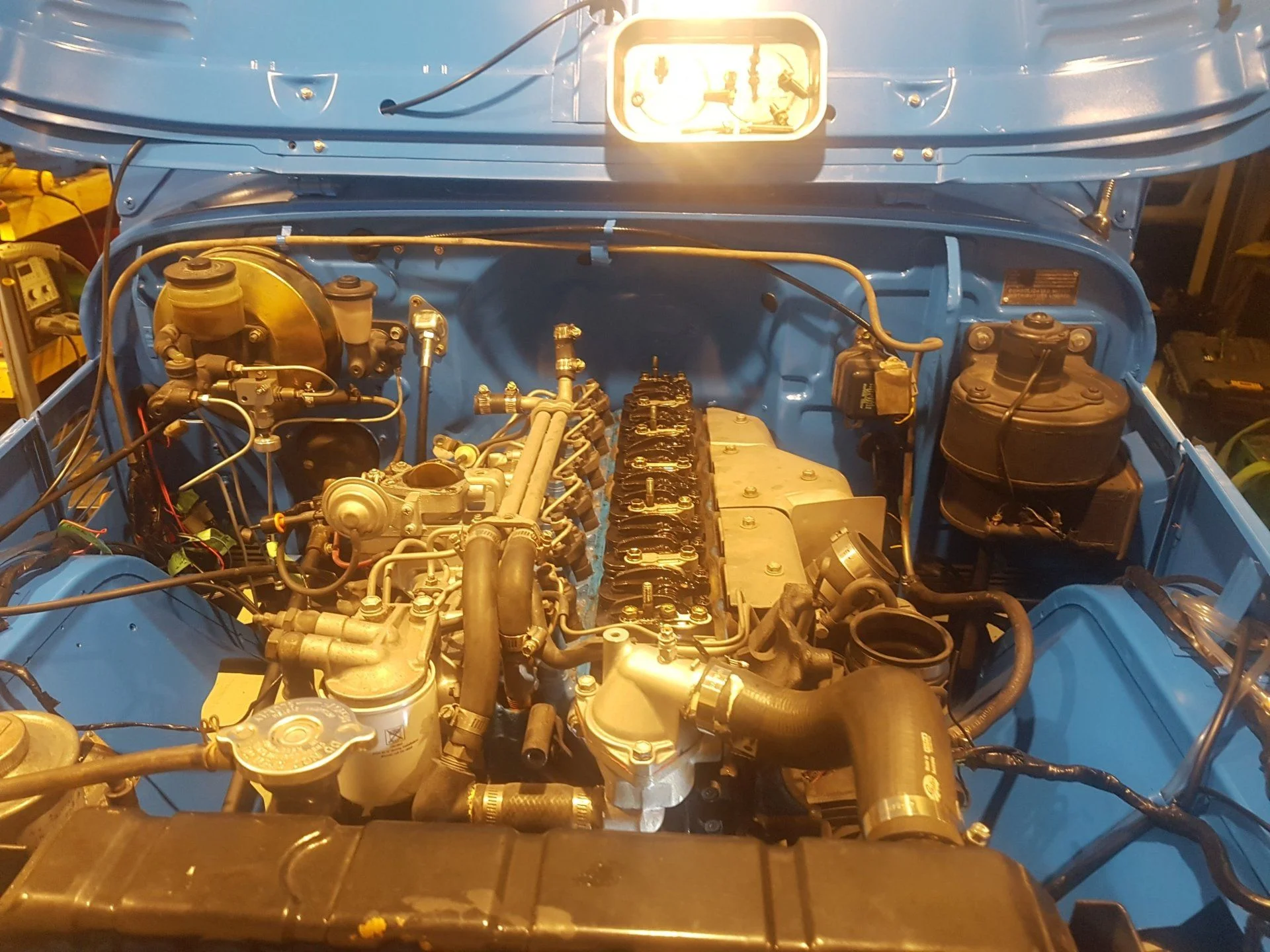

Had the front end apart again, e locker is in the front. Wont be getting wired up till after cert as it's not a priority. Resonator welded in the exhaust, bit quieter to pass cert but lost the turbo whistle......

Glass is in, dont want to have to do that again. Hard job with some rope and my flatmate.

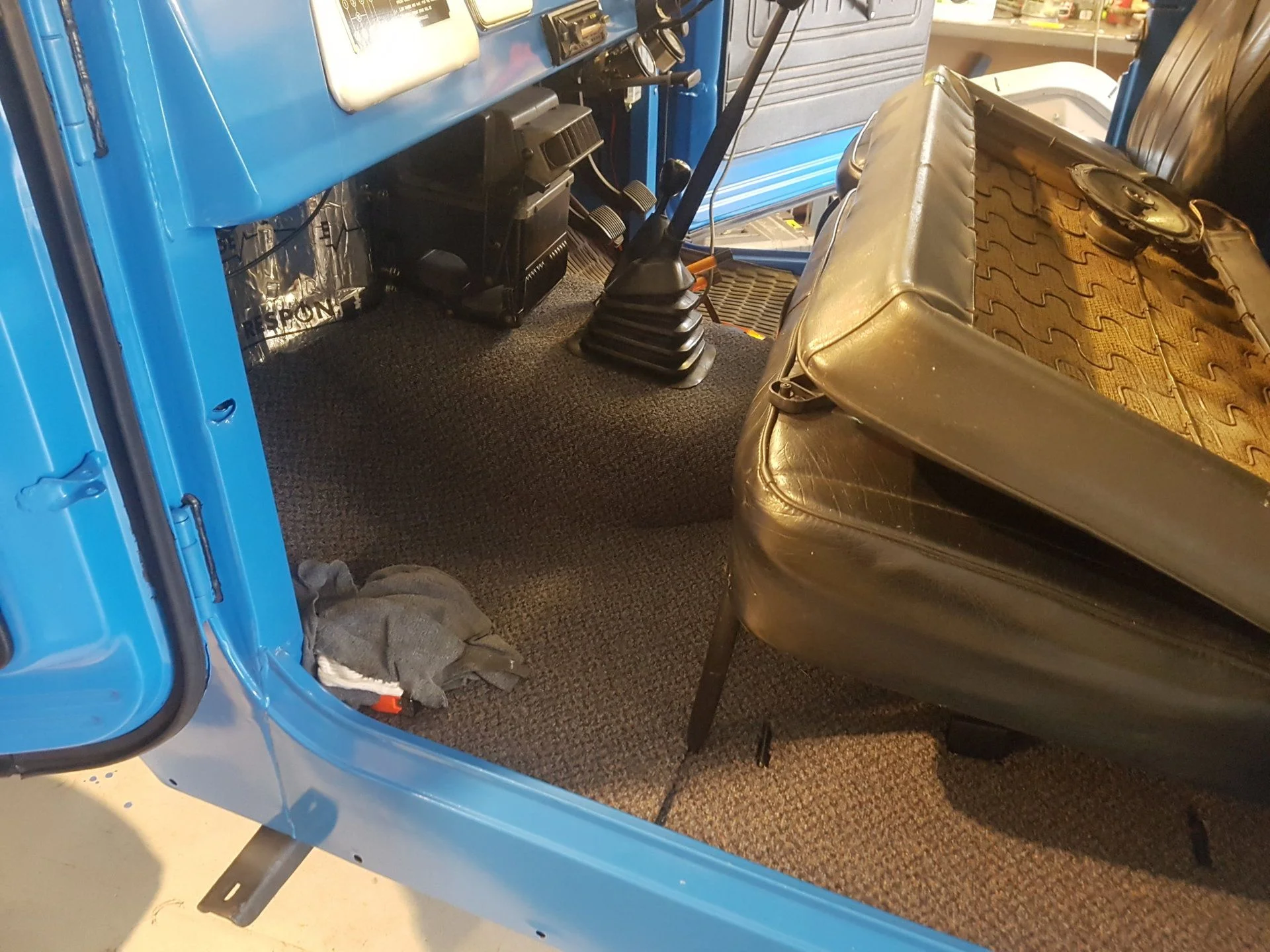

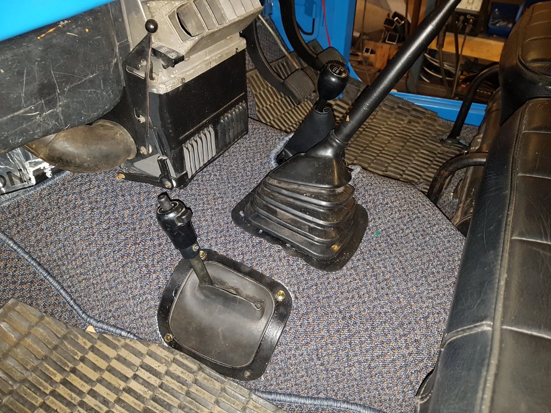

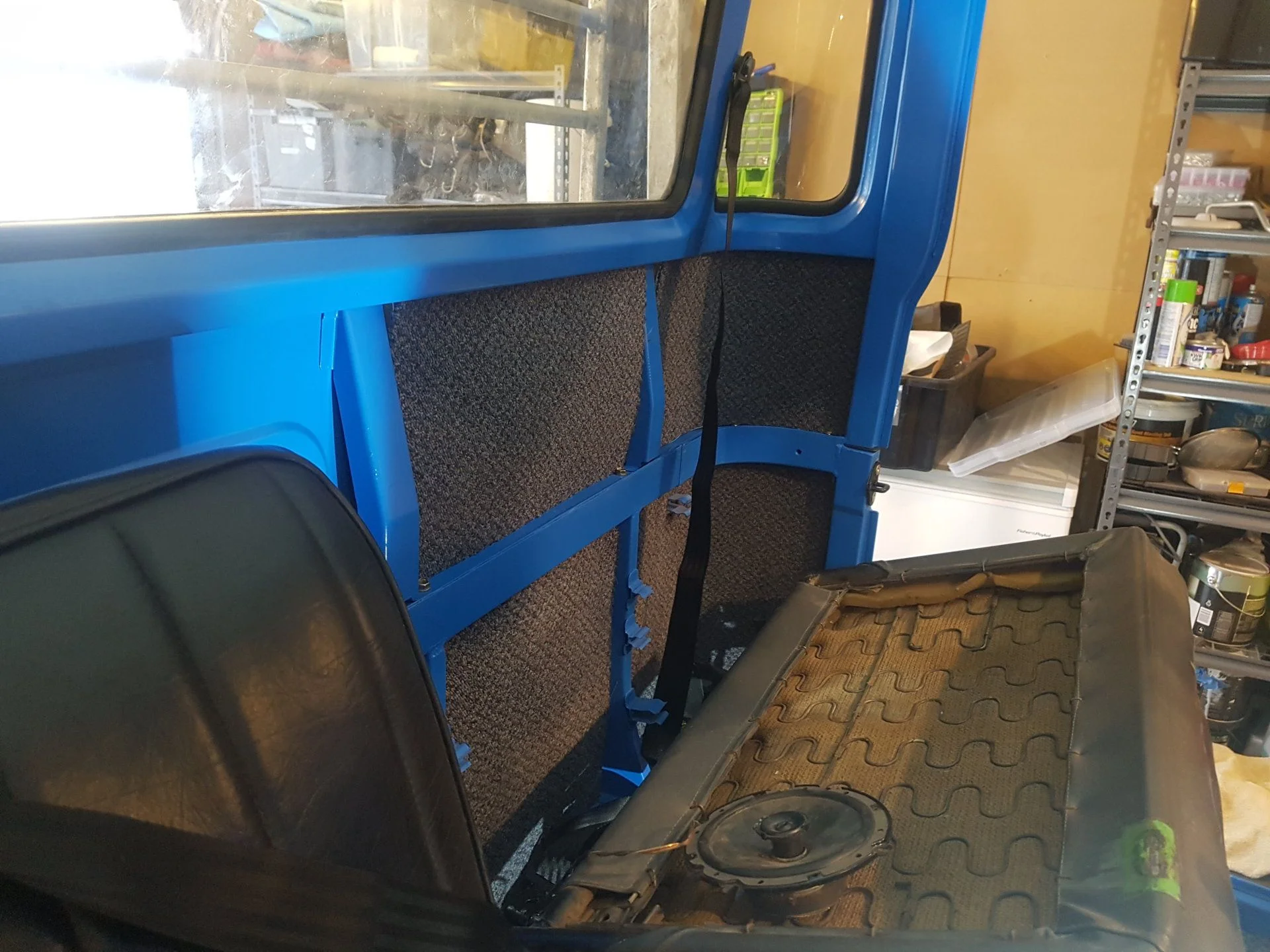

My neighbour over the road owns a carpet shop and came over and made up some patterns for the tub. Carpets cut with underlay, should make a big difference with the road noise. Cut some squares for the back pannel behind the seat as I think quite a lot oof noise comes through there. Any other areas you guys recommend? Done body deadner on the underside of tub and will do inside the guards. And the is stick on soundproofing up the inside of the firewall.

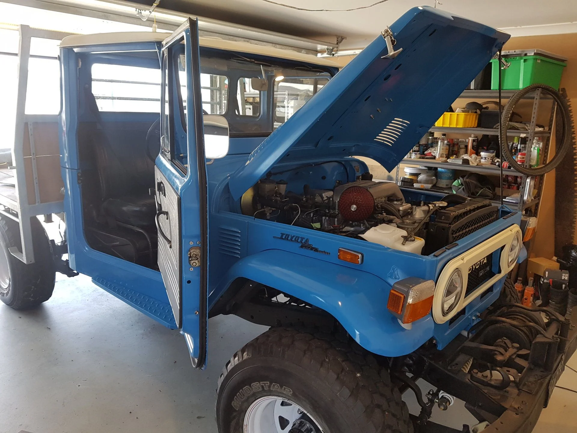

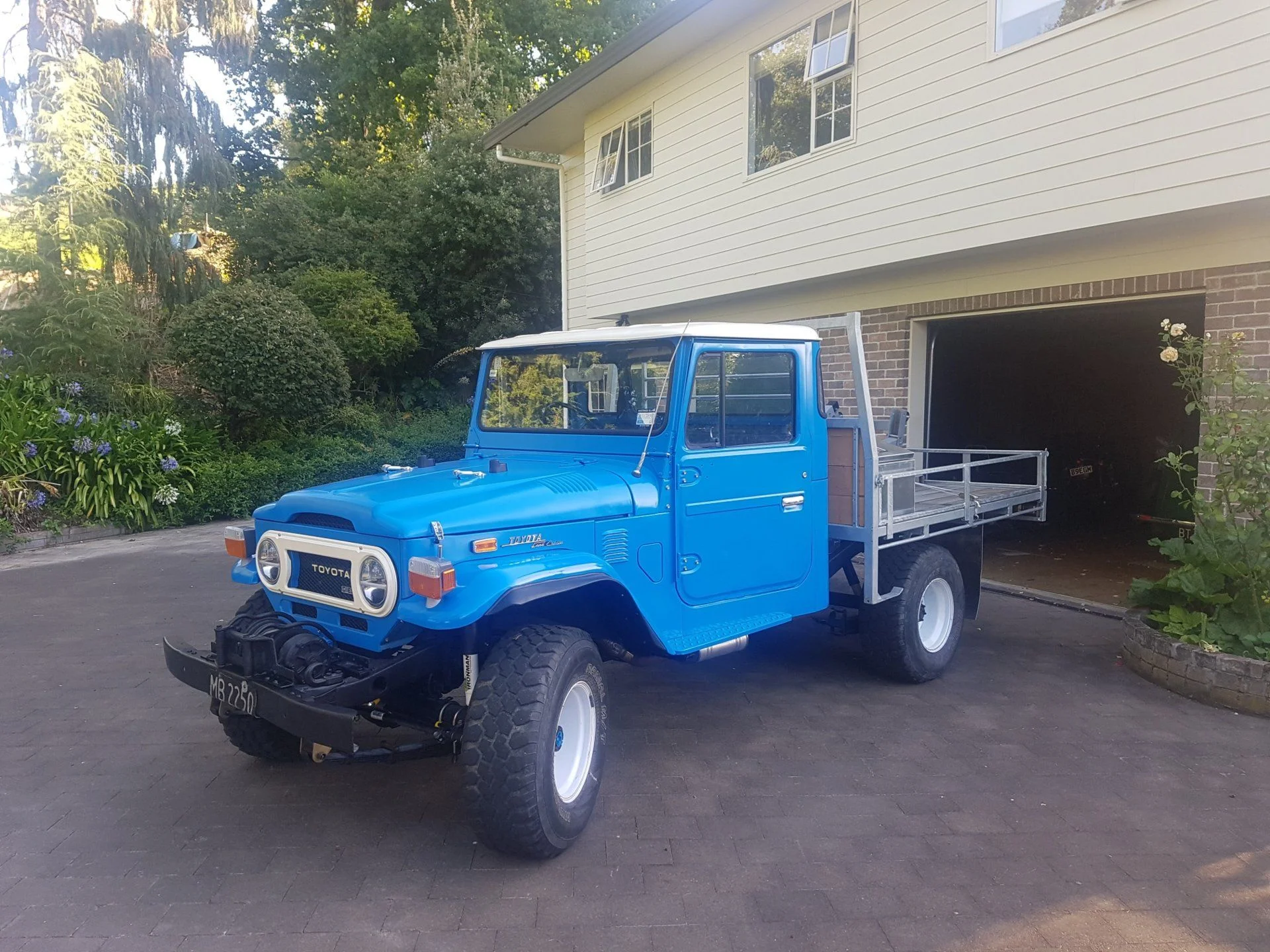

Should of taken a better photo..... Just about done. Finished the bodywork, wired the indicators, sorted the reversing lights, heater is in (but no pipes). Happy with how its looking just a few things to tidy up before cert.

Just about there, should be able to get it road legal for my planned trip in Feb unless there any any major hickhups.

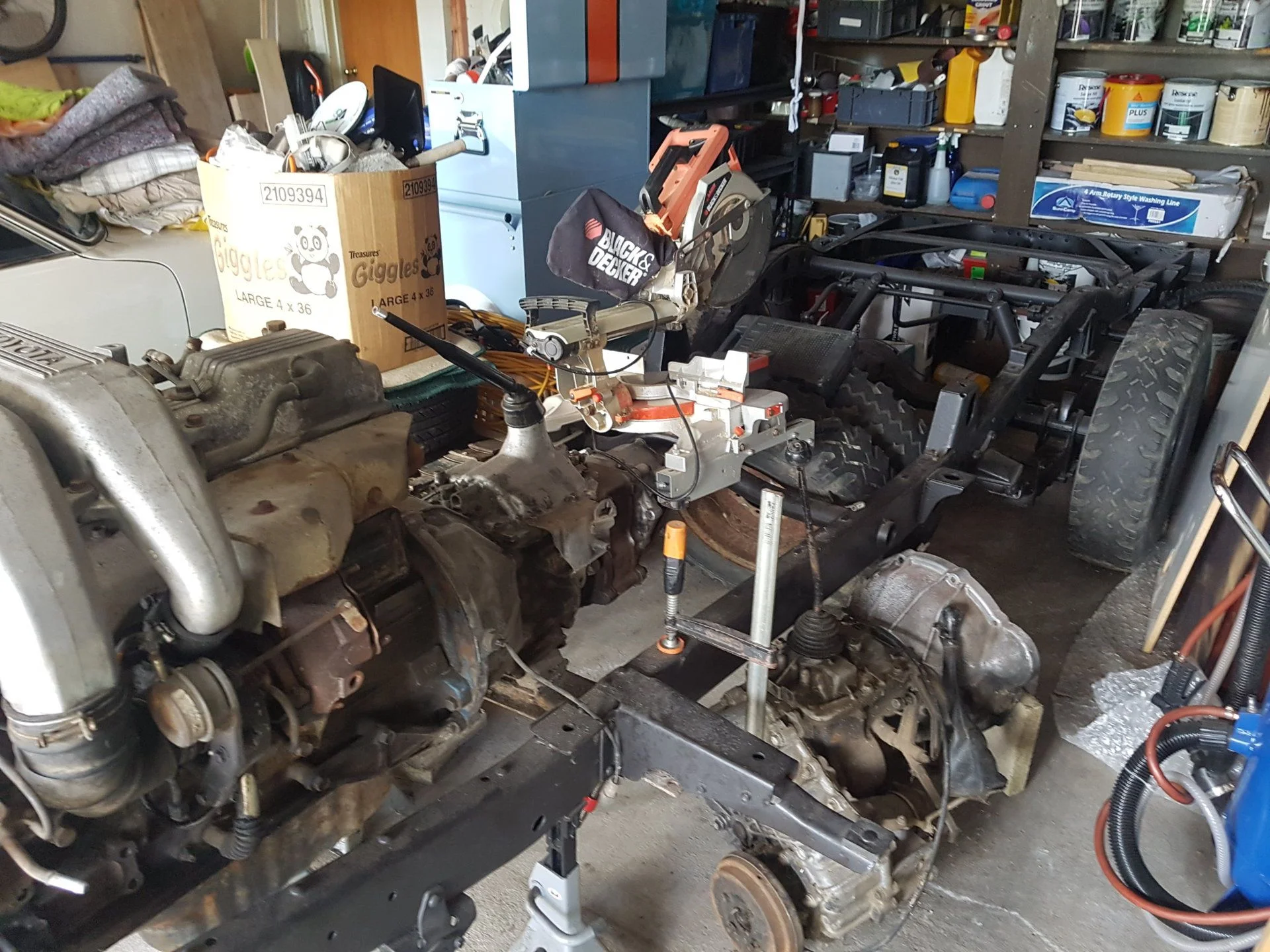

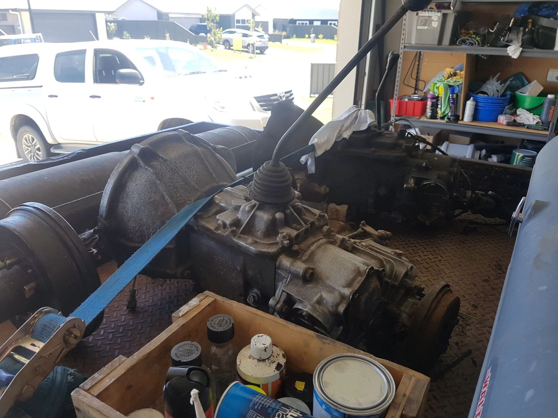

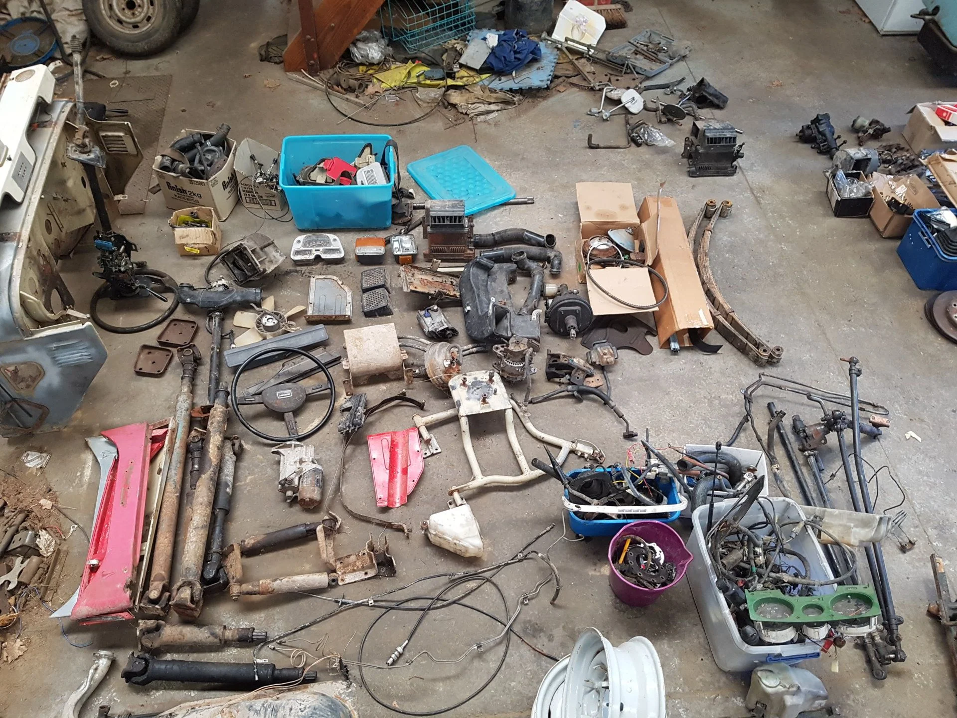

My mate and I ended up picking up a few parts of another mate. Including another 12ht, 5 speed, 2x4 speeds split cases (one includes handbrake), ff rear diff, 60 ps setup, early 45 chassis and a whole load of bits. Anyone in nz need any parts?
Last of the parts picked up at the weekend, took a while to move everything. Still need to find time to sort all the parts out.

My neighbour over the road owns a carpet shop and came over and made up some patterns for the tub..... Cut some squares for the back pannel behind the seat as I think quite a lot oof noise comes through there.
Like those rear panel pieces ... nice job on having good connections :)
Areas to recommmend to quiet it down ... I think you hit them all I didn’t see if you put anything under headliner ... I could have missed it ... but in such a small area that metal roof is like putting a garbage can over your head and jump around for an hour ... deadner on that would help
IF it’s still bad (highly doubt it at this point) you can wear ear plugs :meh:

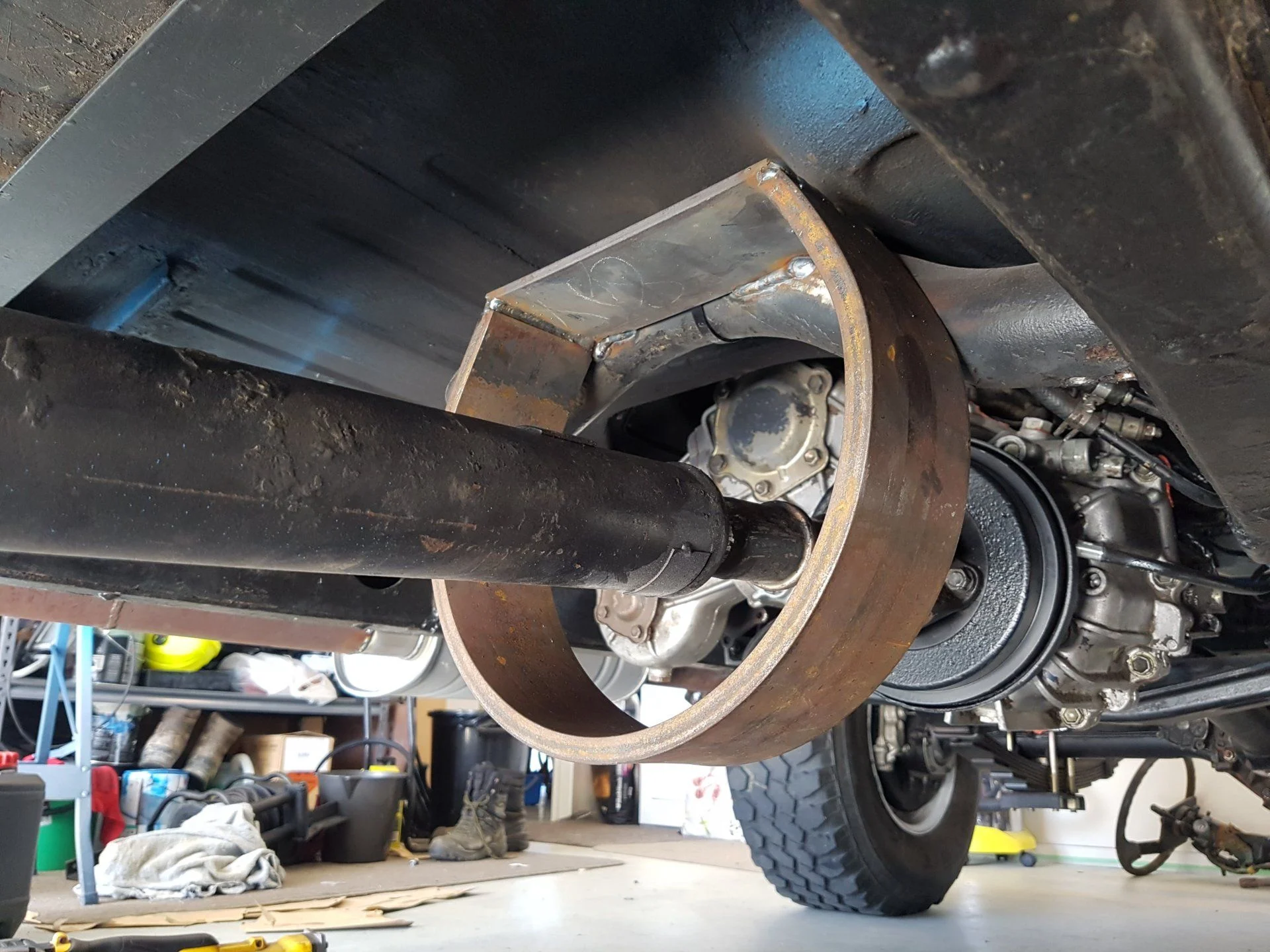

-Drive shaft loop, didn't like my design

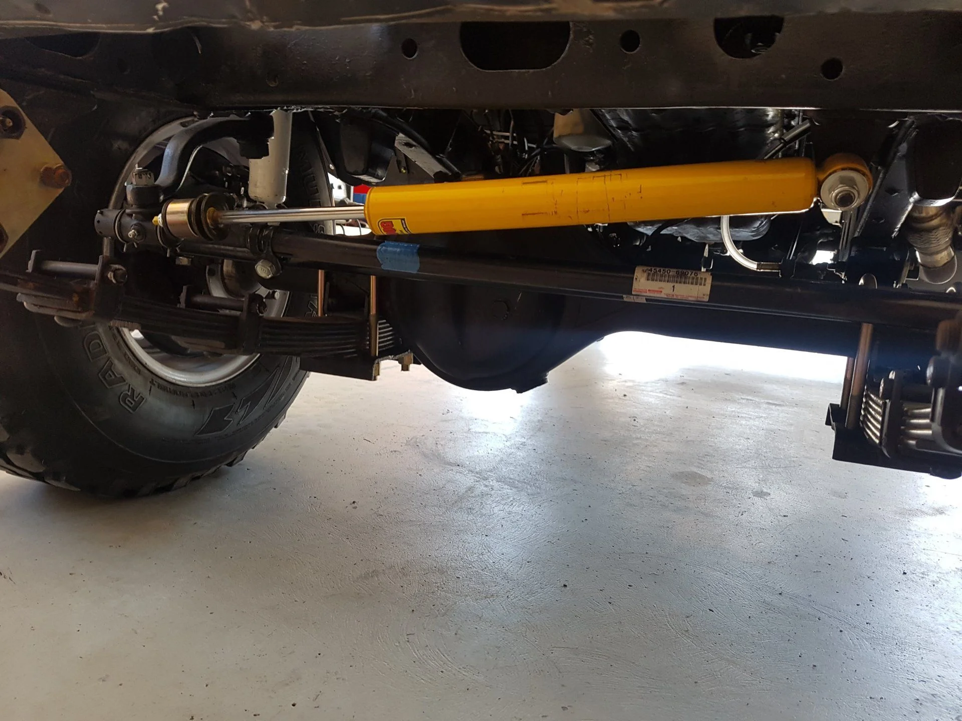

-Remove the return to centre spring on the steering damper

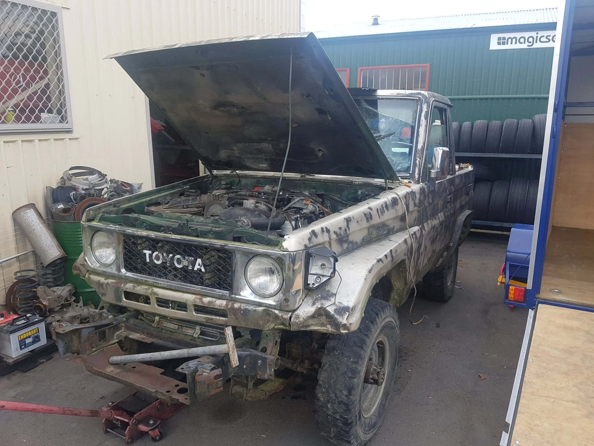

At this rate u should be ready for a 3200km trip around the top of the north island. In other news bought a bj74 SWB today, 13bt and double cable lockers. Joined the local 4x4 club and decided the fj45 is too nice where some of them go. This should be perfect, planning to do a rough paint job the same colour.
After picking the new 70 up and doing a few things on the on Sat I thought I should sort the cert list out.
Made a new drive shaft loop, nz cert rules. Welded to the cross member and not going anywhere now.
Taken the spring off the steering damper and put spring washers on the engine mounts. Thats 3/4 of the jobs done.

The 70 was a bit of a impulse purchase but not a bad buy for $2k, definatly not regretting it after finding most of the issues at the weekend.
Current 70 issues:
-Clutch is stuck to the flywheel
-Hole somewhere in the radiator
-Alternator is not charging
-Rear brakes are garbage.
But the engine runs mint, small hint of white smoke when you bump the throttle but goes away quickly. The lockers, 4x4, hubs and front brakes work. The body has bugger all rust but no straight panels, chassis is good from what I can see but surface rust coming up on the running gear/front end so might need a strip and paint. I vacuumed all the rat poop out and water blasted the seats. Currently sitting in the back garden but it will be painted blue to match the 45, although not as nice a job this time.
12ht vs 13bt, similar engines in terms of function, will see how things go. Always preferred the 12ht but the 70 is perfect for what I want. I may try and find a live chassis and body to get it on the road again but might be a while.

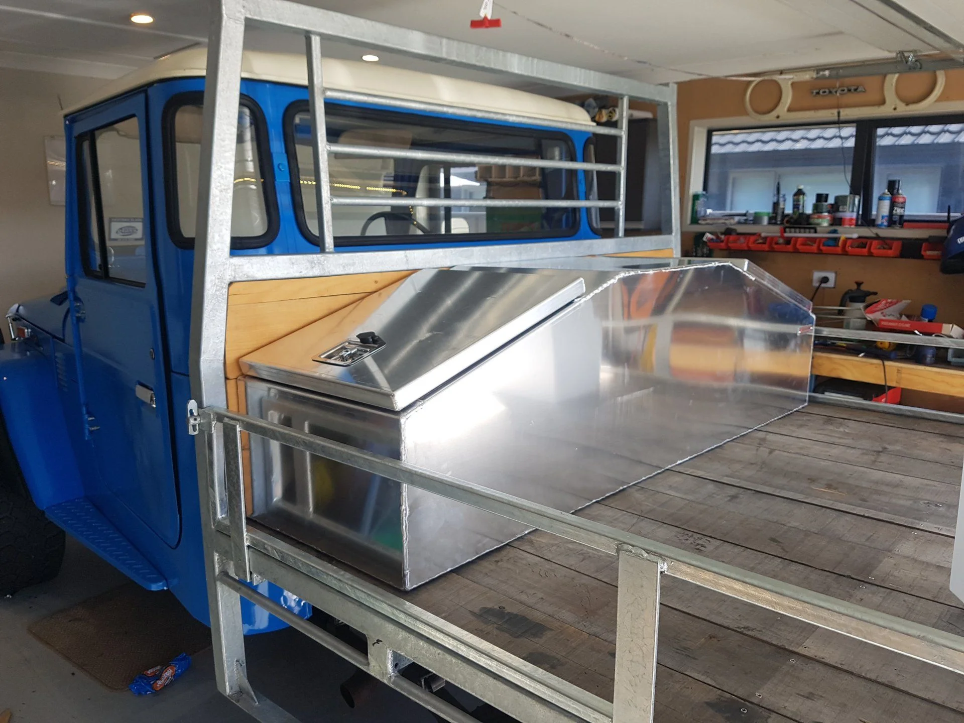

Bought a alloy tool box for the back after deciding secure storage room for my trip was going to be short. Really happy with the Duravault box, well made and fits nicely. Going to install some LED's inside along with two work lights on the headboard.

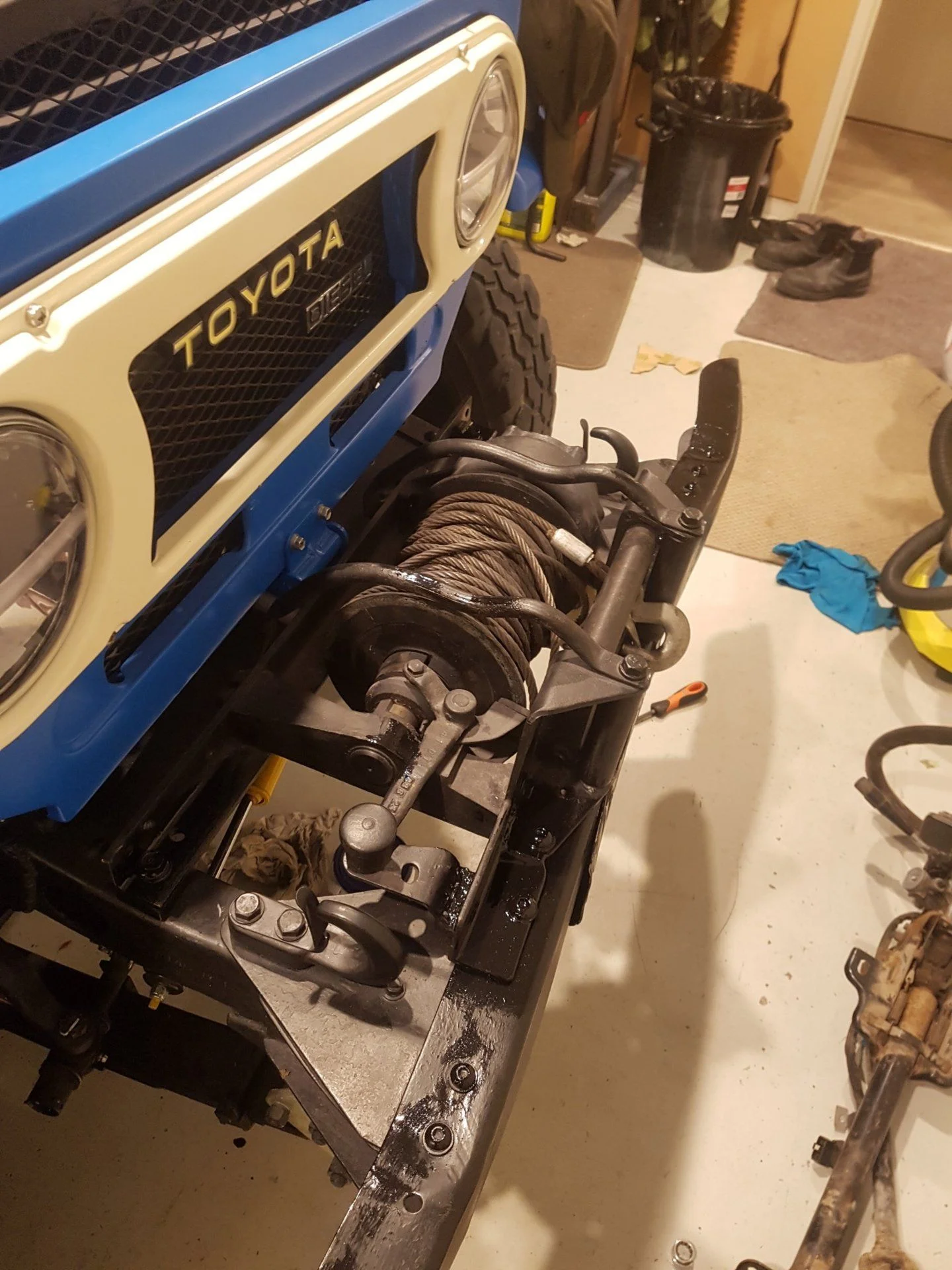

Winch is back in after lengthening my winch shaft. Has to make it three sections again with another bearer block. Ended up making up a section with 55 series steering column parts and uni's. Worked well with a much better spline and the shaft is two piece and can be taken apart in the middle at one of the uni's.
Ended up re-gaping the rockers last night after a drive, thought the engine was getting a bit of a tick but is must just be in my head as only three needed a bit of a adjustment.

Got my winch sorted, shaft made up along with a lever.

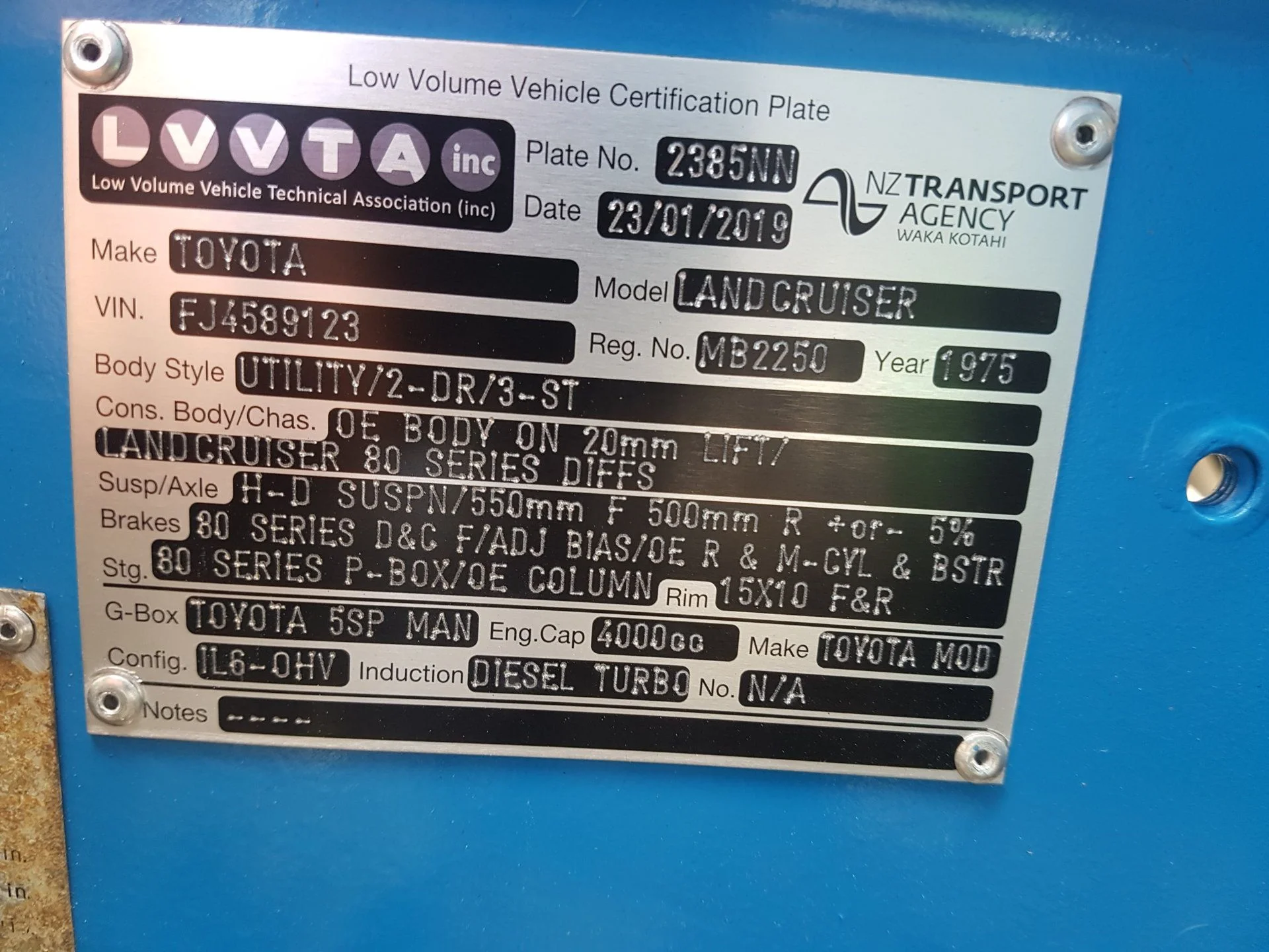

Any got my shiny cert plate which makes my truck road legal along with a wof. Updated my registration but still have to sort out RUC km.
1899303
Cert plate is a bit wrong as it says 80 series brakes and diffs even though it's a mix of 60 and 70 parts......never even mentioned to the guy any 80 parts. Not sure if I should get it corrected or not.

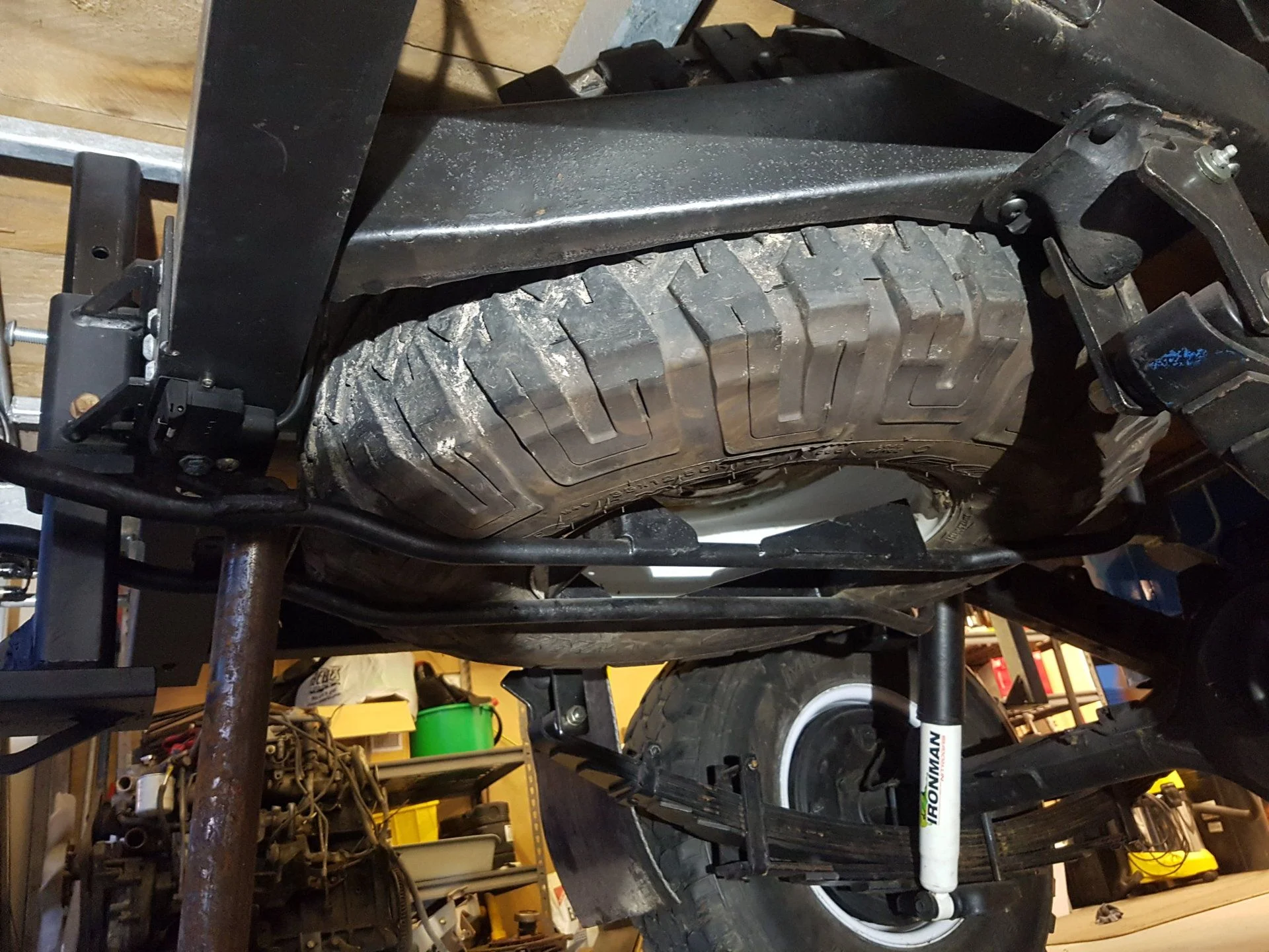

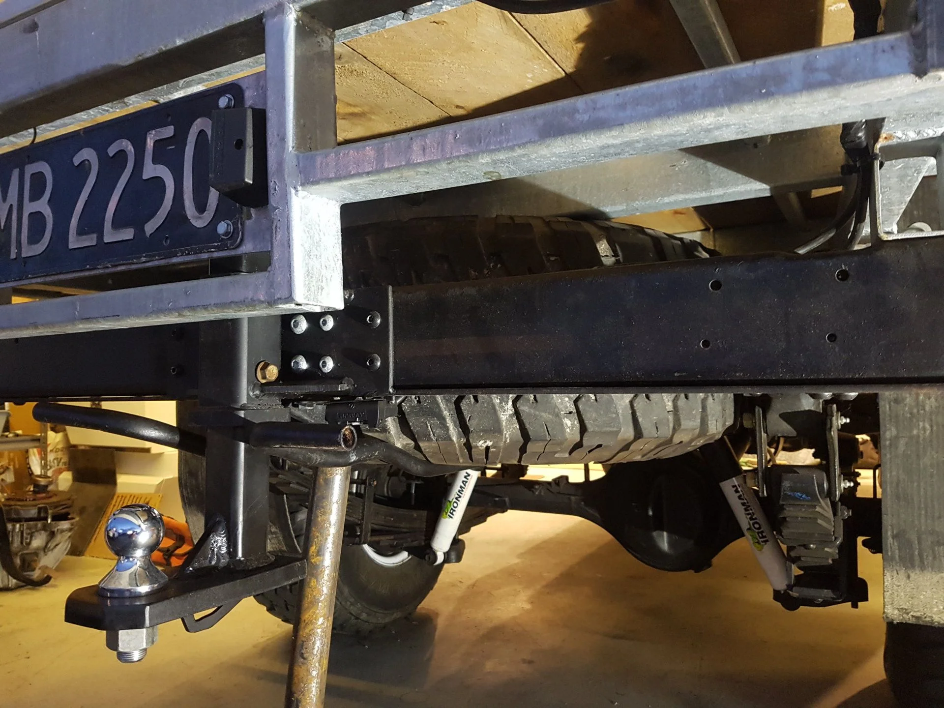

Decided to sort my spare tyre out, after looking at smaller options I ended up making a full size spare fit, 33 on a 15x10 rim.
1900045
1900046
Removed the small cross brace that a normal spare would sit against and trimmed the top edge of the diagonal support to match the bottom edge. A 33 hits nicely resting again the bottom of my flat deck. Tomorrows job will be to sort the mechanism to keep it up there.
1900047
Still planning for my 3200km trip which I am leaving for a week on Monday. Few minor things to fix up including deck sides, spare tyre, work lights and undersealing my front guards. But most should be done this weekend. Three of us are going on the trip with one mate driving his 70 series up from chch. Map shows the rough route in orange but not that well. Starting and finishing in Napier, bottom right of the map/route. Got the first 8 nights/stops drawn on but not much after that. Will be posting photos.
