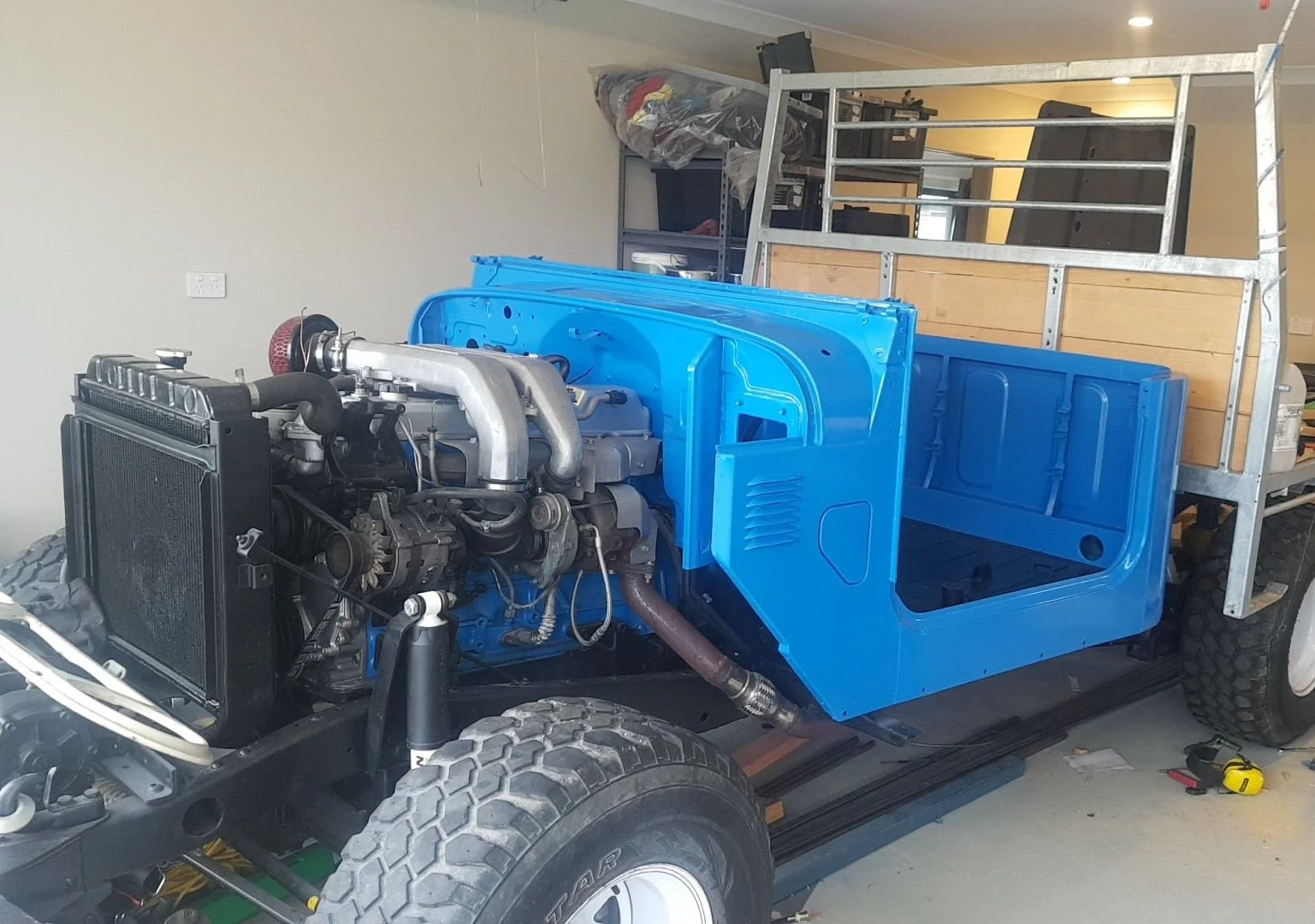

Got the tub pack on the chassis after sorting a few things out underneath. Rewired the sensors for the gearbox after cutting the wires to get the gearbox off the last time. Also welded a threaded plate to the battery tray to take the battery clamp, replacing my cable ties.

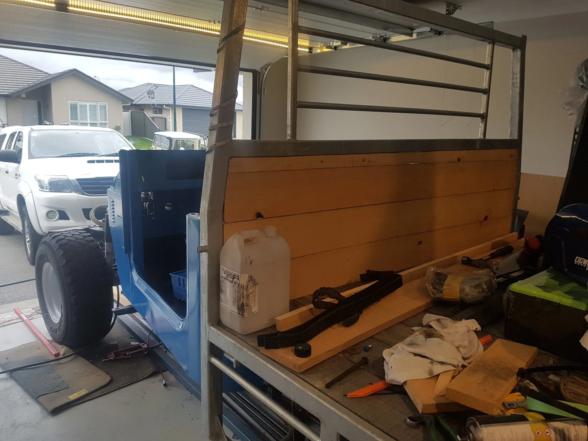

Finished the headboard off too, screwing the last macrocarpa boards in place.
Happy how it's sitting, got to sort some body bolts out as my old ones are shot. Good to get some space back in the garage. Trying to decide which way to head now, fix and paint the back panel or do the front guards.....

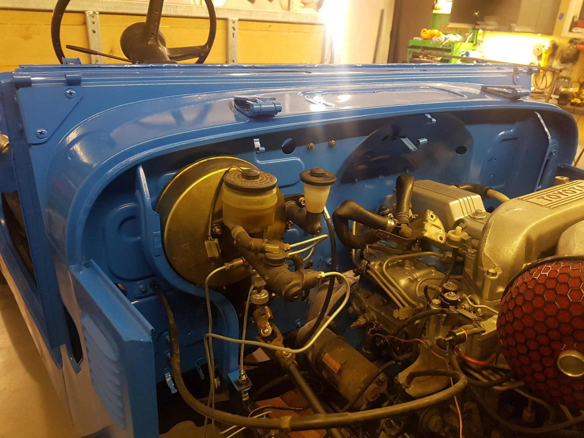

Ordered new nuts and bolts from over land metric, they turned up yesterday and started putting a few things back in like the peddle box, brake booster, throttle pedal.
Got mostly stainless for the outside but got a few packs of yellow zink bolts for other spots. Really happy how they look so ordered some more as I used half of them last night, the way this build is going I might as well go all new hardware :) Looks nice and save me painting bolts.
Attached a few bits to my truck, pedals, steering wheel, clutch master, brakes, fuel tank.

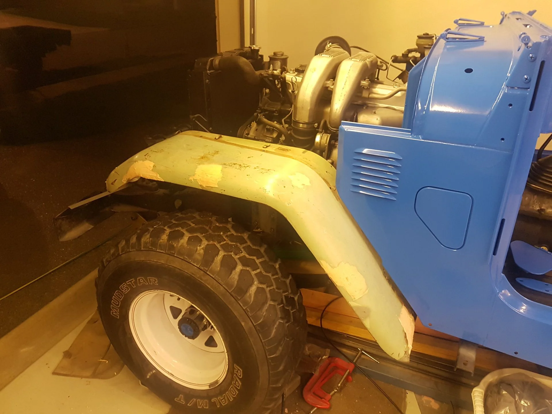

Test fitted my old guards along with the fibreglass ones, will take sone time to get tyem to fit right.

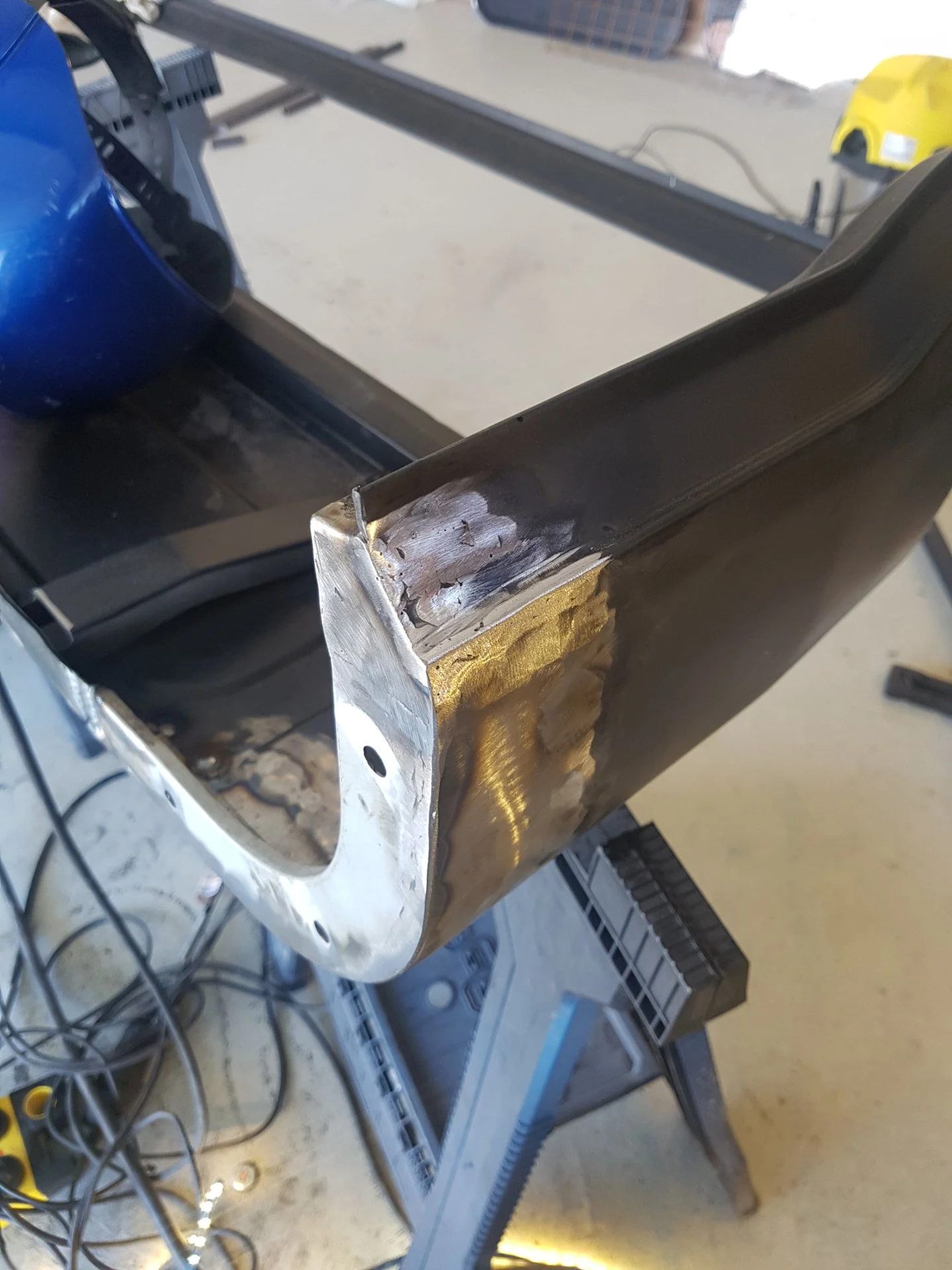

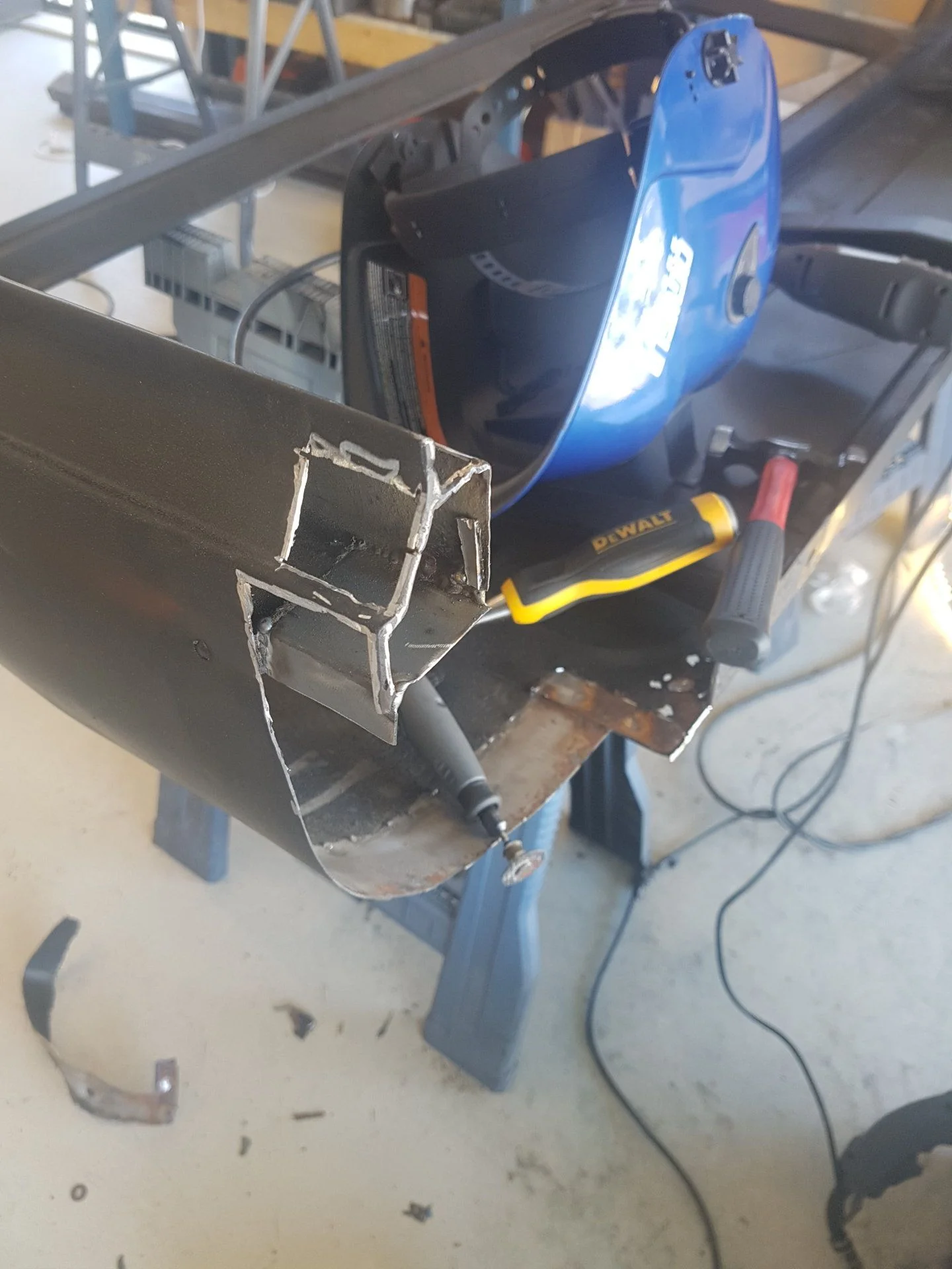

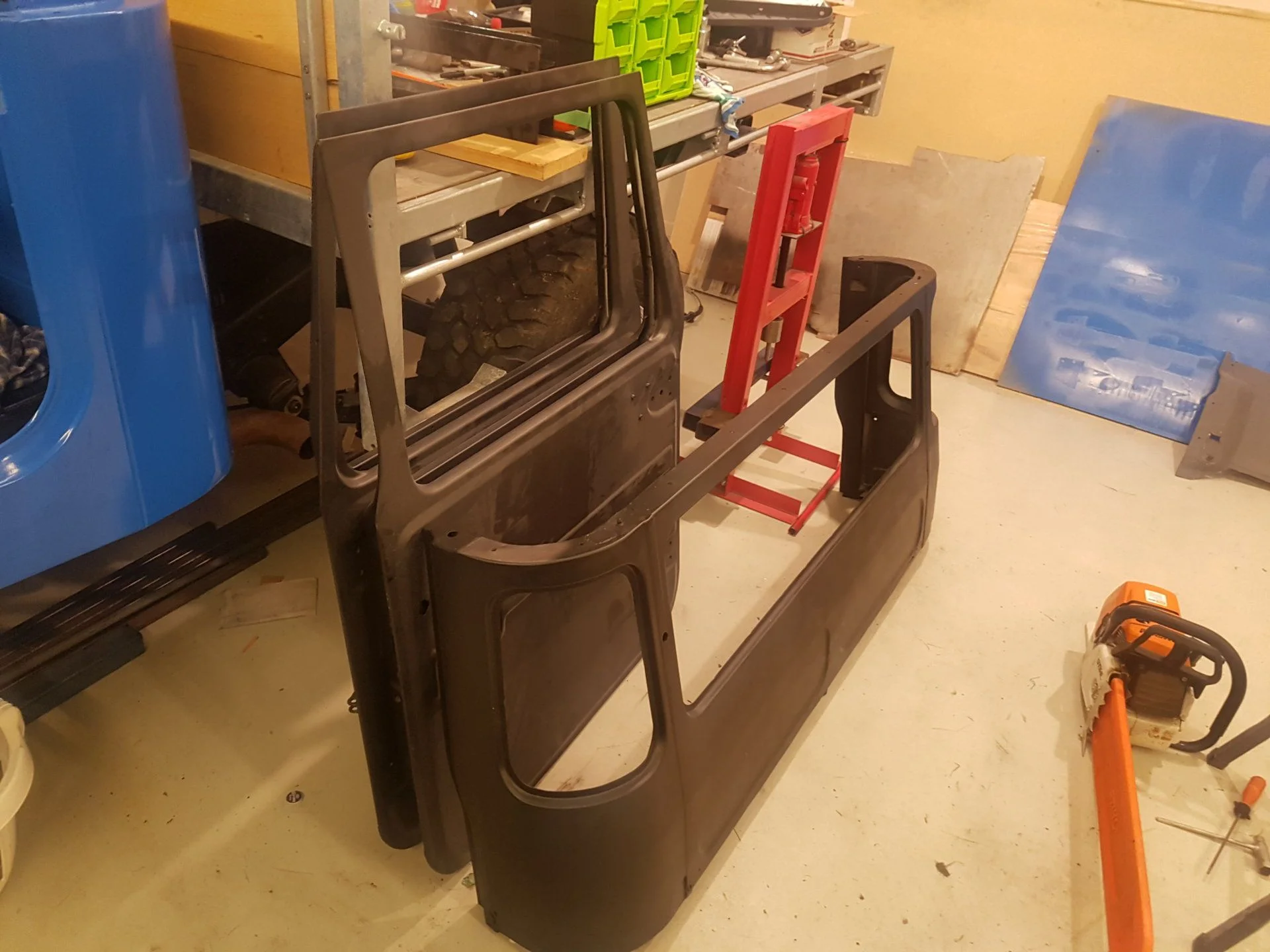

Found some time to start the panel work on my back panel. Been putting it off was i know who much of a pain in the ass it would be. Passandgers side us mostly done, rebuilt the pillar ànd the corner after stripping out my last attempt.
Needs a tidy up with the flap disk and a bit of filler here and there.

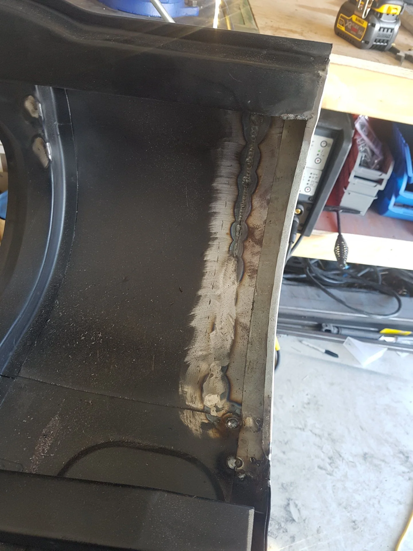

Currently working on the drivers side which was a bit worse. Cut out all the holes and thin areas and built it back up.
Still lots to do......
Came out quite well after a full day's work.

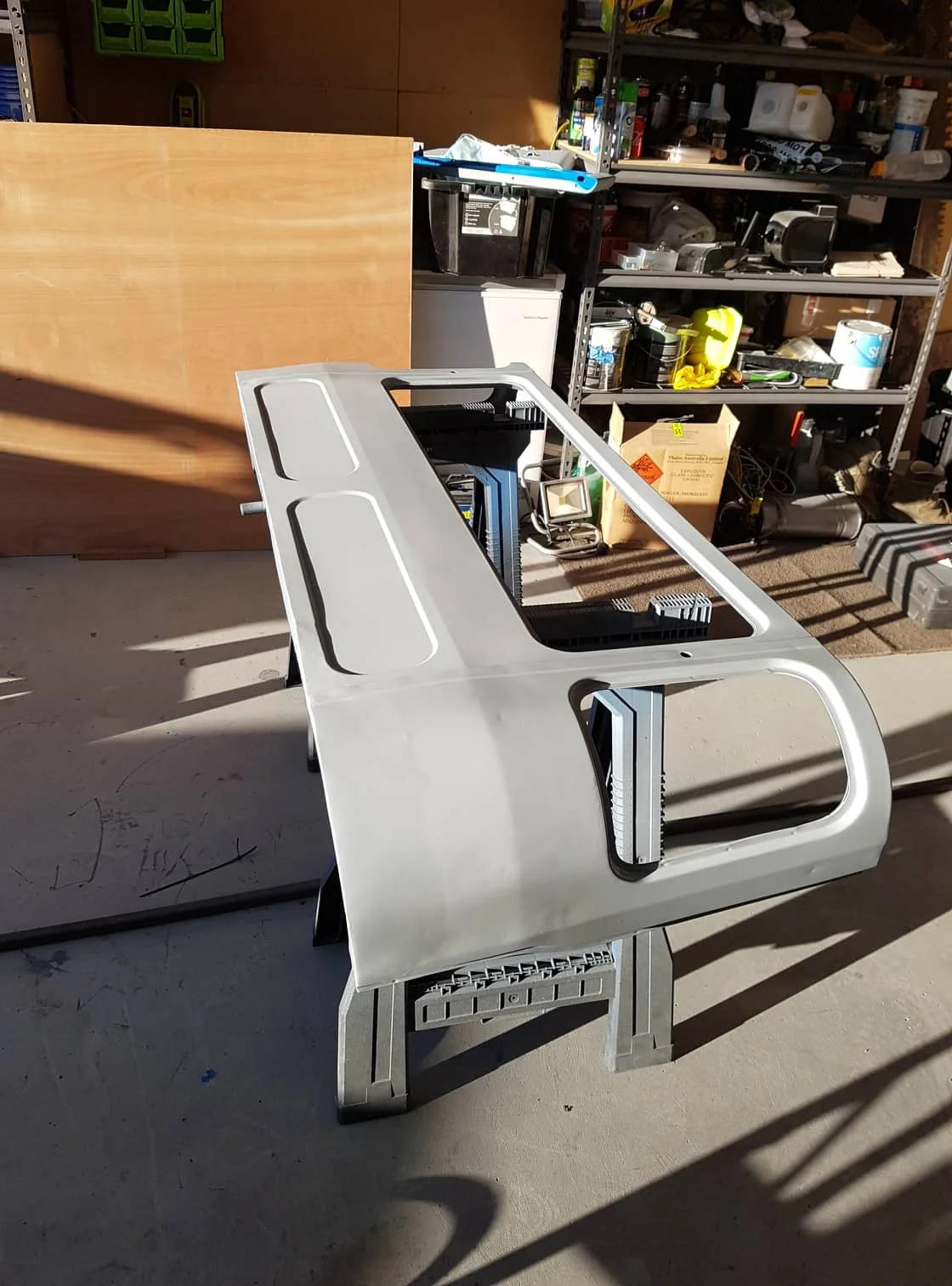

Shot a couple of coats of primer after tidying things up.
Still requires a bit of filler and sanding before primer filler/top coat.
Will seam seal tomorrow after work then tidy the panel up. Got the doors to sand too so may try and get them both done for the weekend. Can assemble the cab then.

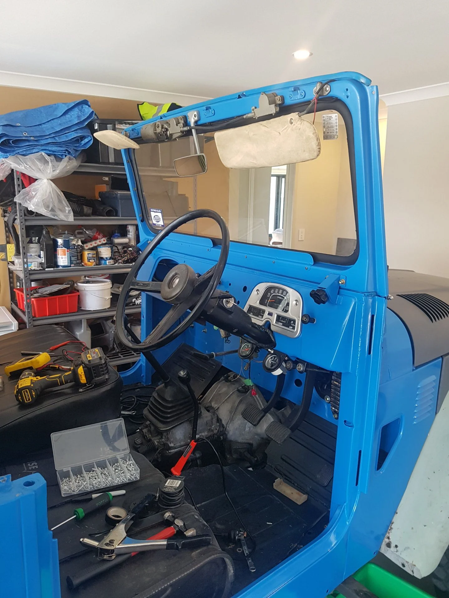

Found some more time to reassemble my windscreen and surround. Ran new wires up to the wiper and light.

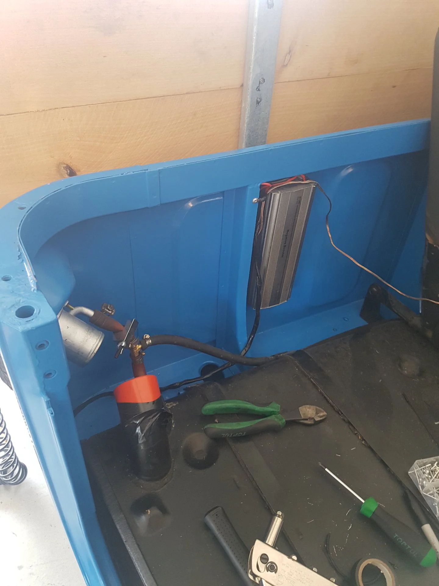

Wired up my 24v to 12v inverter to get the blower and wipers working again. Blowers fine but the wipers only have one speed which is strange.

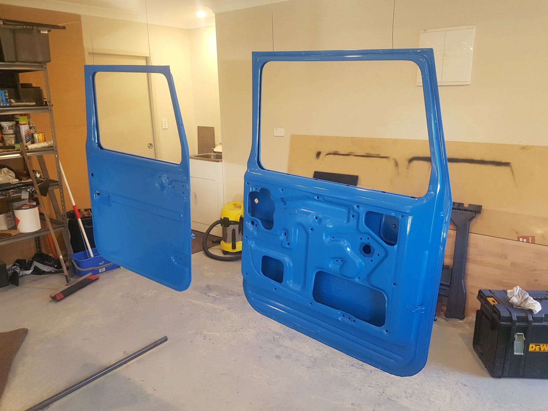

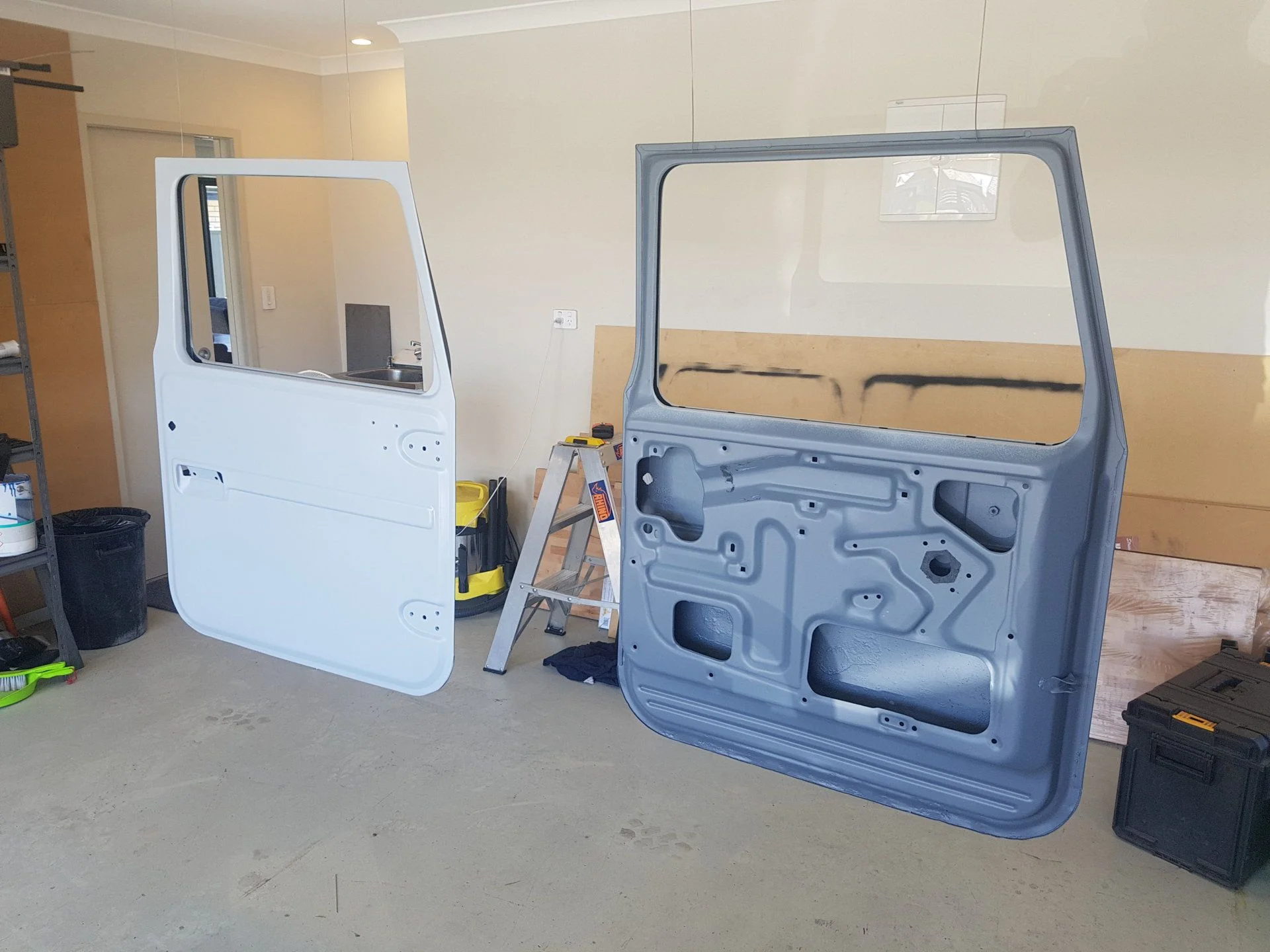

Finished bodywork on my doors, not completely straight but good enough for my build. Re Shot etch primer then primer filler on the outside.
Will resand tonight and hopefully shoot top coat on Tuesday. Should finish the bodywork on my back panel so I can paint that too.
New pup Jess is small and cute, this was about 2 weeks ago. She is about 5kg now and growing fast.

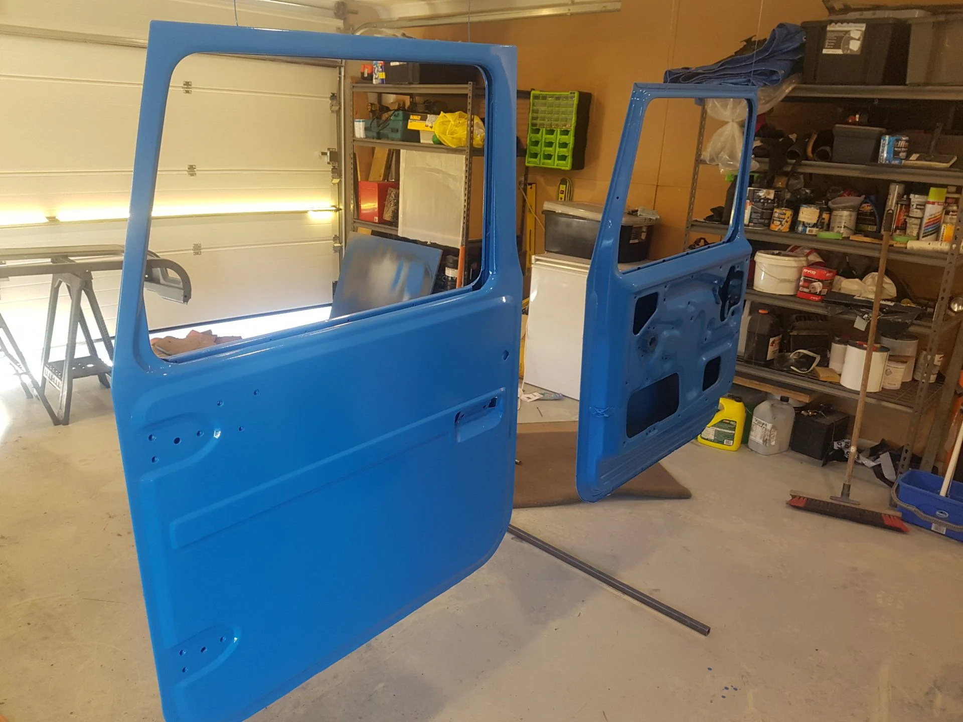

Got home after work and sanded down the doors again. Shot 4 coats of top coat and came out ok.
Drivers door is good but I can still see a few top many dings in the passandgers one. Ok for the moment, may come off again in the future.

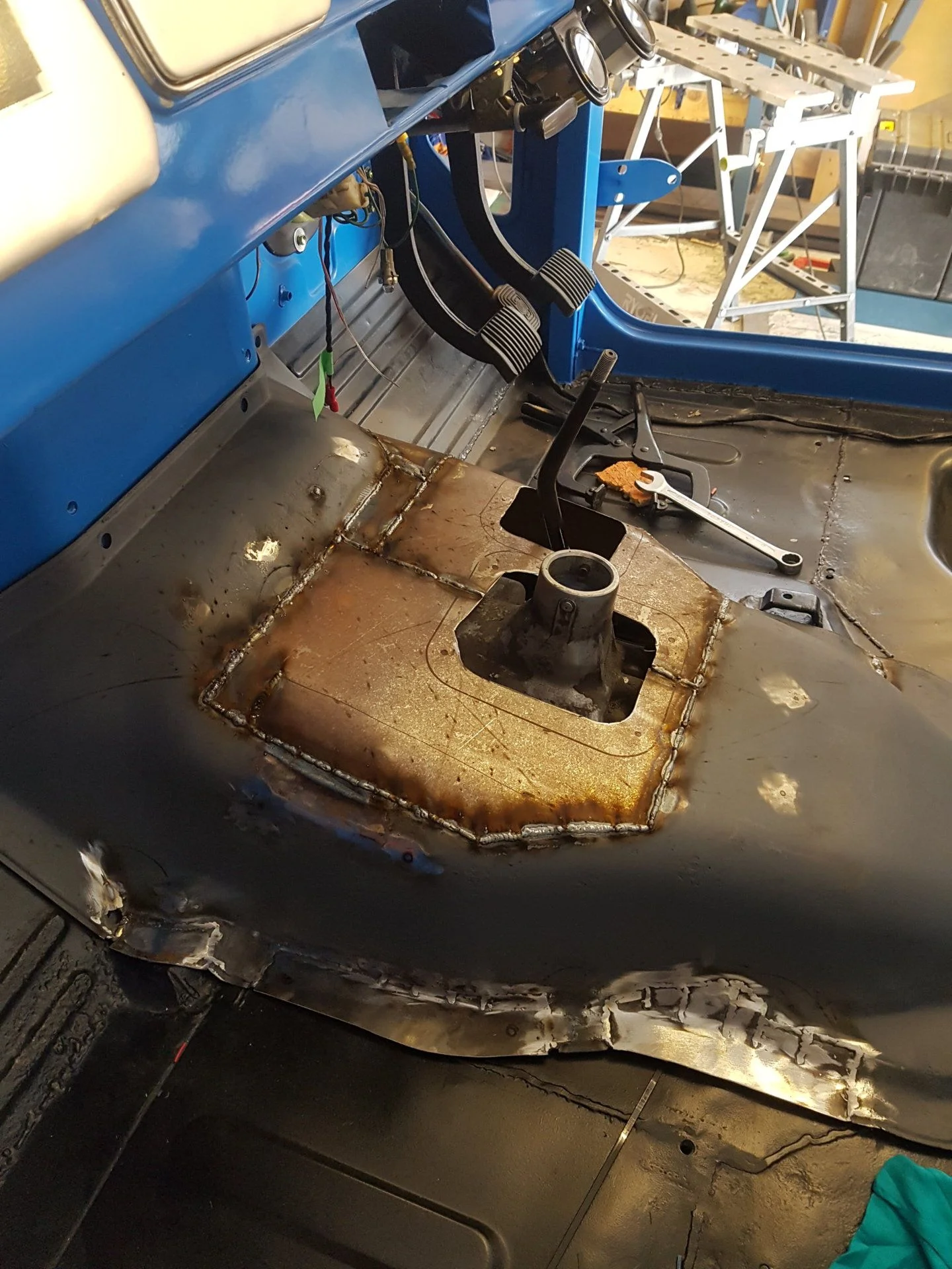

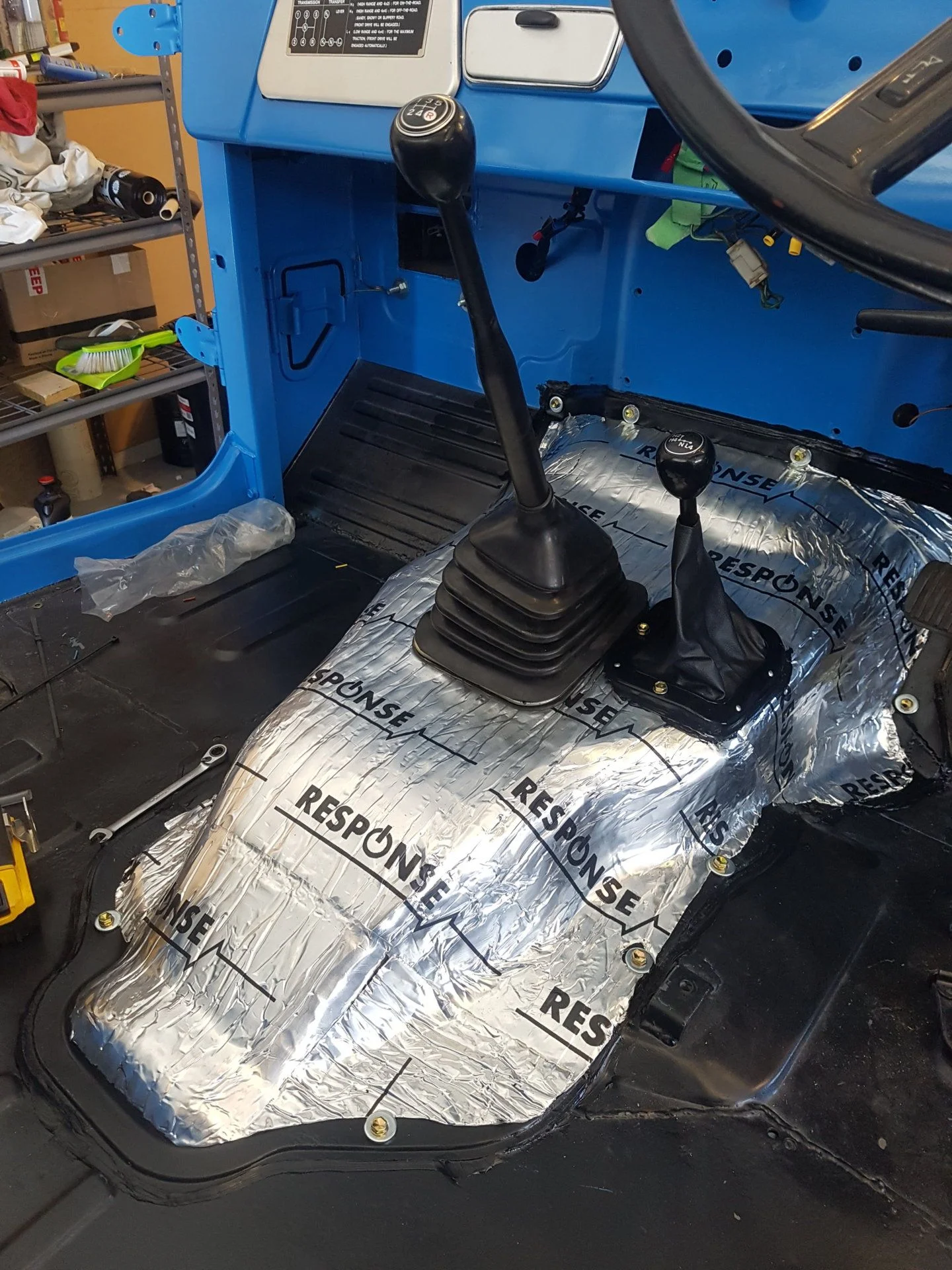

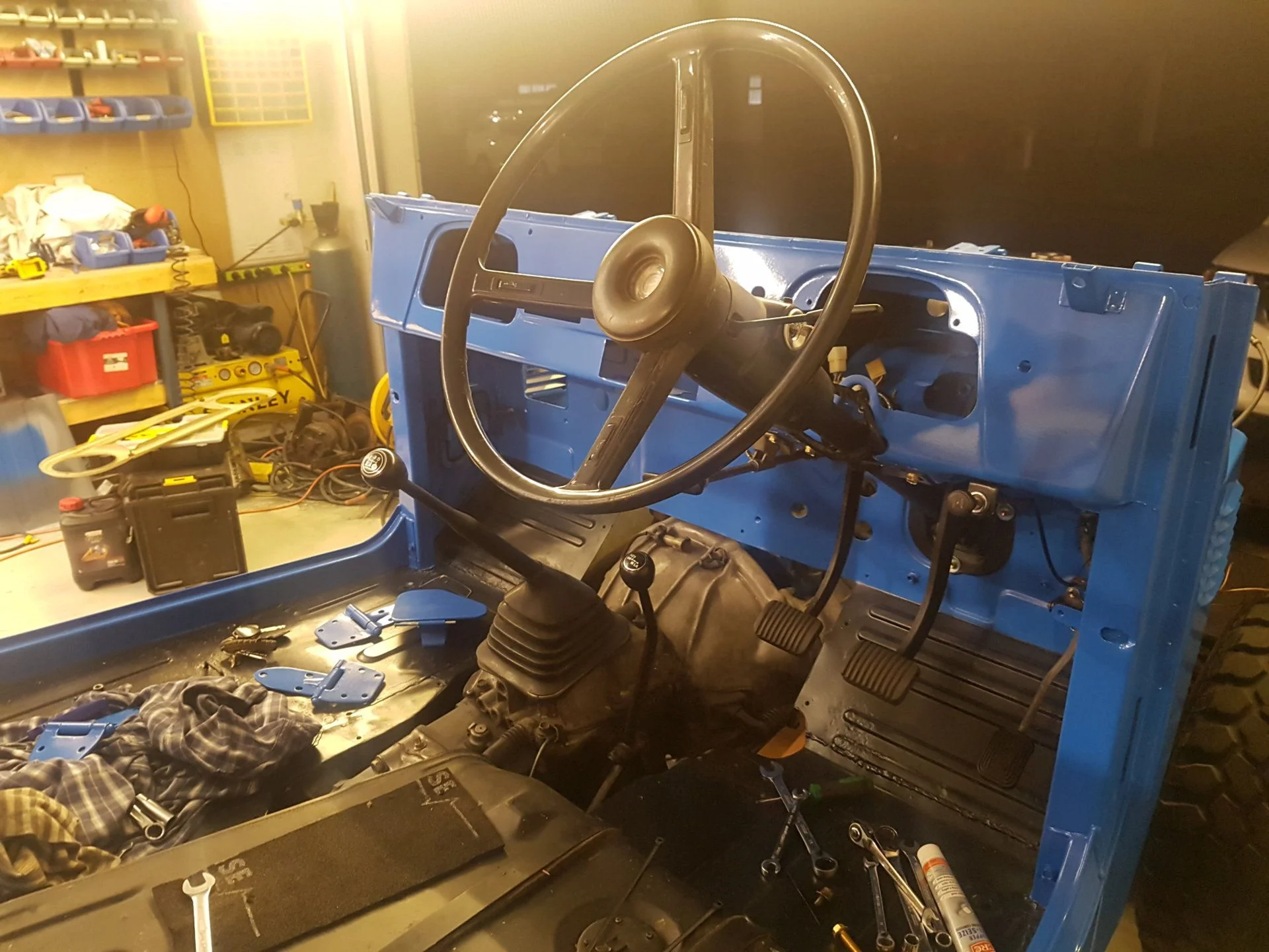

Spend quite a bit of time on my tunnel. Had to make it clear the gearbox and work with the levers. Had to fix a bit of rust in a few places too. Ended up cutting the gearstick and t case lever to change the angles.
Happy how things came out, looks fine after a bit of soundproofing.

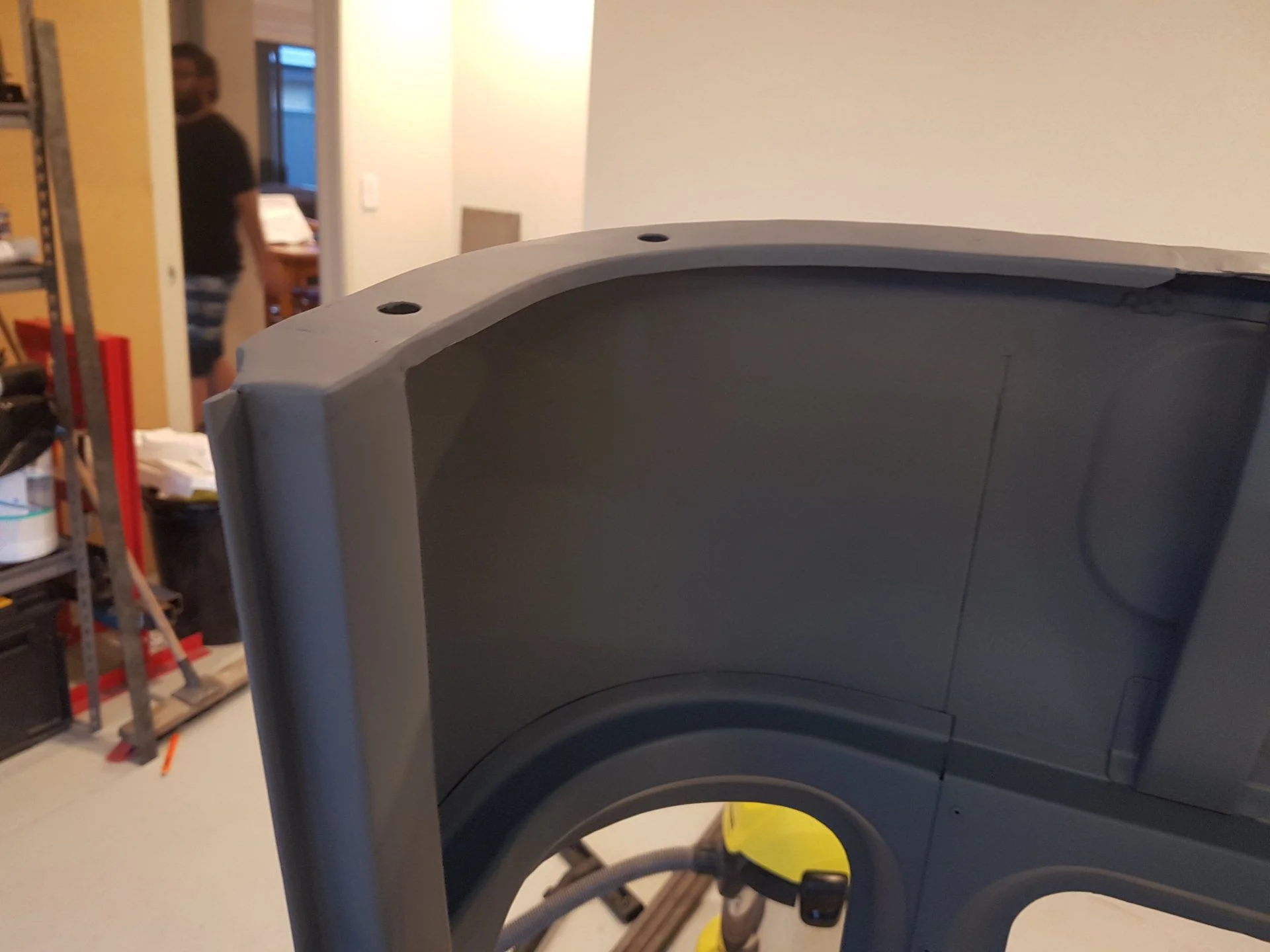

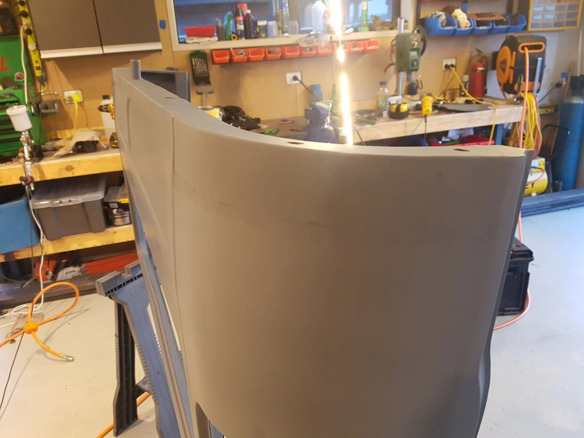

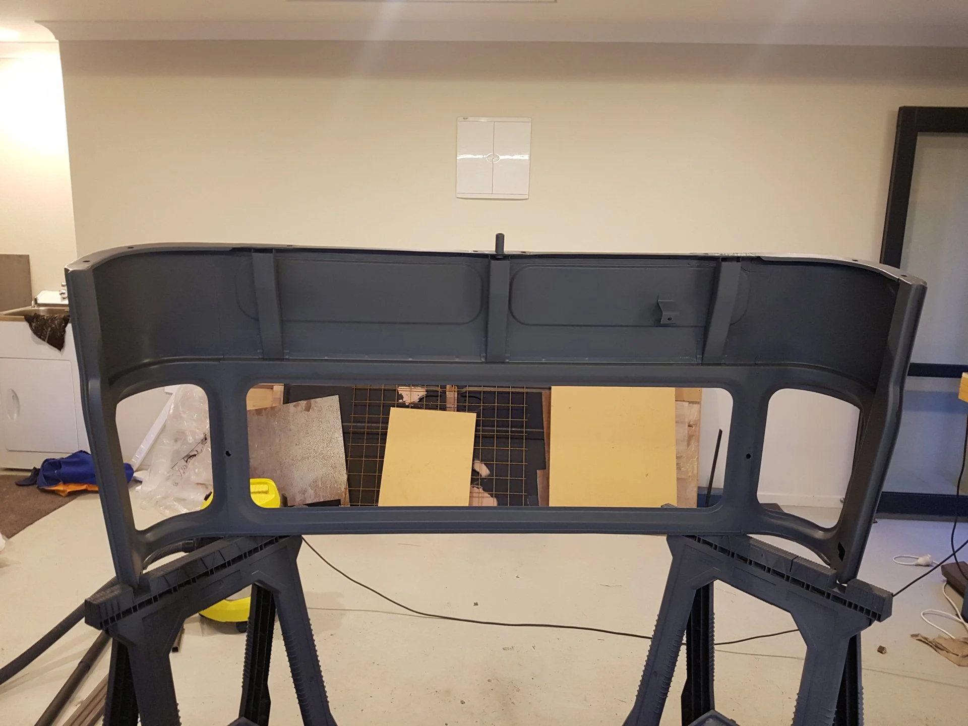

Finished bogging and sanding my back panel, took a while but happy with the result. Painted the inside this evening but ended up with a couple of runs so waiting till the morning before sanding and two further coats on the inside before painting the outside.

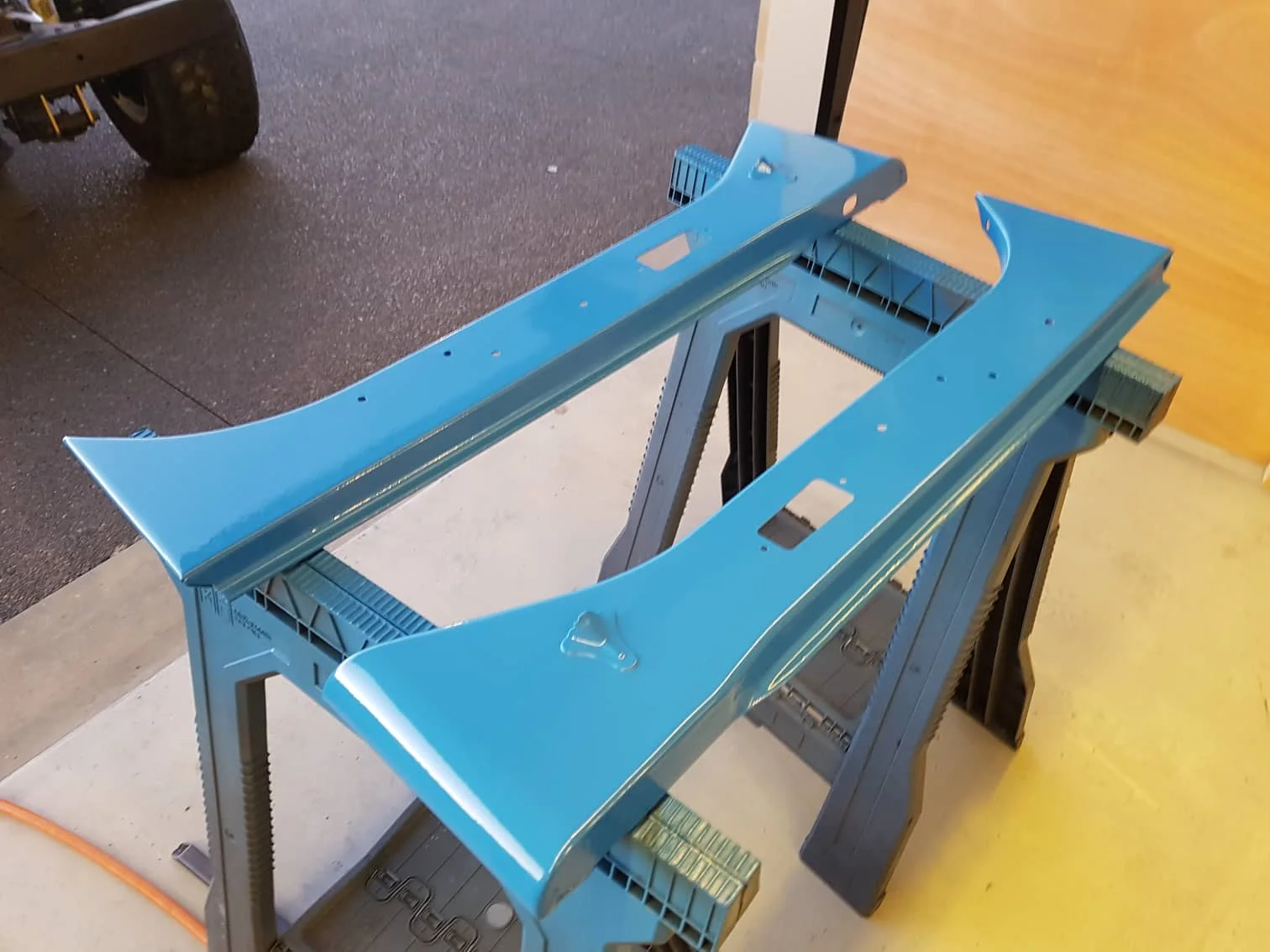

Also worked on the bits that site on top of the guards (anyone know the correct name?), welded up some other badge holes and a random hole and cracks. Bogged, primed and painted. Inside had two coats but another two for the outside in the morning.

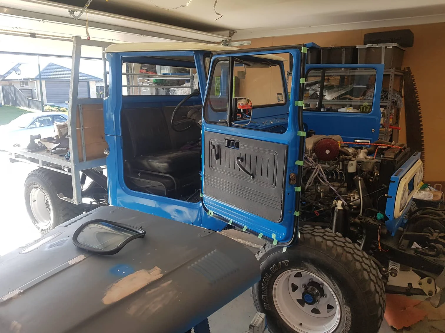

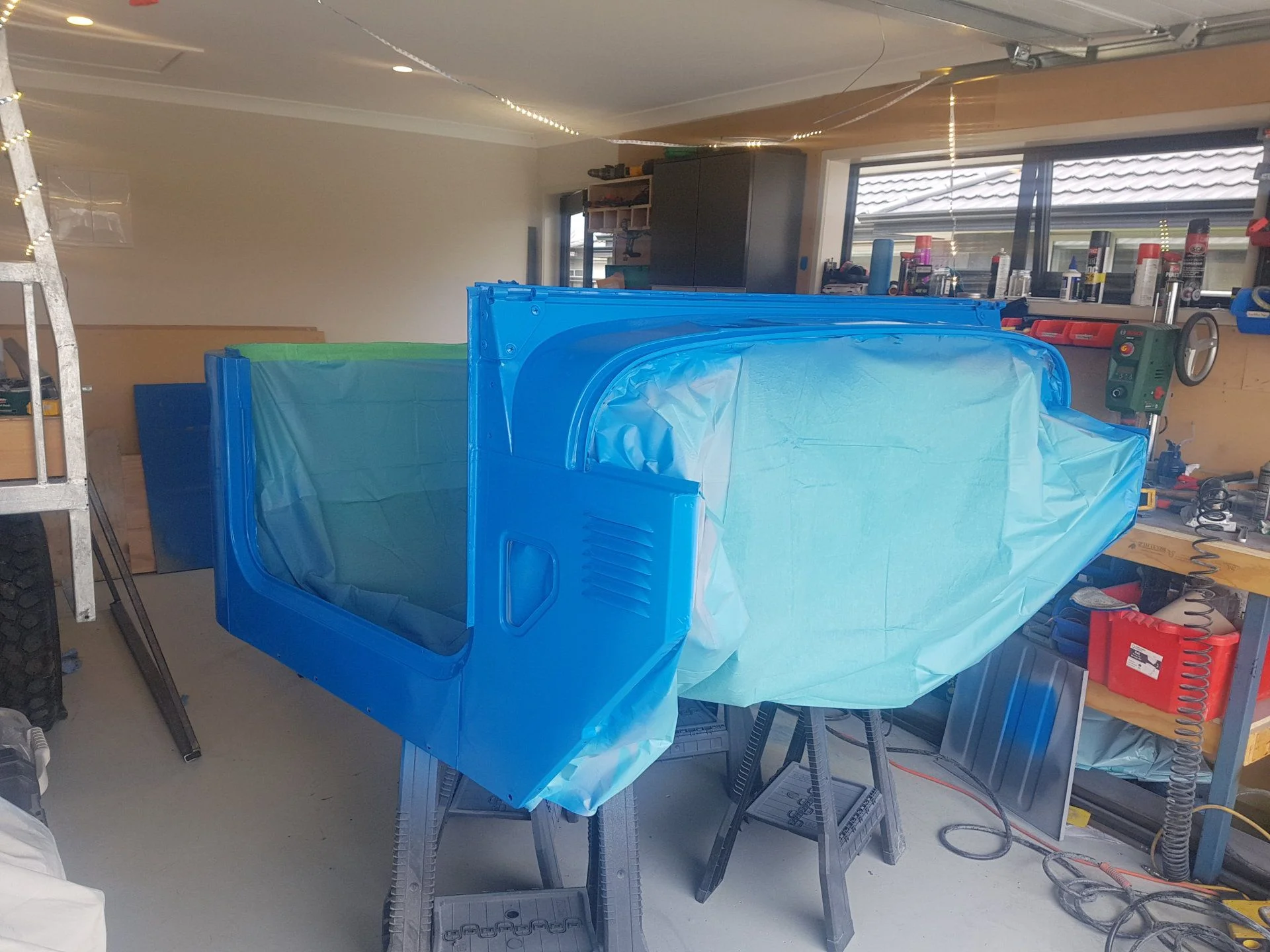

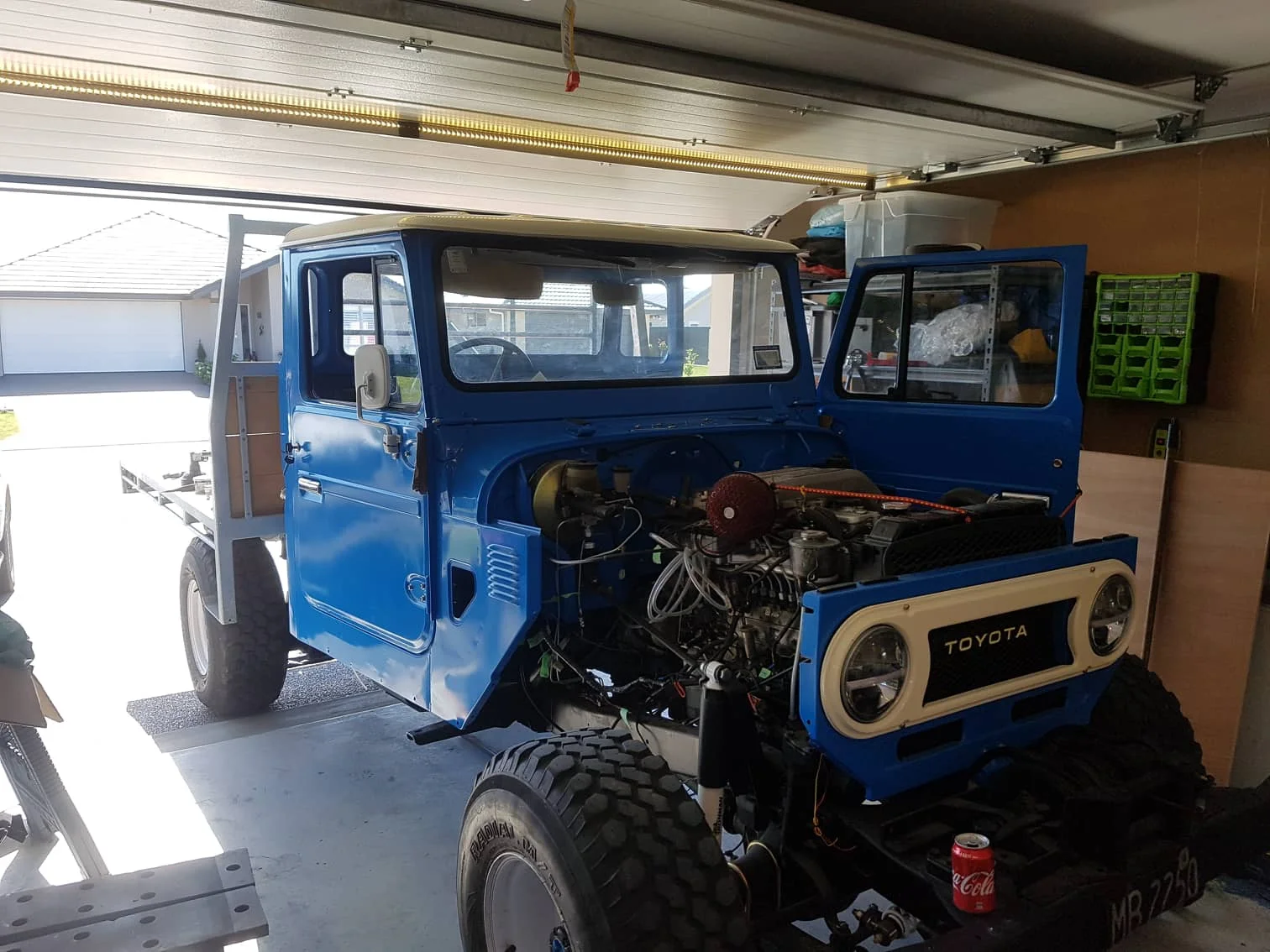

Made more progress, back panel is done. Painted and on along with the roof. Stuck the headliner in too, tricky job.
Got the right hand door seal on but opened the left hand one and it was another right.....might have to get back to all4x4 about that one. Even says left on the bag.

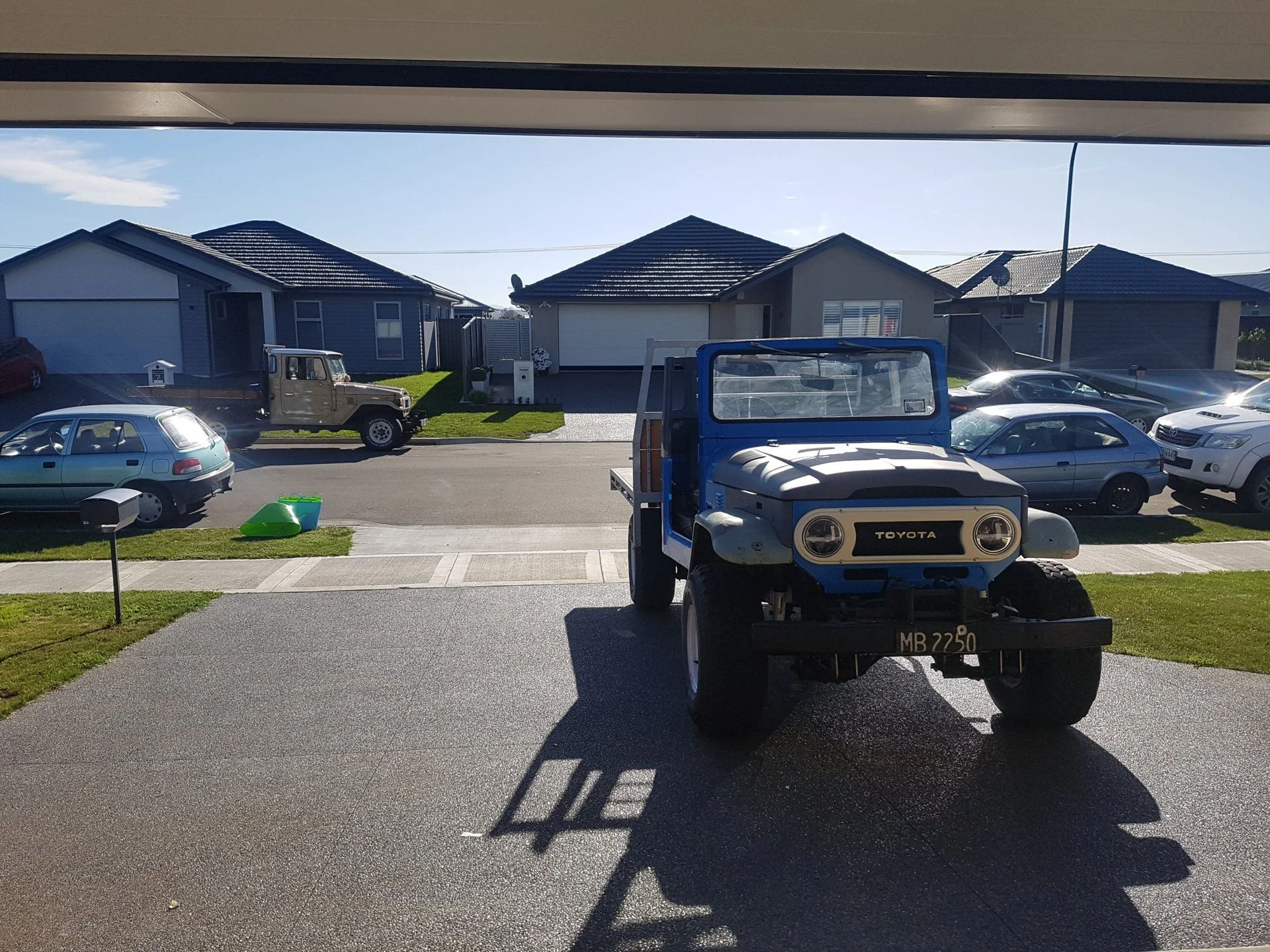

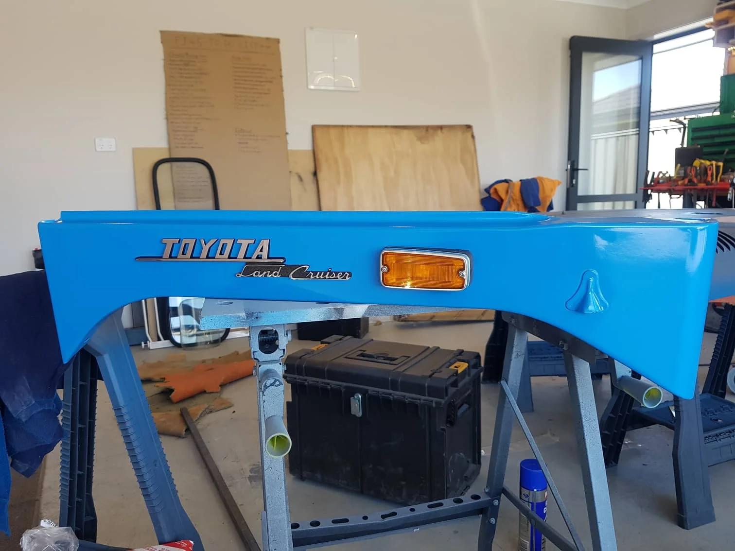

New badges and indicators on the aprons. Going shooting Sunday morning and the garage needs a good tidy up so might not get much done.
Looking great Tom, might want to double check that bezel before the bezel police show up mate. :hmm:
