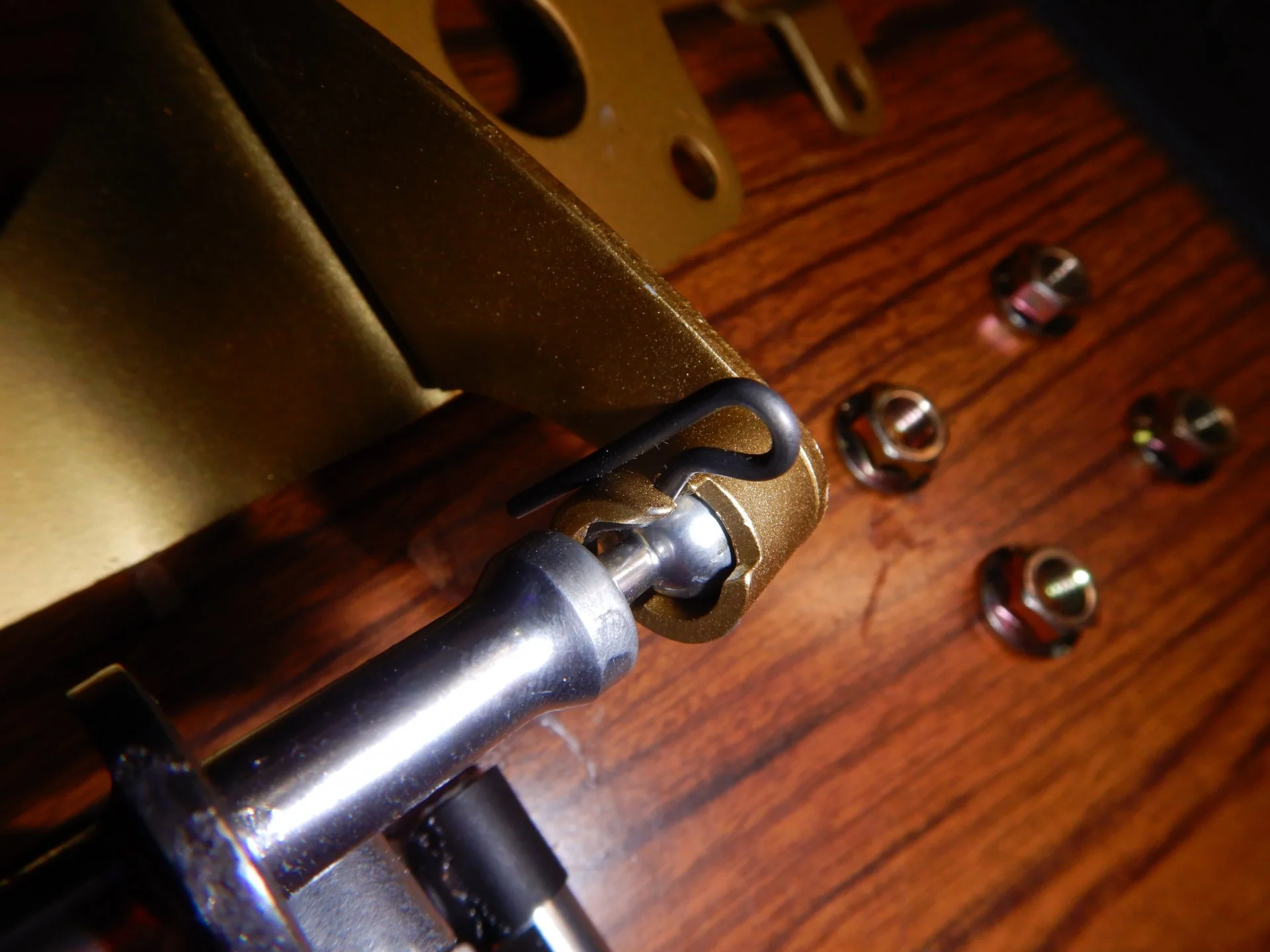

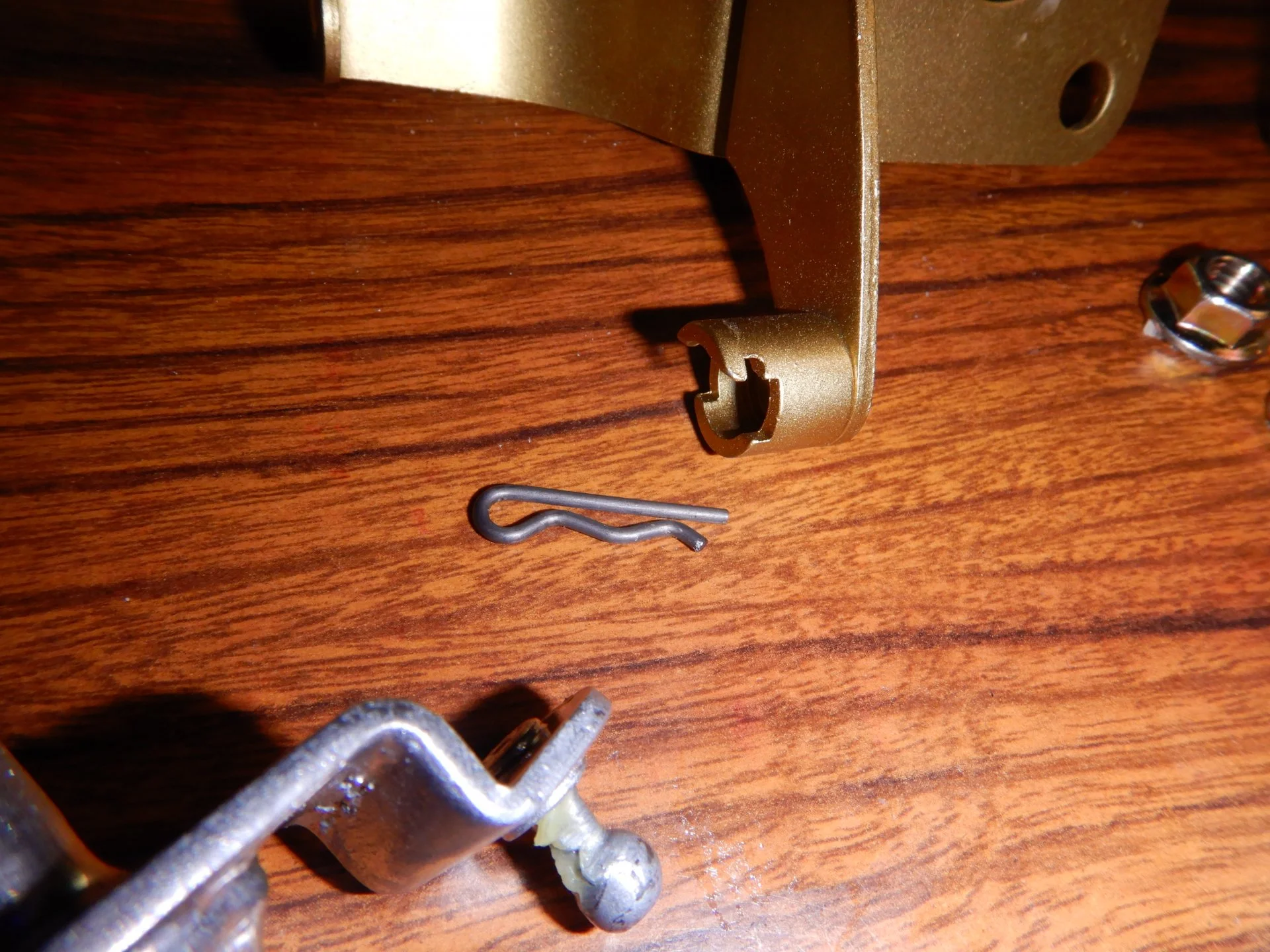

is this your OEM Linkage set-up now on your FJ40 Brian ?
Unfortunately not. As of today - I have from the firewall to the carb.
So as of now. I have three ways to cobble in a cable from the peddle.
If you have a solution to use a cable to the carb - love to hear it.
If you have a peddle to the firewall- would love to hear that too.
Suggestions appreciated.

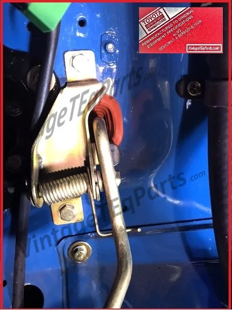

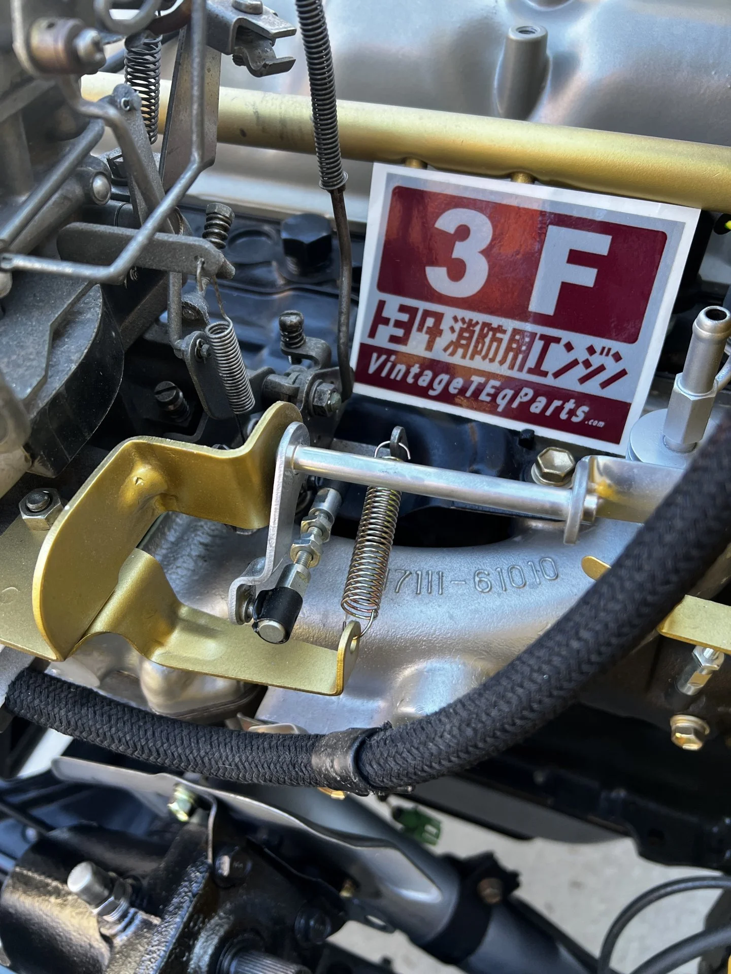

Correct FSM by book Hair Pin / Socket Ball Late modle install location & Positioning :

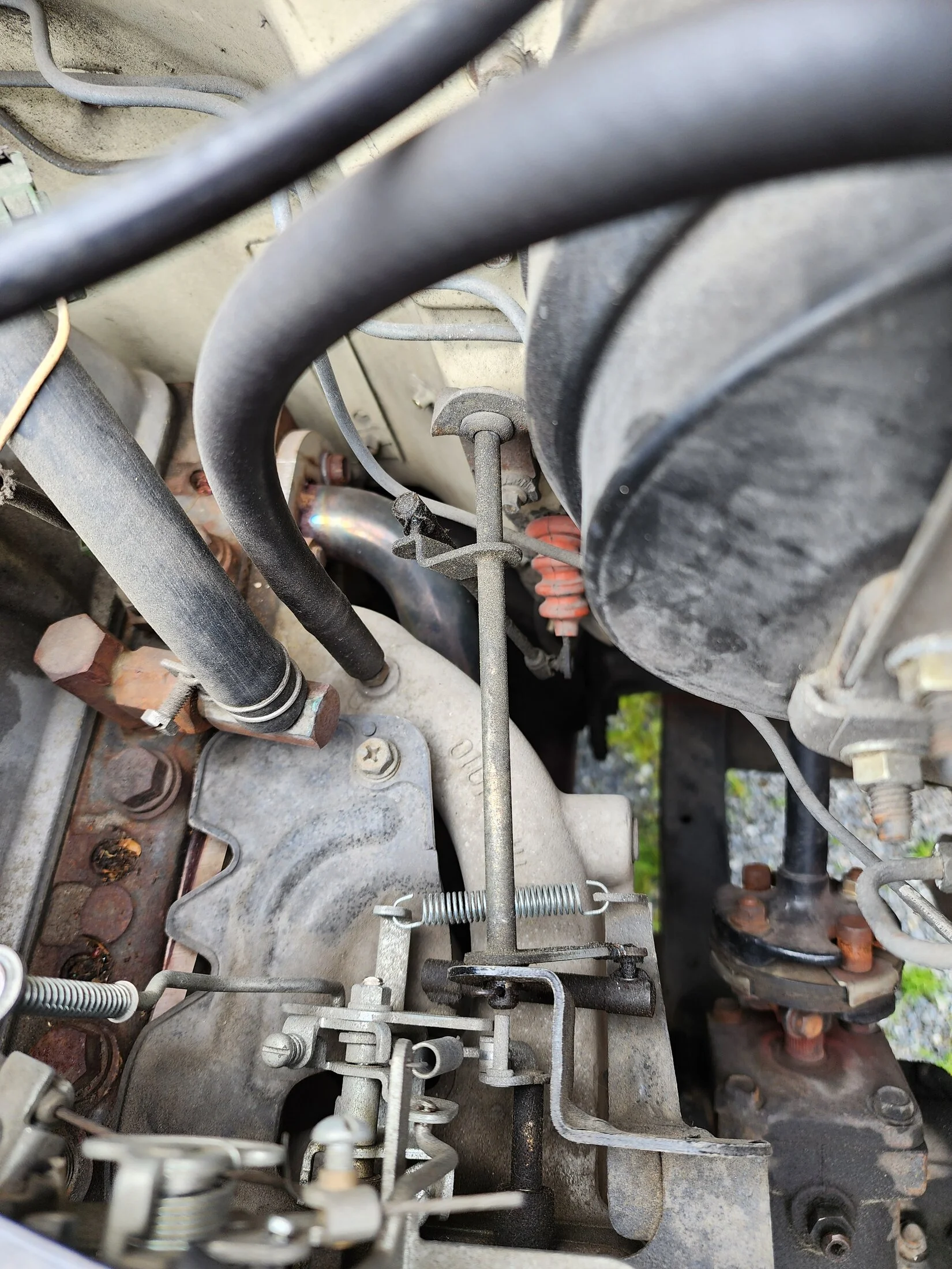

So awesome. Engine bay Gromit?
I pray that the AFI firewall modification was minimal.

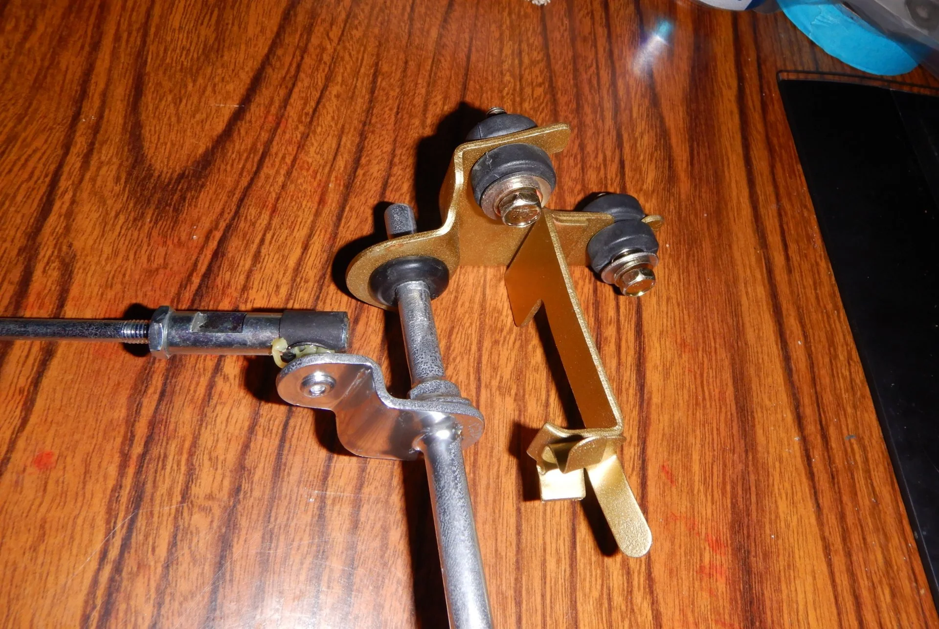

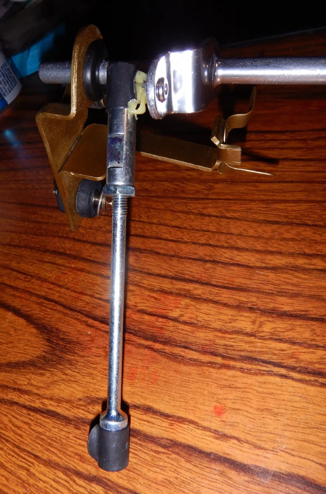

Carburetor ( City Racer ) installed with some awesome Linkage from @ToyotaMatt . Fuel pump and other items from Cruiserteq ( really appreciate your guidance and help.
