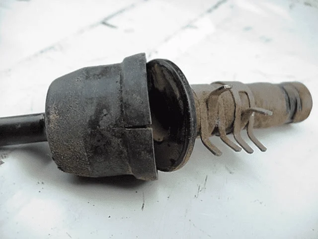

This summer while parked in the sun with a full tank of fuel, gas would literally run out the filler neck, down the fender and onto the ground.
I found a check valve by the fuel separator that let's air in, but not out. I can't find anyway for the tank to vent out, when the fuel expands. What am I missing?
Here is my cracked up check valve:

@cruiserkreutz Any update on this? I'm going through the exact same thing and I'm just starting the process of elimination. I have a new cap. (old one had a cracked rubber seal anyway) I've made sure the lines are clear. Just checking if you'd definitively tracked it down.
Planning on replacing the vent in the cargo panel with a new one. Put a new oem fuel cap on it. Won't know if it's going to vent properly until summer time.
