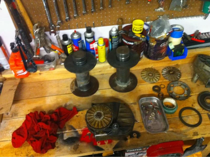

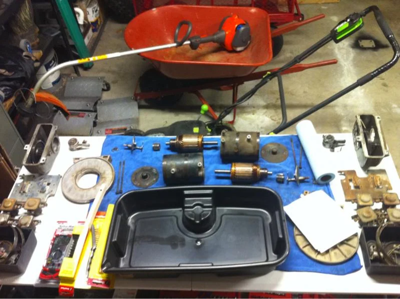

Decided to go ahead and buy another collapsable table today in order to get everything organized in some form and honestly my garage was looking like a disaster zone. Anyways here's a couple pictures. Joel and Chris, I'll have room for your guys 8274s here soon. Sully's winch repair is open for business just kidding. Anyways here's a couple pics of what I got done tonight.

That looks cool... Wish my work space was that clean
Sent from outer space via my mind
It's not that well organized hah
Looks awesome now I'm excited for the reassembly.

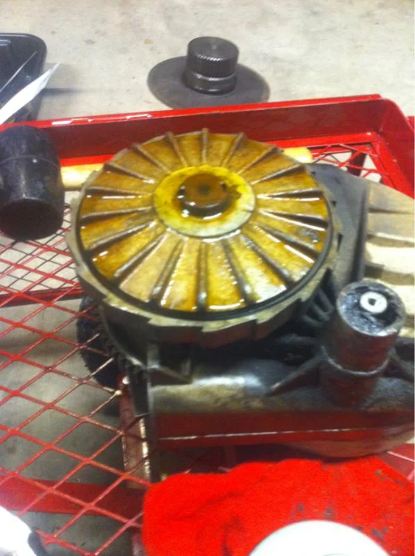

Winch update: ahhhhh I can not get the brake pieces to come off the dang main shaft. Any suggestions? The damn brake covers(unsure of the name at the moment) are too tight against the brake and will not break lose so I can get the outside one off. Could really use suggestions, this is what's slowing me down!
I had to use a three arm puller to get it off. Be careful that is just cast and I broke the center piece after I got the top plate off and it wasn't cheap to replace. My shaft ended up not being perfectly straight and that is what gave me problems. I didn't replace it just buffed for reassembly. I'm sure you do but you took off the c clip right
Thanks man! I did take off the c clip, it was so damn tight that the c clip actually broke in two pieces when trying to get it off. My other winch was alot easier to brake down and there was alot of slack in between the two brake covers.. I guess I'll have to go buy one of those pullers
