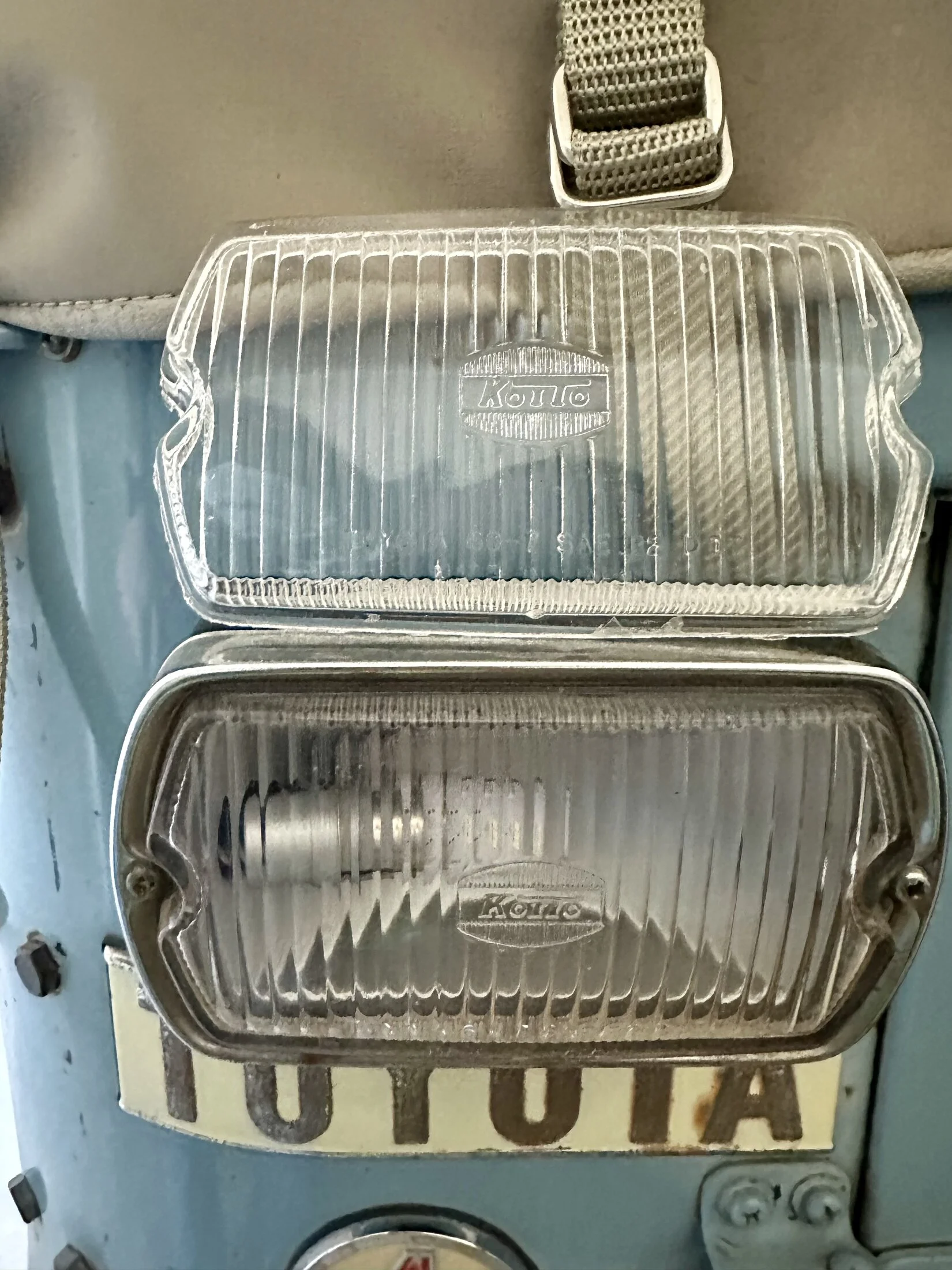

Production is underway! Here's the original and the first casting!
I finally got the bugs worked out and I'm now in the process of making them. I mailed the first one out today to Living in the Past since it was his original I made the mold from.

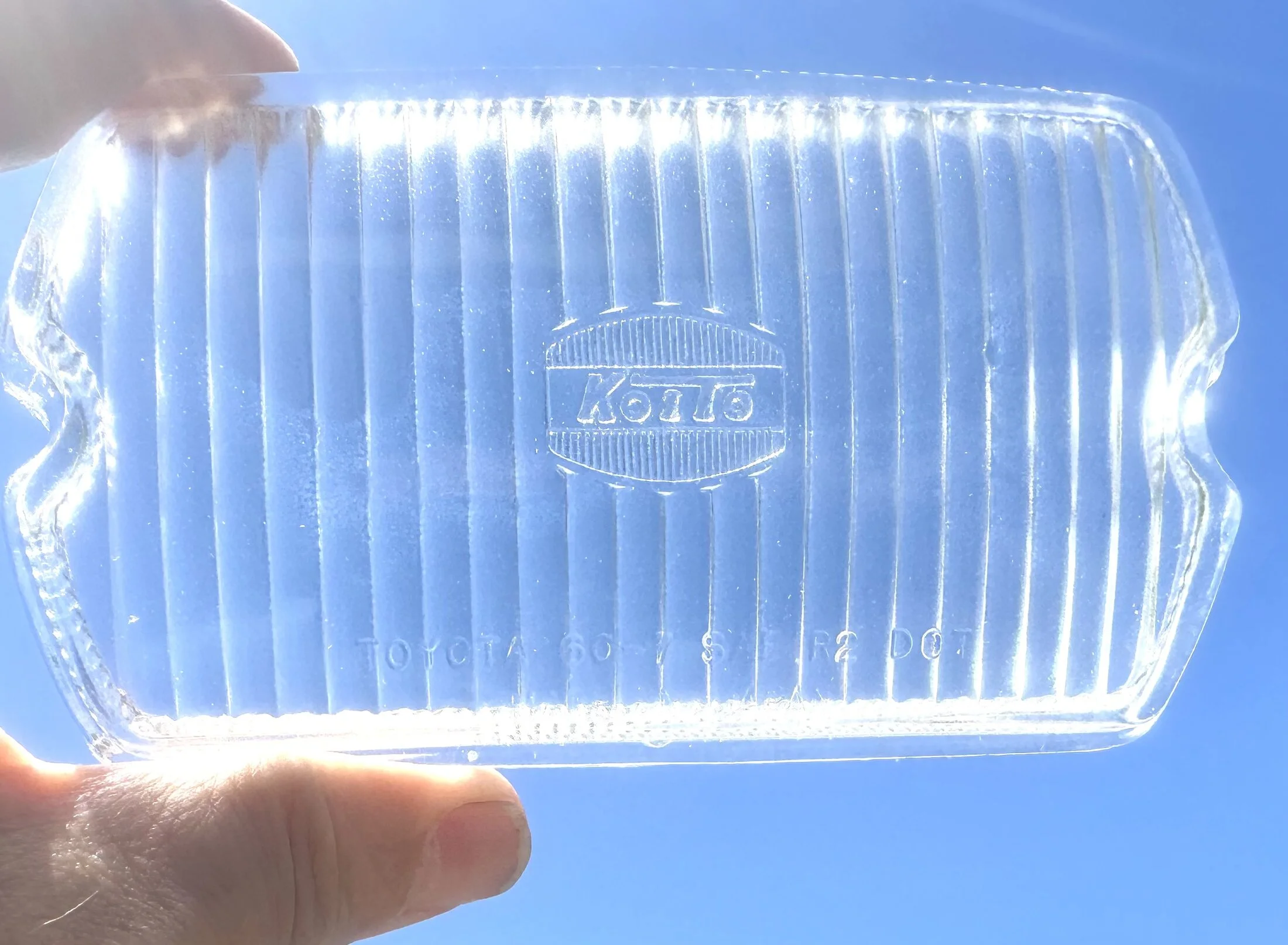

These casting are not perfect but look really good. Nice enough one will go on my 40! I've had one sitting in the hot Arizona sun for about a week now and no deformation or yellowing. If you want 100% perfect, these won't work, there maybe small flaws.
The resin I use was recommended by the company for auto glass. But I can not guarantee they will not yellow or deform over its lifetime nor how long they will last. They take six hours cure time in a pressure pot so I can only make two a day at the most.
