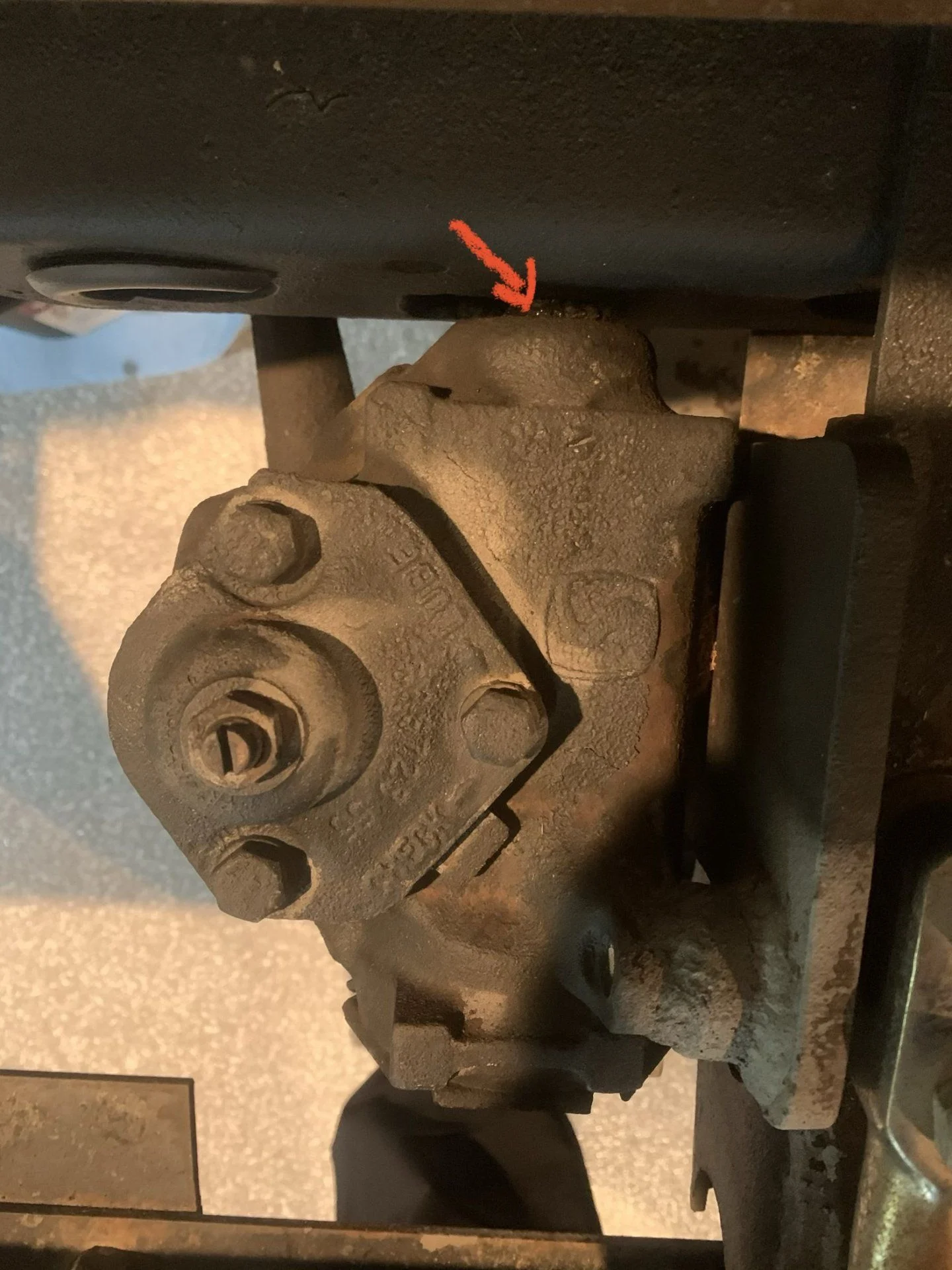

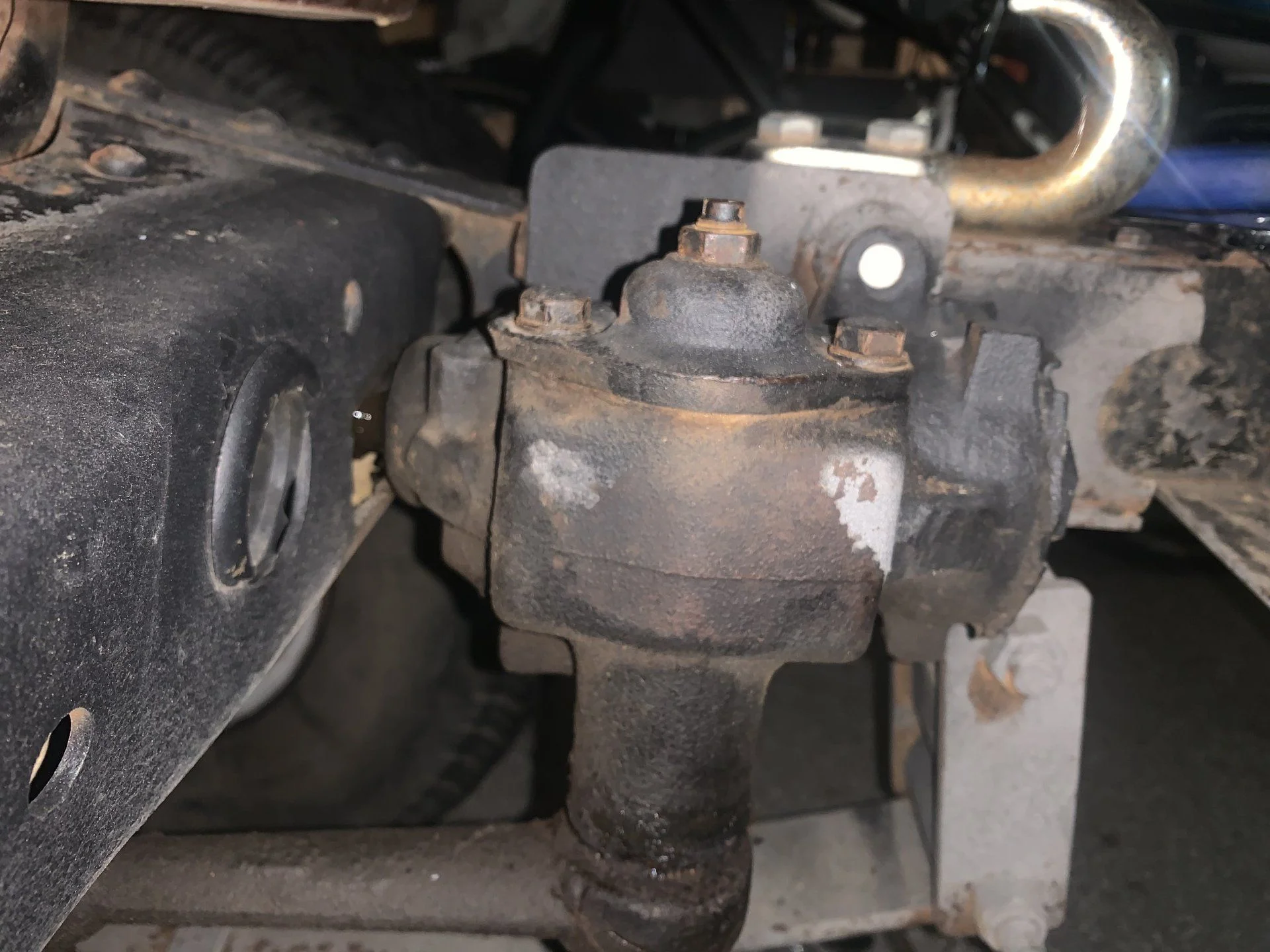

Brought home the 1971 FJ40 a few days ago. The FJ motor was swapped 15 years ago with a Chevy 350 (GM 3970010......69-80...2 or 4) and has estimated 500 miles on motor/there are 49k miles on vehicle. I’m not sure when the truck was painted brown but its ”chipping” with white base coat. I plan to use this vehicle so will likely touch up paint instead of complete paint job. The steering was “slipping“ on the drive from Brownwood to Austin and within 2 days the shaft completely disengaged from steering box so Steering box needs to be replaced.

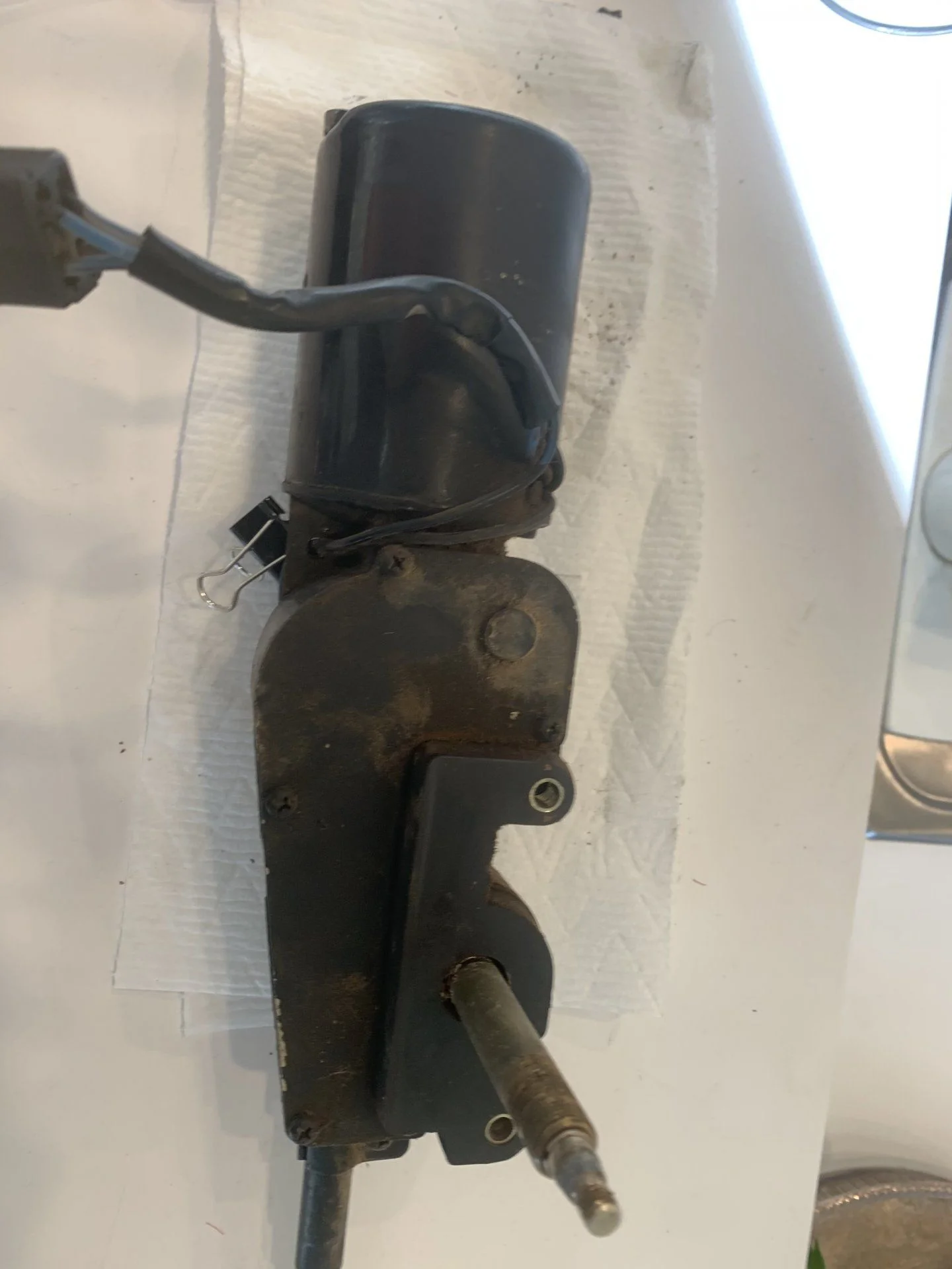

Windshield Wipers:
Wipers & motor pulled. Before pulling, the wipers were inoperable but I’m hoping it was caused by a bad connection.
I attempted to test it last night but I was only able to create a lot a “sparking.” I’ll be doing research this evening on how to do this correctly.

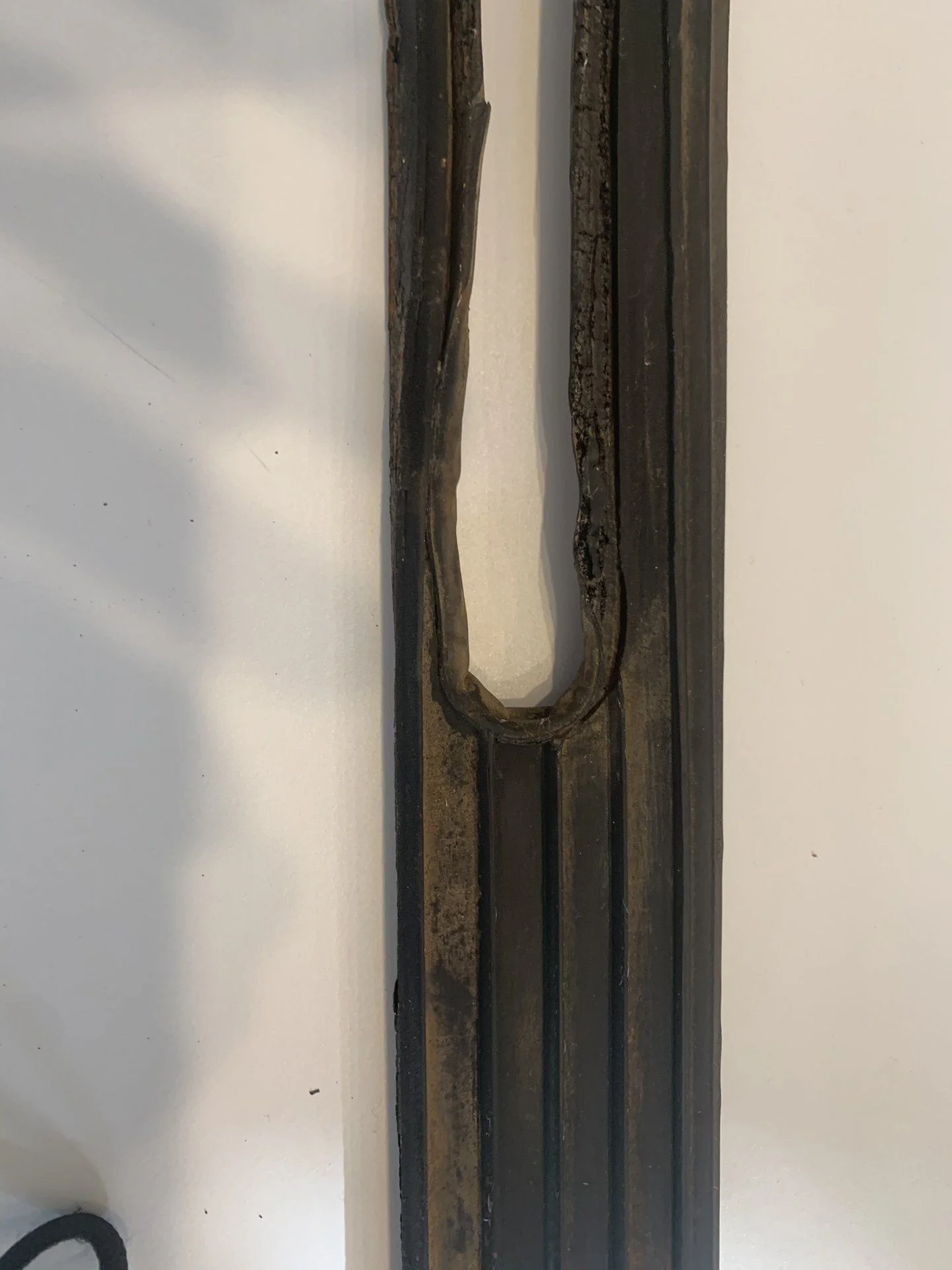

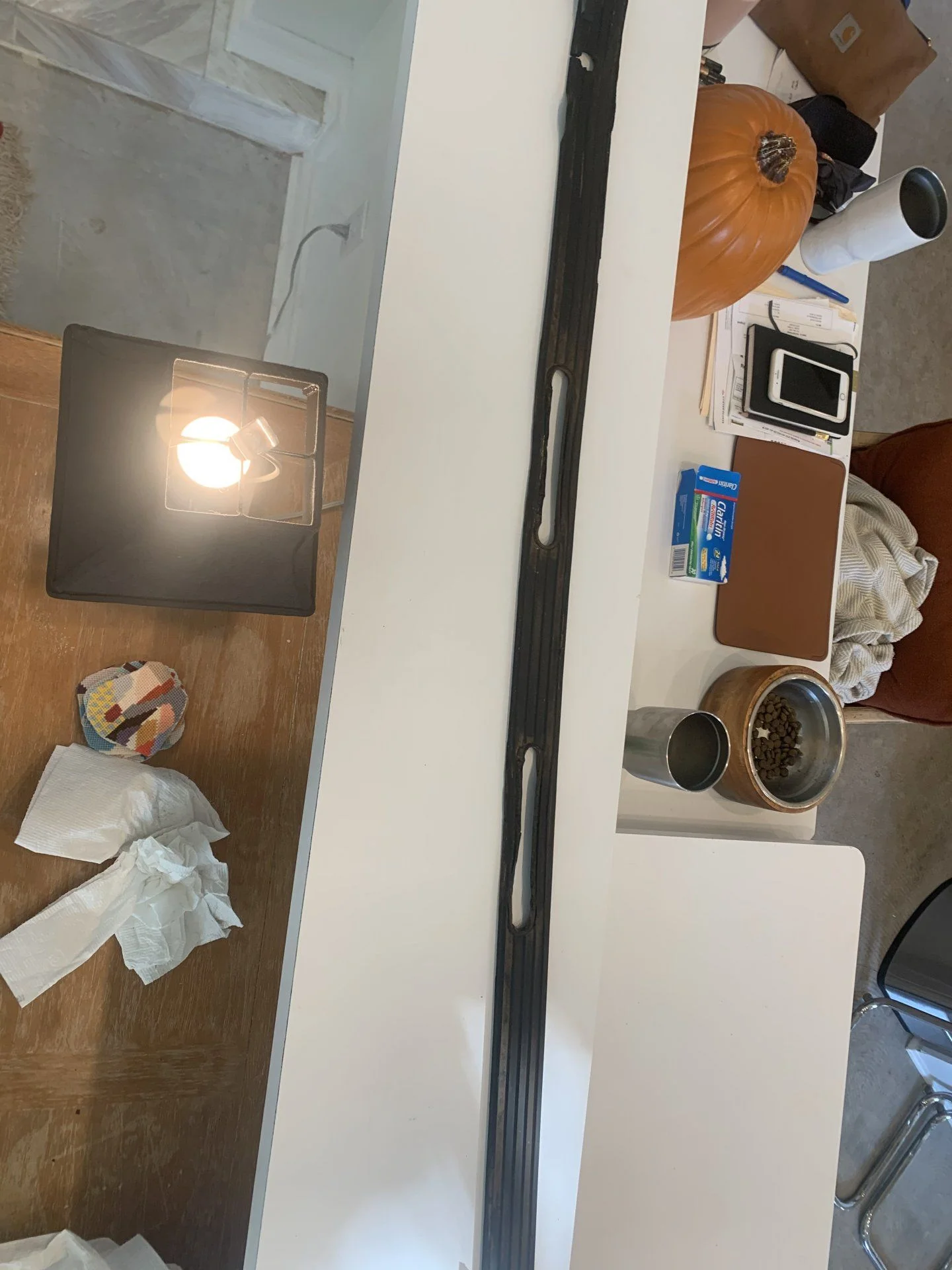

Front Windshield Gasket:
I pulled out the windshield gasket/pad and it’s in surprisingly good shape. Not perfect but salvageable & im happy to not spend $300 replacing it.

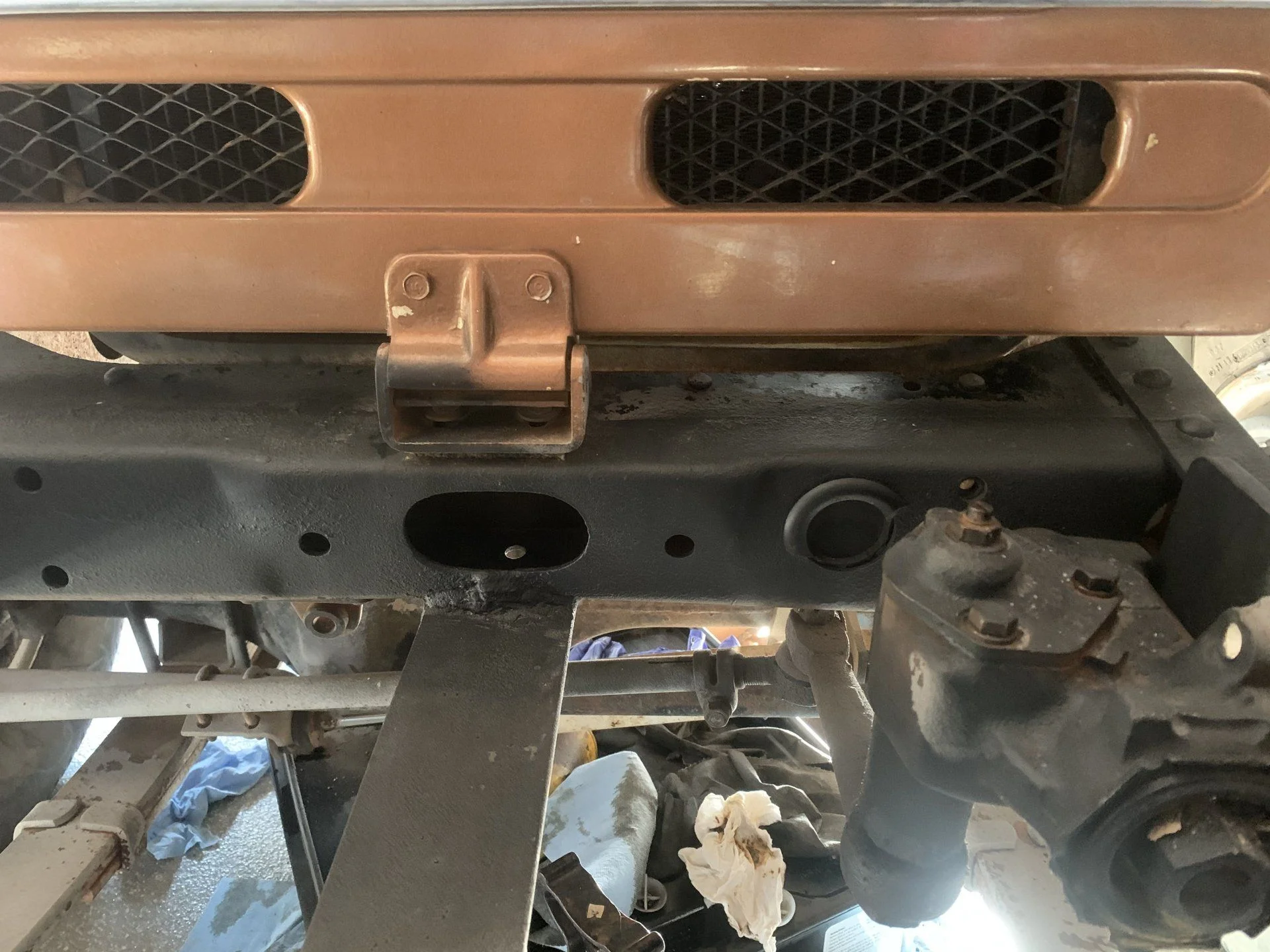

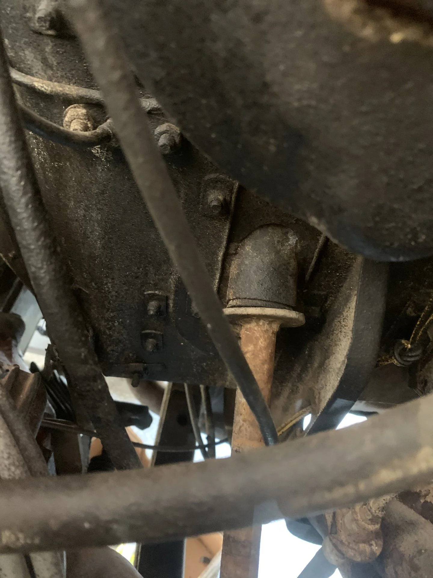

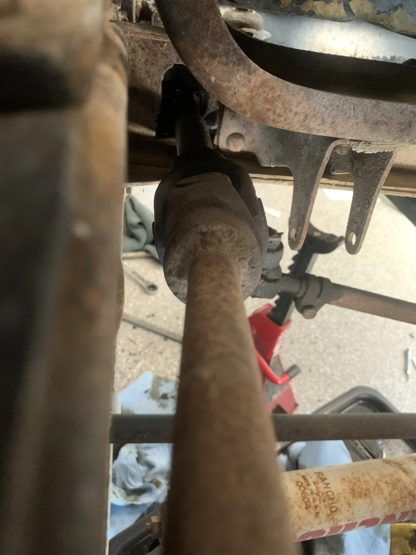

Steering Gear Box:
Since the steering system malfunctioned I’ve received lots of feedback on solutions...Thank you guys so much!
I’m planning to grind the current box off and replace it with one that is rated to handle my vehicle. I didn’t mind the manual steering and will likely go back to one similar but I’ll likely grind the current box off & bolt the new one on.
The entire shaft is rusted to the point it likely needs to be replaced as well. My objective is to replace it with safety in mind.
The PO is going to cover cost of replacing steering box since it “snapped” a couple days after I got it home. He’s a good friend and honorable man. It’s good to know there are still people like this in the world. Thanks Brad Locker!

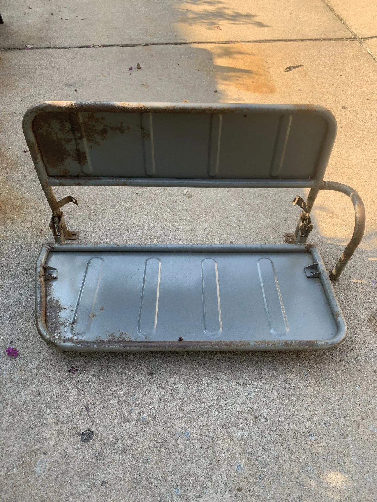

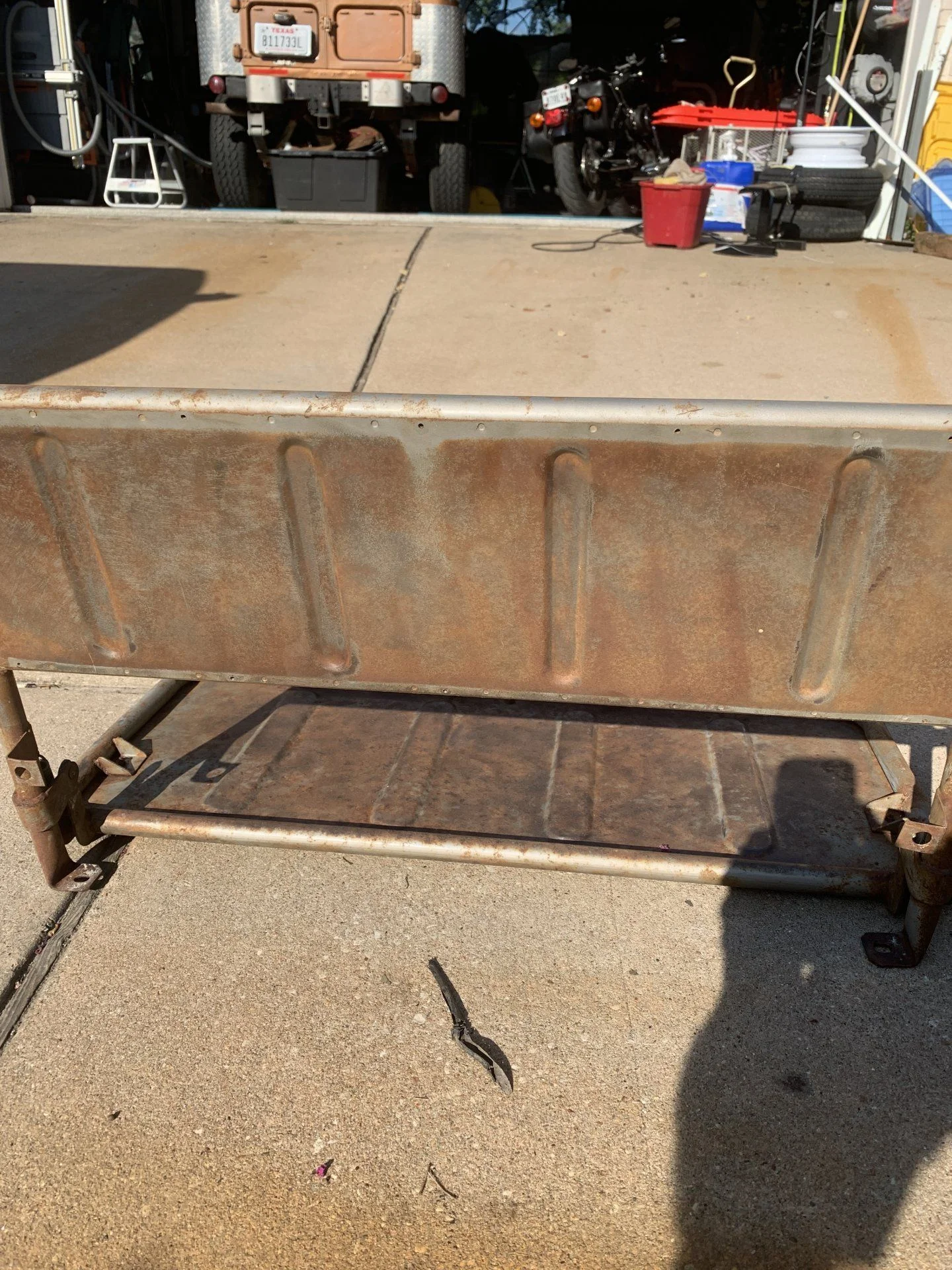

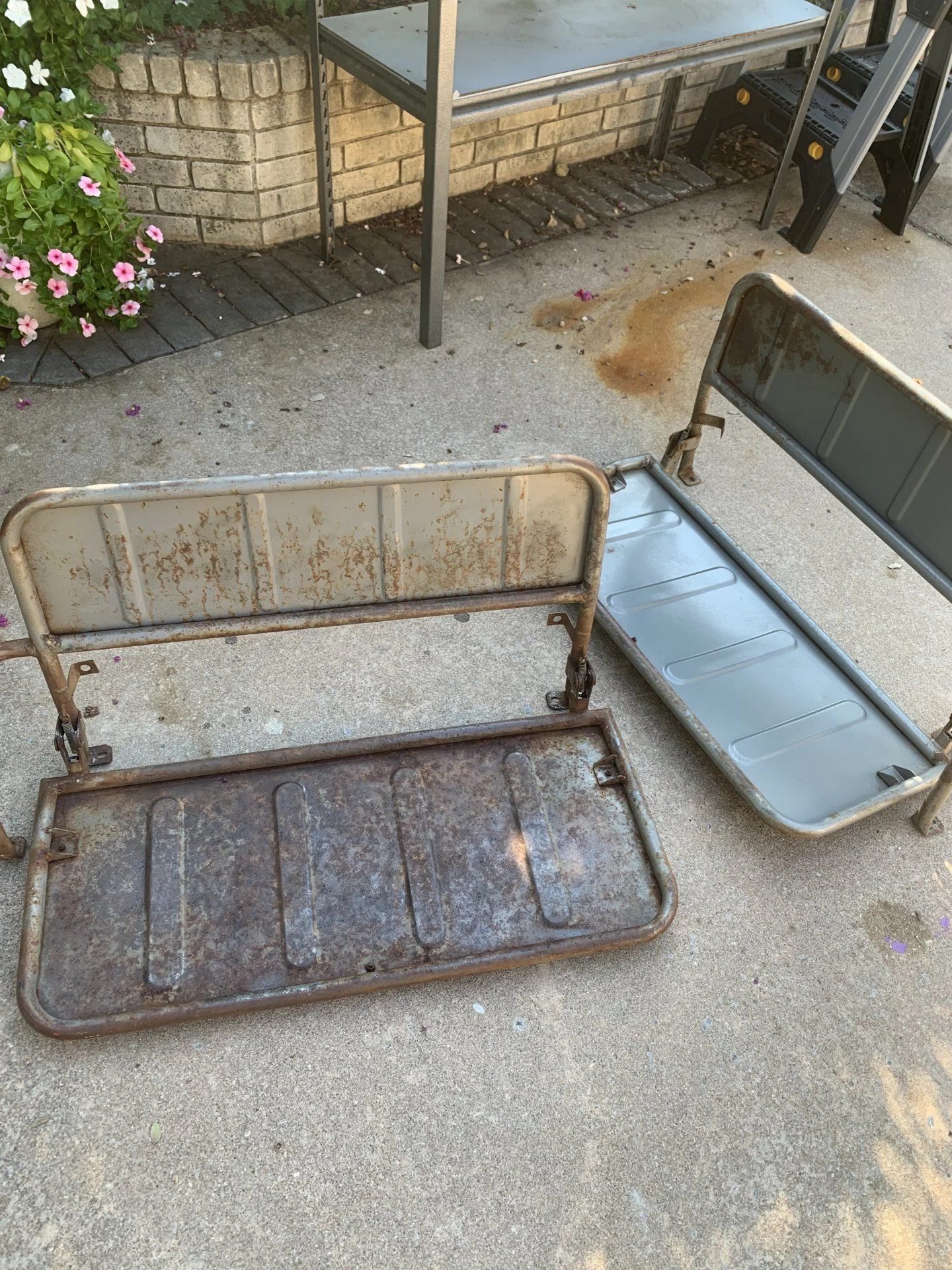

Jump Seats:
I spent a few hours grinding rust of the jump seats this weekend. I lubed them with silicone and these seats are opening/closing smoothly! Lots of instant gratification!

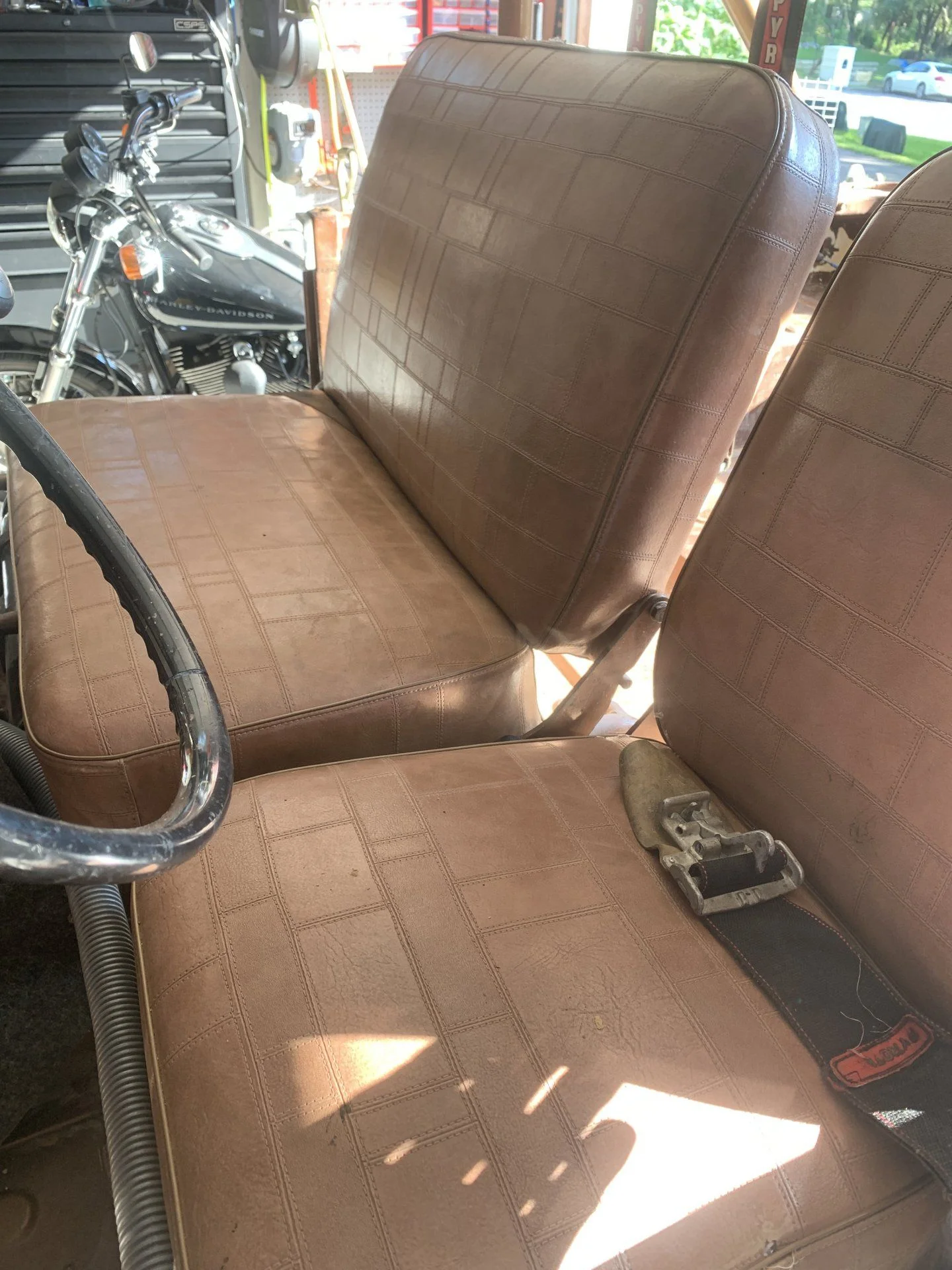

I’m comparing options between ordering the Upholstery kits (coral color) From SOR for front and rear seats vs dropping them at a local upholstery shop to re-pad/cover.
However, The upholstery on front seats is in super good shape so I might try to match the rears with front and just add padding to drivers seat.

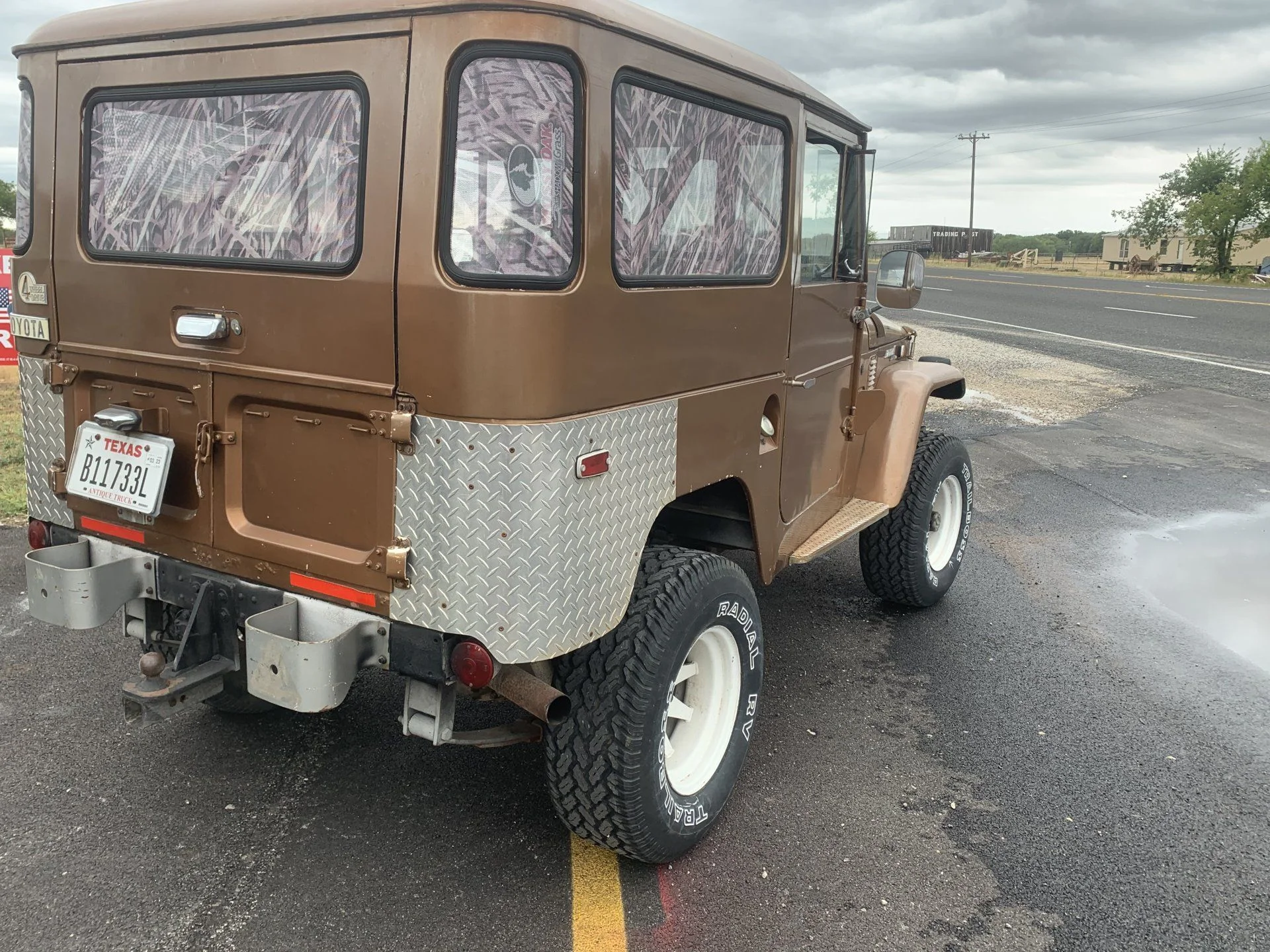

The wheels are the real deal, original ‘Jackman’s’, not the fake American Racing wagon wheels. Keep them for that 70’s nostalgia. ‘Jackman’ went out of business many many moons ago.
Good Luck with your Cruiser Project.

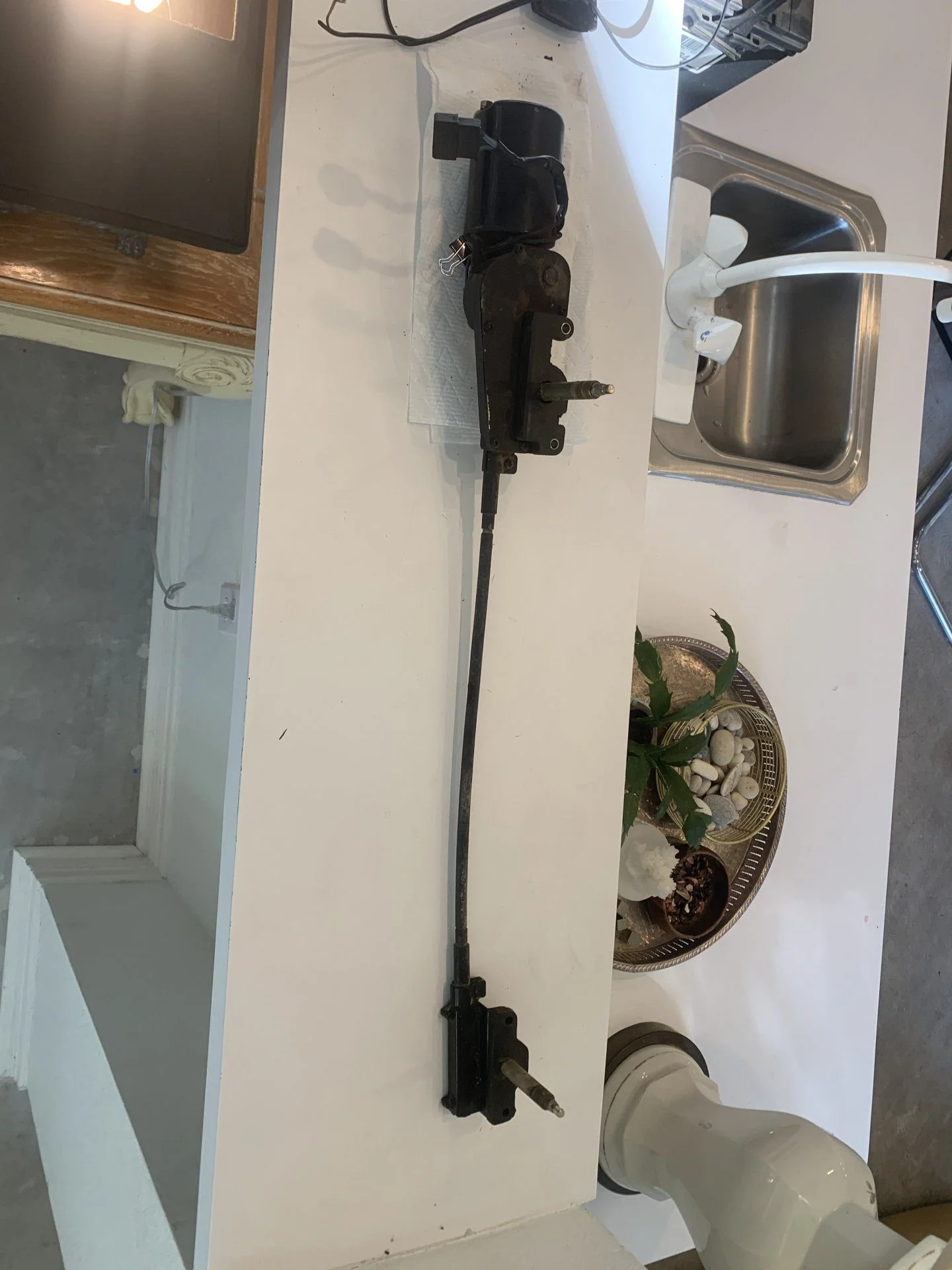

Windshield Wipers:
after testing the wiper motor I’m released that the motor is operating. Now, I need to work on wiring from wiper switch to the motor.
Windshield Wipers:
After testing wiper motor I’m relieved it is operating correctly. Will pull cover(s) and re-grease, then work on connection from wiper switch to motor.
Motor test instructions: connect 12V (red) to solid blue wire running from motor, then ground blue/black wire (high speed), observe. then, connected ground to blue/white (low speed) & observe.Lots of sparks flew to get this dialed in but it worked.
Note: If motor does not operate at first,be sure your connections are solid and also be sure your power supply is charged.
Either you’re a bachelor or you have a very understanding wife, letting you put Landcruiser parts on the kitchen countertop!

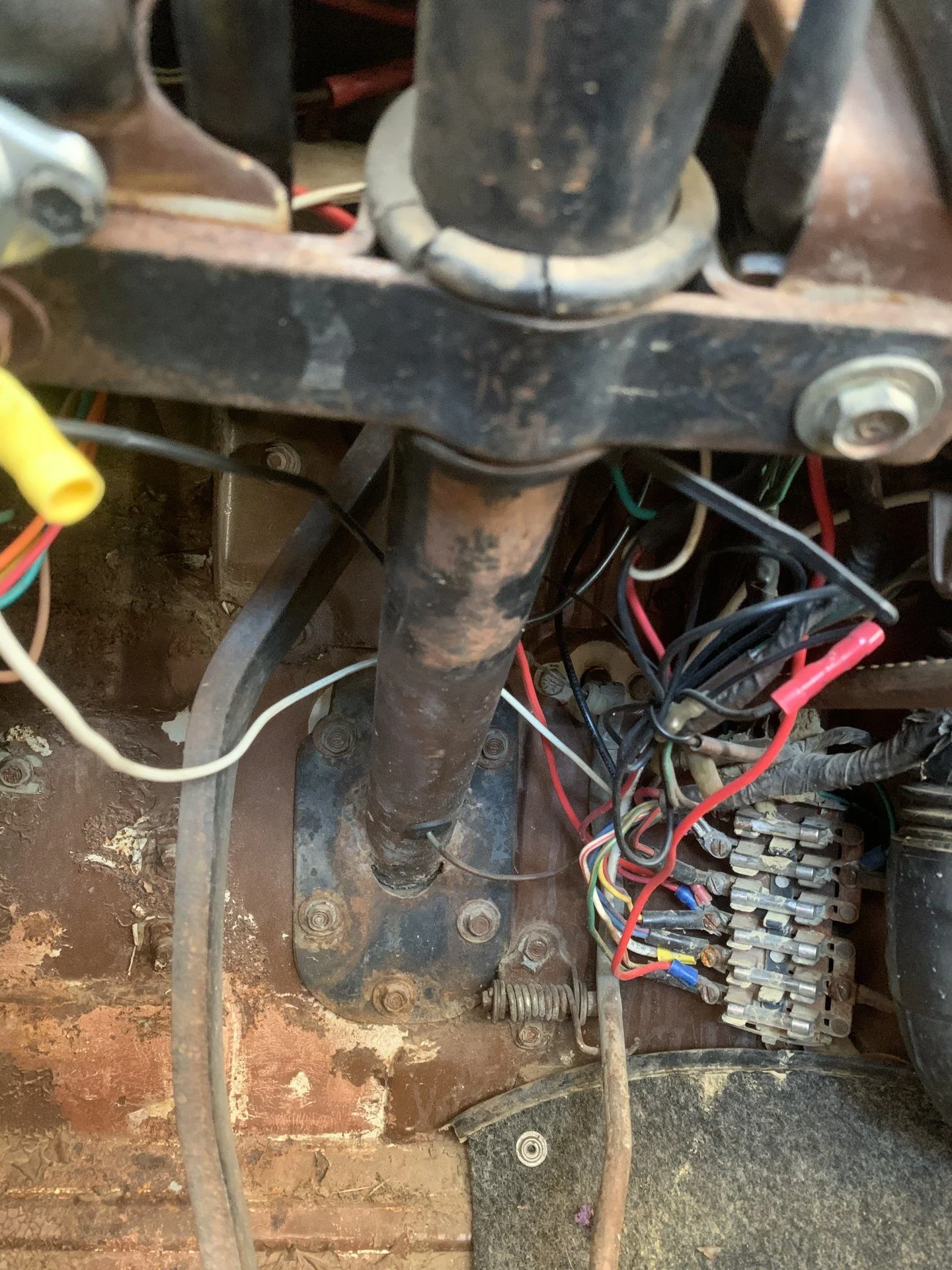

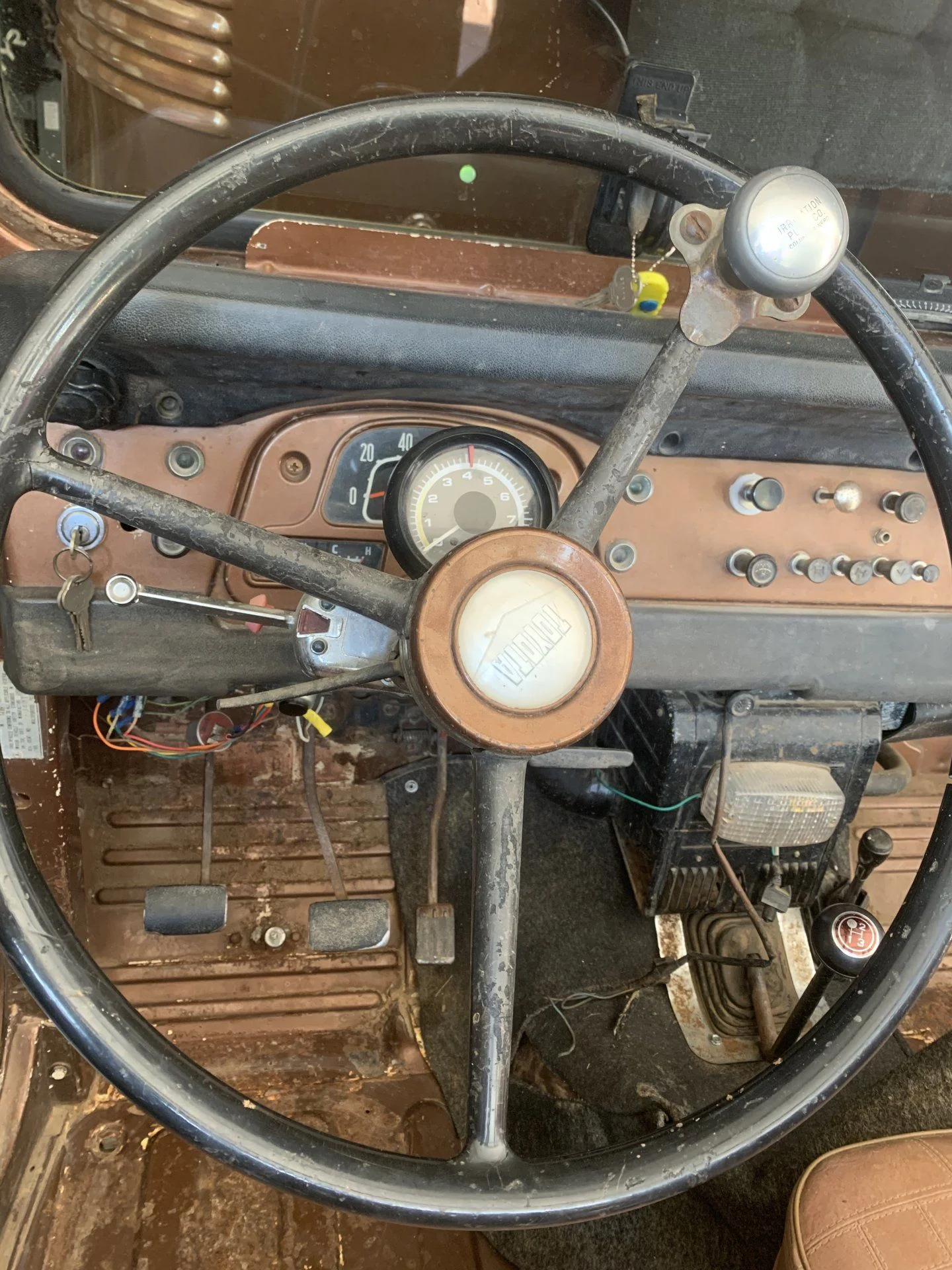

Still need pictures of the steering column from inside the cab...how it hangs from the dash and passes through the firewall. :)

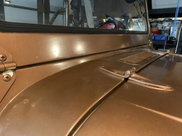

Windshield Gasket cleaned and installed with (non permanent) 3M Marine Sealant for metal/rubber.
notes: when laying down the bead be sure you cut enough of the tip off—I didn’t. The diameter was too small to where I had to squeeze the tube too hard and the backend of the tube exploded. I was able to get it coated in time but had I thought it through I couldn’t been a “cleaner” job.
That 'patchwork' front seat upholstery is sweet - very 'period'. Nice truck and good photos and success stories here.
