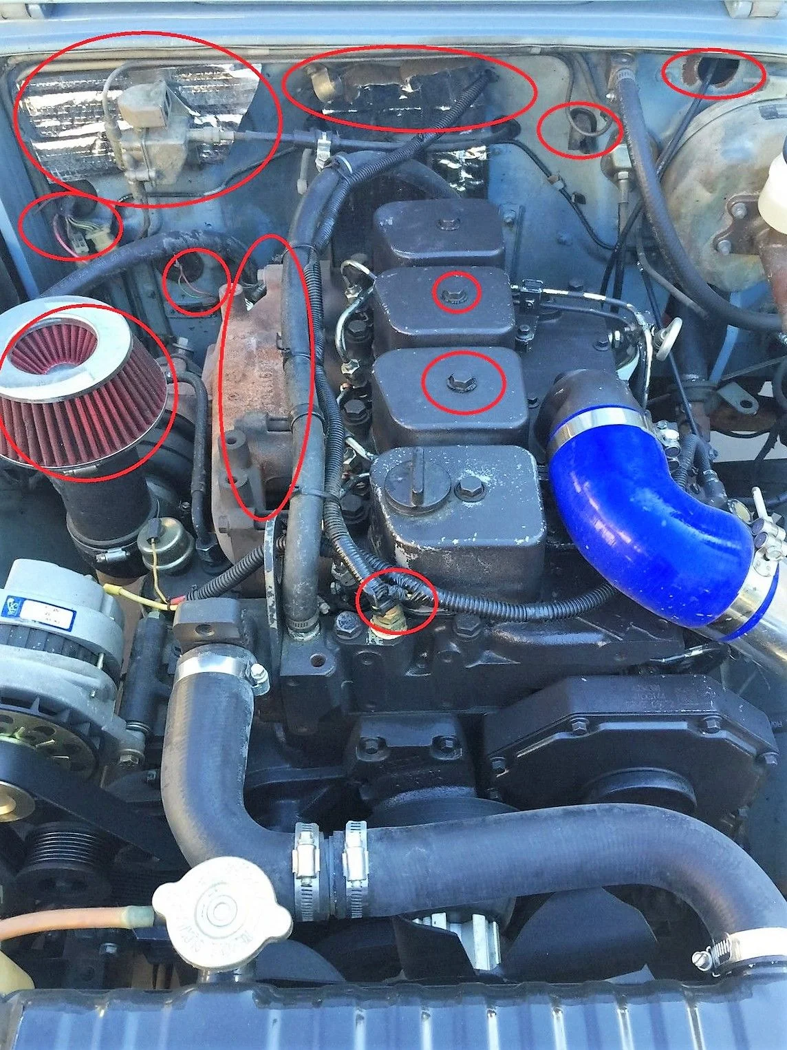

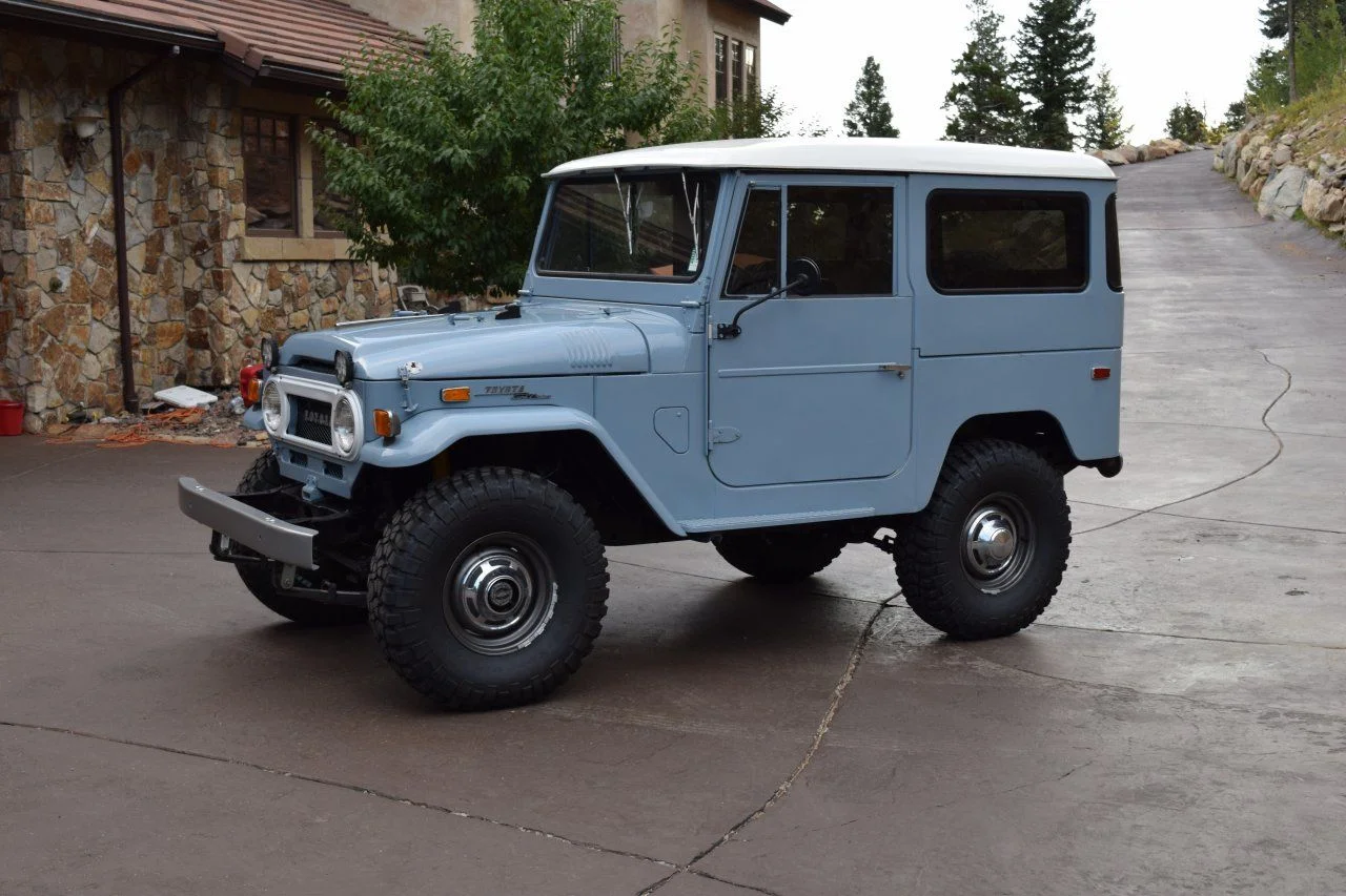

The looks of Toyota and the reliability of a dodge truck, Awesome! I missed where the 40K was? Somewhere? Never mind. "Fully Restored" means something completely different. I wonder why the heater is in the cab but the Blower is not under the hood. What is the point of that? Thats a part of no expense spared maybe.
as has been said already, great looking 40, nice colour and all around very nice BUT, to claim a full frame off resto with no expense spared? yeah right.
im sure there are plenty plus people who would love this 40 and be willing to pay a fair price, but its then only fair to be honest as the seller from the word go.
otherwise your just going to get ripped to shreds by people who really know what to look for on this forum.
again,nice 40, just tell it like it is. thats all anyone asks
No skid plate.

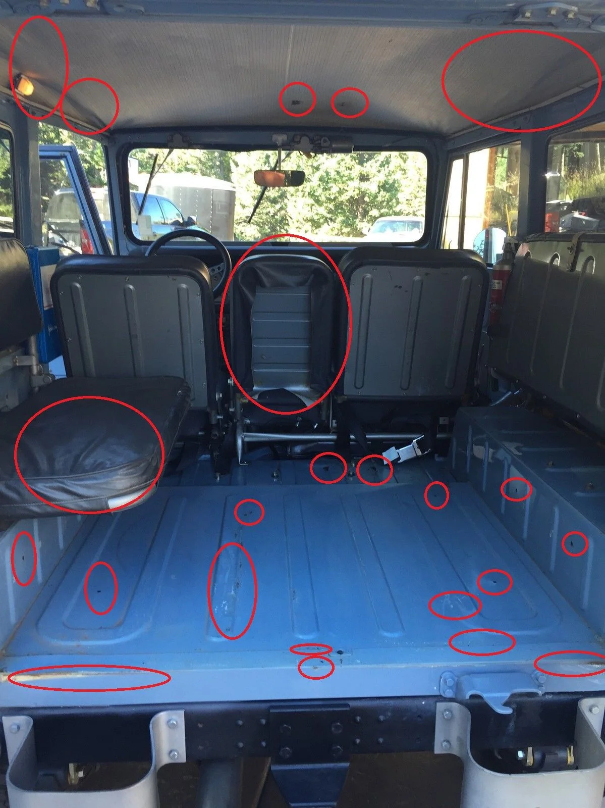

Rear heater is missing.
Look at the green door handle, matches the blue paint nicely and surely is a repro part.
i was fully unaware that a cummins was a factory option in 71? was the 5spd also only available that year as well?
But wait!!! There's more!
Notice the double hose clamps? Means he didn't fit one length of hose from the rad to the engine. Just made do joining two together...

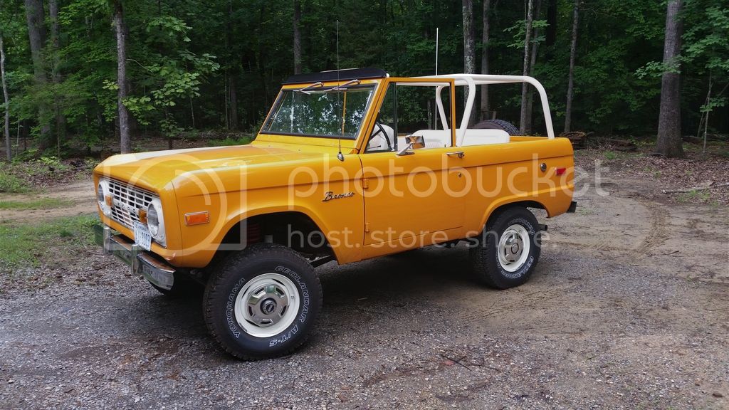

This is frame off restoration.
Here is when I started...

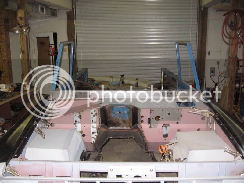

Then after tons of body work...
Then the body came off the frame ( OFF the FRAME!)

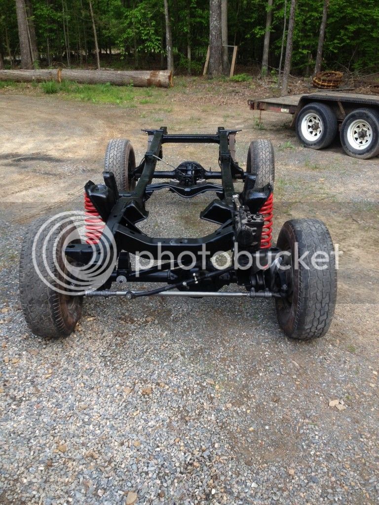

Frame was stripped, treated, painted...
Then I totally rebuilt everything. Old rear leafs in this picture due to new leafs on back order.
Great looking Bronco! I remember them well when new.
Thanks. I've owned the Bronco since 07. Just finished the frame off end of last year. It has the 302 and three on the tree. Mostly all stock except the fuel tank, 2.5" suspension lift and mine was not a ranger so shouldn't have chrome trim on the grill. I guess everything is for sale but I built it to drive. It is as new with everything rebuilt or replaced. And I have a stack of receipts and pictures to prove it :).
