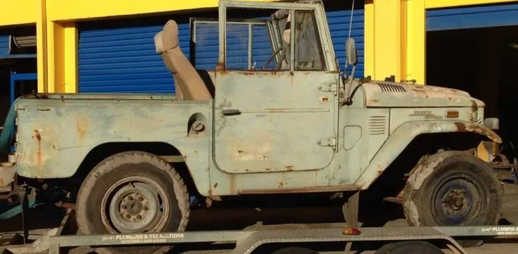

This cruiser has been on Aussi eBay for some time now:

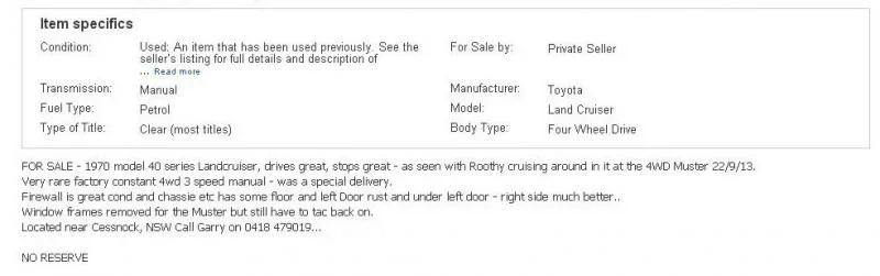

And this is what the seller claims:
Has anyone got an opinion on whether "factory constant 4WD" was really available as an option back then?
Surely such a "special delivery" would cost more (because it always costs more to separate one product out from a production line to be treated differently)?
And why would anyone pay more .... to get less....(assuming no transmission modifications are used to combat the "wind-up" and "extra tyre wear" that an FJ40 would normally suffer from if left permanently in 4WD).
I'd have thought that to get constant 4WD you'd only need to throw away some of your normal shift linkage.
All views welcome....

Used car salesman who thinks they “know” Land Cruisers.
Vehicle does not have lockouts on the front axle, so, of course, it is going to have a “very rare factory constant 4wd 3 speed manual – was a special delivery” configuration that someone will have to pay extra for.

Yeah. I was sceptical too Steve...
There was a "full time 4wd" ... Two trucks that I know of exist
There is a thread or two about them on mud... That truck is not one of them :)

I know full-time 4WD came later (after the 40 series was finished).
But was it really available (with a centre-diff) off Toyota's 40-series production lines in the 1970s?
I find that very hard to believe!

no centre diff,it just had no free wheeling hubs,actually i threw out 2 new front hubs this year off our old tojo
