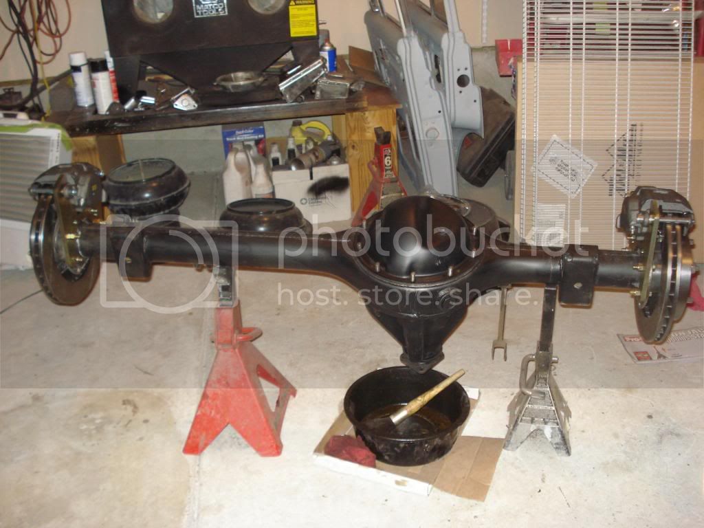

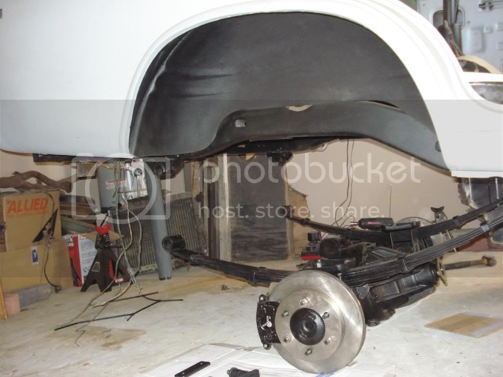

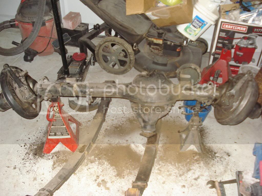

After rear axle spring over. I put new wheel bearings, seals, and a disc brake conversion on the rear end while I had it out. New spring bushings too.
Lining it up!! I hate working under jack stands!!!:rolleyes:
Its huge!!! Cant wait to get my tires.

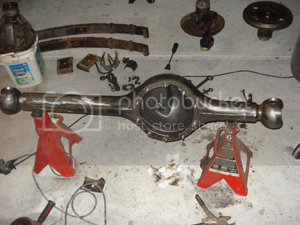

Front Axle Before Tare Down

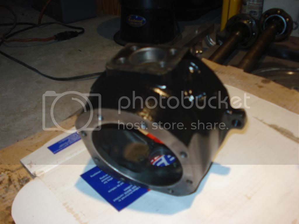

Waiting on new disc brakes, knuckle's to be cut and turned, a knuckle rebuild kit, high steer arms, spring perches, u-bolt retainers, steering stops, and shock mounts.
All cleaned up and getting ready to be shipped out to have the ends turned for the soa lift. It was a pain in the a** cleaning all the grease out of the ends. :bang: I still have to clean up the knuckles and third member, that will have to involve a few beers.:beer:

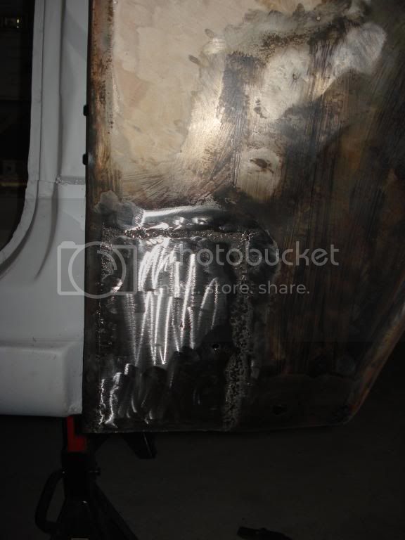

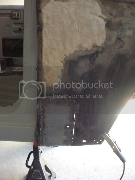

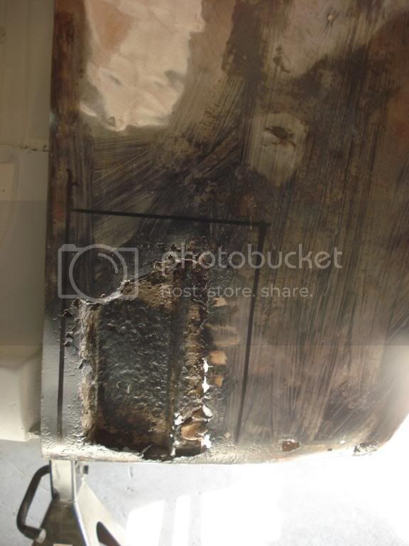

Fender Rot Repair
Well back to some body work till I get the front axle housing back. I started to repair the passanger side fender, it is in bad shape!!! But not for long. I cut some rot out and made a patch to weld in. Here is some shots of the work so far. This should make a great inprovment to the over all look of the pig.:)

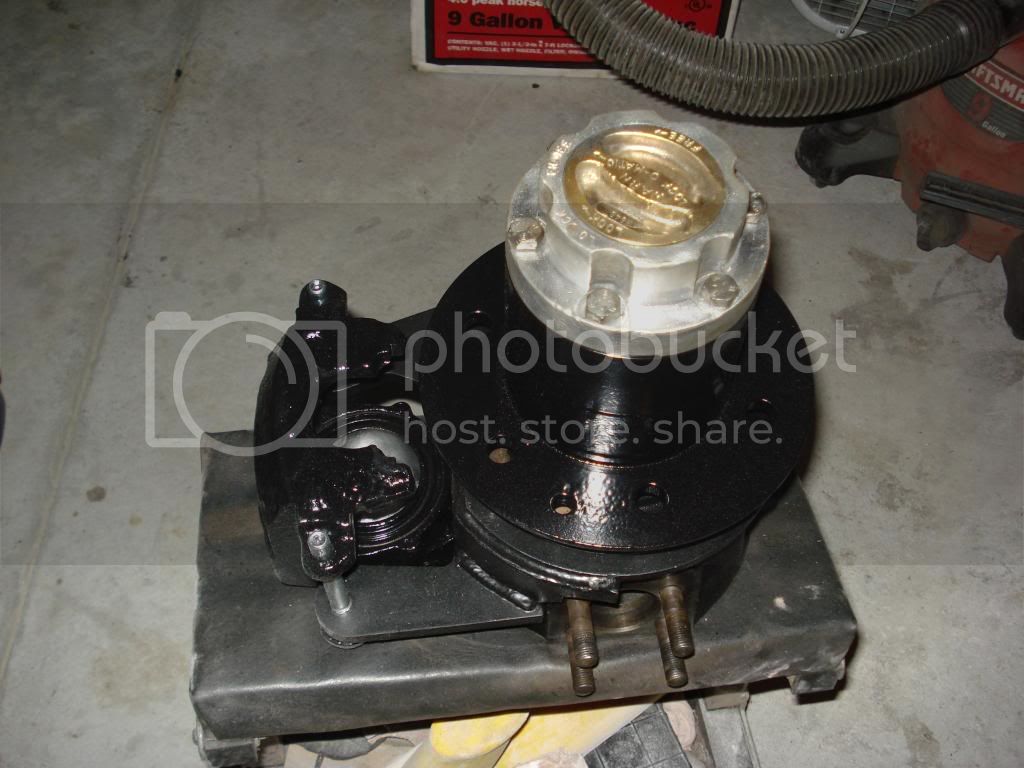

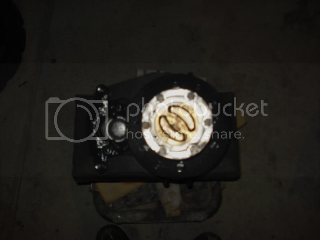

:bounce:Back in the garage today, i am cleaning up the steering knuckles and fitting all the disk brake parts together making sure all jives!! Still waiting on my front axle housing to come back. Cant wait!!!:bounce2: Well I will post some pic later tonight of the progress. well back to work for me. :beer:

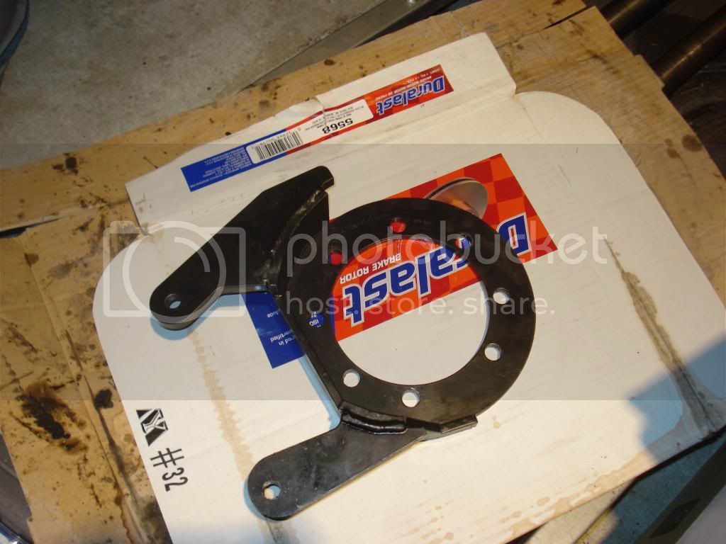

The disk brake brackets are from jt outfitters, they work with 1984 monte carlo calibers, and a milled to fit 1990 gm 4 wheel drive truck rotor. So I just bought the brackets from them, I got the rest of the parts from auto zone. But I am not to sure that I sould of gone that route. The rotors in the center have to be milled to 4.20" not a problem I grinded the center out and it fits over the hubs, but the inside of the disk is rubbing the bracket alittle. So the inner disk needs milled as well. I cannt find a shop that can mill it down so I think I am going to have to order the rotors that jt outiffers sells already milled to fit. I wasted a day in the shop grinding the center out of a rotor that is not going to work.:bang: So it is better to spend alittle more money up front than waste time and money in the long run!! Lesson learned!!!:bang::bang::bang:
Found a machine shop that will mill the rotors for $100.00. That is what jt outfitters charges for milled rotors, I just ordered them. Less hausle. Also some stainless steel brake lines!!! I should be set. For now at at leased.:)
