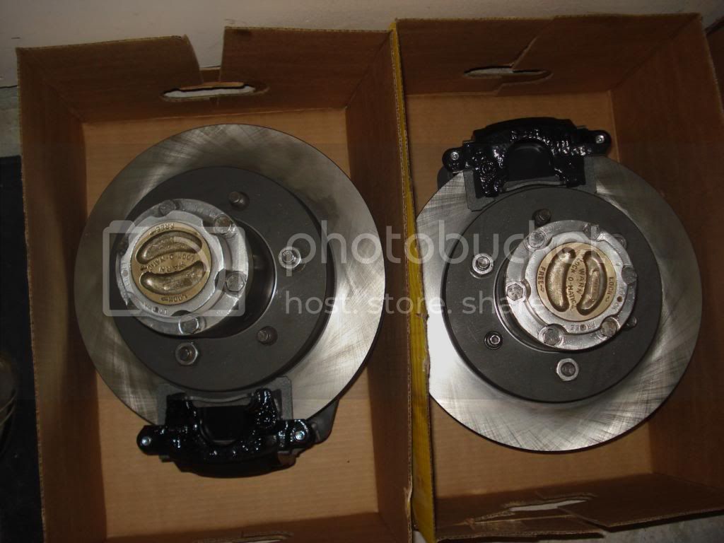

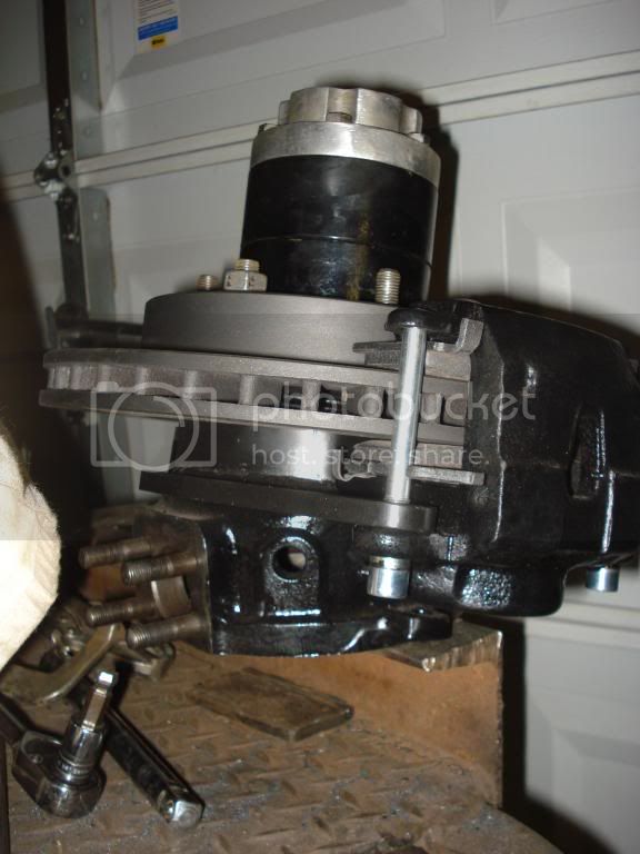

Well I got the front disk brake built up today.

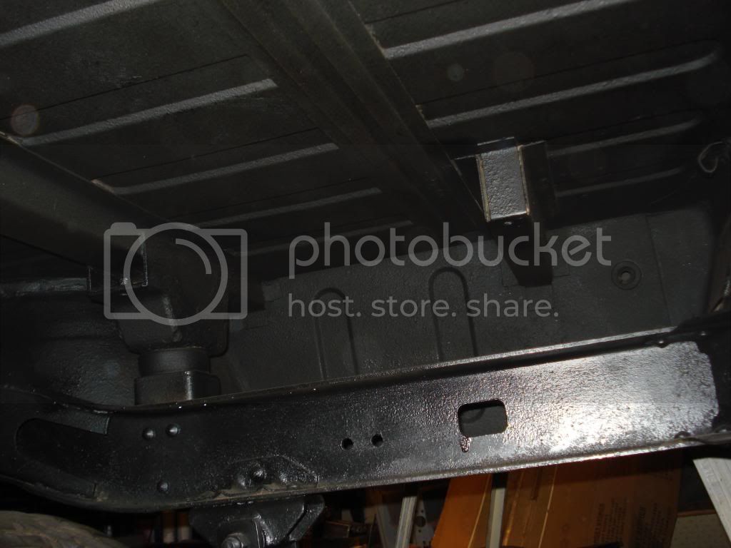

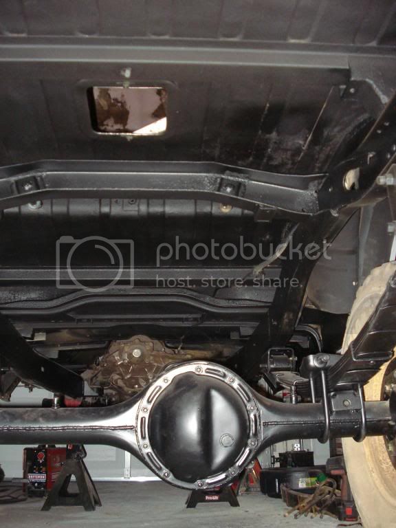

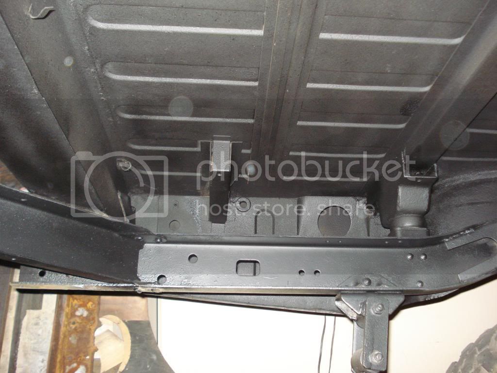

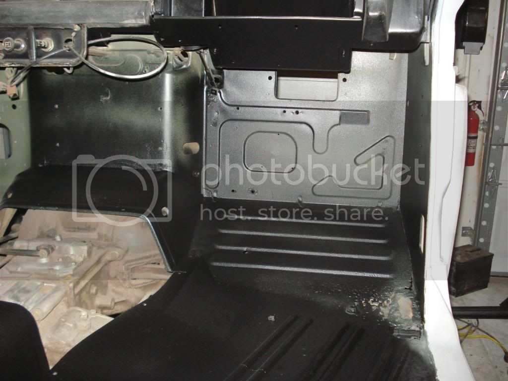

Right hand rear under body.
Under Body
Left hand rear under body.

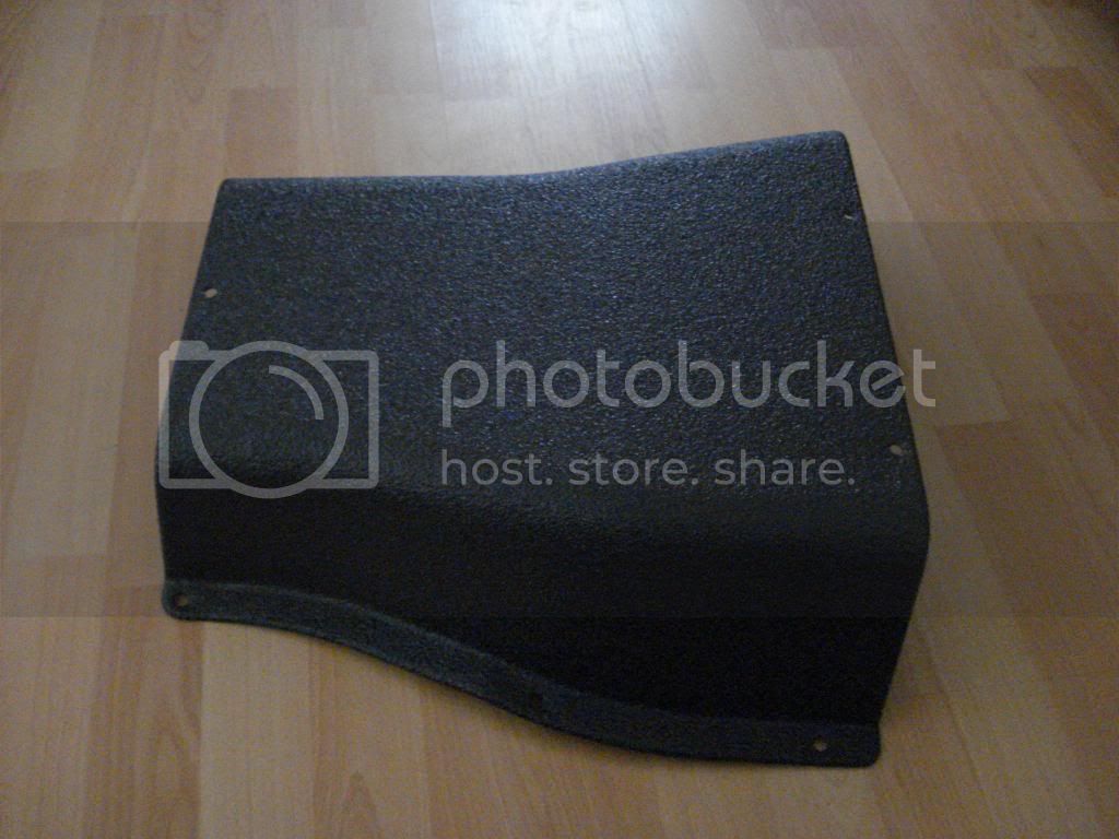

Trans cover after LineXed

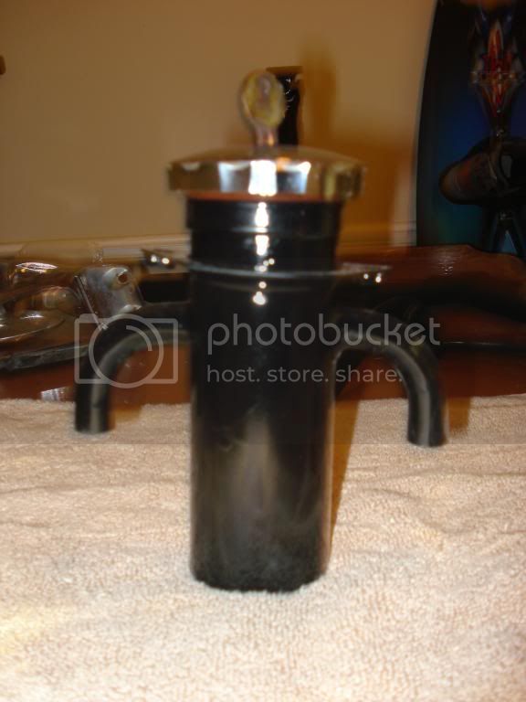

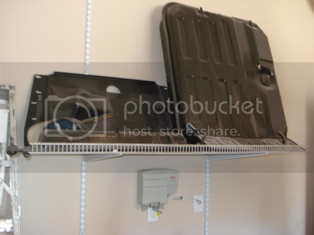

Gas filler neck
Gas tank, and some other finnished parts

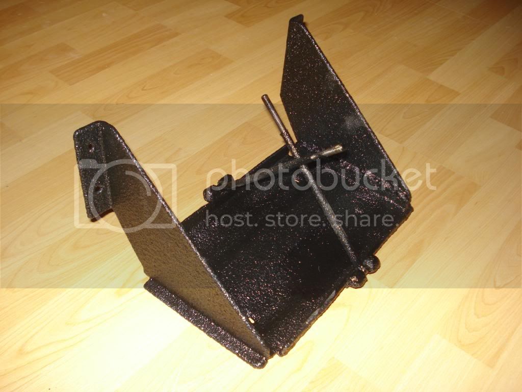

Line x battery box

Keep going your work looks great!
let us know if dows calipers work nice on the front, have an Idea to place 4runner calipers the same way for an axle that I have at home.
are you goin to run 33´s or 35´s
cheers:beer:
35" mtz's is the tire I plan to run. The calipers I am running with the brackets from jt outfitters is for a 84 monte carlo. It only works with that caliper. I am sure they will work great, they line up great after a little grinding!! Even with the jt disks I had to grind down my hub flang, just a cun* hair. Rock out:beer::wrench::flipoff2:
Moving forward!!
Oh ya you have to grind a tab off of the calipers too. No harm those.

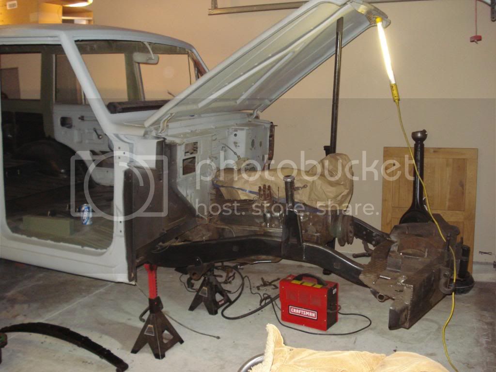

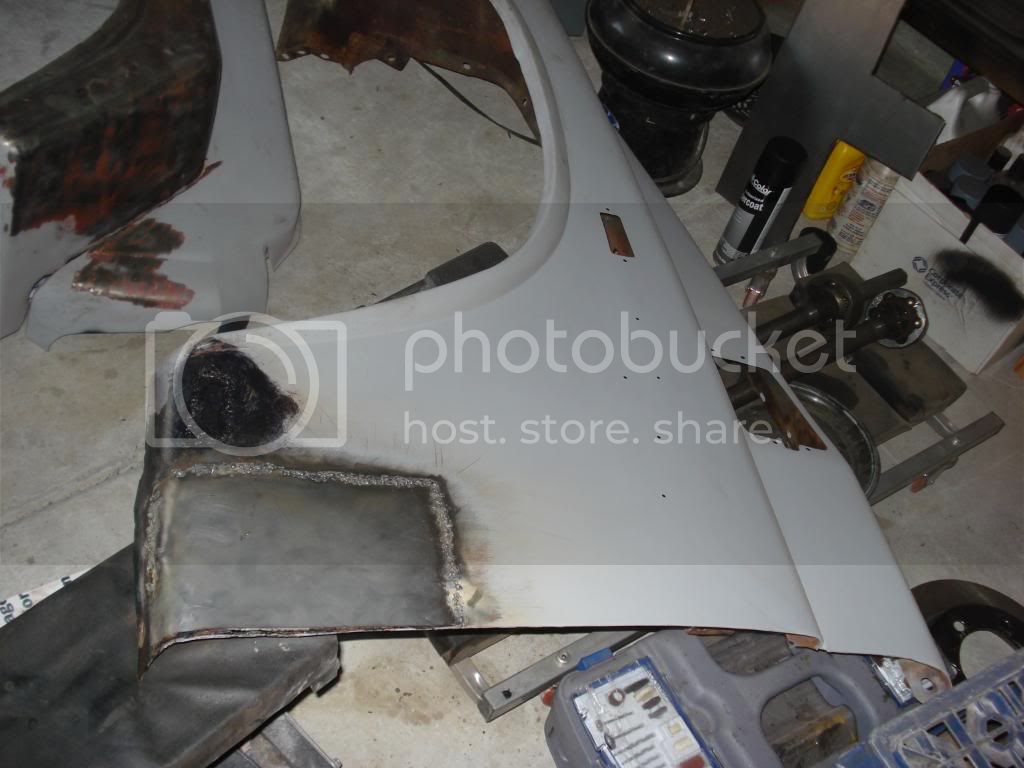

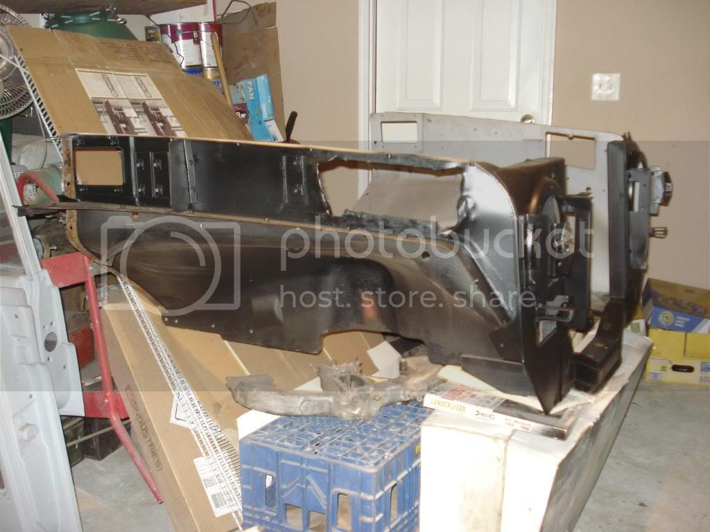

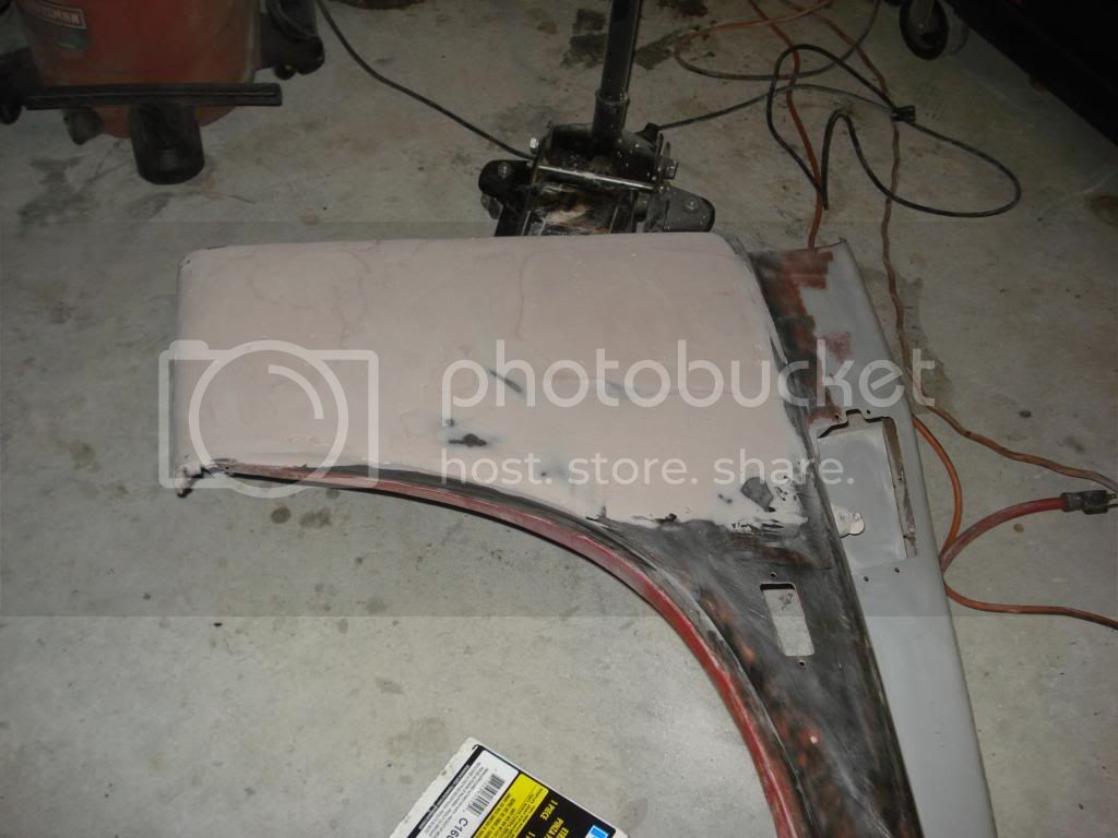

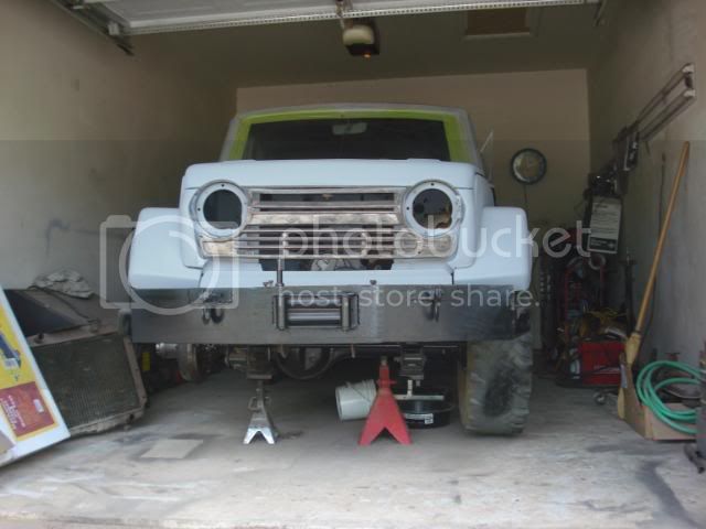

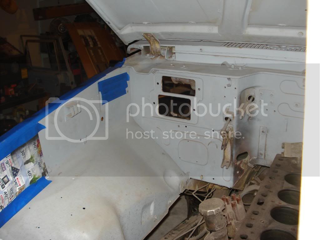

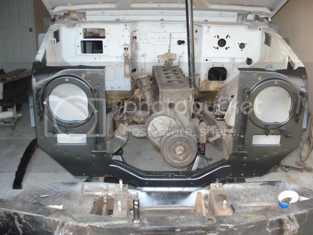

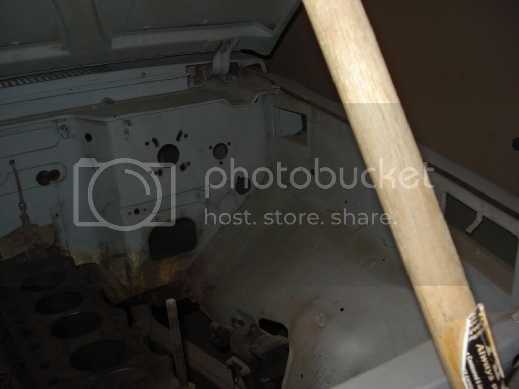

Well this is what I did today, I pulled the front clip to get it ready for paint and clean up the rust at fire wall. I was thinking of line x ing the inner finder walls for the engine compartment, but I think I should just paint it white original (alpine white). Give me some feed back on that. Well tired of typing so light the right end!! :beer::wrench::flipoff2:
Driver side front fender repairs
Still working on passanger side fender, I hate sanding fing bond!!!:mad:
:beer::wrench:

Are they enough to stop a Pig on the front?
They should work fine, I asked the guys at jt outfitters the same question. They use this same set up on some of there rigs runing 40' tires, I will just be runing 35' tires so I am sure they will work great. 95% better that the old drums you know what I mean. Cant wait to try them out!!!! :steer::cool:

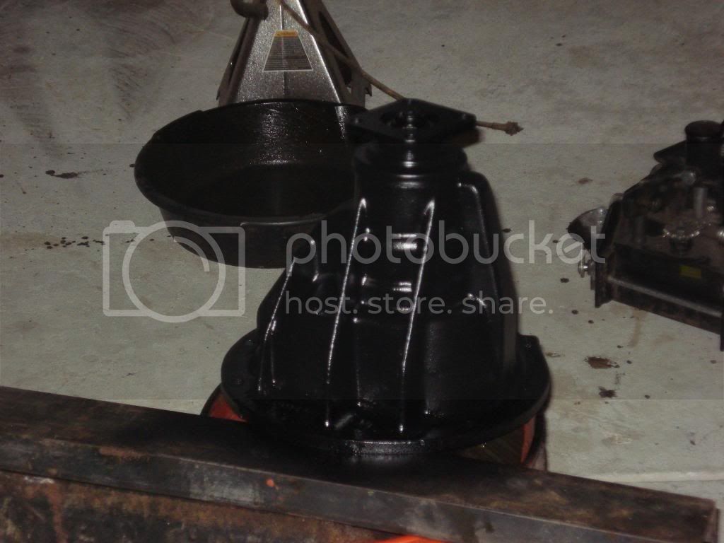

Just drained the old oil from the F engine, holy crap the oil comes out fast it almost over flowed my drip pan. Should be a warning placard above drain plug, "Causion huge stream of oil that comes out fast". How many quarts of oil go in the f engine? I know alot came out. :)

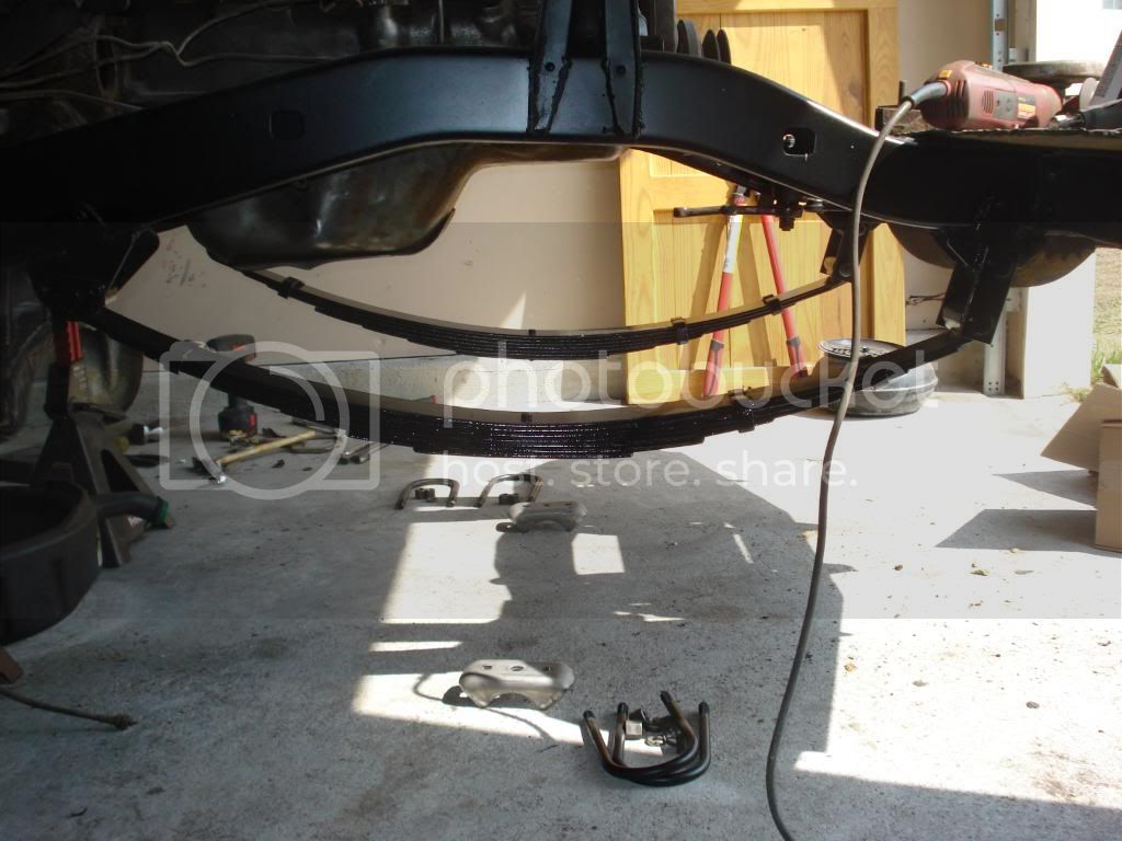

Front Axle about to go in SOA
Working on the front suspension today. I put the springs on with new bushings, I will be setting my pinion and knuckles tonight I hope. I desided to have a local machine shop cut my front knuckles, so I can set the pinion angle, weld on new spring perches, then set the kunckles to o and ticky them in place. Then pull axle back out and have the machine shop put a good strong weld on the kunckles, and perches. I will post some pic soon. :)
