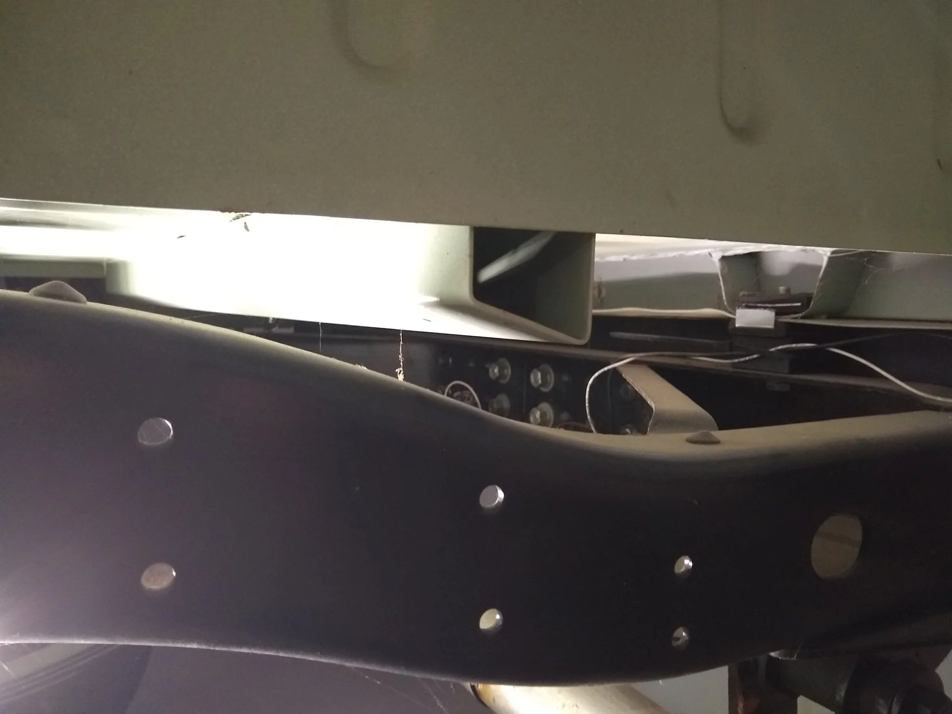

Looking for a couple of body mounts to connect just in front of rear axle to bed.
Your axle is held on by springs and bushings not mounts. Let me know what OD, ID, etc you are needing. I have a box of spare bushings.
or if it is body mounts, post us what location, i have leftovers of those also.
Sorry. That was a horrible description of location.
Pictured is the body mount location in question. This was taken on the DVR side, rear of the rear tire looking to the passenger side. There are two ribs under the rear of the tub. The rib forward of the rear tire has a lift block and rubber mount between the frame and tub so I assumed another is needed here. I need to get rid of the body lift stuff.
I will have a need for spring bushings for another project. Looking to make an 88 2wd mini truck safe enough for use a s a DD. I have to get the fuel take issues taken care of before I work on the springs.
I'll look at my leftovers. I think that is a little pad held in with 2 little plastic plugs approx 2" x1"
Thank you for the conformation 2fpower and tornadoalleycruisers. My original description sucked.
