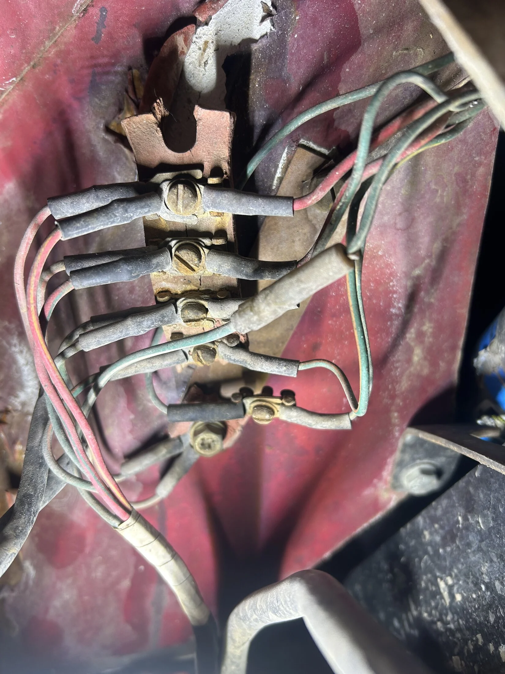

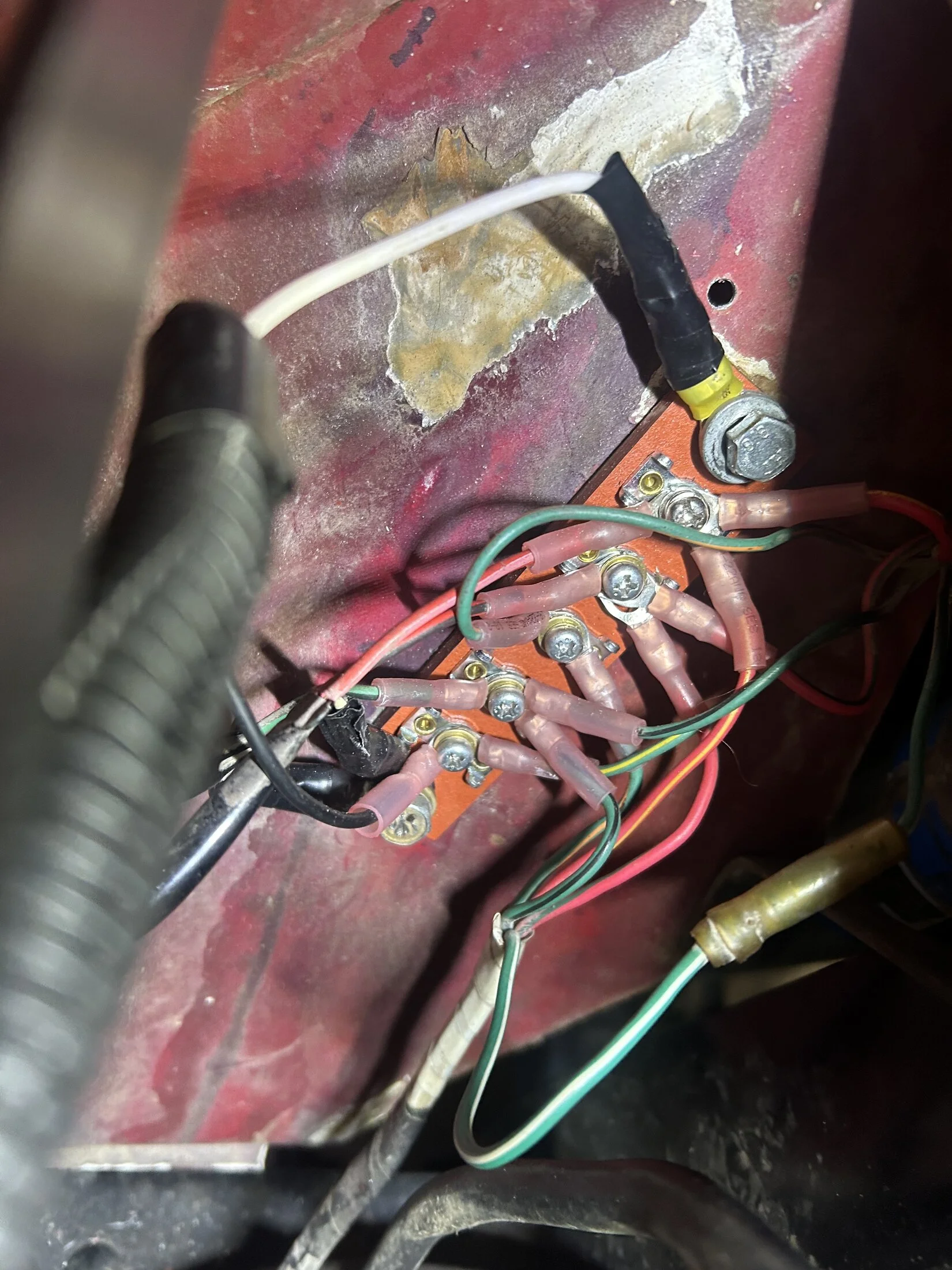

I’m having an issue with my wiring blocks. They were so corroded that one of them was separated from the fender well and the blinker connection was detached and just floating.
I ordered new blocks and replaced all connectors. Previously did not have working blinkers but pretty sure that’s due to the blinker switch on the column as it only clicks on when switched to the right. Did replace the stock blinkers with some aftermarket led’s, that’s the black and white wires in the picture. Now I have no headlights or park lights.
Anything I’m missing?
Also PO did some of his own wiring as well.
Here are some before and after pictures

Typically the white wire with a black stripes are grounds. You should start by checking component grounds. In your case, the 1 blinker problem is most likely the flasher and the led turns. The led's don't pull enuff amps to activate to 40's old mechanical type flasher, so it clicks once. Using a flasher for led's or an electronic flasher which senses lower amp draw is required. I would check the grounds on the other fixtures that are not working. Most fixtures use their mounting hardware to the body or frame as grounds which eventually creates poor connections. I usually add ground wires to the fixtures body and connect the wire to the frame. A continuity/test light is helpful in tracing electrical issues. You can find wiring diagrams on Coolermans website.
You should pull every plug apart and clean both sides of the unit. Look carefully at the wire below the connection; corrosion often crawls under the insulation and eats the wire next to crimp connection.

Thank you for the input. Today I am starting bye rewiring the grounds from the headlights and park lights to the frame.

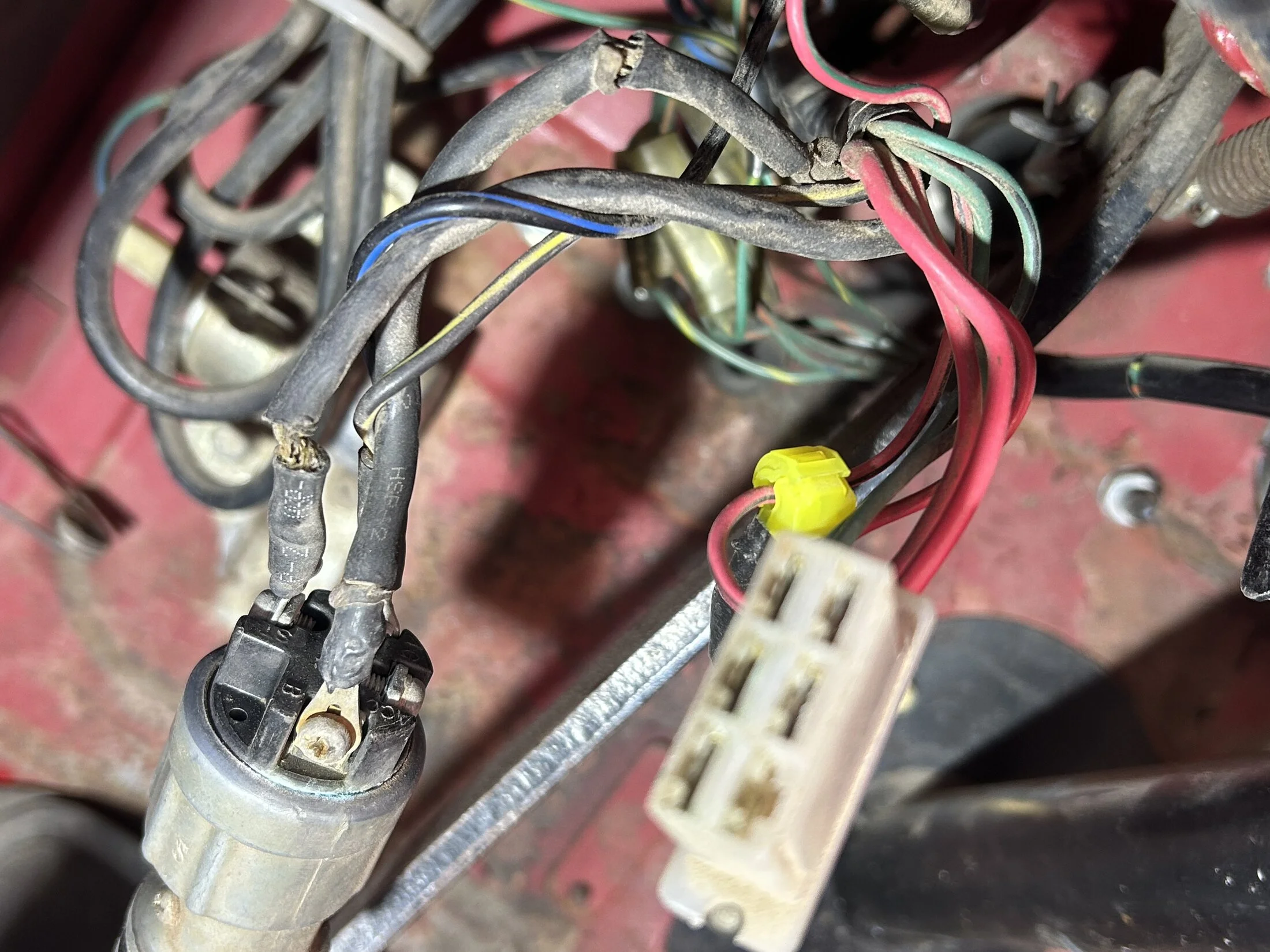

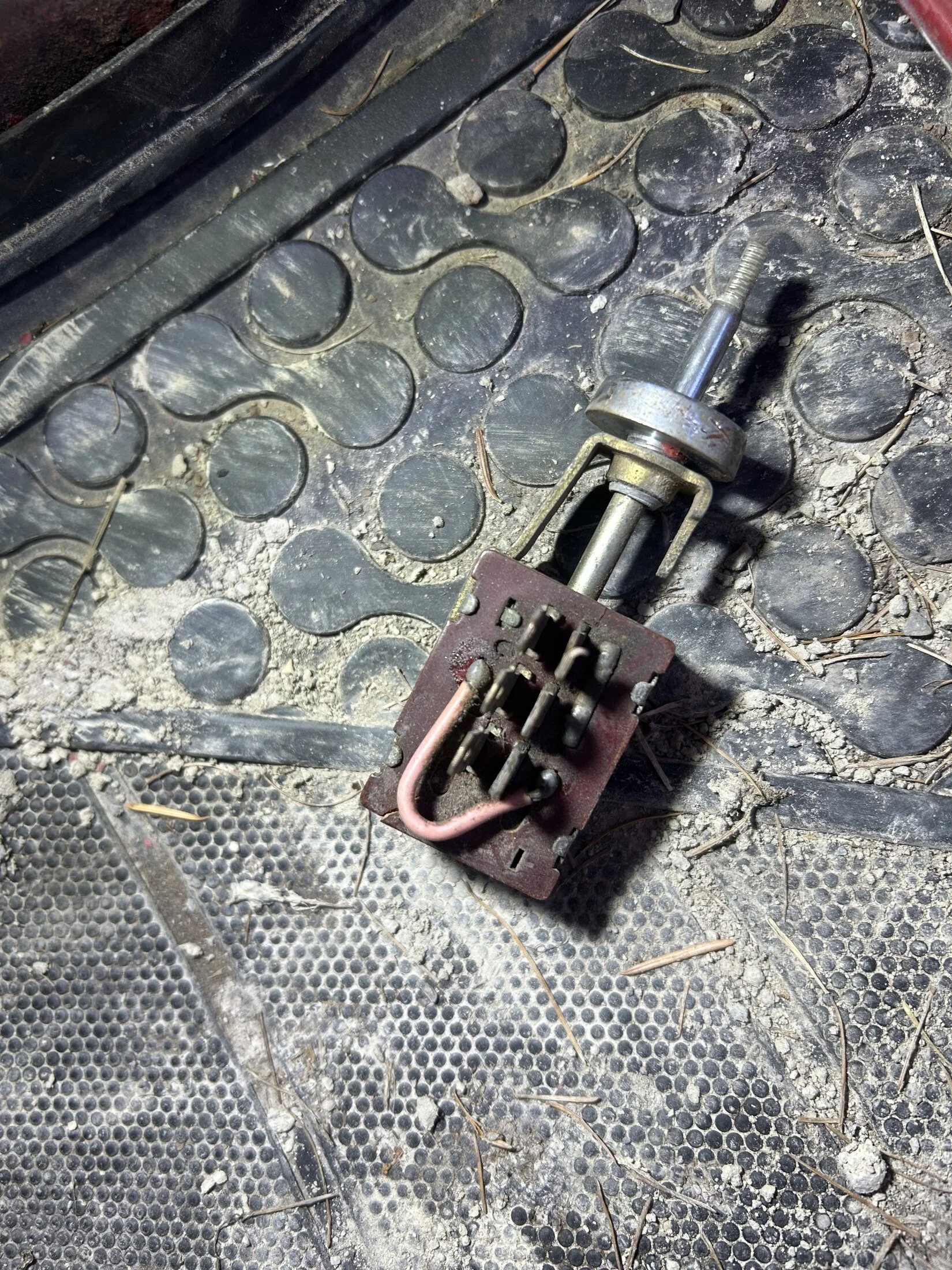

I’ve got a lot of problems from the p.o. He had proffits swap in a 3FE out of a donor 62 and the wiring behind the ignition/headlight switch is ugly! Not sure what the jumper wire soldered on the light switch is doing? Any ideas?
The wiring on your ignition switch looks corroded and ready to fail. I would address that for sure.
I would take this as an opportunity to refresh that ignition switch at the same time: OEM TOYOTA Japan Spec. Early In-Dash Ignition Switch & Key Lock Cylinder Comes w/ OEM YAZAKI Service Spec. Connector Pig Tail Kit w/ Solid Brass Terminals FJ25 FJ40 / FJ45 Pickup 1956-1972 - VintageTEqParts.com - https://vintageteqparts.com/products/nos-early-in-dash-ignition-switch-key-lock-cylinder-comes-w-oem-yazaki-service-spec-connector-solid-brass-terminals-kit
I see something vampire tapped onto one of the headlight wires (yellow plastic connector). That will fail eventually too - might as well deal with that while you're at it.
The jumper wire on the switch is factory. You can get new OEM switches.

Figured that would be a good place to start with the ignition wire. Yes I will cut that wire clamp out of there when I wire up the new switch. I ordered a new light switch as well while I’m in there might as well change it. Wouldn’t have guessed that small soldered jumper wire would be factory but I see it in the picture on the new switch.
