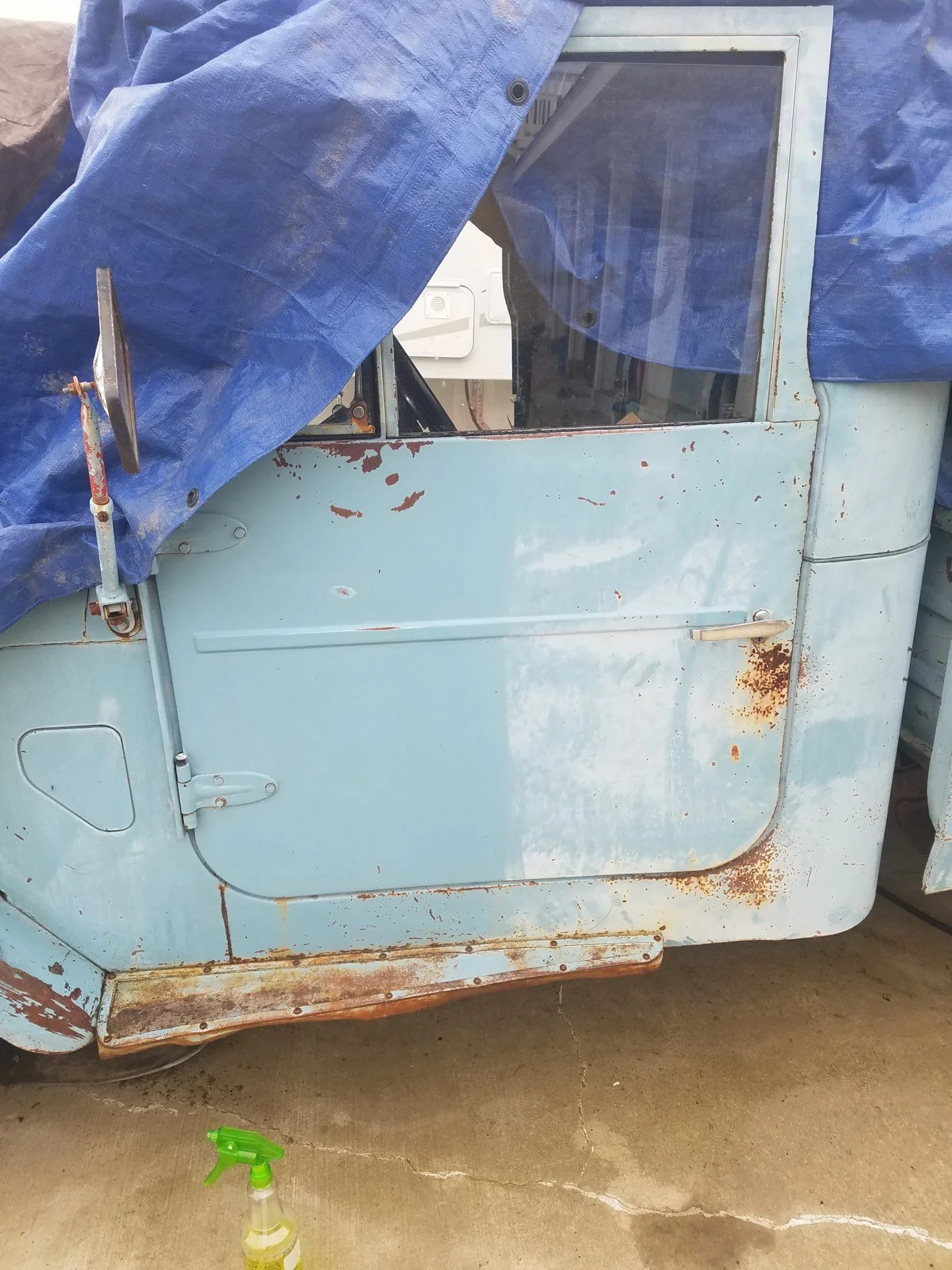

Seems to have done well. Looks awesome. I used a sponge/scotchbrite and straight scotchbrite and I liked the former the best.
I don’t think mine would have been so noticable without the abrasive pad.
