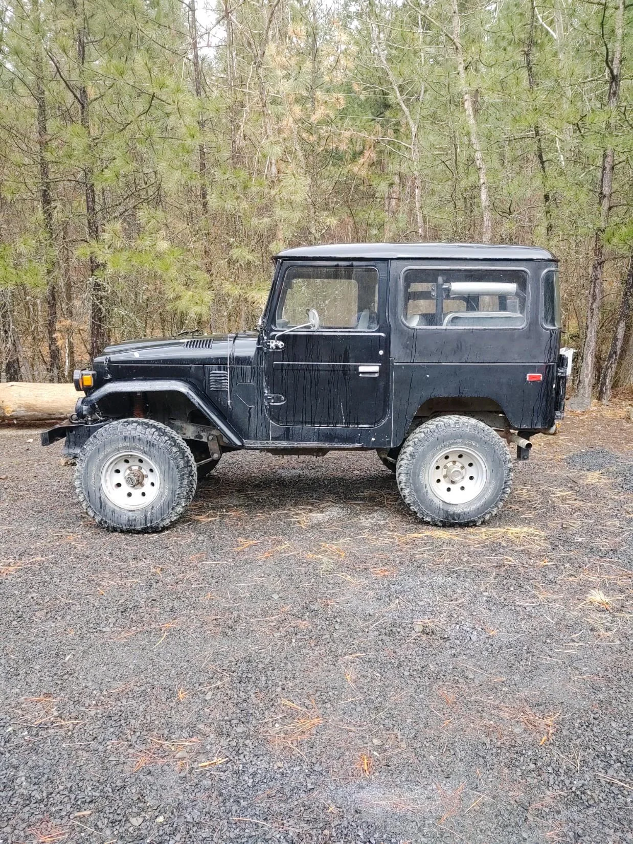

Not the best pic but you can see the shackles,
I don't think an add a leaf is going to help you with that, your shackle angle looks a little wrong for skyjacker springs. Like your springs look too short eye to eye.
Well dang, that's what they are maybe I will check the numbers again. But yes I do see what your talking about. I would hate to buy the same thing twice.
Mine are 44" eye to eye, center to center

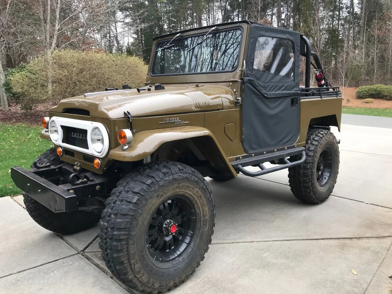

This is my 67 sprung over (and shackle reversed) on 37's with a wheelbase stretch and fj60 rear leafs.
It is much, much easier to just toss on some 3-4" lift springs. The spring over is great, but it is much more work (and $$$) to do it right.
I ran spring under for 20 years and it was great for everything I did. I've always wanted a spring over FJ40, so I did that when we rebuilt it. I like that too, but for different reasons.
