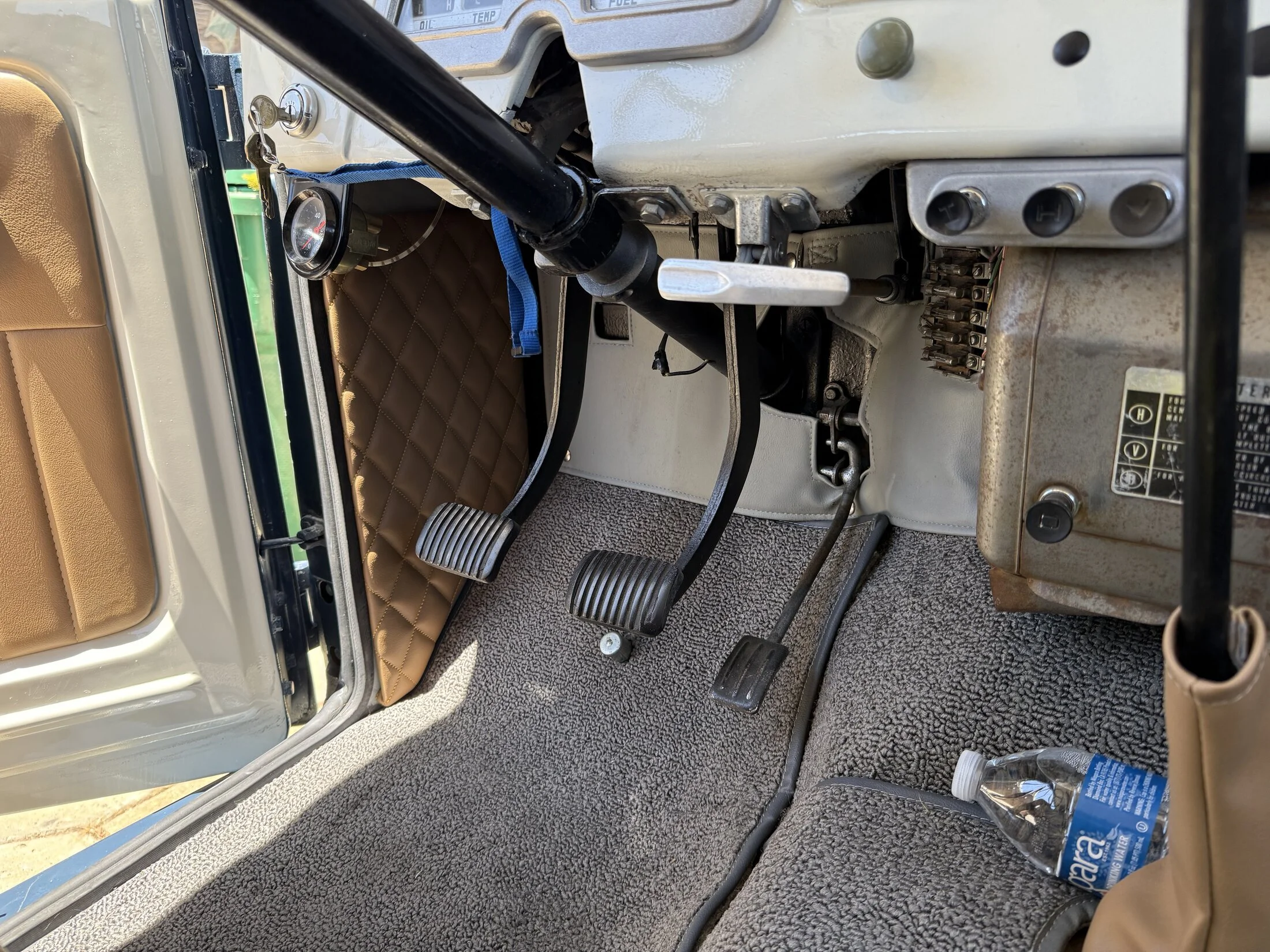

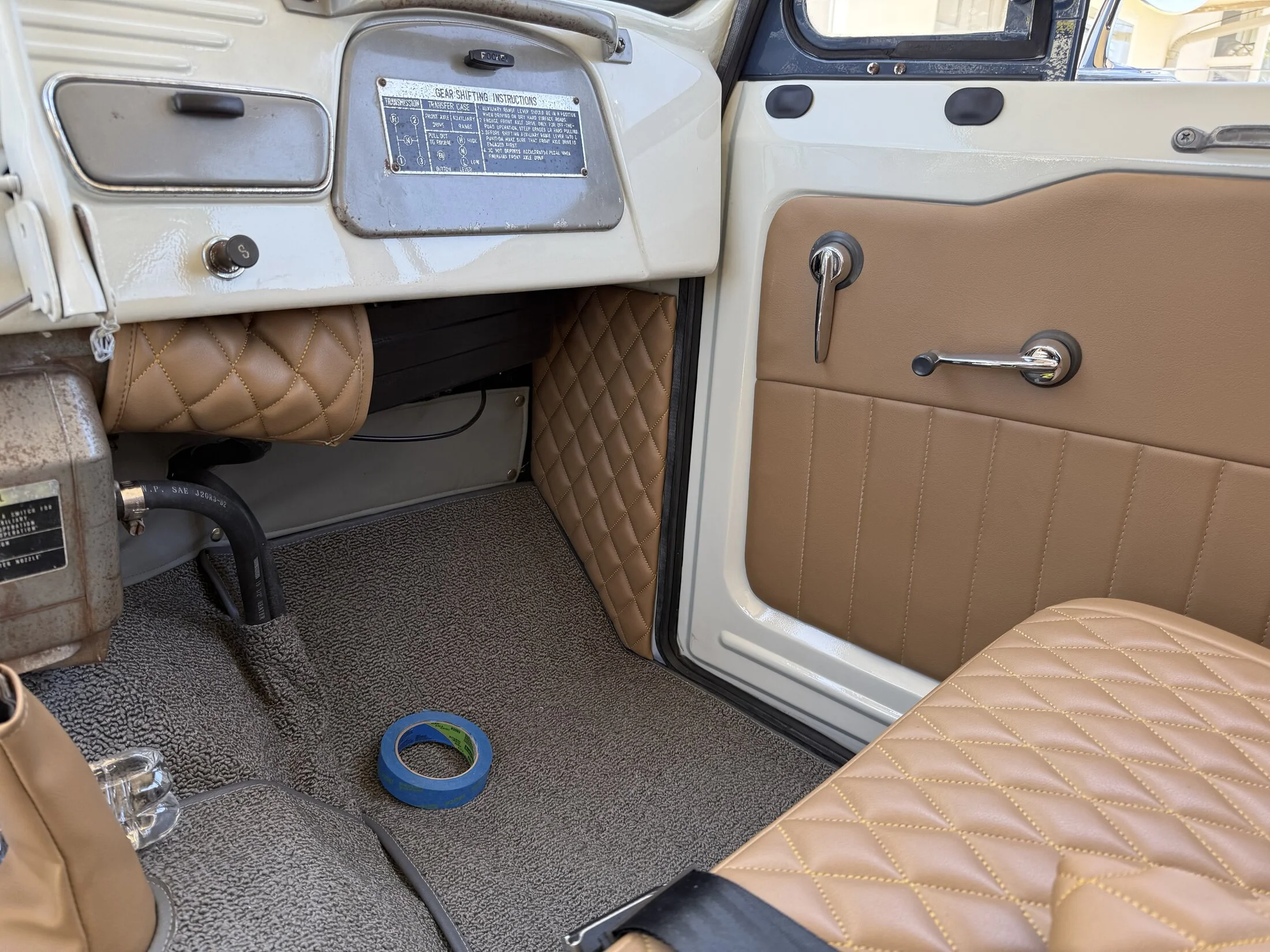

Took some of the extra fabric from my upholstery job and made some quick kick panels.

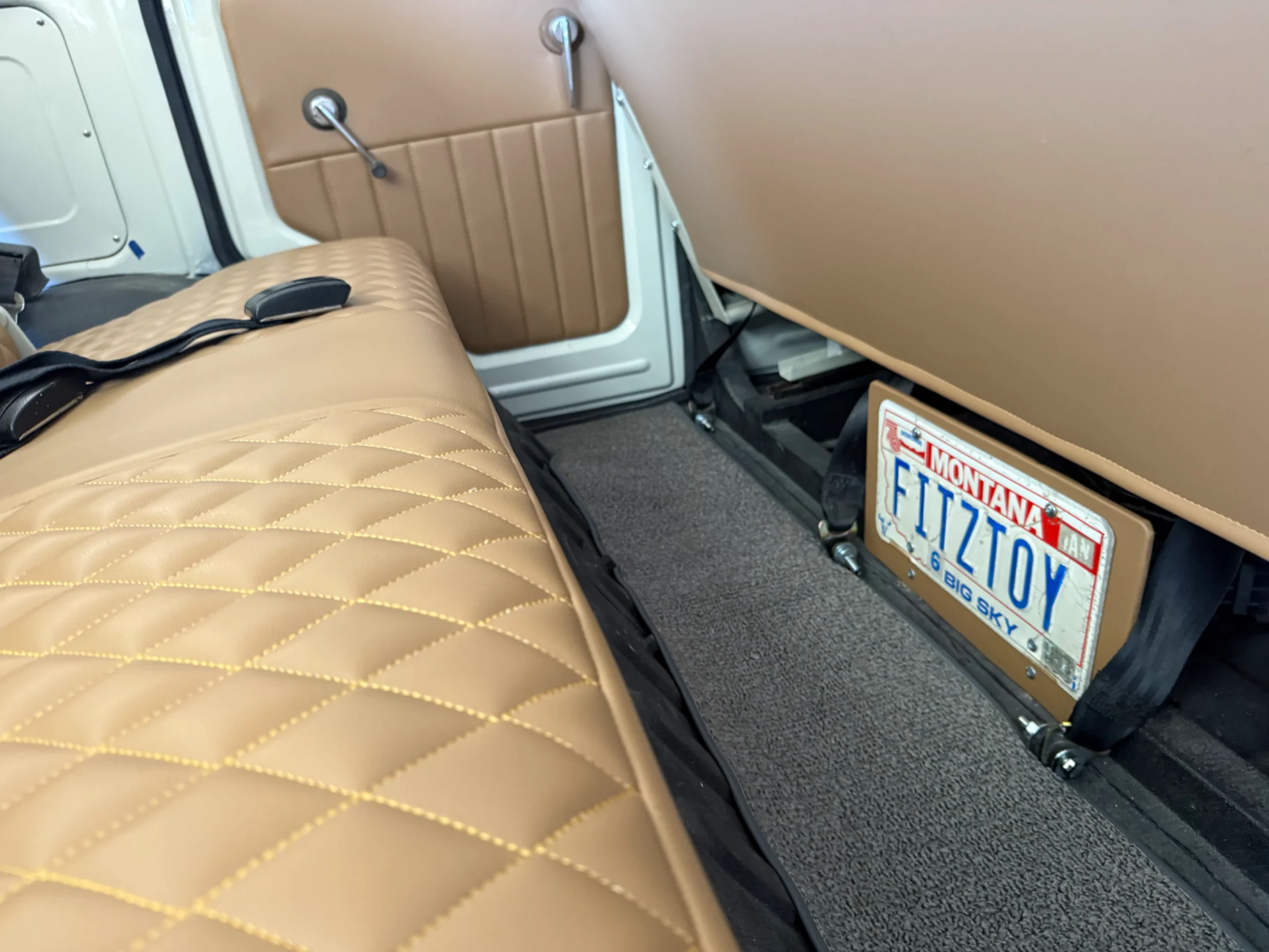

One of the things I said I was going to do was incorporate “Fritz’s” License plate into the build. This was his yellow pride and joy for more than 55+ years . Hopefully he is looking down on me and happy I was able to keep his LV on the road for a lot more years. I think I found a suttle place to pay homage to Fritz..

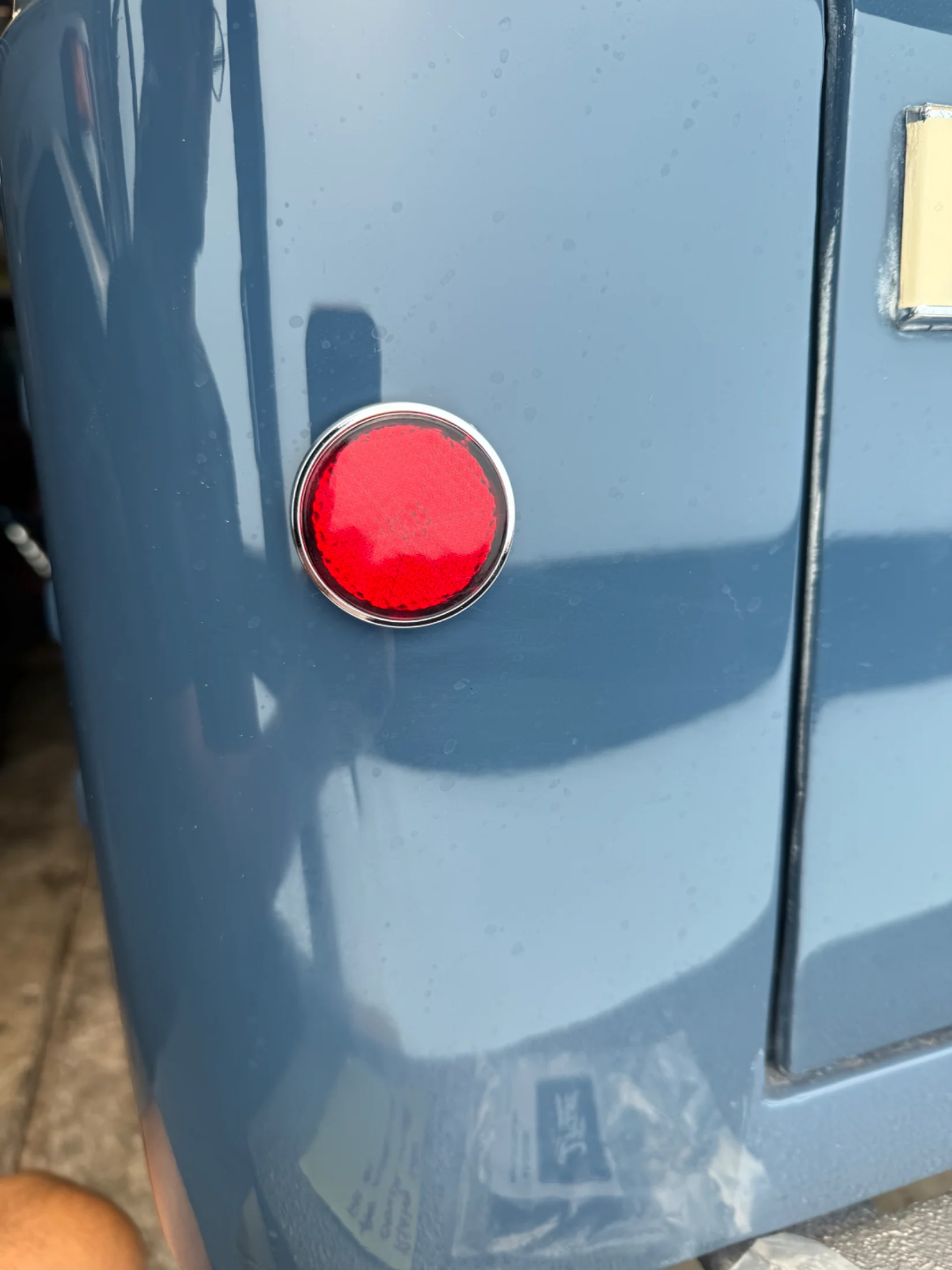

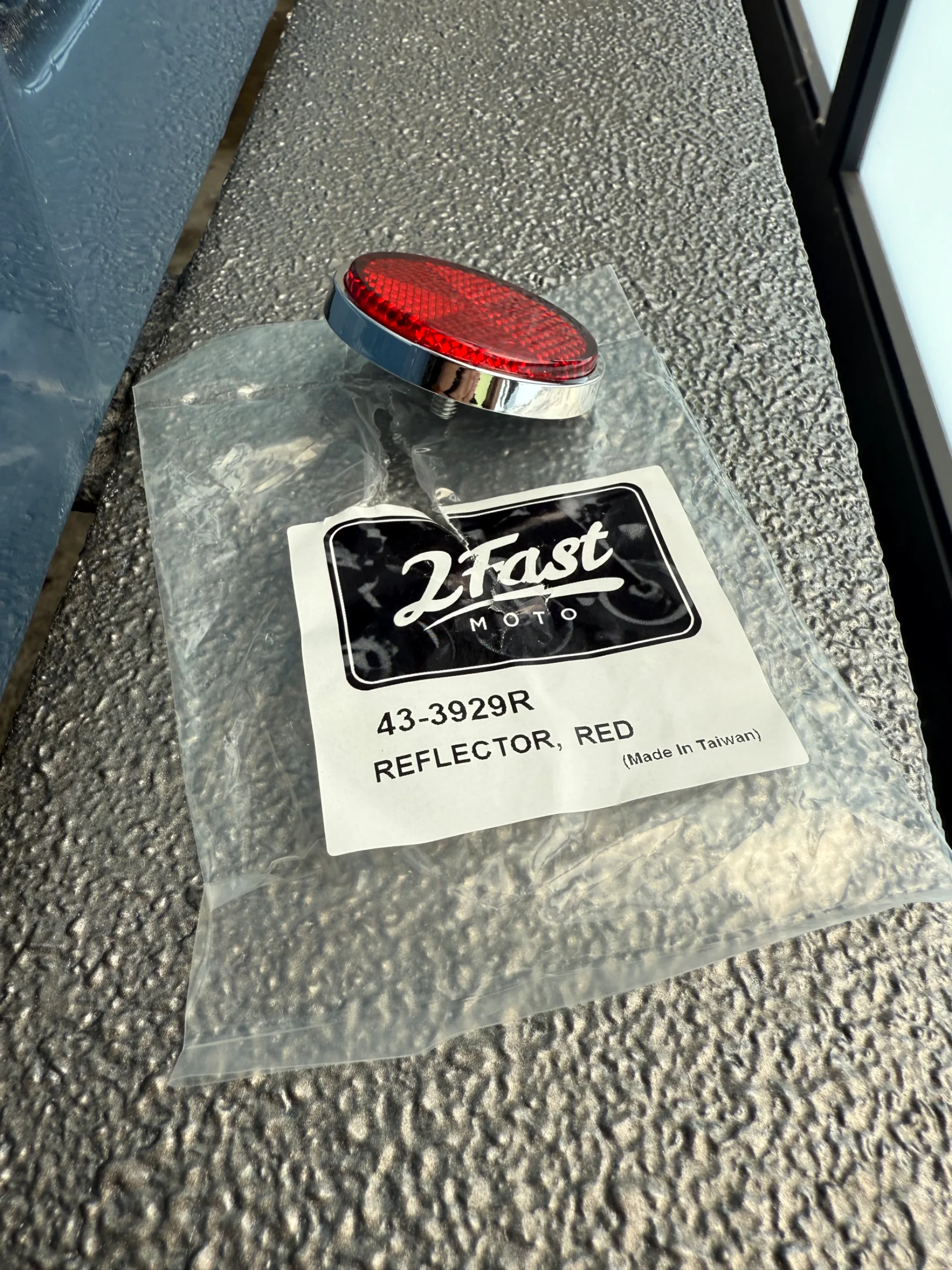

Going to make these work . I have original ones with gaskets but one stud is broken and will fix original ones later and install but for 10$ shipped these will fill the holes for now. Included the package if anyone wants to know where I got them.
Thanks Jason. Those look very close and great. I was just on the hunt for something like that. I found similar ones but not with a chrome ring. OG originals will hopefully surface one day.
Those look really good. I think I found a set of cat eye reflectors that look pretty similar. In a decade of looking I’ve only ever found a single OEM reflector, but once those aftermarket ones are on I bet you’ll never worry about it! Wish I had gotten the 3D files when I had those gaskets made years ago but there wasn’t much to them really. Just a rubber wedge with a little curvature to it.
LV is looking beautiful by the way! I love these trucks.

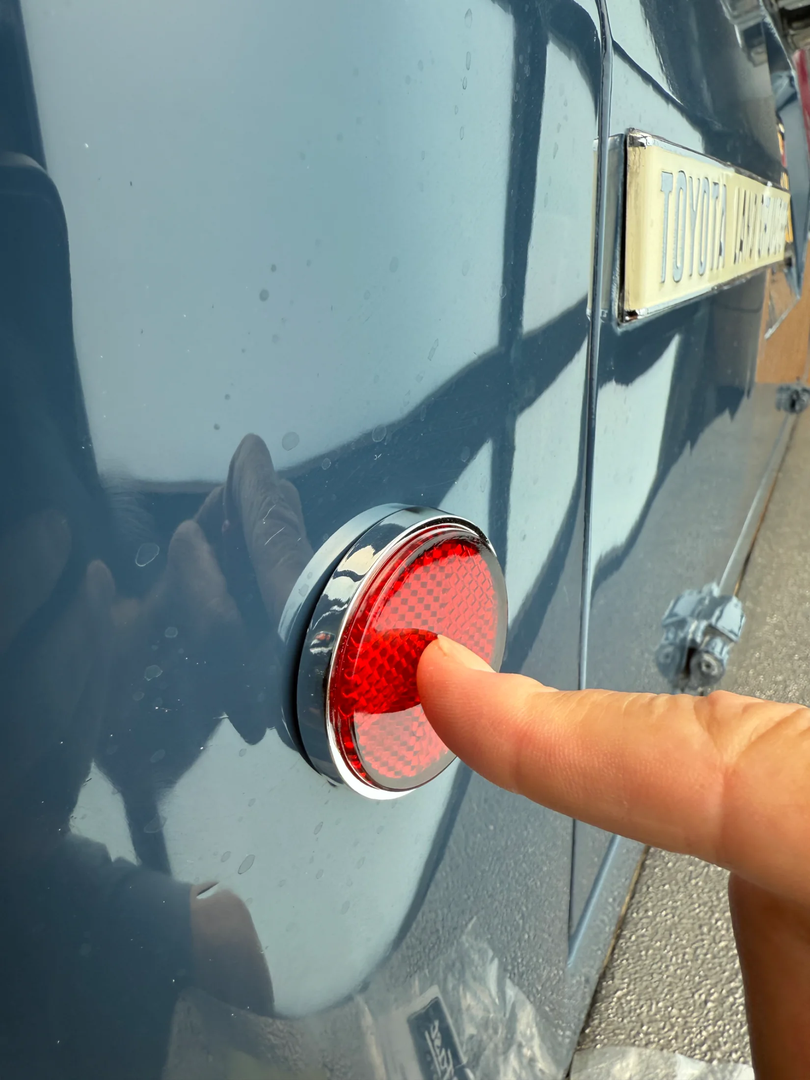

Agreed Jason, those look great. I bought the same reflectors, now just working on some rubber backs. Hoping for 3D versions or handmade redneck engineering.....What was your solution to extending the reflector stud for mounting?
It fits with a small fender washer on the inside. The nut is 3/4 threaded on but has tension from rubber gasket so I don’t think they will fall off . So to be clear with stock gasket the nut is only 3/4 screwed onto the stud with the washer in place.
