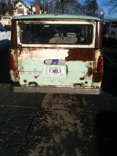

1966 FJ45LV Rejuvenation
I have seriously mixed feelings about vanity plates but this one seemed like I had to get it....
