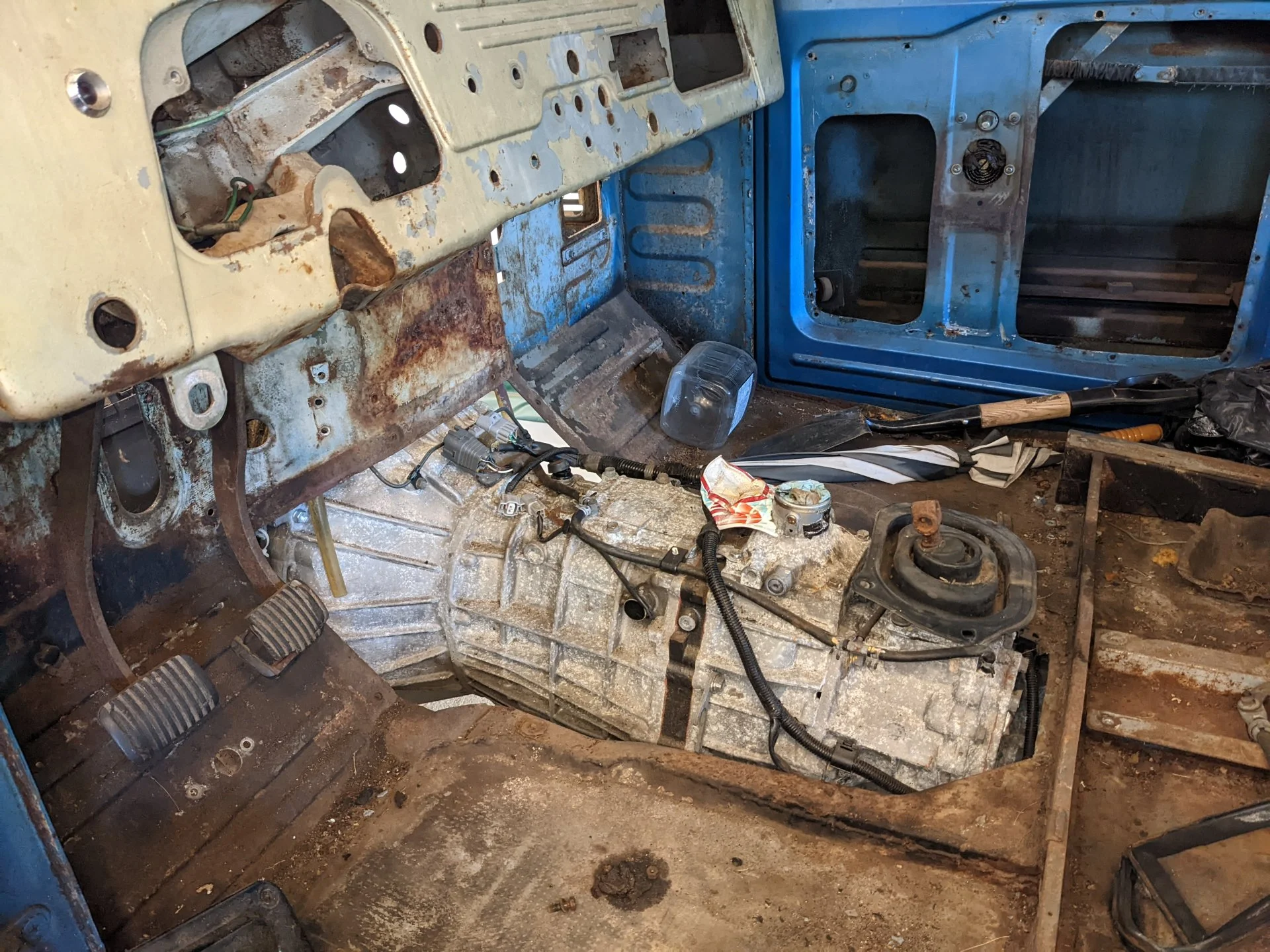

How far back will shift lever be? Looks far back.
Yes it does. Next step is to try to figure out where the seat will be and the steering wheel and go from there.
So.... the shifters will be in just about the right place. The transmission shifter is about 9" back from the rearmost point on the lower edge of the dash (measured horizontally.)
I am going to reach out to see what stock seat position is for an LV.
Measuring in my 40 the seat back is about 36" back from the dash and about 14" from the floor to the top side of the seat bottom. I'm pretty sure the LV will have a lower seat position by a couple of inches.
Just measured my bench seat in the LV. It is 15” off the floor at the front edge and about 35” from the bottom of the dash to the seat back in a horizontal line. I have the seat one or two clicks from full extension towards the rear to get the leg room I need at about 6’2”.
Thank you. Can you measure to where your butt sits on the seat instead of the front of the seat... when it's crushed down and you're sitting on it?
I will try to get that measured before I go but I am headed out of town today. I will say that the seat is tall! I would like the whole base to be at least a couple inches lower. If I am first at a light, I cannot see the traffic light unless I lean forward. I have also hit my head on the inside of the roof a couple times bouncing around.
Thanks... no rush... I am a million years away from getting to the seats.
