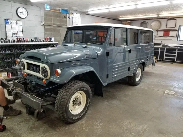

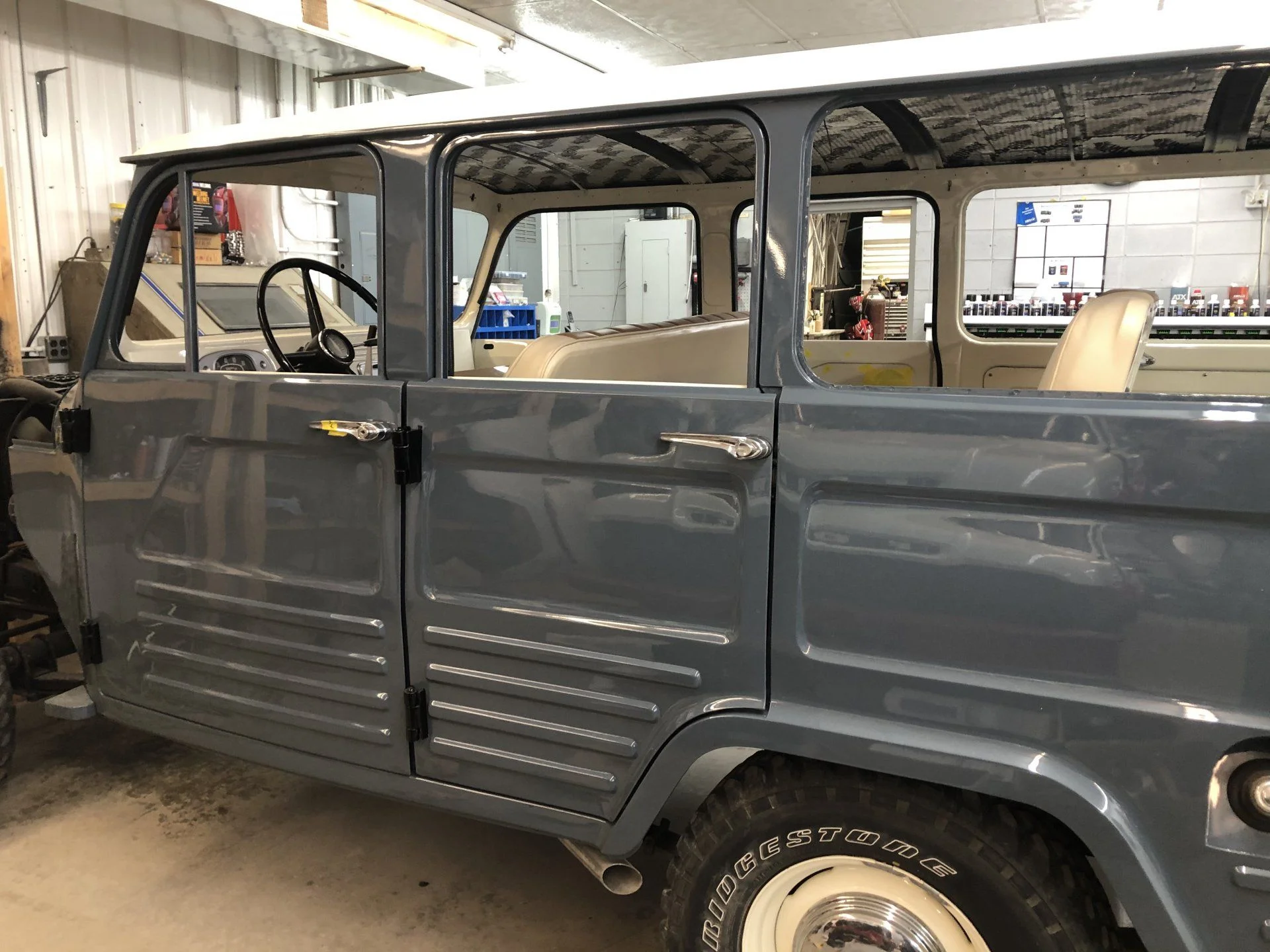

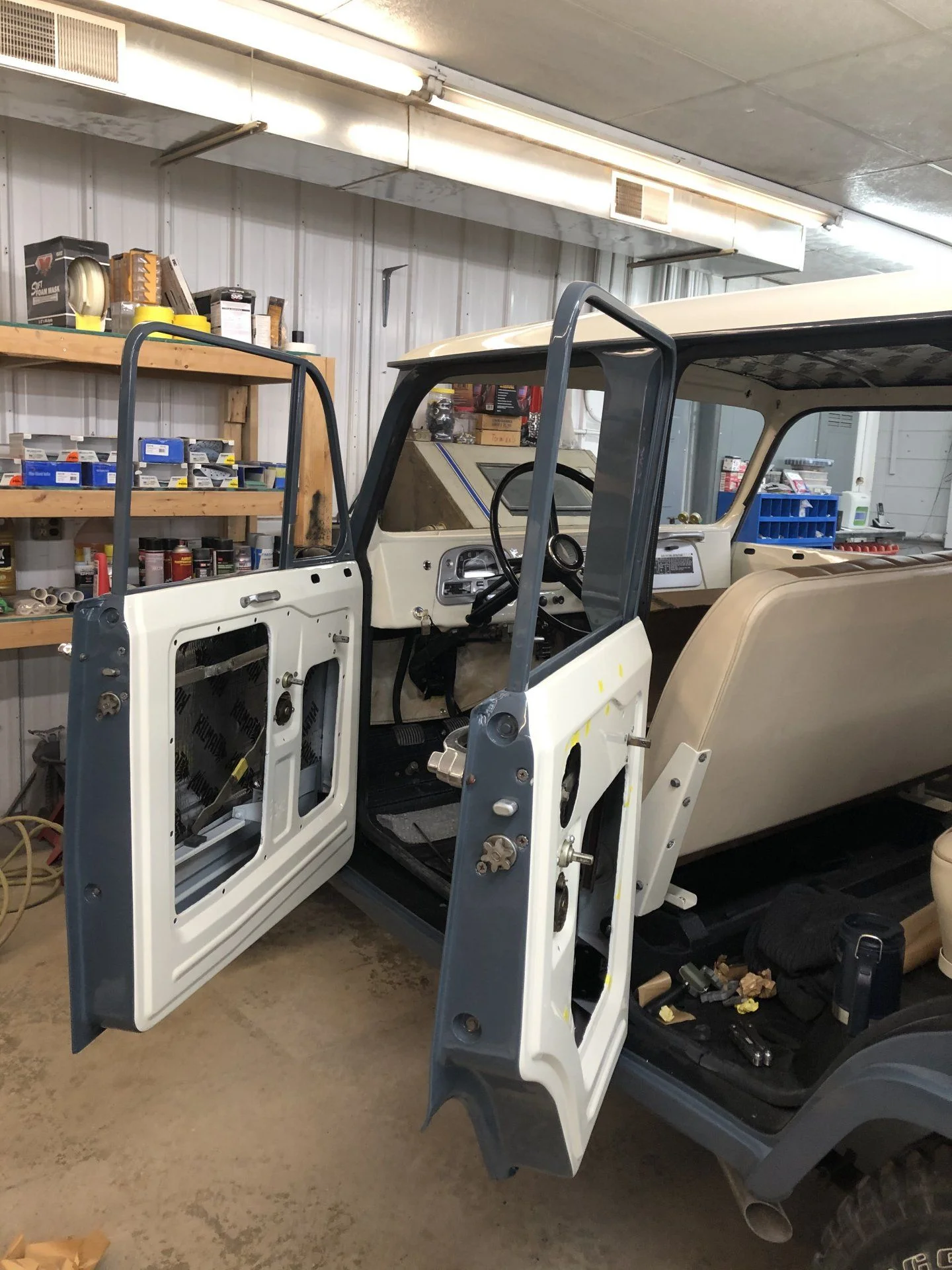

Today’s progress. Getting closer. Glass should get in this week. Doors and gates are fitting. Front door top frame doesn’t seal in the top corner, so working on that. Genders and hood should get done in the next week or so as well. Bumper with winch bracket is getting worked on. Rear bumper being made as well.
Lookin good. I love the color and the taillight lenses.
im guessing the lenses are from Toyota heritage?
thank you!
I believe so, if that is the company out of australia, then yes. They look good. I have 2 sets of the originals, but keeping in case I want ever make exact reproductions. Silly, i know. It's one of those "some day" that will probably never happen. :)

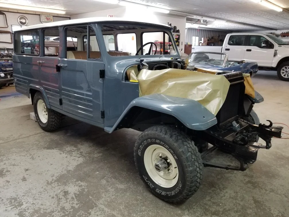

What was the idea behind the hinges being black? Looking good.
thanks for asking. I know it's a different approach. There were a couple thoughts. The main driver was I wanted the vehicle to be sophisticated and tough. And when i designed it, i was still going with the oem bumper and traditional front elements. My concern was the only "tough" element I had was the tires. When i switch the tires out to a more road friendly version, I lose some of the attitude. So I painted the hinges black, added a custom bumper with a winch to get a little more toughness. In addition, I wanted to break up the grey a little. Also, I have a soft spot for the old forged metal, it reminds me of the tractors on the farm, so i wanted to spotlight them. And finally, i figured let's try it, no one else has done it(to my knowledge) , and worse case I have to jerk the doors off this winter and repaint the hinges body color.

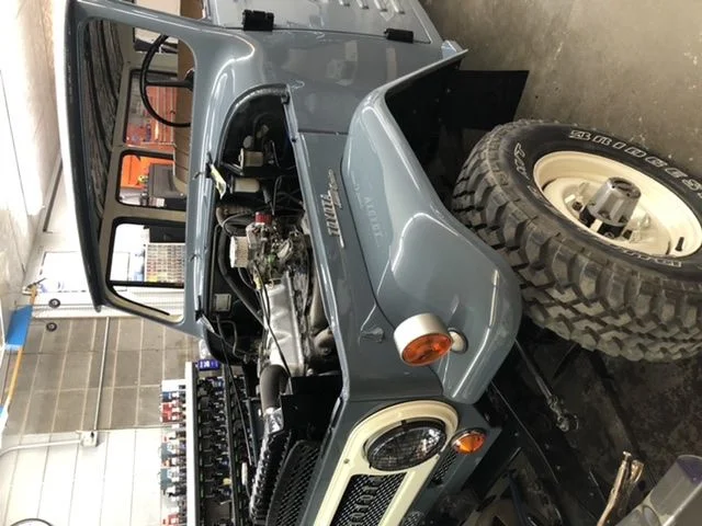

Ditto. Rubber seal is what was meant. Rear side windows and rear hatch.
We used CR Lawrence, 50 feet of: Part # AS-1216 Item # 75001208
In rear windows and hatch, the lock strip went on the inside, for the windshield we are going to put lock strip on outside so it looks closest to original.
For installation, we used a heat gun for the corners to eliminate the tenting and get a good fit.
Hope this helps.
righto, thanks. So you just used universal seal on the side windows too; just reversed. Looks neat.

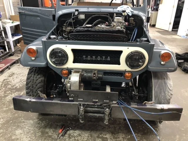

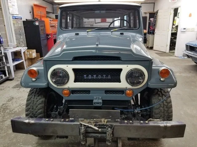

This weekends progress. Any recommendations on how to run the winch cables? Trying to use the hole in the frame to keep it tidy. But the turn is a little to sharp.
1. Flip the bezel so it's on right ;)
2. If the bend is too tight to go through the frame you can run it behind the winch and then strap it to the inside of the bib and up and out to the battery.

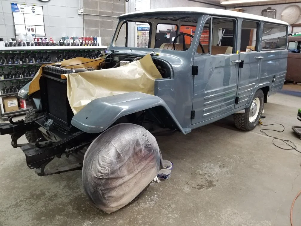

Glass is in. Bumpers fitted. Winch cables routed. Roof rack and bumpers go off to blast on Friday. Need to cut and fit wooden floor boards to the roof rack when it returns. But With a little luck I’ll be driving the old girl by Father’s Day. Famous last words.
