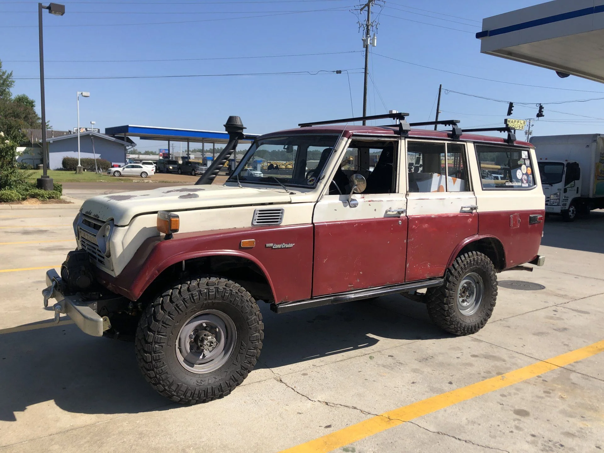

@Tommy Shumpert no RTT. Not really sure about the exact use of the rack.
@divemedic tell us about those pimp straps.
I made the straps. Its UV stable and rated webbing with AustriAlpin buckles. Ends are sewn using kevlar thread with footman loops used to attach to a fixed surface. The length is adjustable using a velcro taco to retain the running end.
My best guess is the strap is good for about 1000lbs. The sewn ends are the weak point given that a single crossed-box was used.

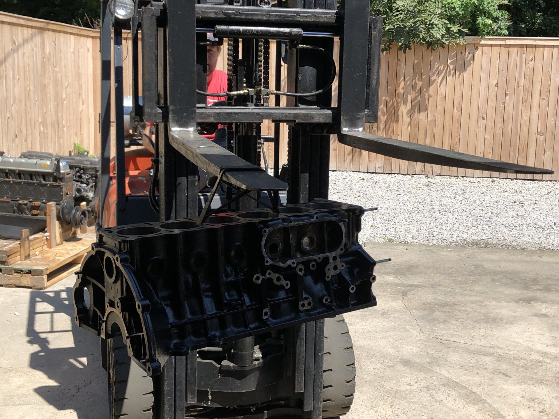

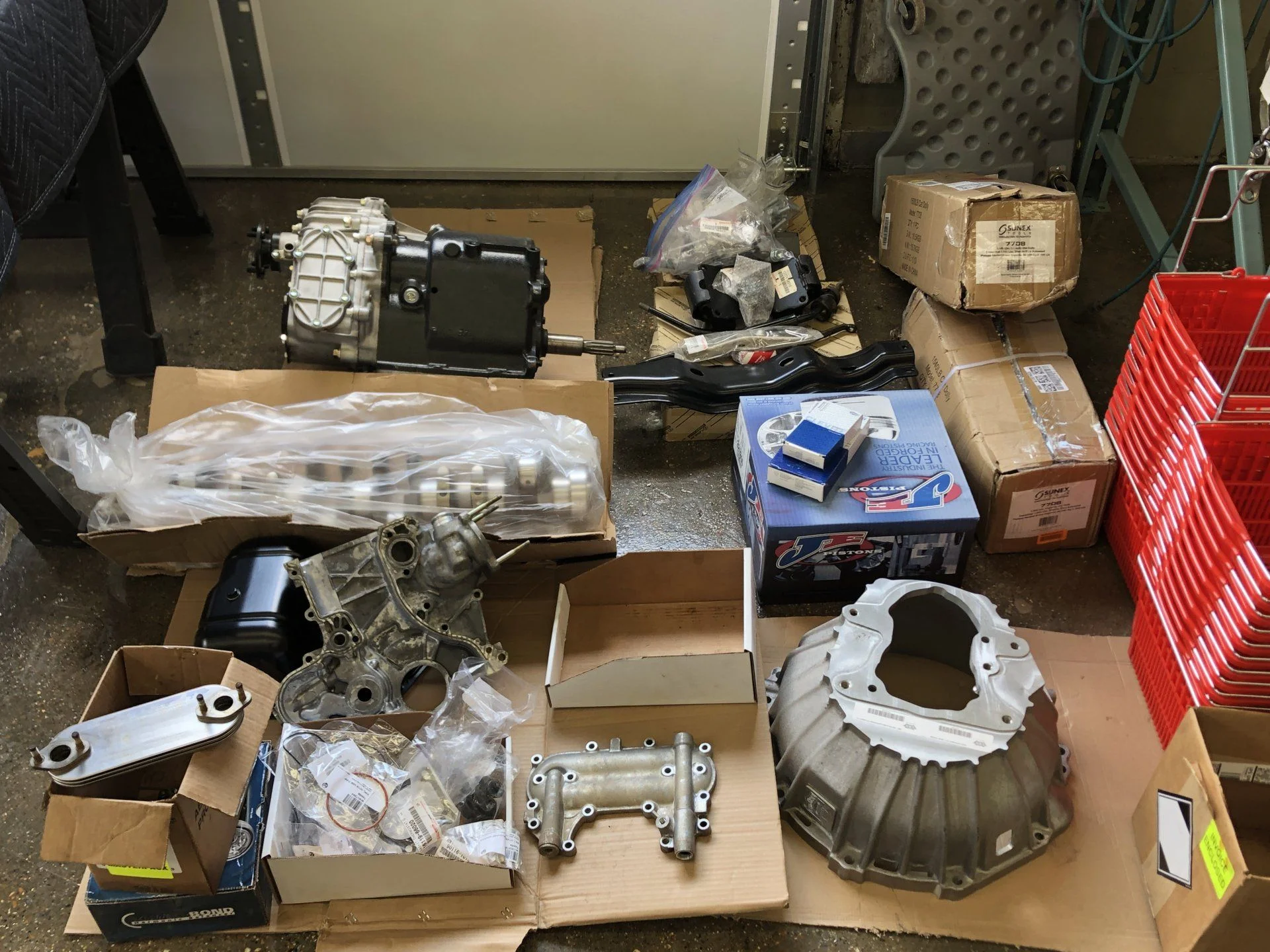

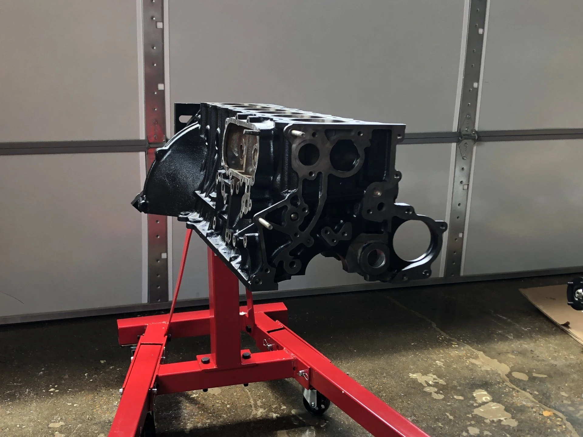

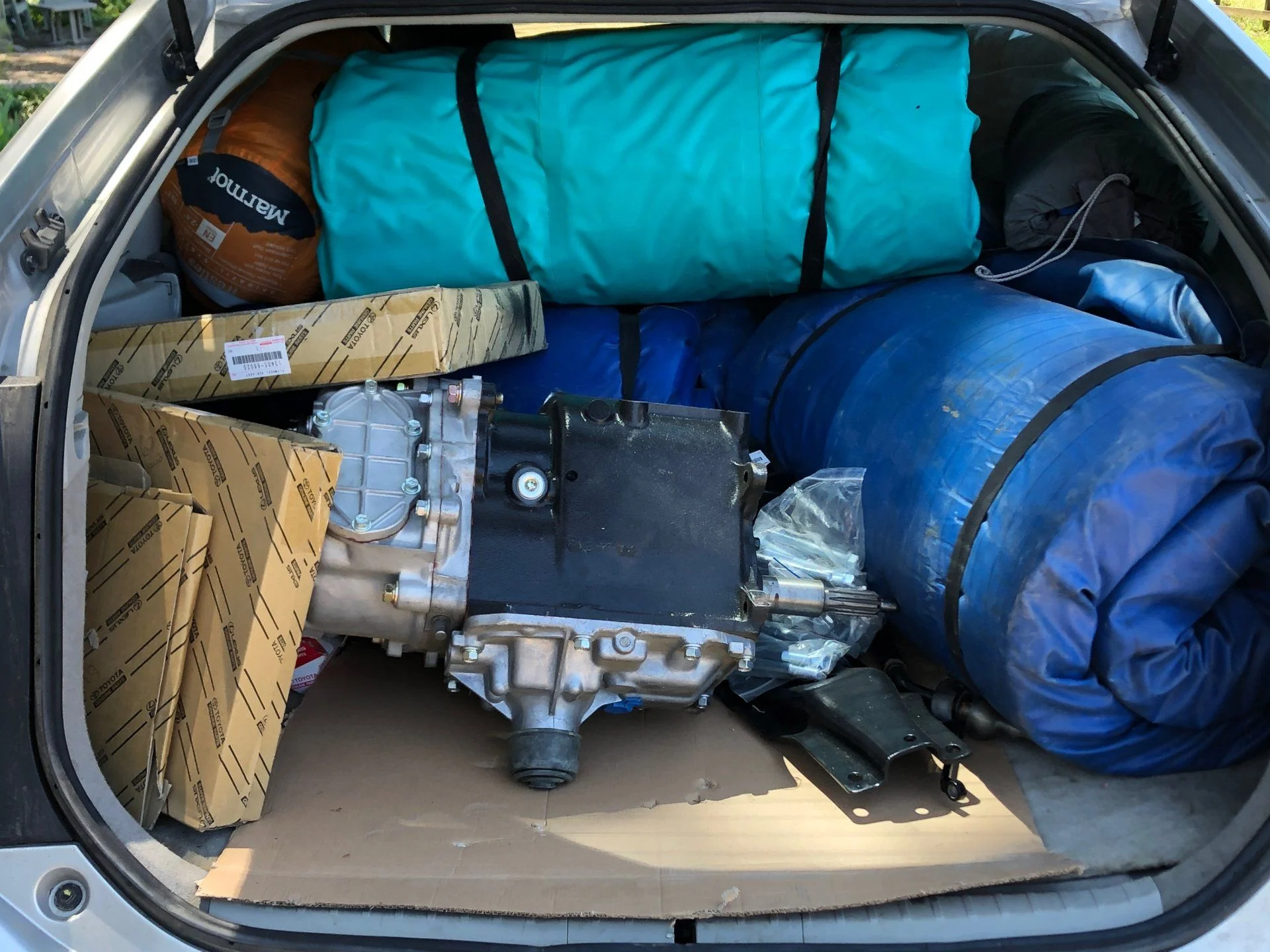

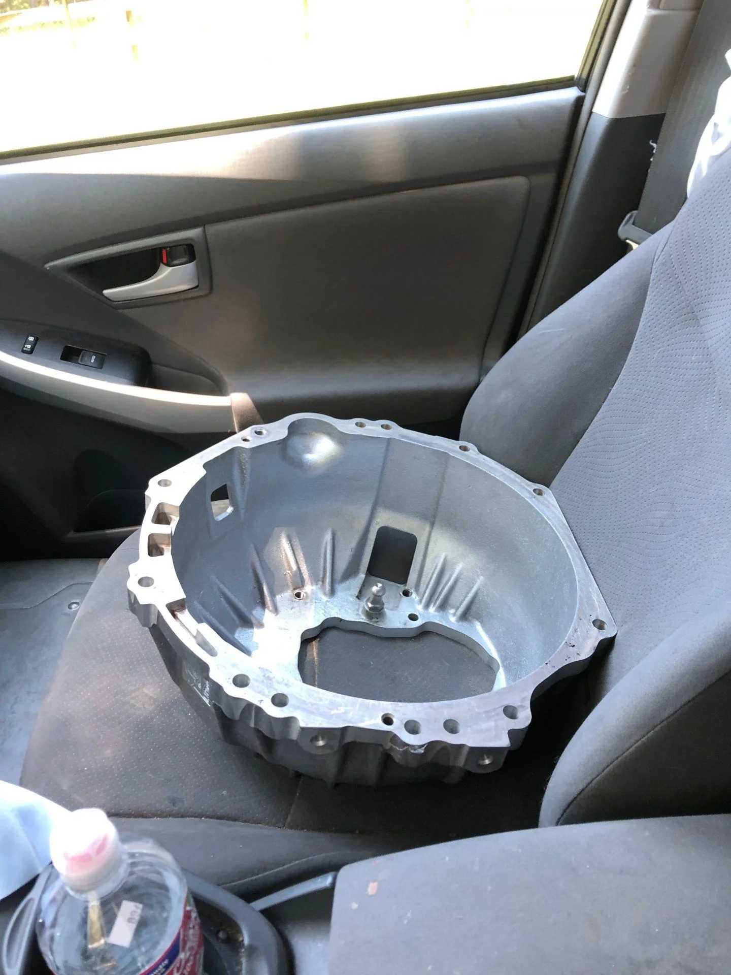

At the shop we moved crap all around in his 💩Prius and tossed the Valley Hybrids built tranny and case in. Sorry it’s upside down.
We put this mission critical piece on the front seat and Beno is off to Mosley Motors for a few days work on getting this drivetrain assembled

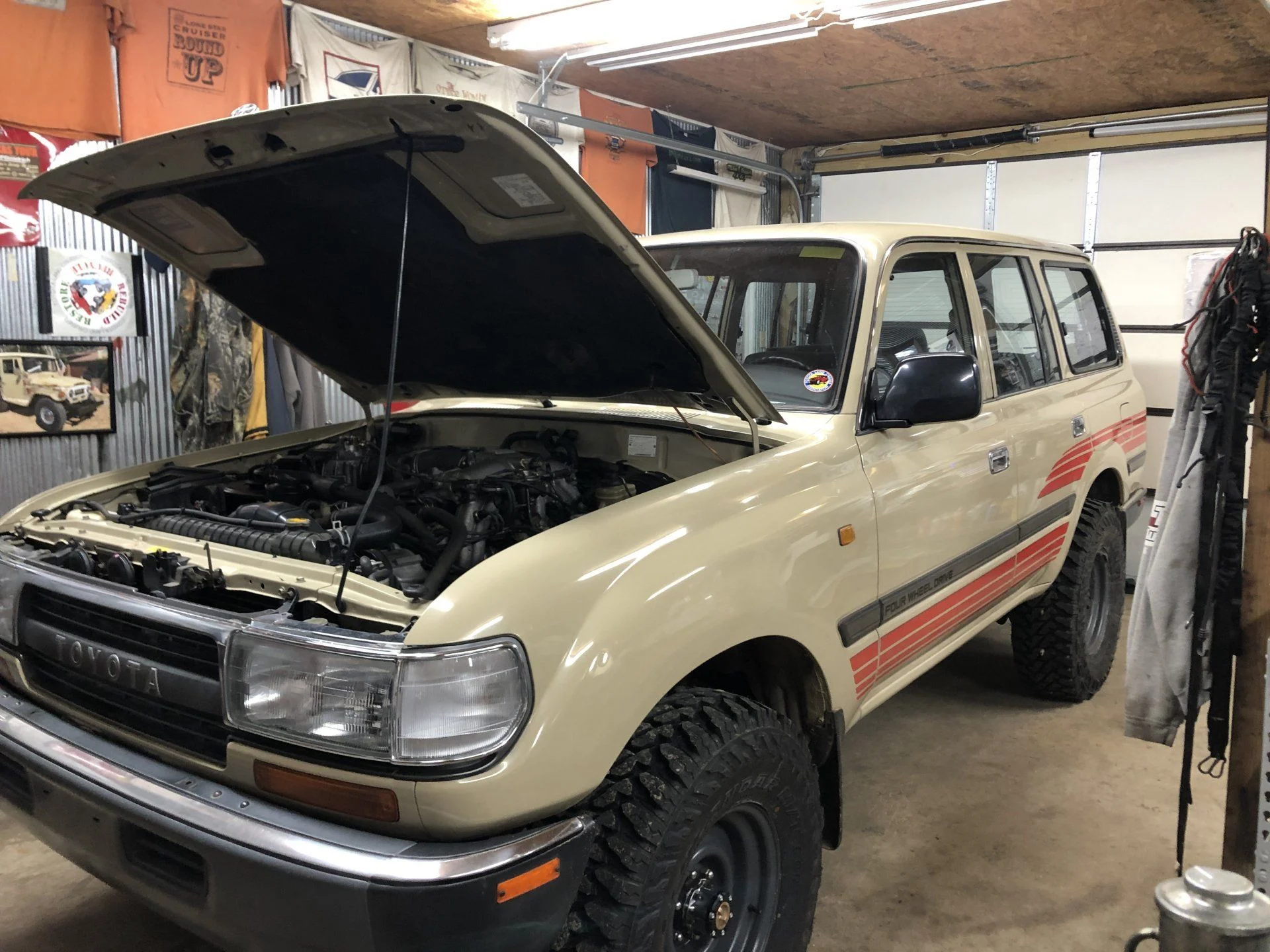

And thanks to @jmlockwood for the go-ahead to make a quick visit to Nolen's to inspect the truck and then up to @FJ60Cam for a few days so we can start plugging away at building the super special 1FZ.
Landed in Memphis. Time to start plugging away.

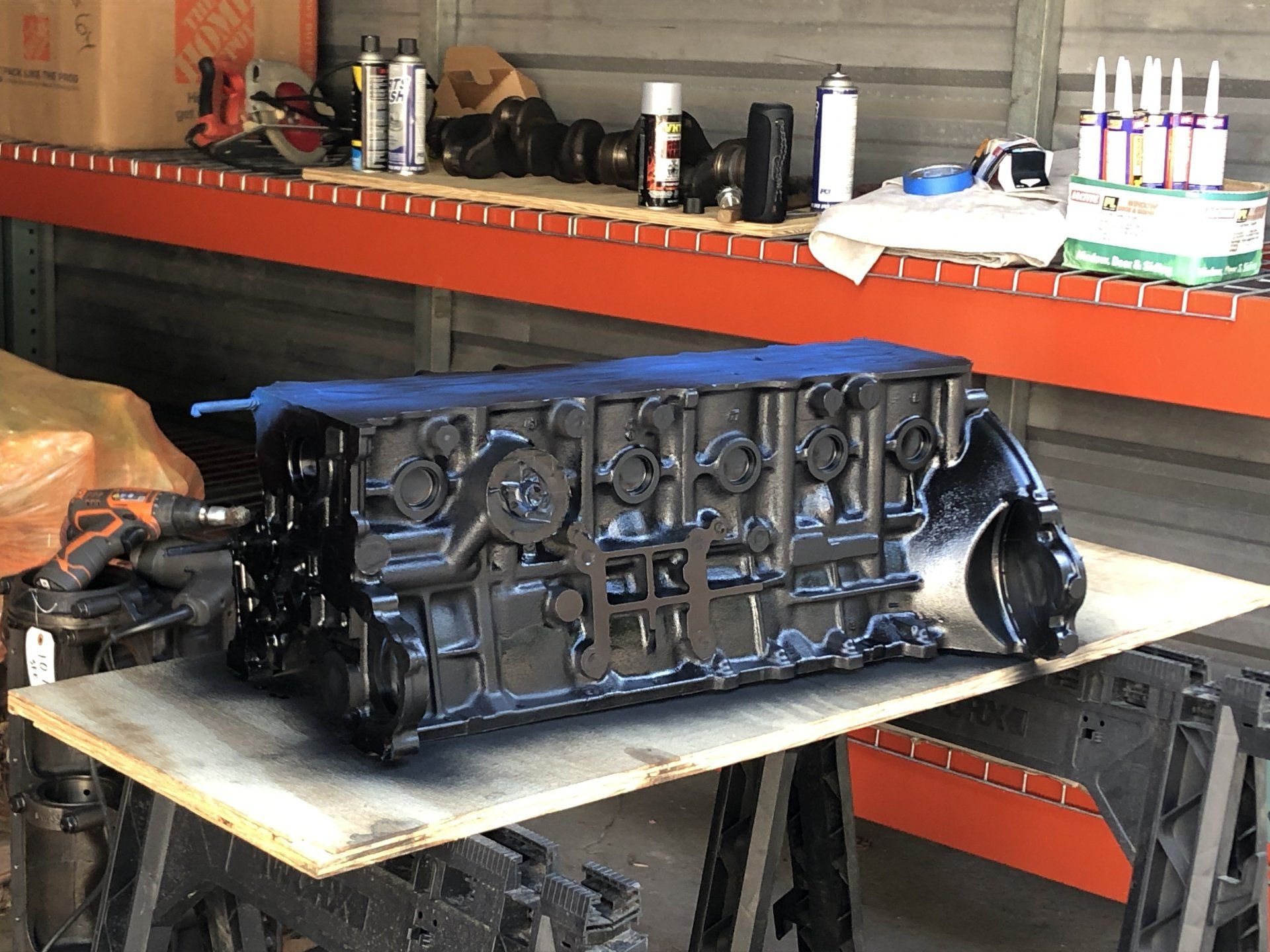

Future reference for rust removal without the labor of wire wheeling.
molasses rust removal For engine blocks and cast iron heads, this also gets the water passages flushed of scale and maybe casting residue. It is a slow process but apparently works great. You just have to plan ahead and start soaking the stuff long before you think you'll need the parts.
Vinegar to remove rust? Old guys rule!! I use this for small parts and usually works over night for surface scale.
