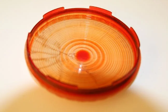

I spoke with him a few weeks ago.
My Yellow (Clear) was in good enough shape that he is going to try to reproduce them as well. I think the only real difference between the red and yellow will be the part number molded into the lenses.
He was having a time getting my clear/yellow ones out without breaking them.
Dan, any progress with the front dual sided turn signal lenses? damn that seems like a lot of adjectives for one item;)

Dan take a look at the red ones in my thread, the only difference between the amber and red lens is that the red ones have tabs along the very inside of the lens that act as stops for that set screw on top of your housing.

Steve has them. I soaked them with PB Blaster for weeks and weeks but could not figure out how to get the non-red ones out.
Is the single sided clear lens the same??? If so, I have a very good clear turn signal lens to copy.
Single sideed ones are not the same. These screw in while the single sided ones have three screws holding them in. Last I heard the single sided one could be bought new. There is a small screw on the top of the housing that helps hold the front lens in. This is removed I assume?
