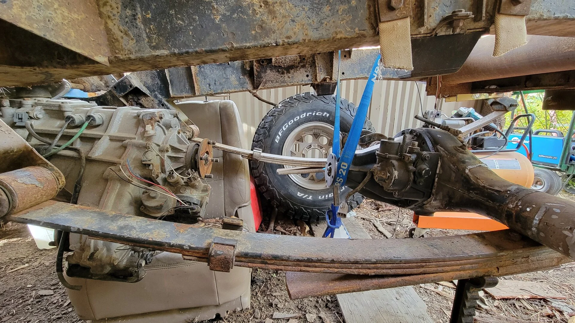

I'll try and add more later but heres a photo as requested

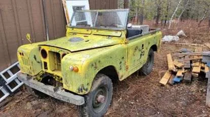

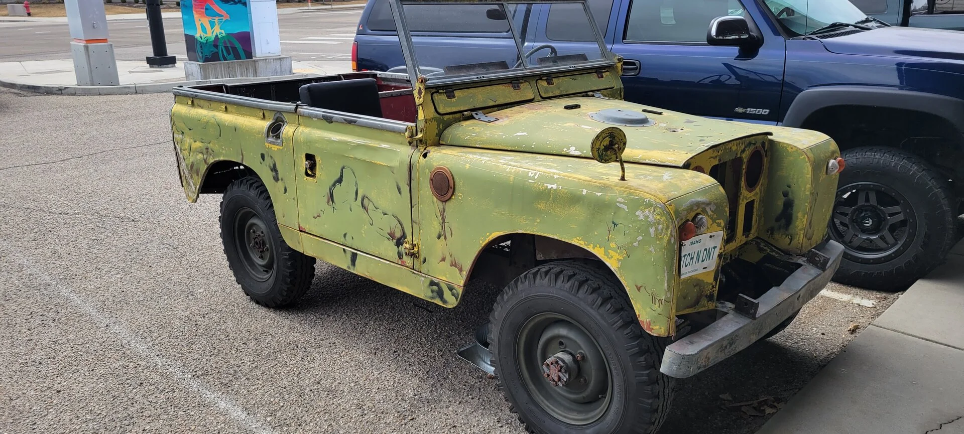

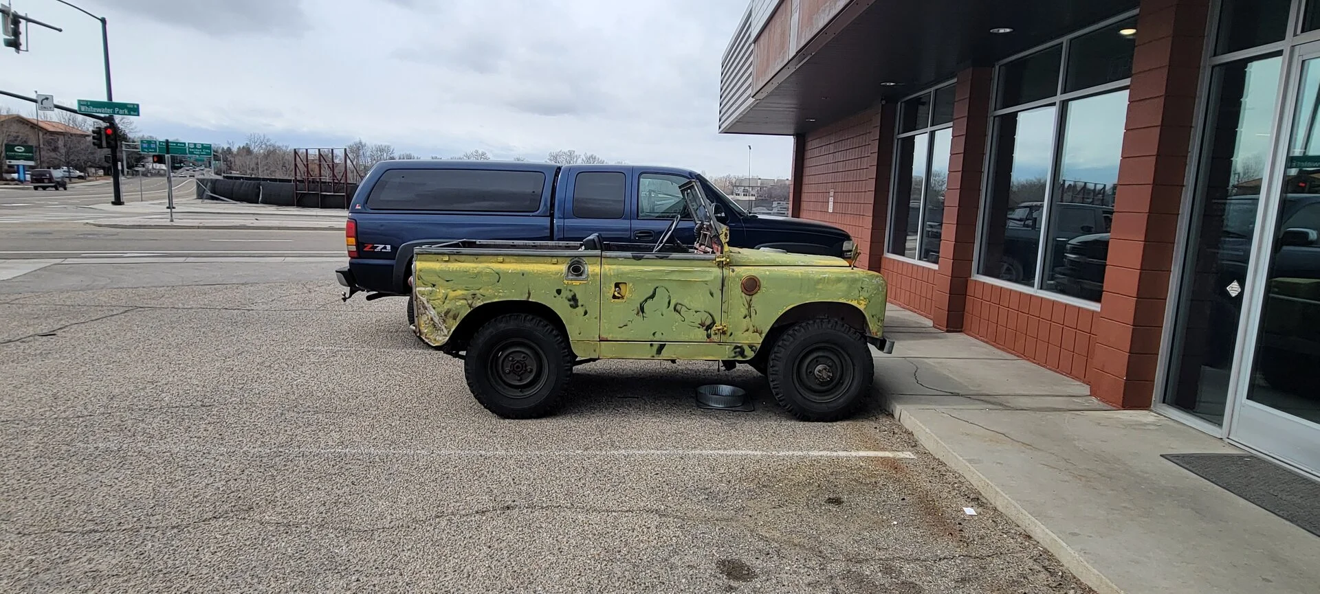

Before:

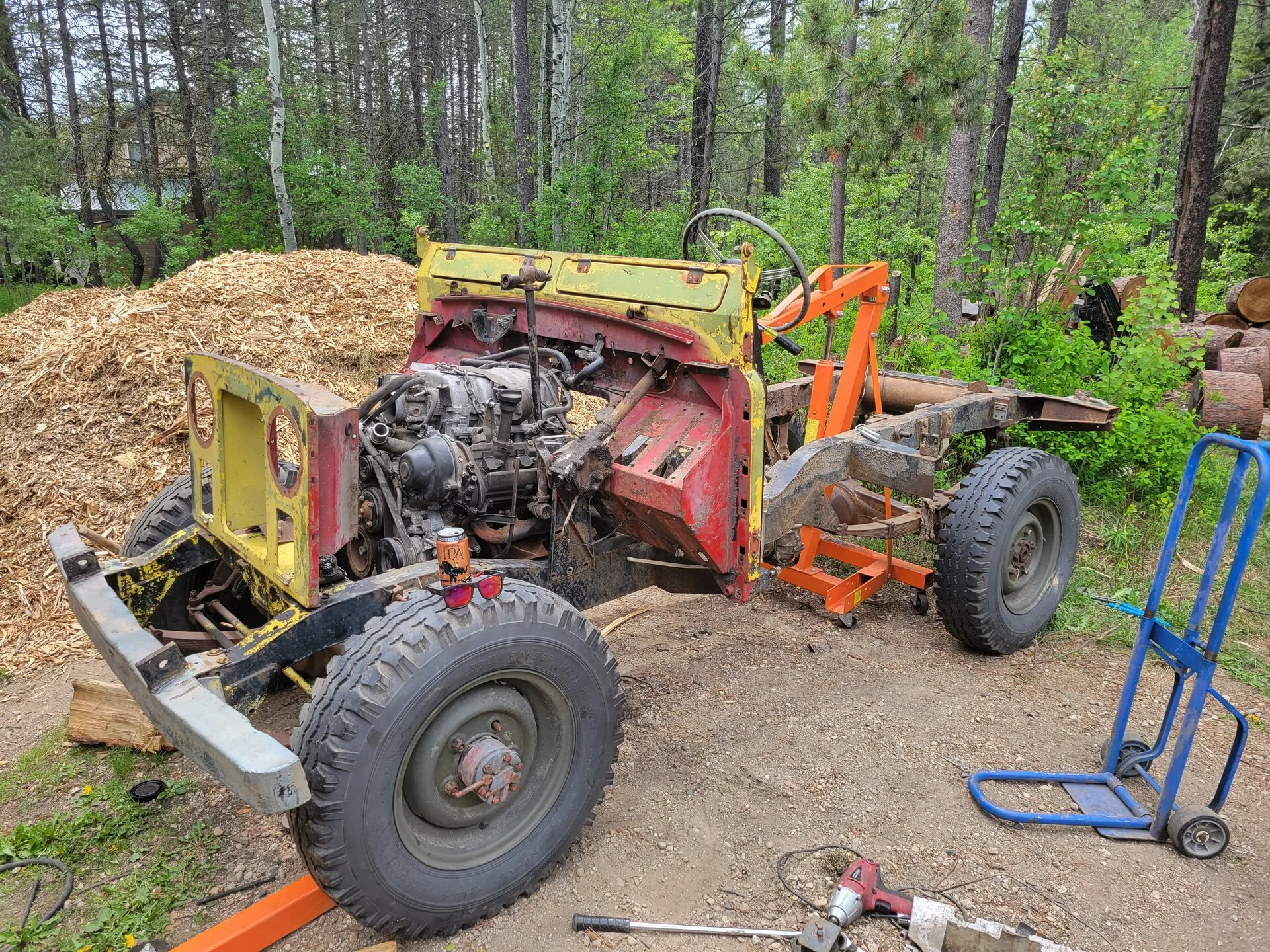

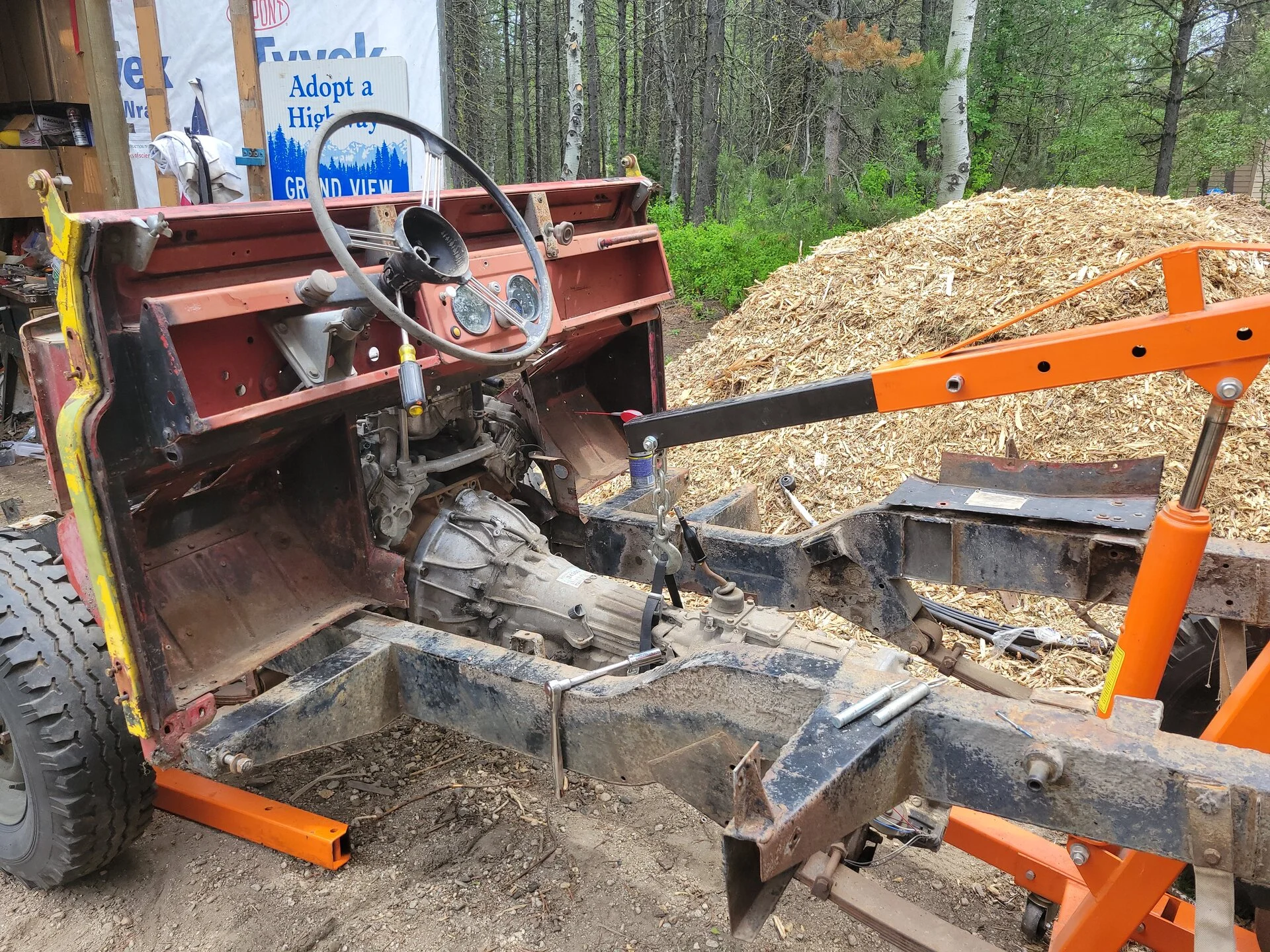

After stripping the body and loose fitting the 2uzfe and transmission:
The exhaust manifolds just clear inside the frame rails with the flanges cut off. Mounts should be pretty straighforward. Engine fit will be improved by removing the AC compressor and installing an oil filter relocator
Firewall underwent some surgery to fit things better. The LR has an offset tunnel in the firewall so it will be widened to match the drivers side. Maybe will be rebuilt as a removable doghouse to better access engine parts
Junkyard leafs from a 1st gen tundra fit great in the frames original front hangers. Flipped 180* to move the leaf's mount point of the axle about 6-8" rearward. Shackles and mounts will have to be fabbed in a way that they stick out past the rear bumper a few inches. Still only have about 14" from flange to flange right now. Hoping to fudge the engine forward a bit and fudge the axle back.
Currently experimenting with driveshaft configurations to accomplish what I need. Id like to mount the axle under the springs and find a CV or double cardan that will acccomadate the angle. Just not much room to work with so far. I tried cutting up a jeep cv prop shaft that just didnt accomplish anything useful so Im planning to go back to a 4runner double cardan if I can make some room for it.
Not pictured (yet) is the 85 solid front axle that bolted perfectly to the original leaf springs. Im invisioning a hi-steer setup with a 4runner steering box.
