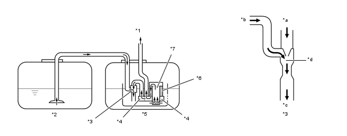

I'm curious, do we know how the OEM sub tank functions? Is it primarily a transfer pump into the main tank?
Do we know?
Do we know?
"A jet pump, which automatically transfers fuel from the fuel sub tank assembly to the fuel tank assembly, is provided in the fuel tank assembly on models with a dual fuel tank."
  1. The dual fuel tank model uses a jet pump.
  2. A jet pump has been provided to transfer the fuel from fuel sub tank assembly to fuel tank assembly.
  3. This is accomplished by utilizing the flow of the fuel through the jet pump, so that the pressure difference, which is created by the fuel as it passes through the venturi, is used to suck the fuel out of fuel sub tank assembly and send it to fuel tank assembly.

Bernoulli at its finest! I imagine there's some vapor pressure equalizing lines between the two tanks.

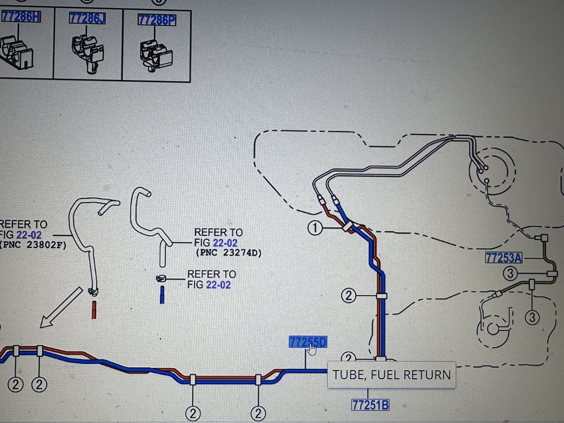

Am I correct in saying there is no fuel return line from the engine?

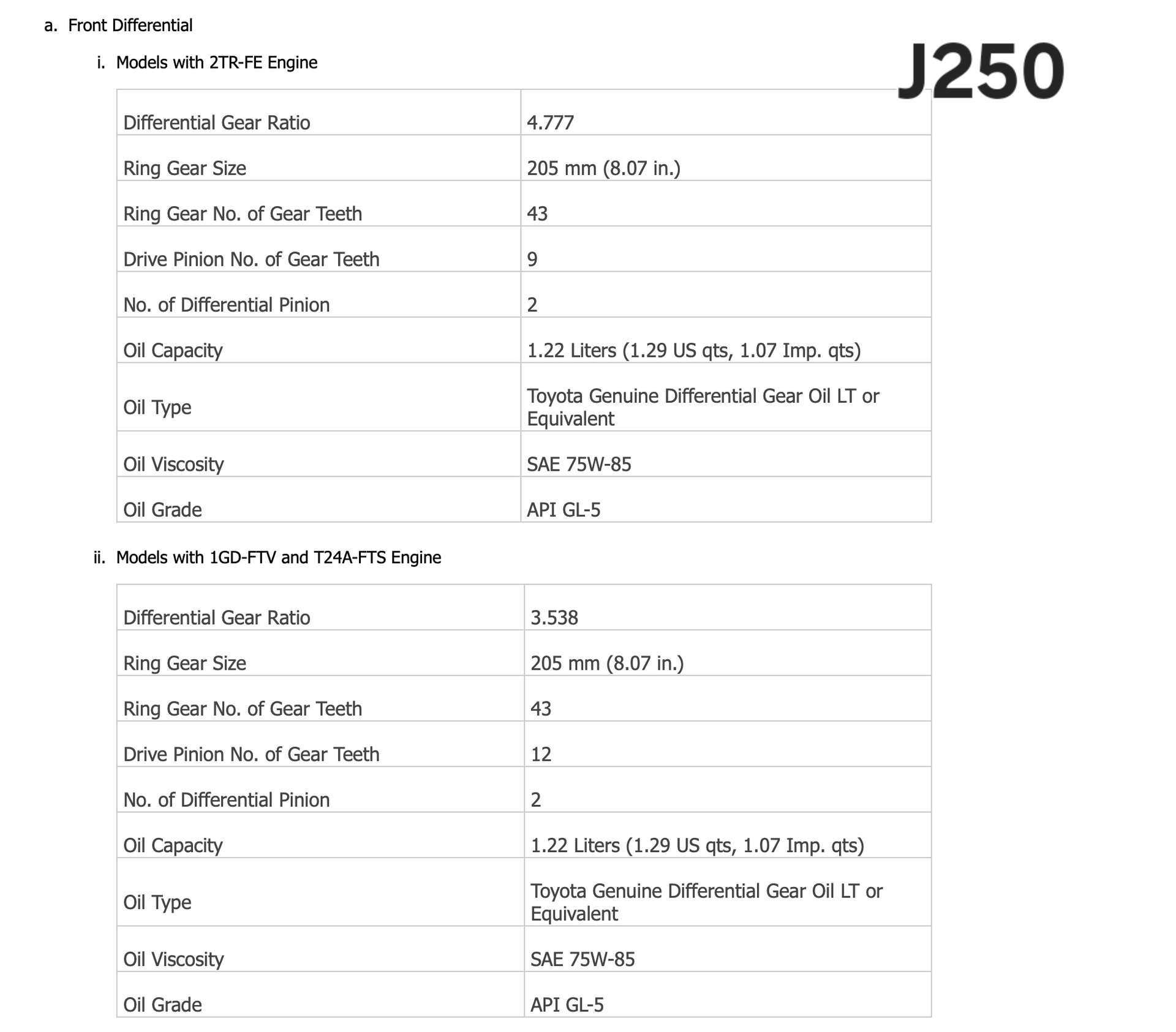

Did we ever confirm the front diff and rear axle size for the LC250 TJH version?

With this low curb weight {if this is correct} it is almost guaranteed it have smaller diff. I don't mind the smaller diff and giving higher ground clearance. The 8.2 in GX460 are pretty durable. Even more durable compared to the elocker version.
As for the front even the old 8" front clamshell are plenty strong. I hear people blowing CV all the time but I don't remember hearing somebody blowing the 8" clamshell. RLCT truck running 40" tires are still running this diff.
Tacoma seems to have BD24 on MT equipped version. The rumor saying all hybrid getting BD24 might not be true.
What is weird the overtrail might get smaller front diff compared to other model that have 3.307 gear ratio.

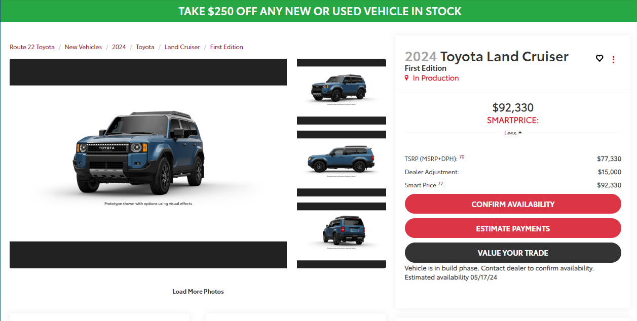

Let the dealer adjustments begin..
Just take note of these dealers and route all business you might conduct with Toyota, and any referrals of everyone you talk to, away from these businesses.
I don't patronize the Toyota dealer near me that does markups with any service or parts requests, and definitely not vehicle purchases.
