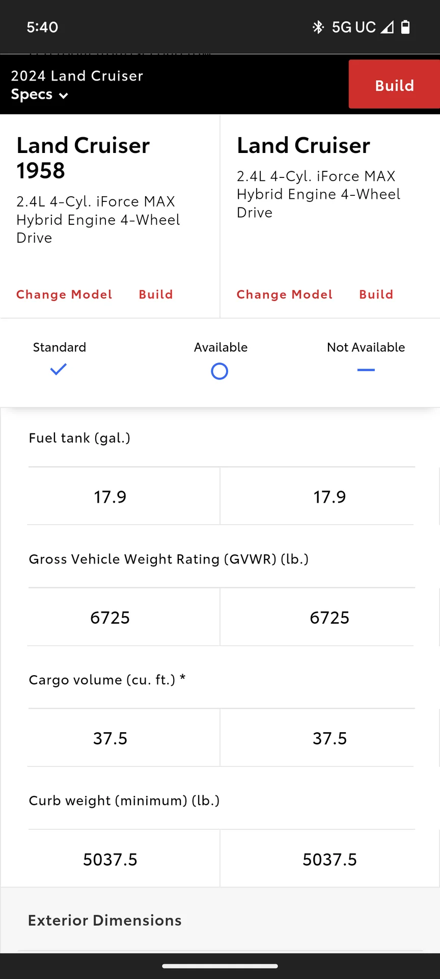

The "download details" function for a 1958 build provides some new specs, per below and at the build link:
Payload: 1687 lbs (GVWR 6725 lbs - Curb Weight 5038 lbs)
Fuel capacity: 17.9 gallons (disappointing)
MPG: 23 combined (22/25/23) -- 22 city (and dirt road) is not too shabby.
Payload is great.
MPG is pretty good. Not quite the 27mpg predicted, but 25 is a big improvement over the current 4Runner at only 19.

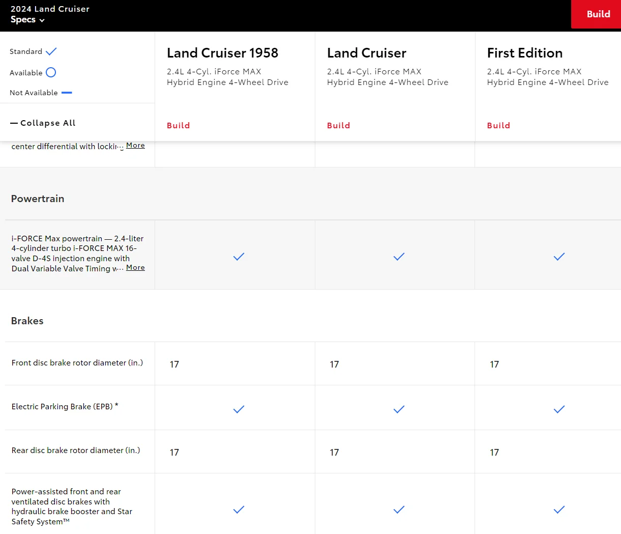

It has some very big brake rotors too, I wonder how 18" wheels fit over the brake caliper....

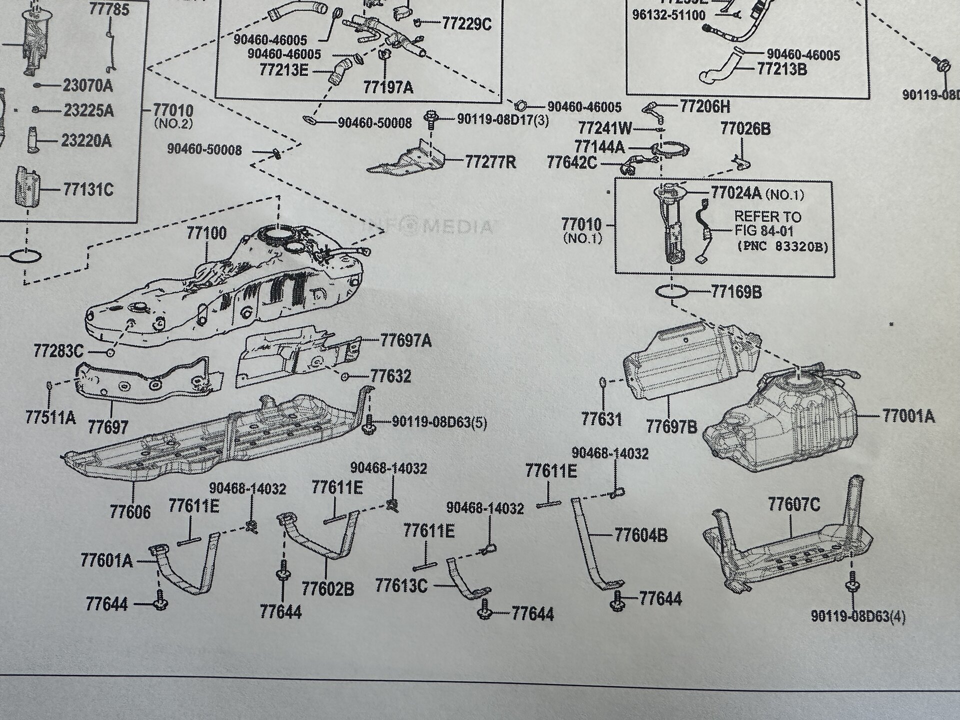

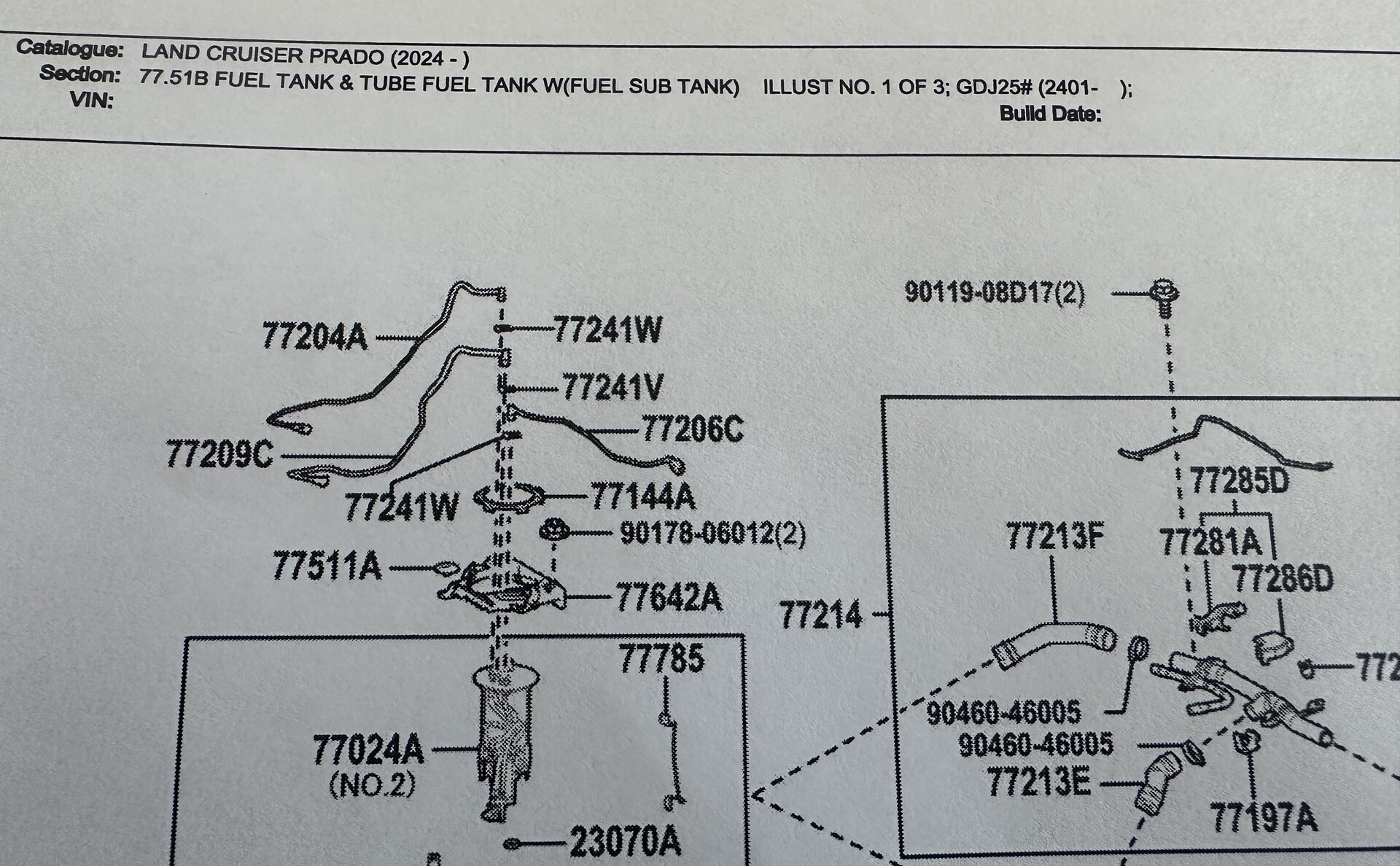

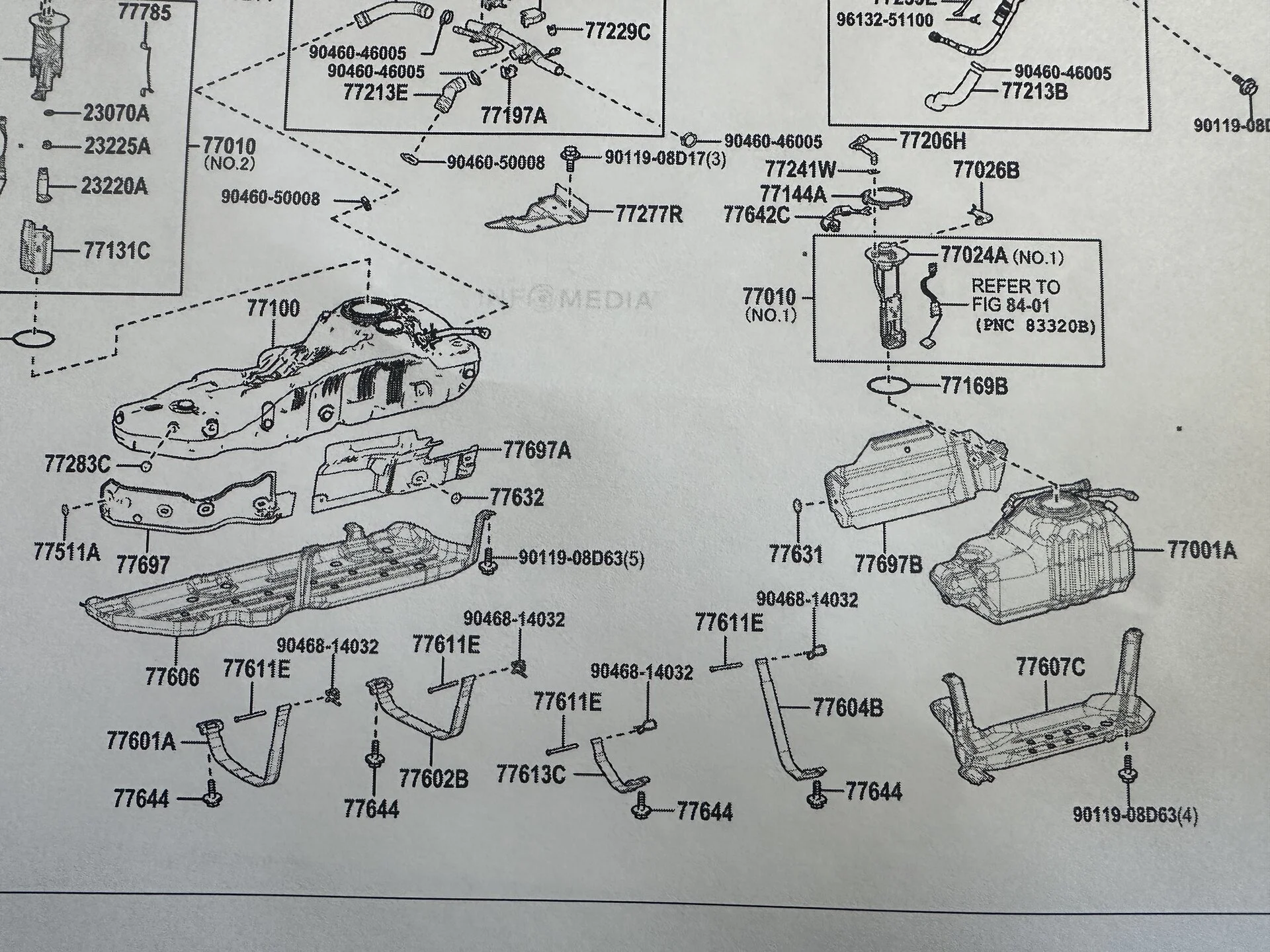

With a little luck, the GX 550 or 300 Series main and sub tanks will swap in with minimal effort. The sub tank mounts forward of the rear axle axle, just like the main. Very small, though, only 8 or 9 gallons.View attachment 3564044
I think this is going to be a direct fit, Brian.
