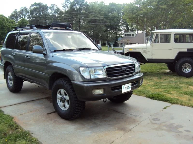

Did you want 315's? Or 285's? The 285 Look on 18's is awesome! Sonk76's truck!
285's
285's
Those look great but I want to keep the size down a little.
Then you want 285/75 R18. That's a 11.25" nominal width on a 35" diameter with your 18" wheels. Those LC 18" wheels sure look mobetta than my Tundra 18's!

Those look good...

I sold the OEM amber corners a couple years ago. I wanted all clears up front and have a amber bulb in the corners now. That was actually when I tried replacing all my exterior lights with LED bulbs and couldn't find anything bright enough... I couldn't find a suitable amber LED either and returned everything I had picked up locally...

Actually the center caps are duplicolor graphite in that picture... I was experimenting with different wheel colors at the time... I have quite the spray paint collection...
