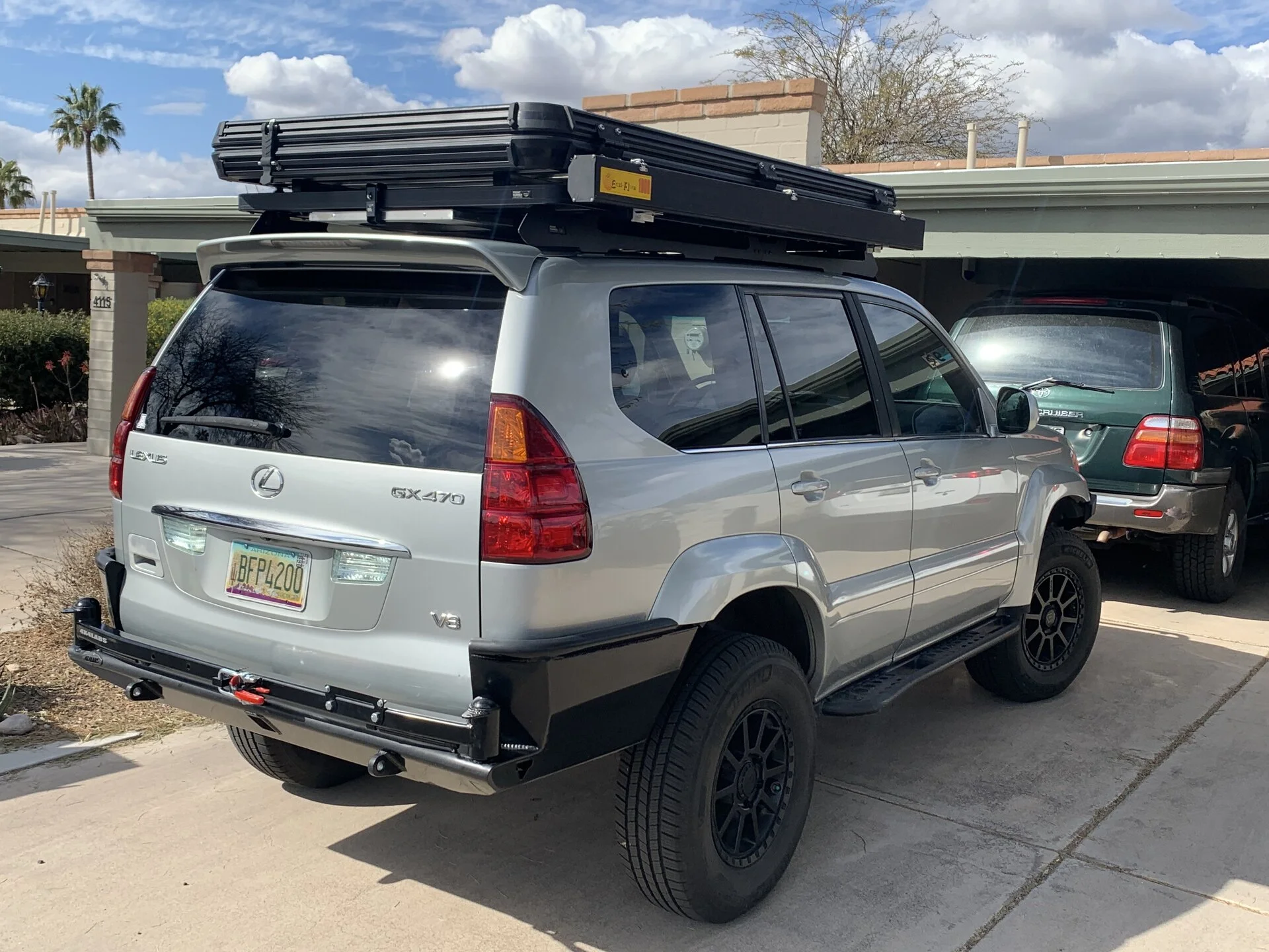

@Chuy - responding here so I can post a few pics.
I'm not running spacers and the ride isn't what I'd call "squirrelly" but it definitely rides tall if that makes any sense. Sweeping freeway runs (e.g. 87 north to Payson, 260 east to Heber) are ones I'm definitely sticking to no more than 5-8 mph over the speed limit (I generally don't ever travel faster than that anyway). Spacers have never crossed my mind but admittedly your query has me thinking - I'll ask some of the other guys in the 120 section and see what they come up with.
If you aren't in a major hurry, maybe we can find a way to let you drive mine but I couldn't make it happen anytime soon (work/life....). A few pics I've got handy (sorry, just parked it up north so can't run to the garage for any specific shots - these are random):

Thanks tlin,
Looks excellent I think Im settled on that tire with a 3" Ultimate Toyotec lift. I might run a 1" or 1.25" wheel spacer just to get the track a little over factory spec. Those step sliders look great.

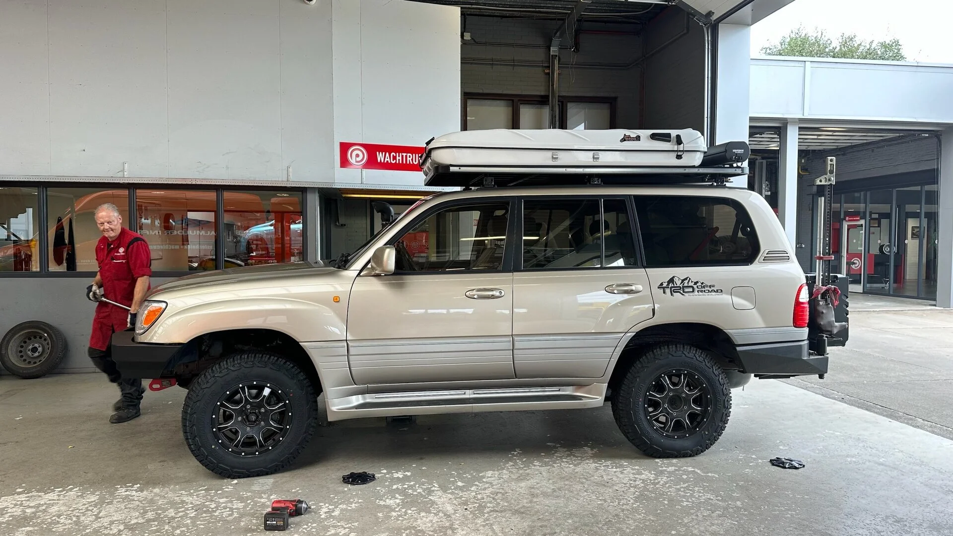

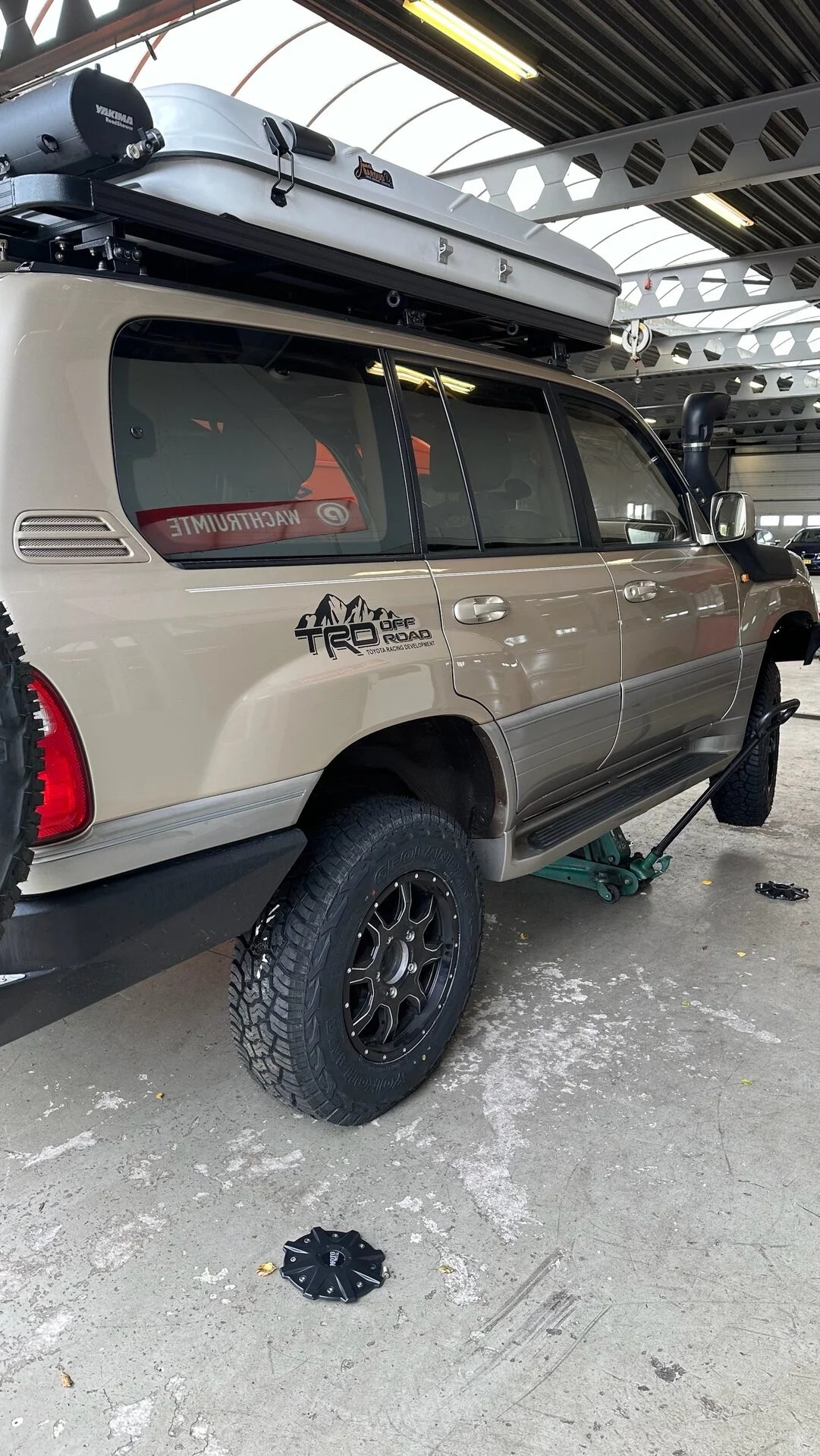

I bought 235/80/17 Yokohama X-AT tires (E rating) for my 2002 Lexus LX470. These are 32.2 inch tires and weight only 50lbs (source: Yokohama Geolandar X-AT Tires - https://tiresize.com/tires/Yokohama/Geolandar-X-AT.htm). I downgrade from Falken Wildpeak MT 34.8 inch tires which weight 80lbs (source: Falken Wildpeak M/T Tires - https://tiresize.com/tires/Falken/Wildpeak-MT.htm). So this saves 150lbs with 5 tires ! I am done with wide, heavy, large tires and will convert to pizza cutters.
