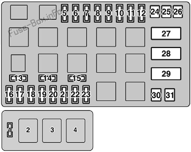

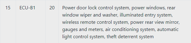

Here's the latest, we have found that these two fuses draw .5 amps when everything is turned off (ECU-B1, and AM1 NO.2). The question is, is this this normal? Also what do these fuses do? Its possible that I could just not be driving it enough but just wanna make sure its not these fuses.
Another item I'm conserned about is the radio has to be manually turned off when car is completely off. Is that noraml?

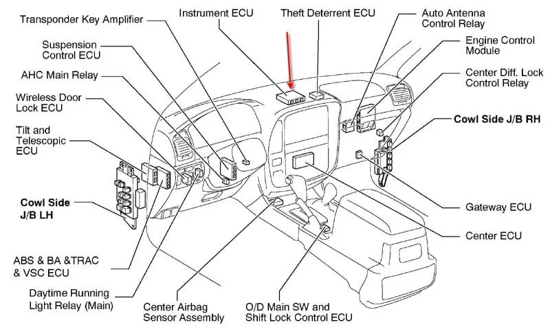

Here's another update, i'm still having trouble with my battery. I had thought that the drain might be normal and I just needed to drive it more, but after a couple days of a lot of driving I let it sit for no more than a day and it wouldn't start. I did a little more research on the ECU-B1 fuse that seems to be one of the things draining the battery. I found a couple of diagrams of what the fuse controls and a diagram of all the ECU's and where they are. So im wondering if anyone could tell me how to narrow down to which ECU is causing the problem? Also like I said above their is another fuse called AM1 NO.2 which I've looked up but couldn't find anyone else that had a problem with it.

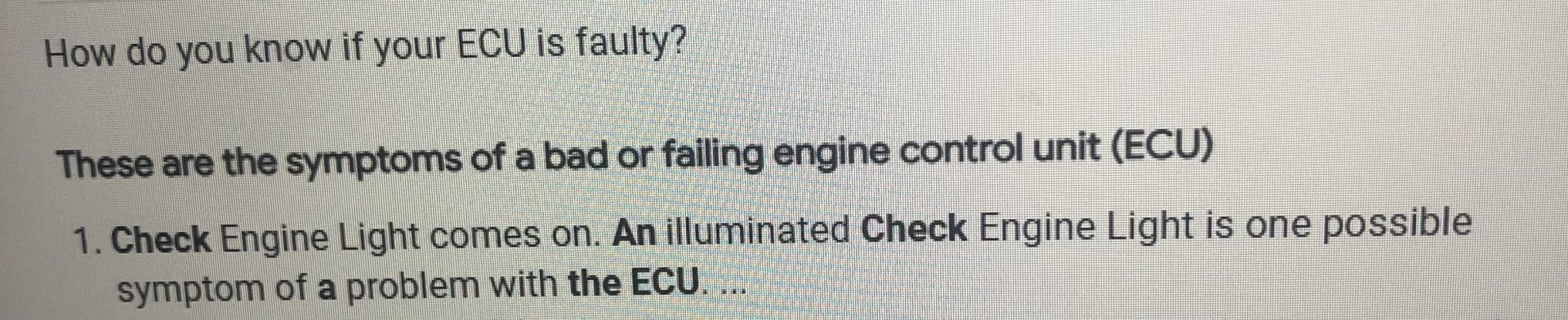

Theres two other things that I should've mentioned before, the cigerrete plug also still works when car is off, and when I was doing research yesterday I saw something that said that a failing ECU could cause the check engine light to pop up. Which when we bought the car the PO said the check engine light is always on but he didn't know why. So I think tomorrow I'm going to check to see the condition of the center ECU. Could the center ECU cause the check engine light?

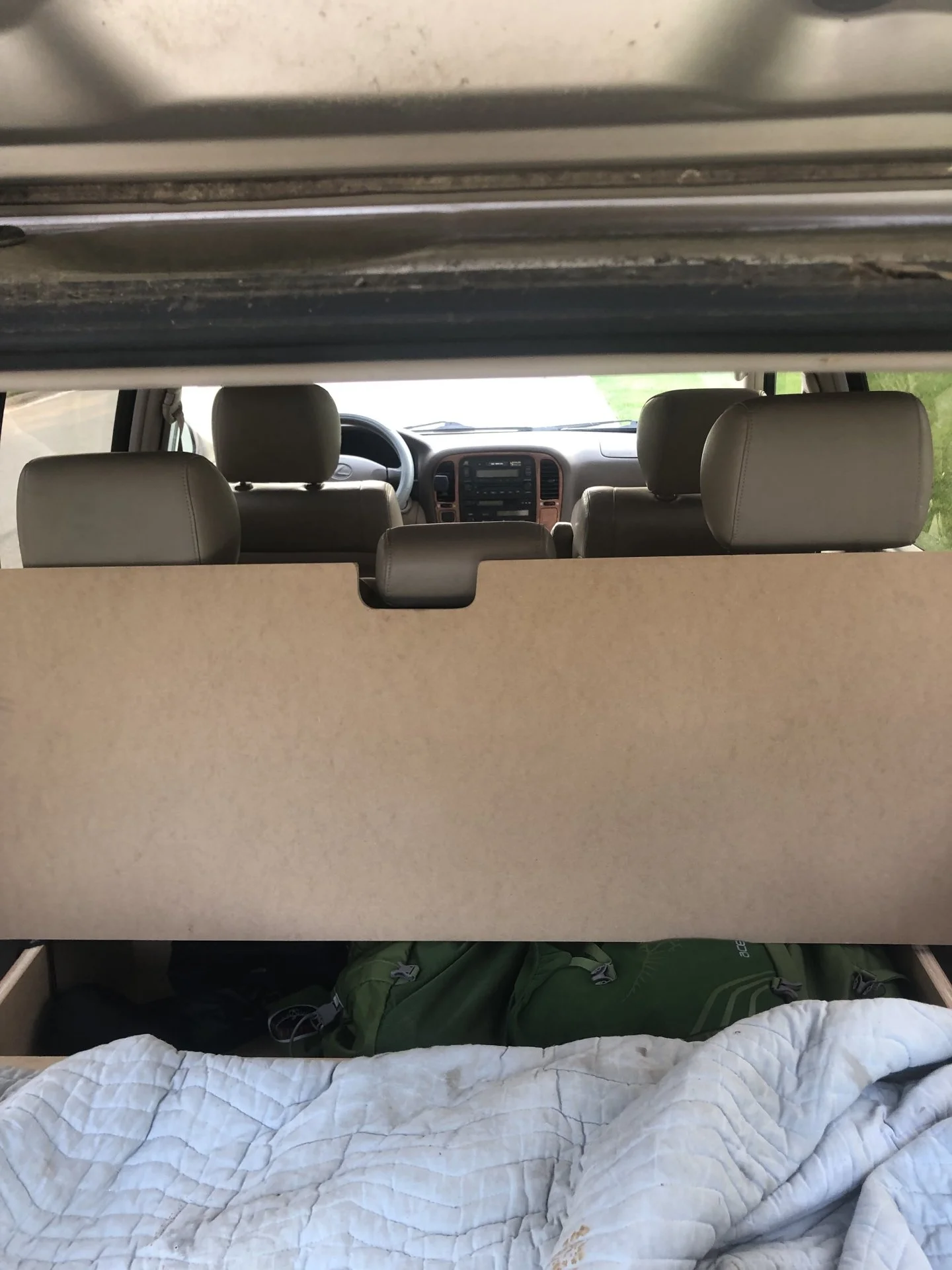

It's definitely been awhile since my last update, I have done a little bit while I was gone though. I now have storage in the back that still need drwers on it but haven't gotten to that yet. I also put on the 2in Ironman lift which has made a huge difference with the car. Unfortunatly since we did it ourselves we have a couple of adjustments that we'll need to do soon but nothing to major. Also after I started driving it a lot I found that I needed to turn the key more before taking it out so no more drain problems which is such a relief. Other than that I couldn't be happier with it and I'm looking forward to getting more done with it. I think my next step with it is going to be getting tires just gotta get to working so I can get them and pay off the lift.
