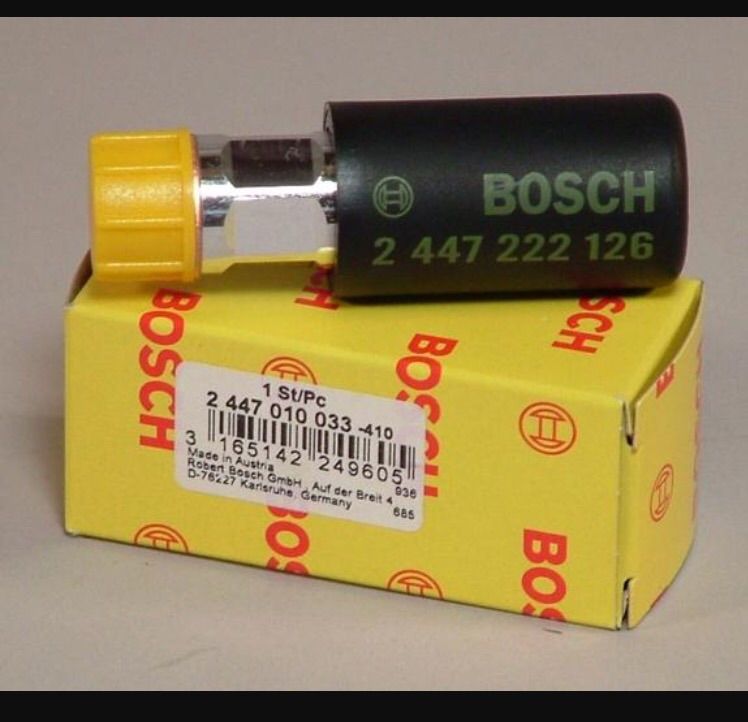

This little sucker was a pain to find but here she is!
Dan saved my butt on this one!!!
Had to hunt around the Denver metro area for a bit to find one.
Popped the new primer on and WAM! Worked like a charm!
Glad to hear you're back on the road. In your picture, the part number on the box is different from the number on the part. Could you please tell us which is the correct number?
Thank you.
Thank you.
The part # on the part is correct. Not the box!
