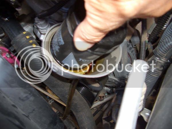

Actually, the FJC '07-'09 has the best design. The filter mounts in a cup that has a nipple on the bottom so you can attach a section of fuel line/vacuum line and drain into the oil pan.
oilchange10.jpg~original
