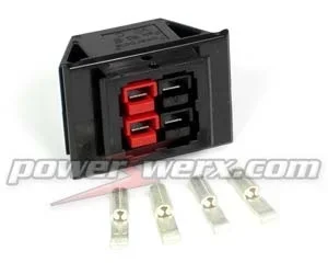

Just out of curiosity what would you guys pay for a Power Pole connector that had the same form factor as a cigarette lighter. In other words would be a direct replacement with no modifications to the vehicle.
I would pay $20 for a sturdy locking outlet that is the same size as a cigarette lighter style. Power pole setup is logical because of the existing availability of plugs. Surprised it hasn't been made yet.
I'm thinking about doing this in the rear storage pocket of my LX since I have the space, it's $9.
I'm surprised too. I'm going to do some number but at first glance I don't think I could hit the $20 price point unless the volume was there. If I get time I'll piece one together and do a DIY thread.

And many different options for female, male and cig adapters too. Having said that I use a Anderson style Powerpole, with the removable locking clip to secure the connection between my Waeco and the rear aux fuse panel in my 100.

I used the Anderson Powerpoles in my 100 series. I ran 8 guage from the battery to a blue sea 6 circuit fuse block placed in the rear cargo area, then 14 guage from there to my Powerpoles receptacle.
