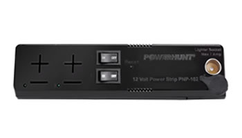

I've been searching for something better than the "cigarette lighter" 12 plug-ins and came across these:
http://www.power-hunt.com/12-volt-power-strip.php
They are designed for higher amperage and seem that they wouldn't work themselves out like the cigarette lighter ones do.
Anyone have experience with these?
Note the lighter socket plug above is only rated at 7amp:frown:
(see PDF manual)

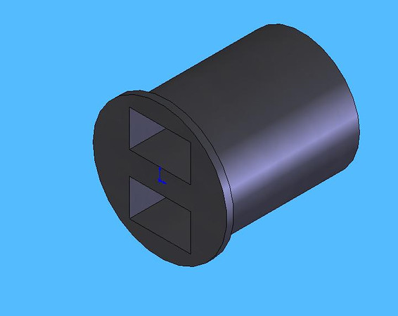

I wish that there was a better way to mount the power poles. I'd be more inclined to try them. Give me a "normal" receptacle instead of what are obviously inline connectors semi-sort of made to work as a receptacle. Best would be if it had the same form-factor as the common 12V "power point" (like the above USB charge port) because then it would be a simple swap-out, swap-in cosmetic replacement for the existing power points.
EDIT: I called West Mountain and suggested they consider something like what I mentioned above. Perhaps they'll make them. I know that I'd like to have at least a couple of them.
For USB I'm using these w/o the two screw adapter flange:
http://www.bluesea.com/products/1016/Dual_USB_Charger_Socket/featured
So you want a drop in replacement for a cig lighter receptacle that uses PP connectors? I think the problem would be that most "power points" are only rated at about 7A max. IIRC the USB standard is around .5A max so running two USB ports is easy. It would be a waste of time to do a PP connection that way, what can you run on 7A@12V?
"obviously inline connectors semi-sort of made to work as a receptacle" PCB mount PP connectors are available, in fact the Rigrunner series of products use them. BTW they are not really inline connectors they were kind of derived from the connectors used on arc welders.
No, I realized that re-wiring would be necessary to take advantage of the additional ampacity afforded by the PP's. What I think would be a seller would be if people didn't have to make new holes in the vehicle to replace their old power-points. Make a part, an adapter really, that the PP connectors snap into that has the same form and size as a power-point. Could possibly even get two pair in such an adapter. I get why the PP's are shaped the way that they are, but that shape isn't very conducive to making a "receptacle" out of them.
Something like this:
Ntsqd I think you have a good idea here. After recently installing a Marinco cig receptacle (and new wiring), in my LX for my fridge, I would be a buyer if I could swap that receptacle for a "power pole" receptacle. Part of the reason I stayed with the cig plug was so that I can use my fridge with my other vehicle without having two power cords (one for cig plug and one for power pole). The Marinco locking plug pretty much stays put in my LX, but I constantly have to make sure it stays plugged in my Ford. My fridge peak amps is around 5A, and runs fine on the factory wiring in my Ford.
