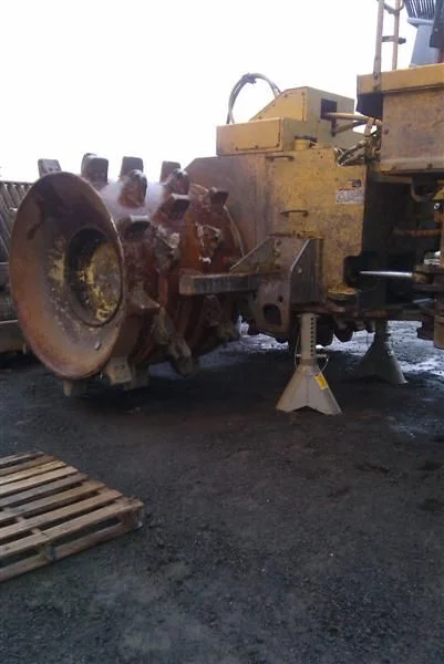

After reading a bunch of threads about jack stands including one that failed crushing someones chest I pulled the trigger on a set of 12 ton double locking Torin jack stands from Home Depot, and they were a smokin deal. These are not stocked at the store and you have to special order them.
Don't order them online cause they list for $99 a pair there and have a different number, T412002C, but are the exact same model. Instead go into your local Home Depot store and tell them you would like to place a special order for a set of 12 ton Double Locking jack stands using this number; T412002A. My cost out the door was only $56 for the pair including 6% tax. Only drawback is that it took over two weeks to get them as they are shipped to my local store from the Torin warehouse in California.
They are for sure hefty at 30 pounds each. The triangular shaped safety pin is one of those mods you wish you had thought of yourself. You slide it in after you get the ratchet bar to the height you want; it locks the handle and bar in place by catching another tooth in the bar. I'm guessing it also acts as a backup to the pawl.
Specs: (actual measurements)
min height: 18 3/4"
max height: 28"
base: 12 1/2" x 10 3/4"
wgt: 30 lbs each
Yeah, like 95% of all jack stands, the Big C, but they look well made, better than HF quality using the eyeball test. The main reason I posted the price is cause I think it may be an old price someone forgot to update, so maybe get your order in before they catch it, but the main advantage is no shipping charges from Home Depot. Advance Auto carries the Torin 3 ton and 6 ton if you want to check out the build quality, but they can't order the 12 ton double locking, I looked into that route before finding this deal at Home Depot.
