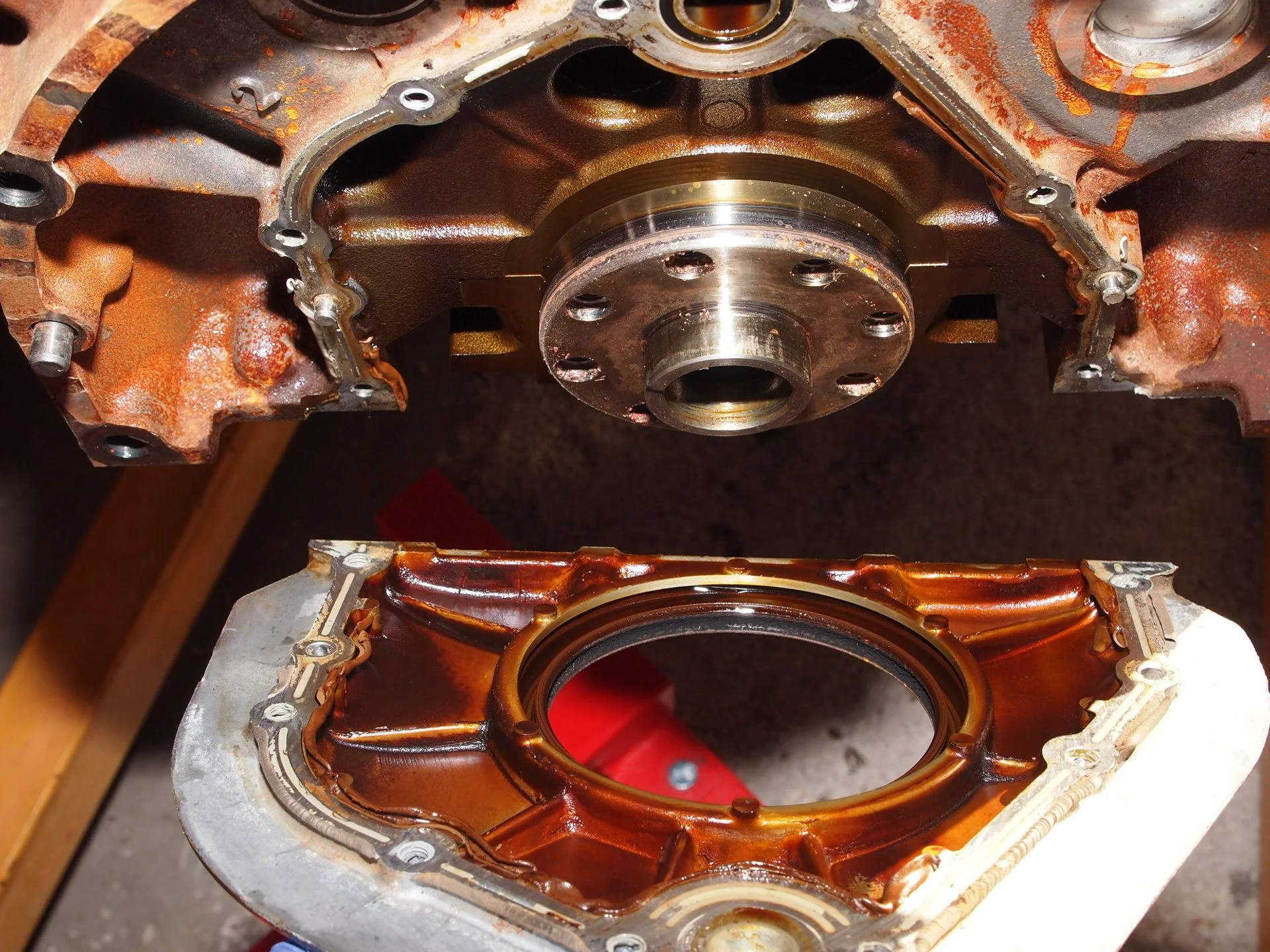

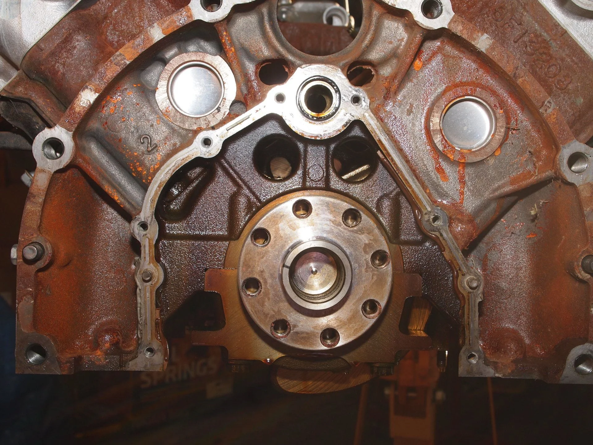

I do see the drip of fresh oil on your upper oil pan rear bolt but you've not shown us much else. This could be from elsewhere around engine flowing back, even from oil drain plug

I don't think you've "puke" out rear main seal.

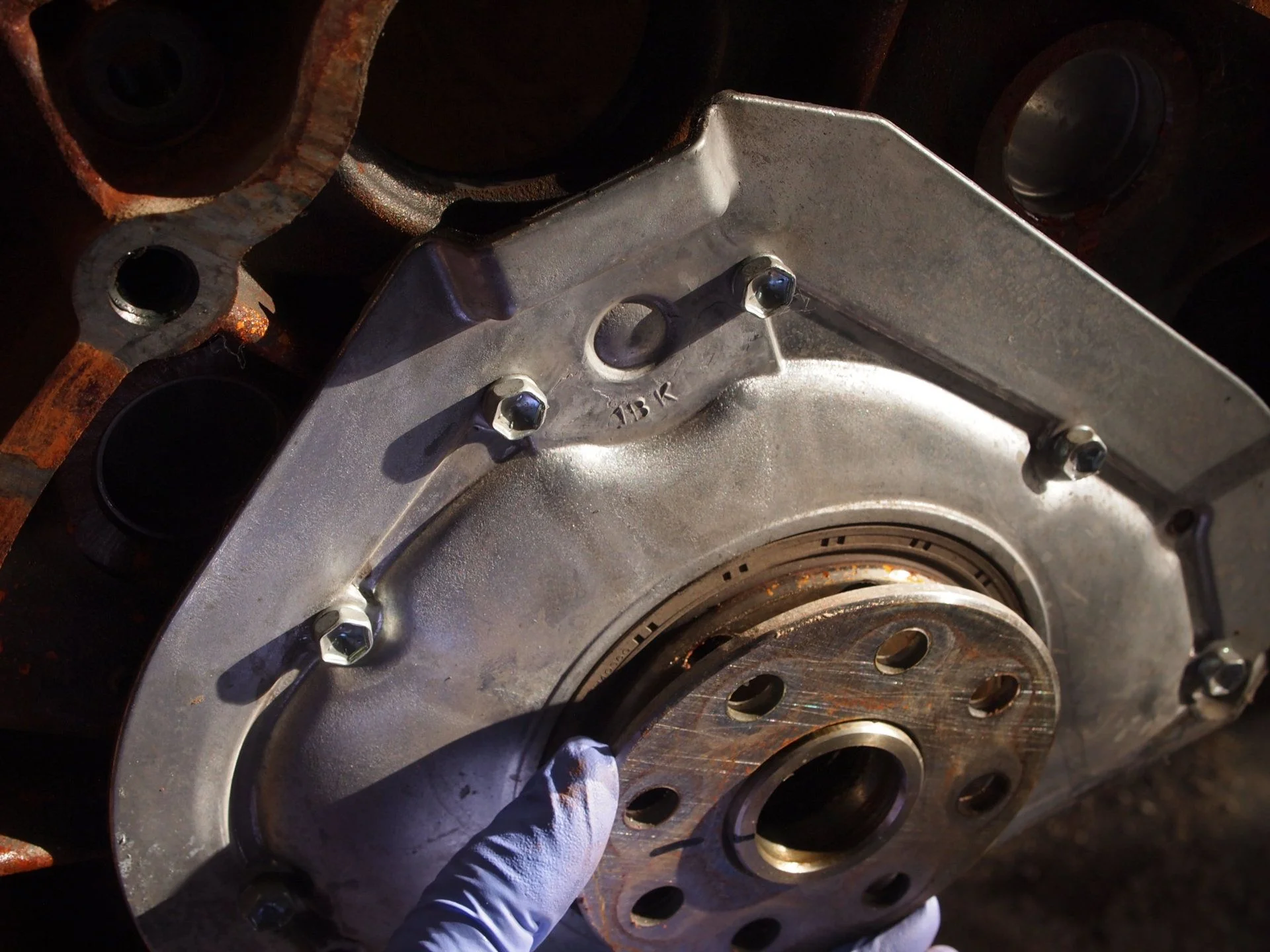

Could be some FIPG from the rear oil seal retainer plate. Or something that came from above, possible from drain holes in valley at base of starter.
